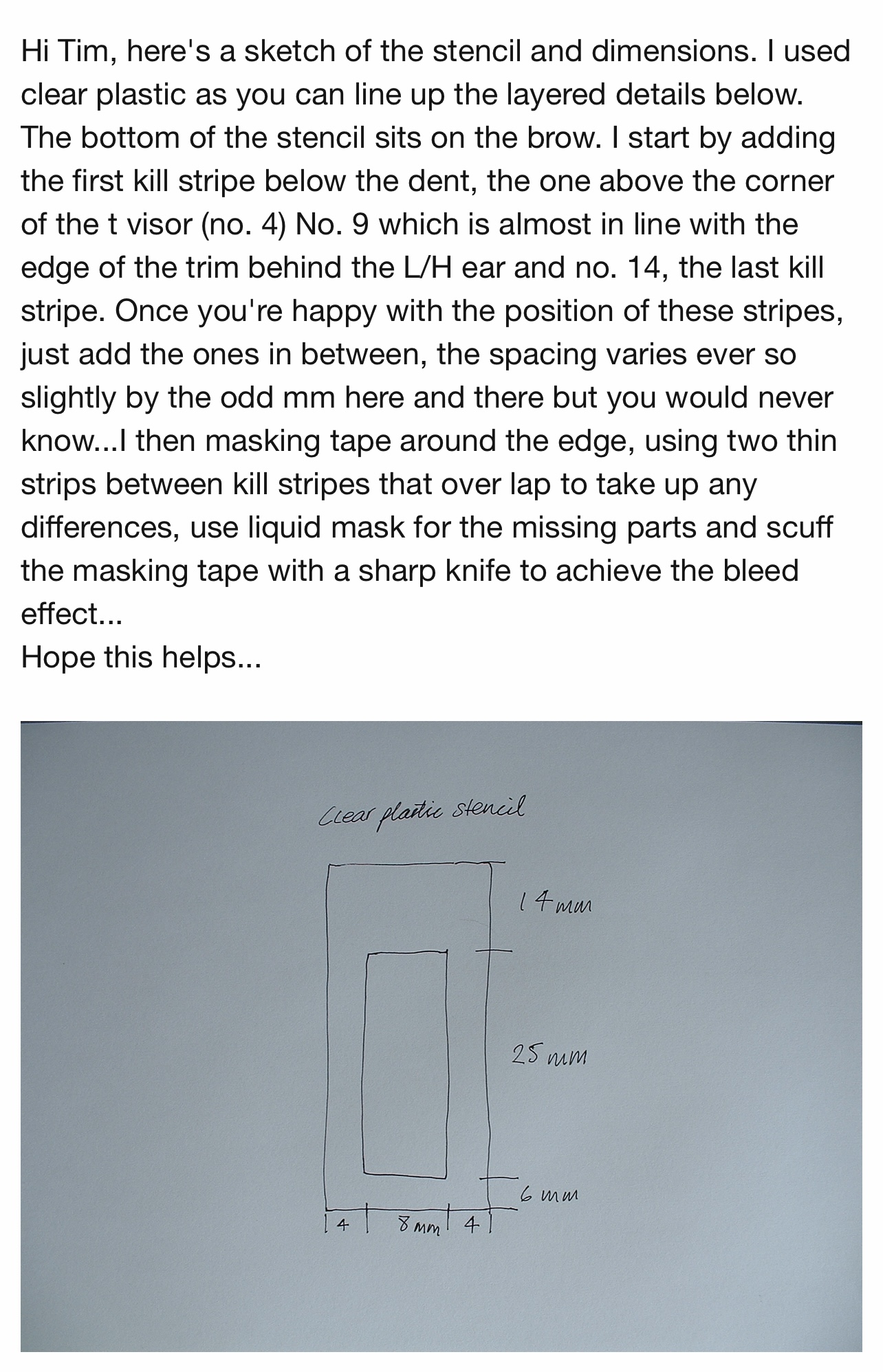

Hope this helps, from a Terminal Fettler paint up thread:
So, in general - each strip is 8mm wide x 25mm tall with a 4mm gap between each stripe.
All stripes are 6mm up from the trim.

Sorry, I must have missed this post somehow. The ROTJ killstripes are approximately 6mm wide x 20mm tall,, with 5mm space in between each one. I say approximately because some helmets may be different than others and the killstripes would need to be scaled up or down to fit the scale. These measurements should fit the "hero" sized helmets though.
Thank you so much for the help!!
