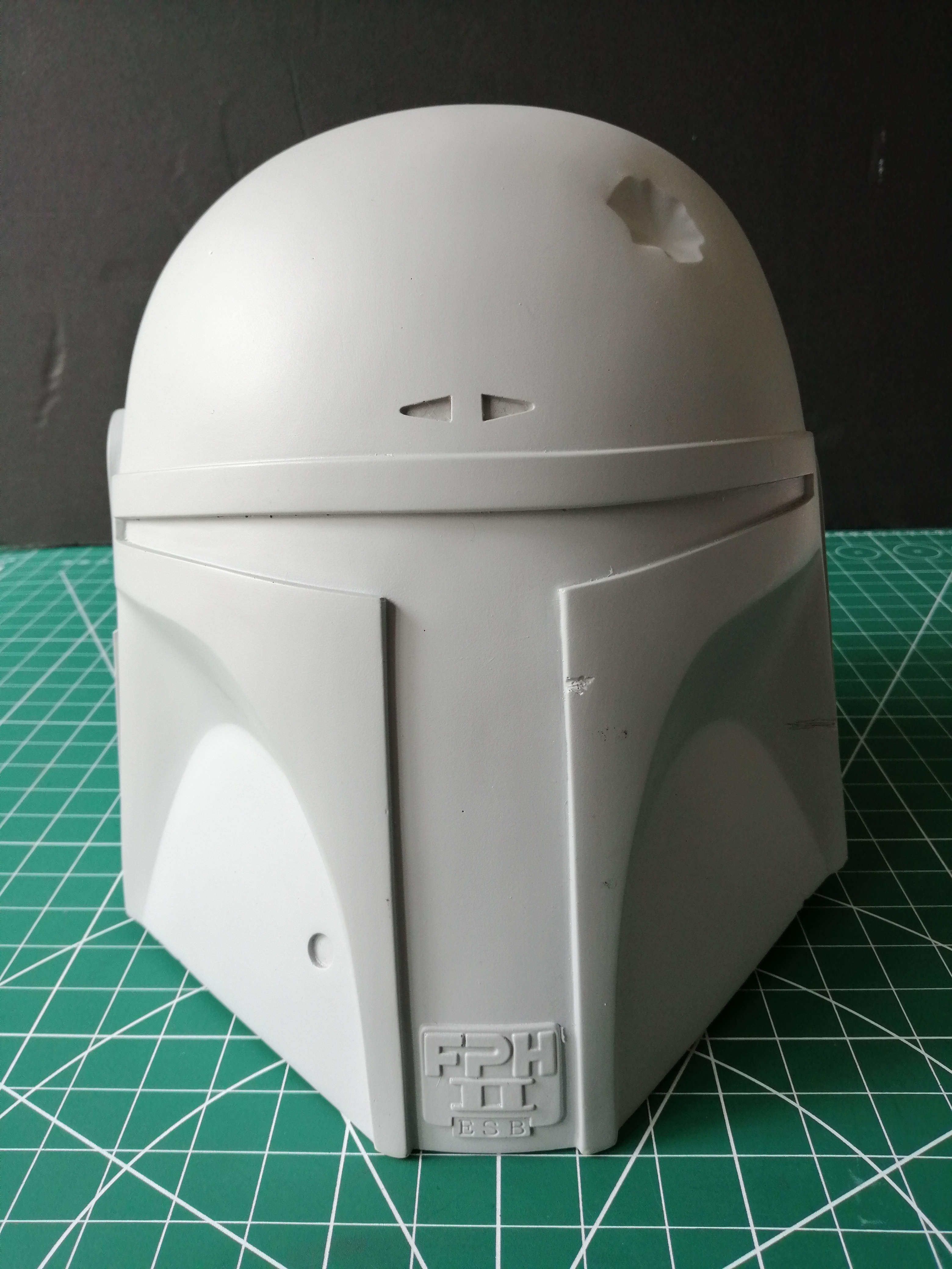

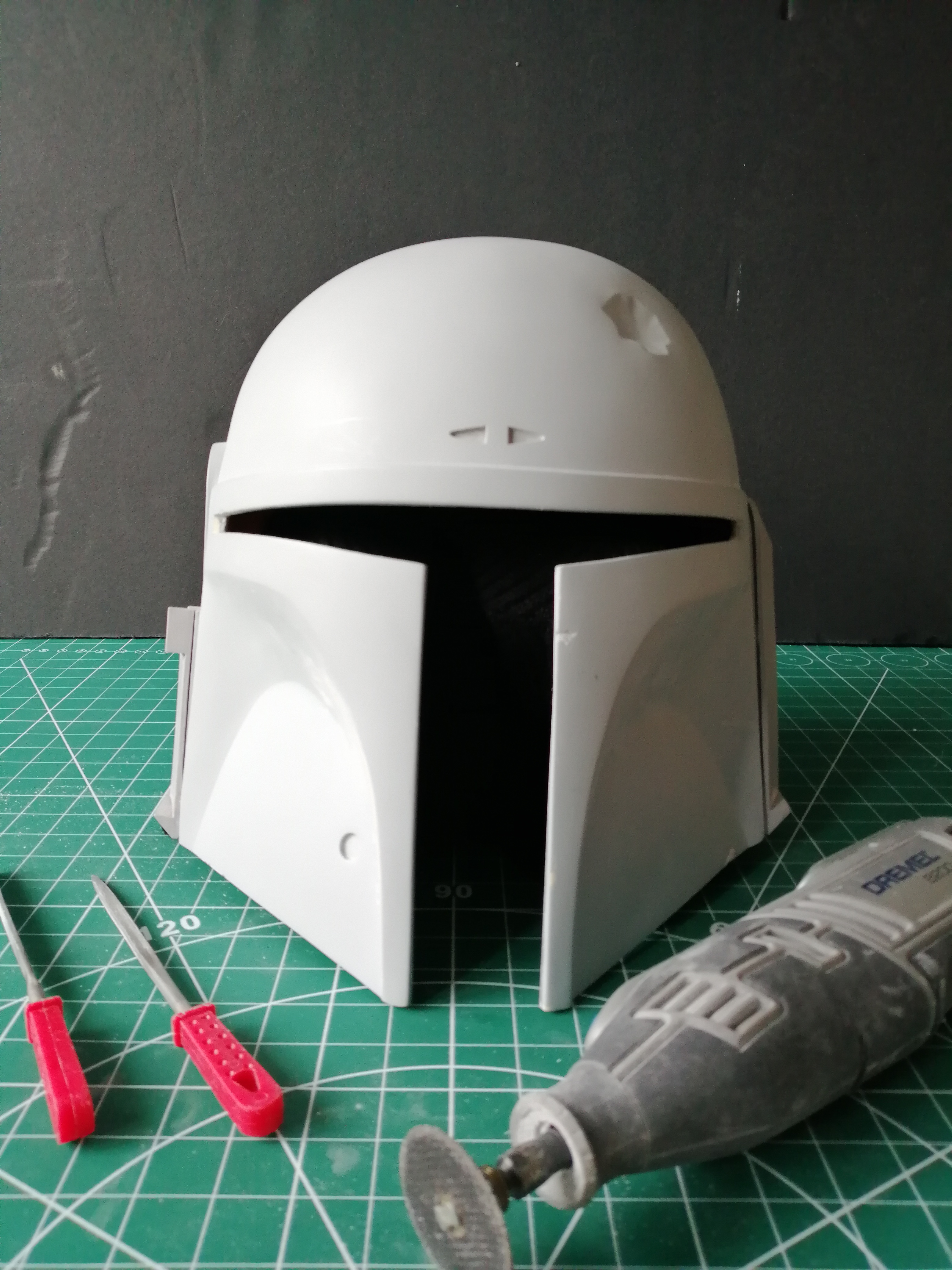

First steps will include triming out the visor area and filing out the key slots as well as adding the bulge to the right mandible.
Time to get the dremmel out........
Kill Stripe
The bucket has had a quick clean to remove any residue, next step mark out the visor with a marker pen and drill some pilot holes and trim out the visor.

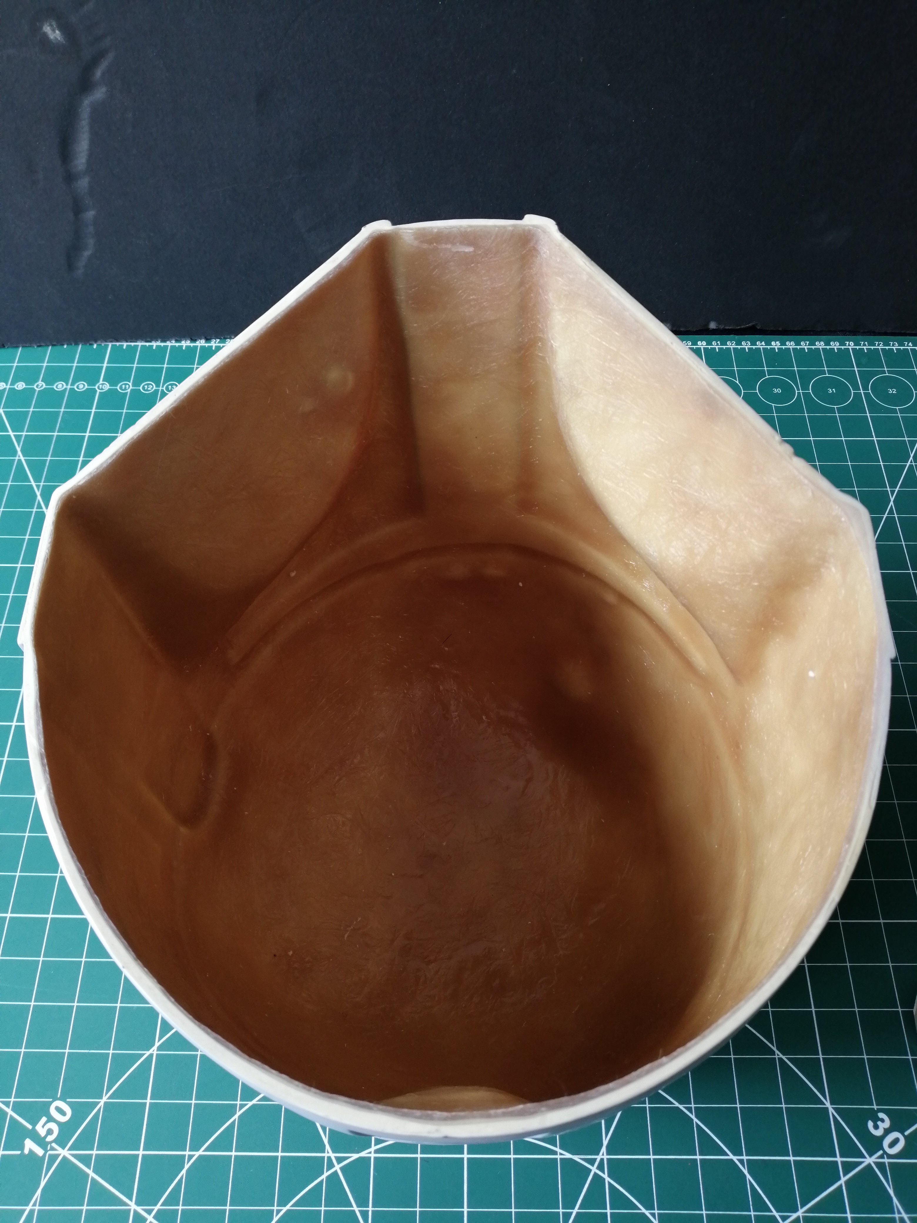

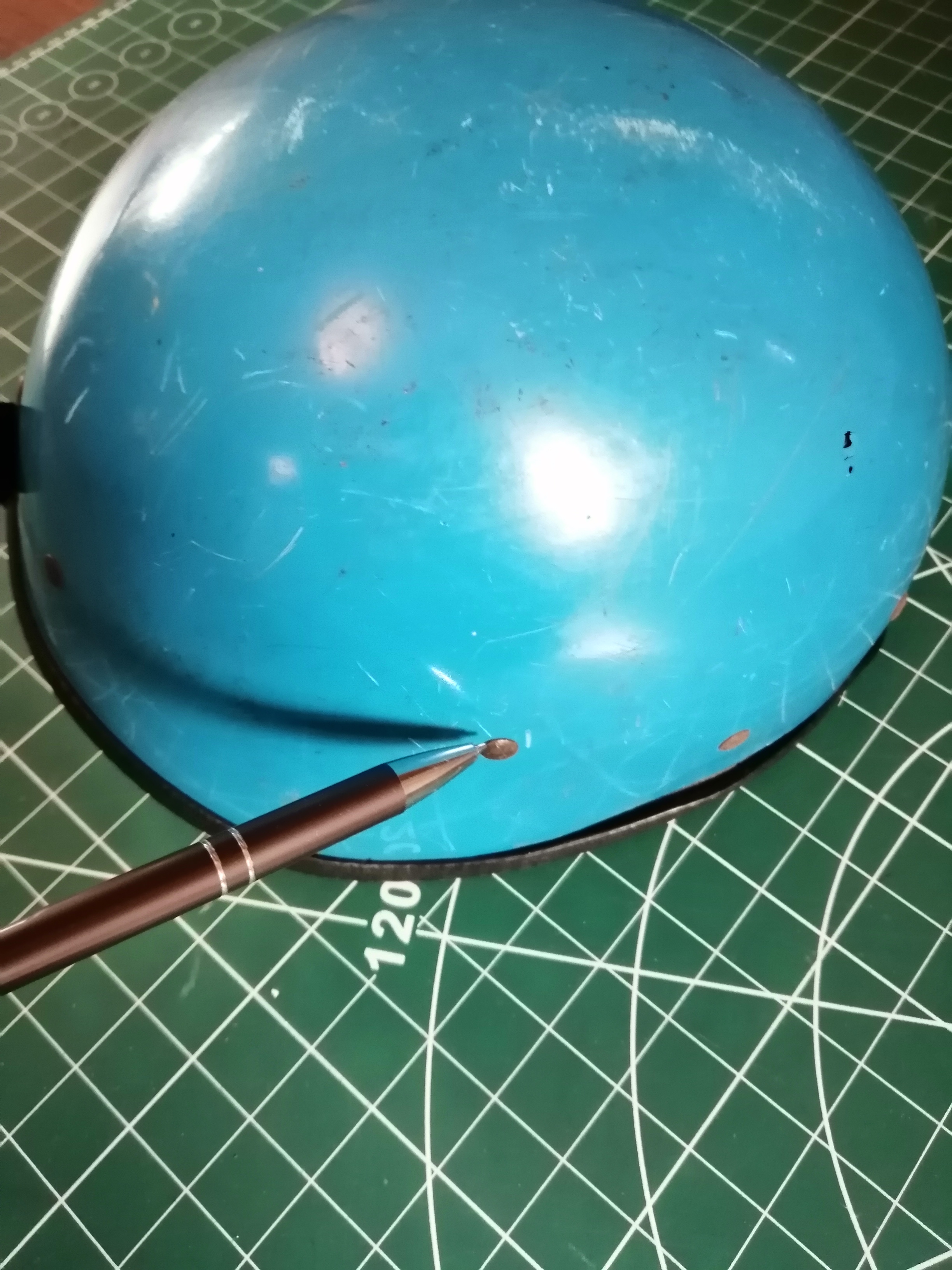

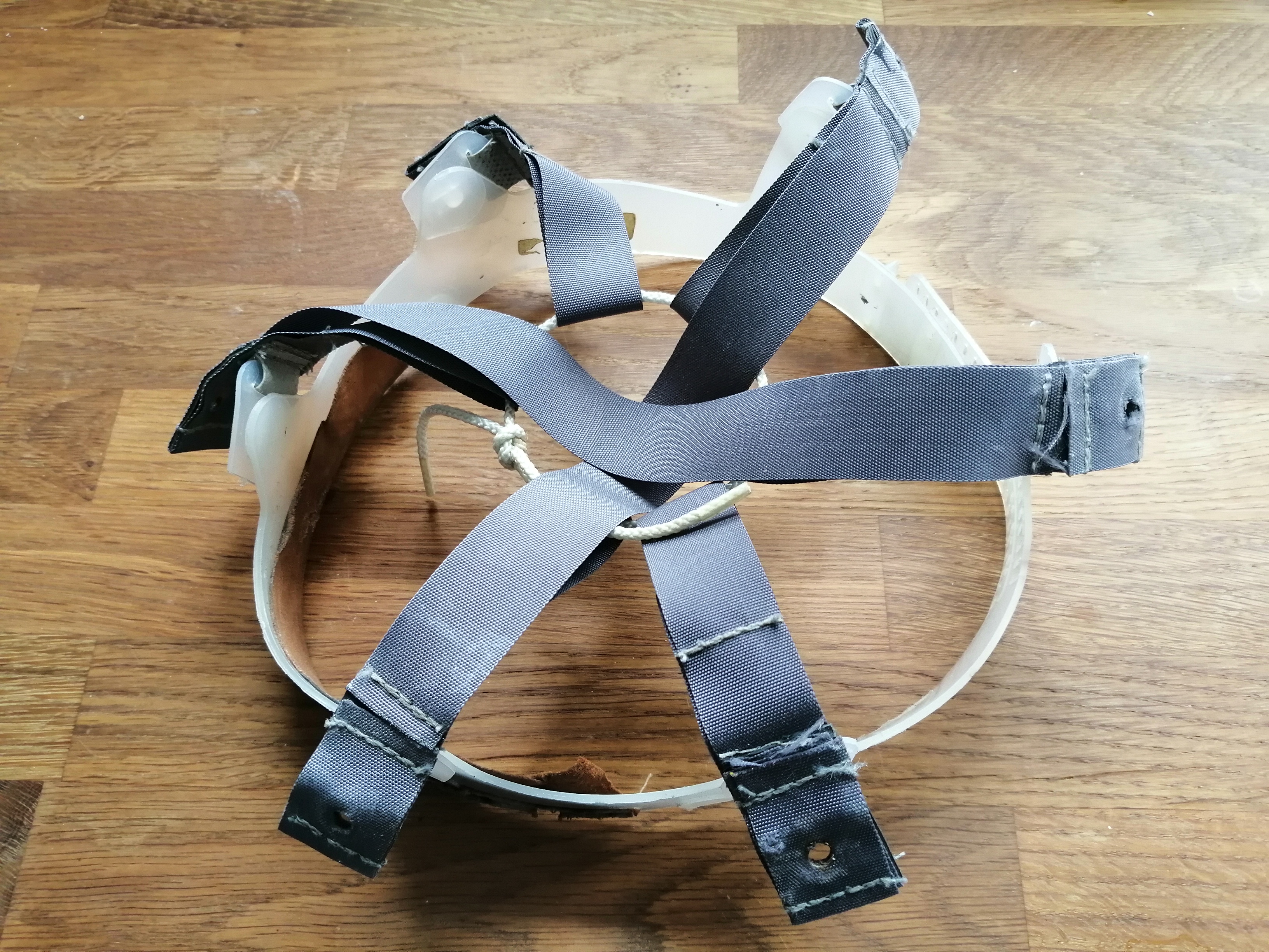

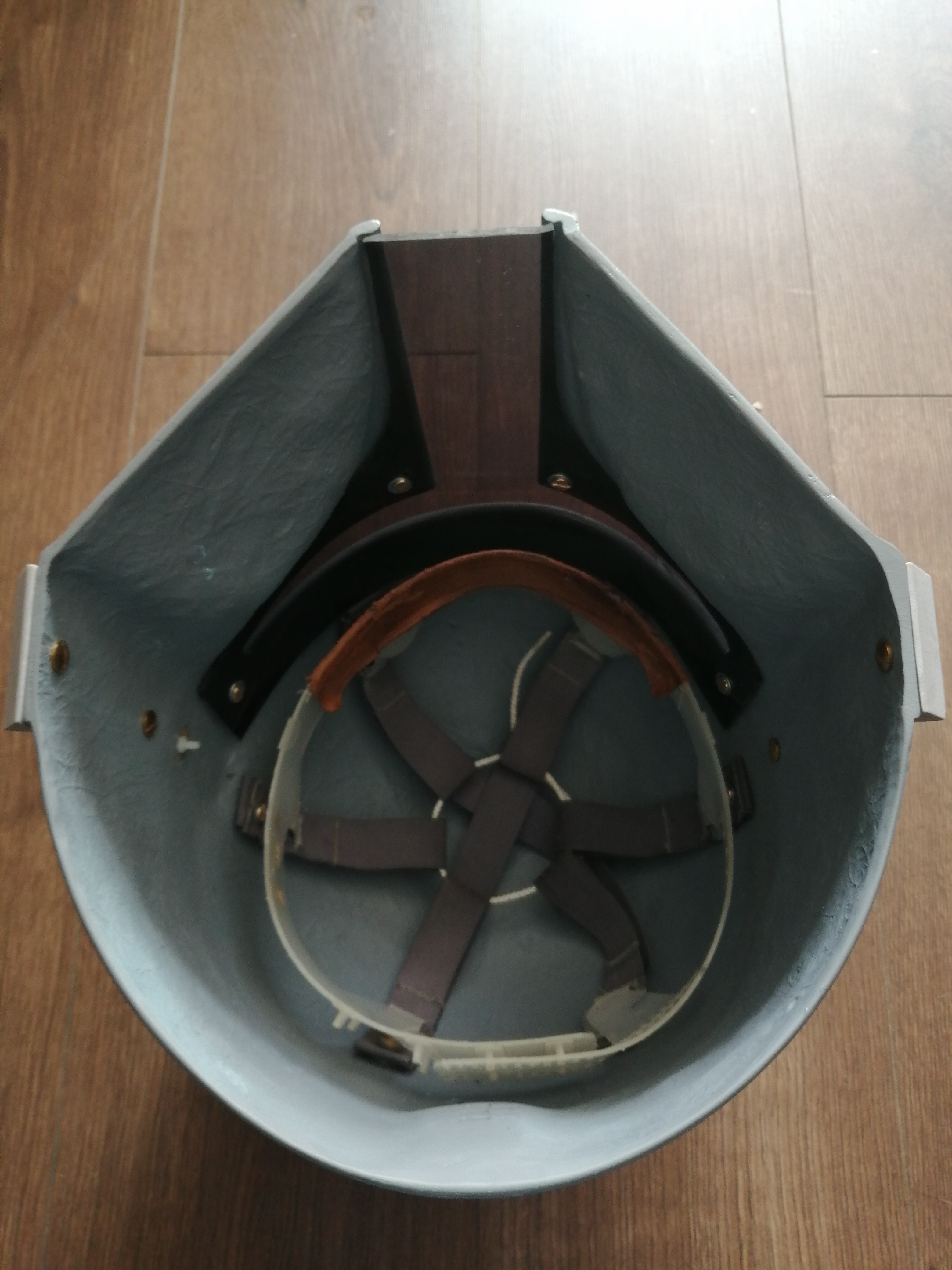

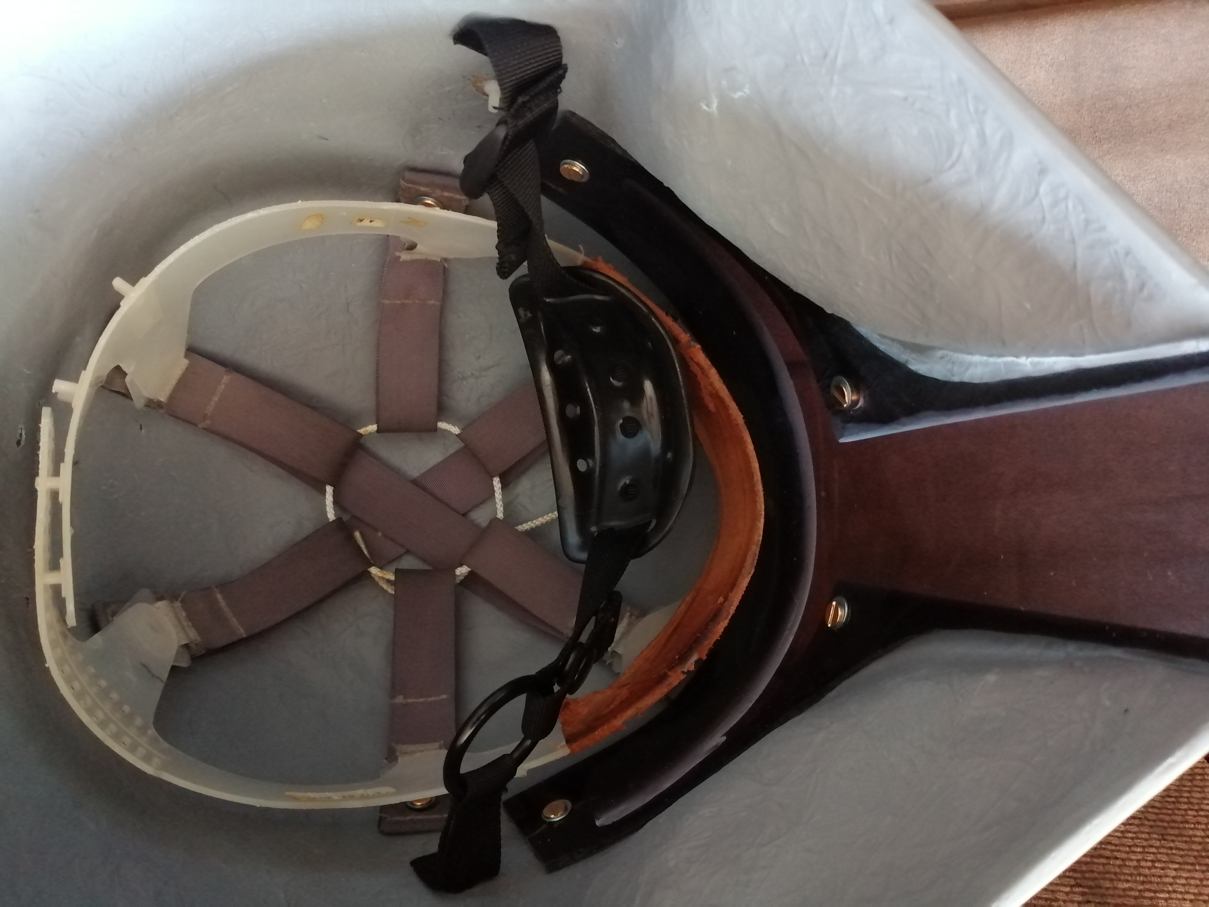

Helmet cradle
Although the new CRL doesn't include a helmet cradle from personal experience and the fact its more comfortable and improves air flow inside the bucket one will be fitted to this helmet.

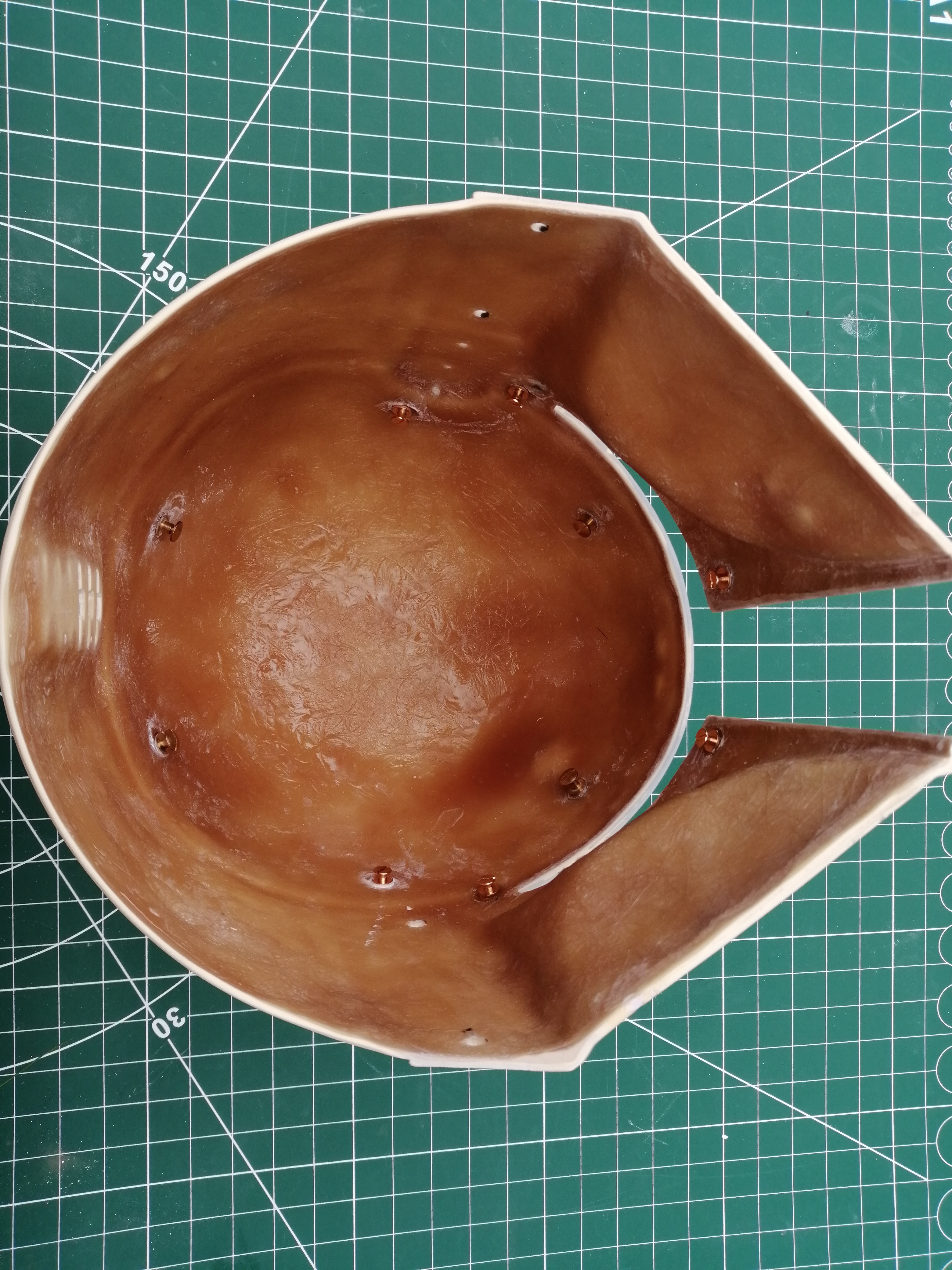

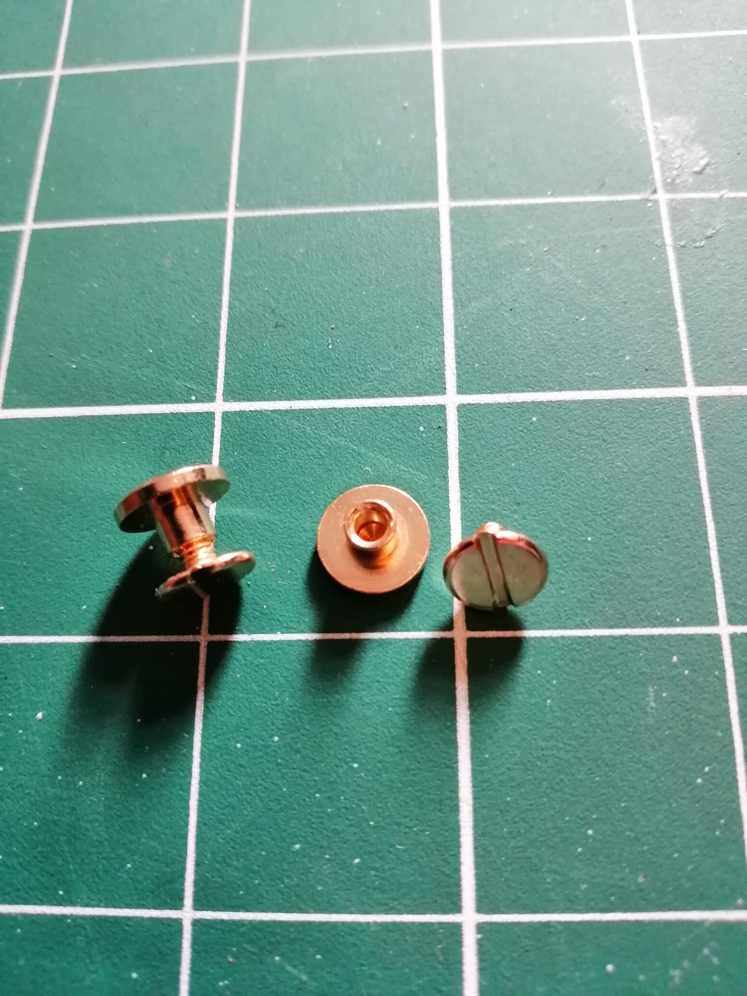

I first ground down the rivet around the helmet that hold the cradle in place. This left the tabs intact to help resecure it in side the bucket.
You can clearly see the tabs which attach to the inside of the helmet, I usually use hot glue but thought Chicago screws mite be an easier option and use the existing holes .
Time to file the key slots out....
Kill Stripe

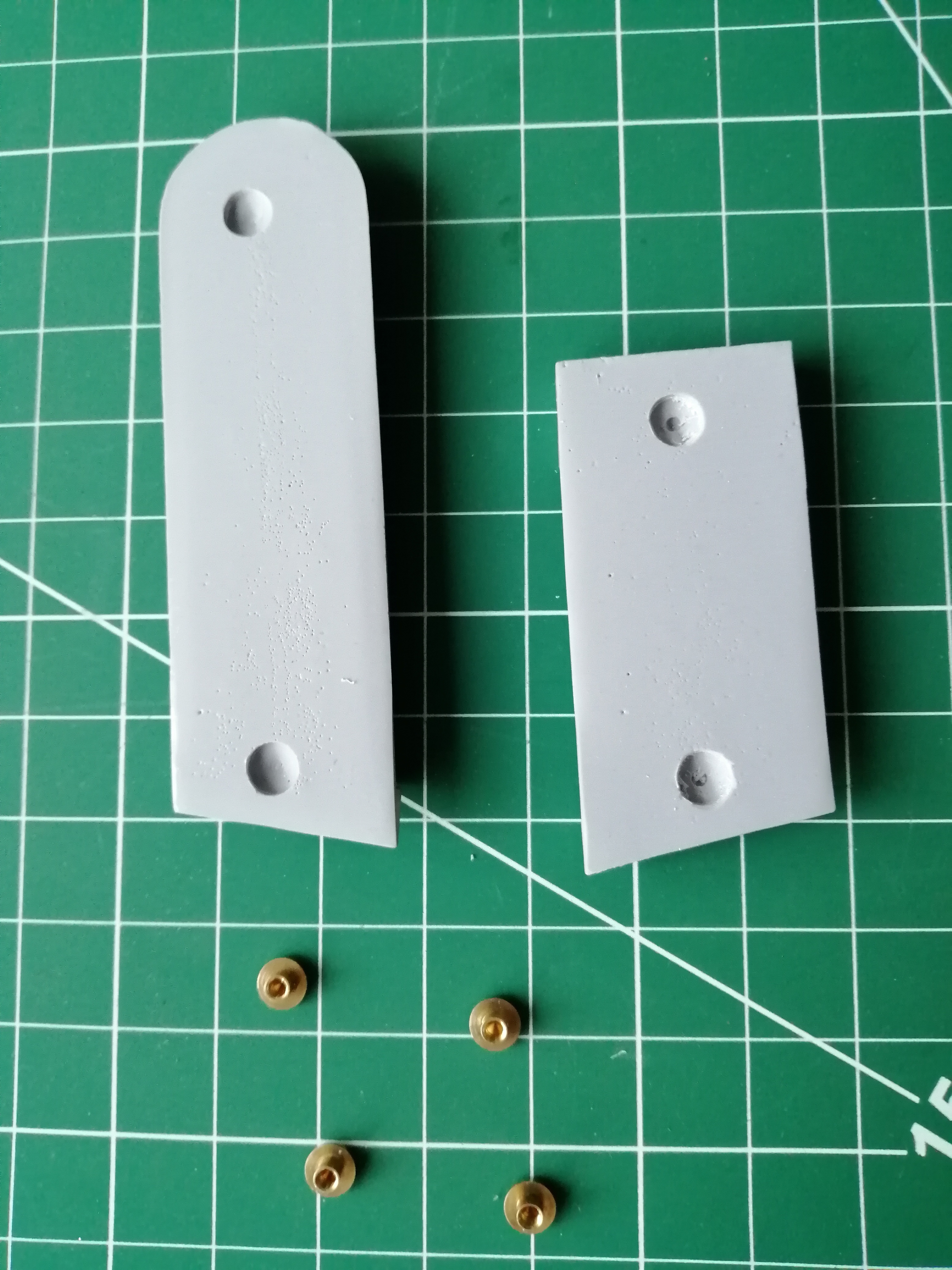

Pilot drilled the ear caps and epoxed chicago screws into the recess

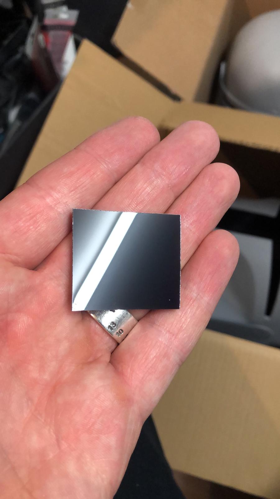

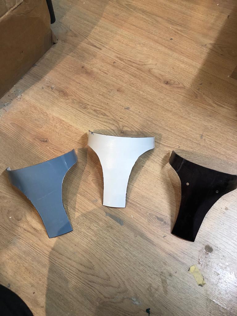

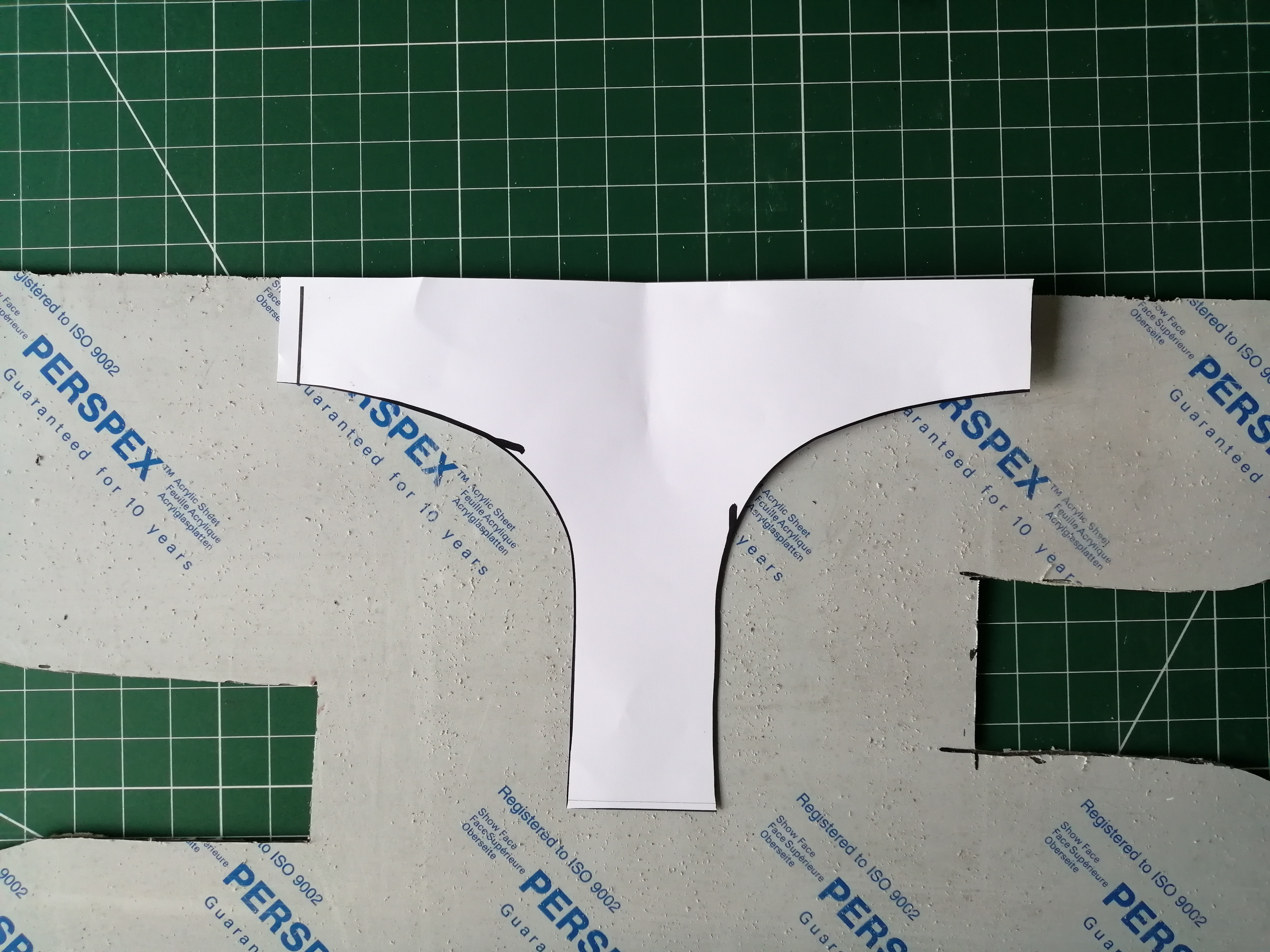

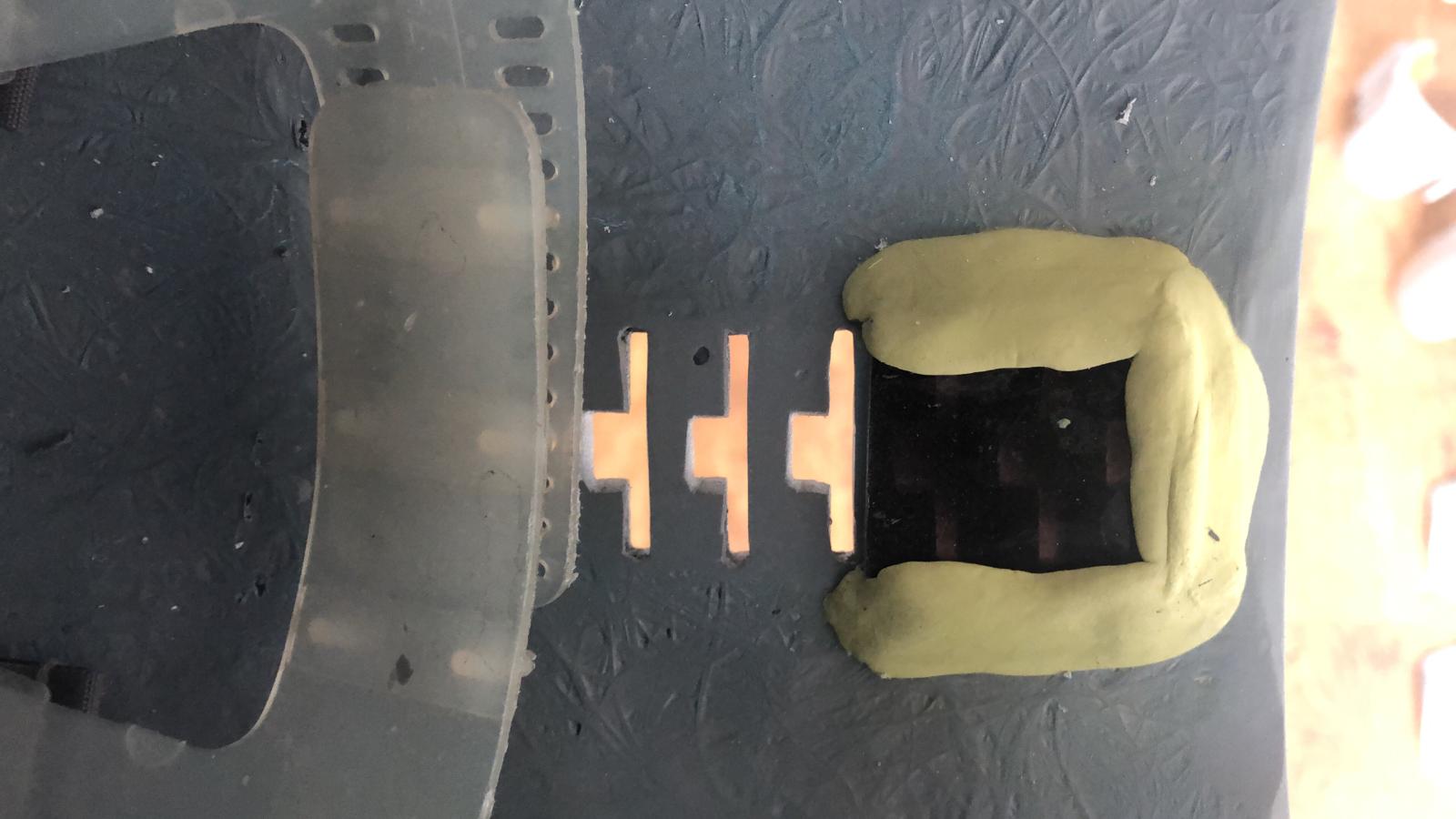

This bucket didn't come with a visor so had to make one.
Heat gun and welding gloves and a bit of patience.
And a small piece for the bottom 3 key slots below the Casio MQ1 circuit board.
Kill Stripe

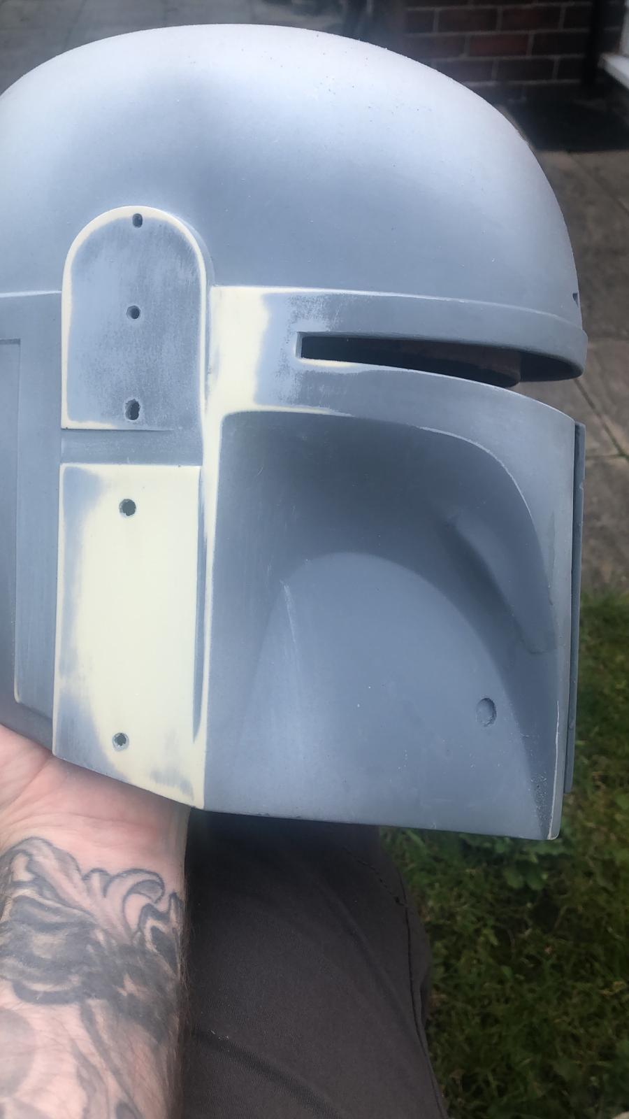

Filed out the key slots and fitted the piece of visor to the bottom 3. It looks a bit bulky atm with the miliput but that will get rubbed down.

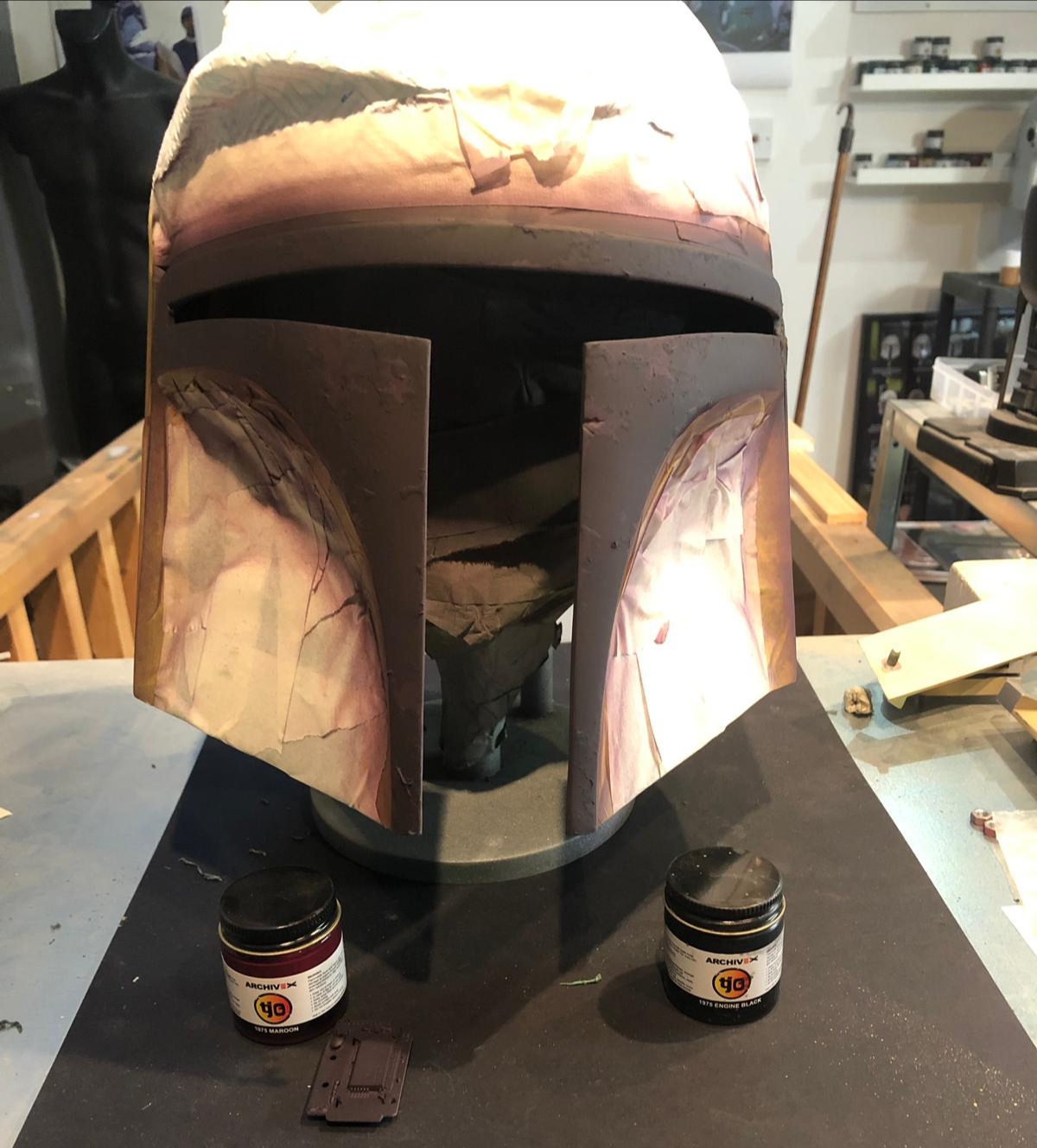

It's a 60 /40 mix of maroon and engine black.

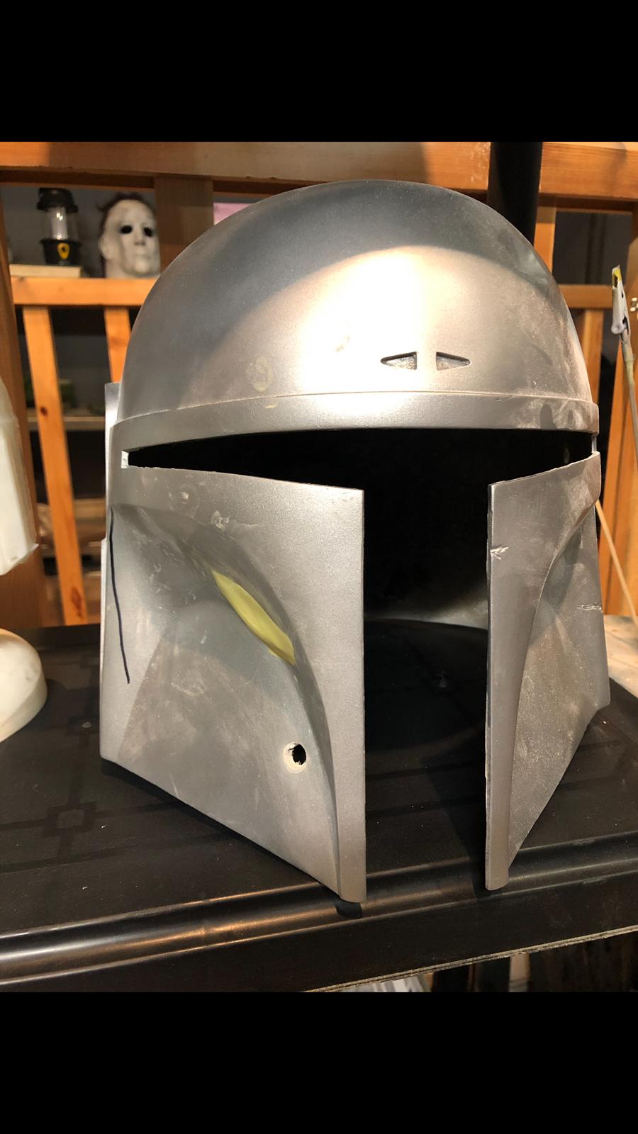

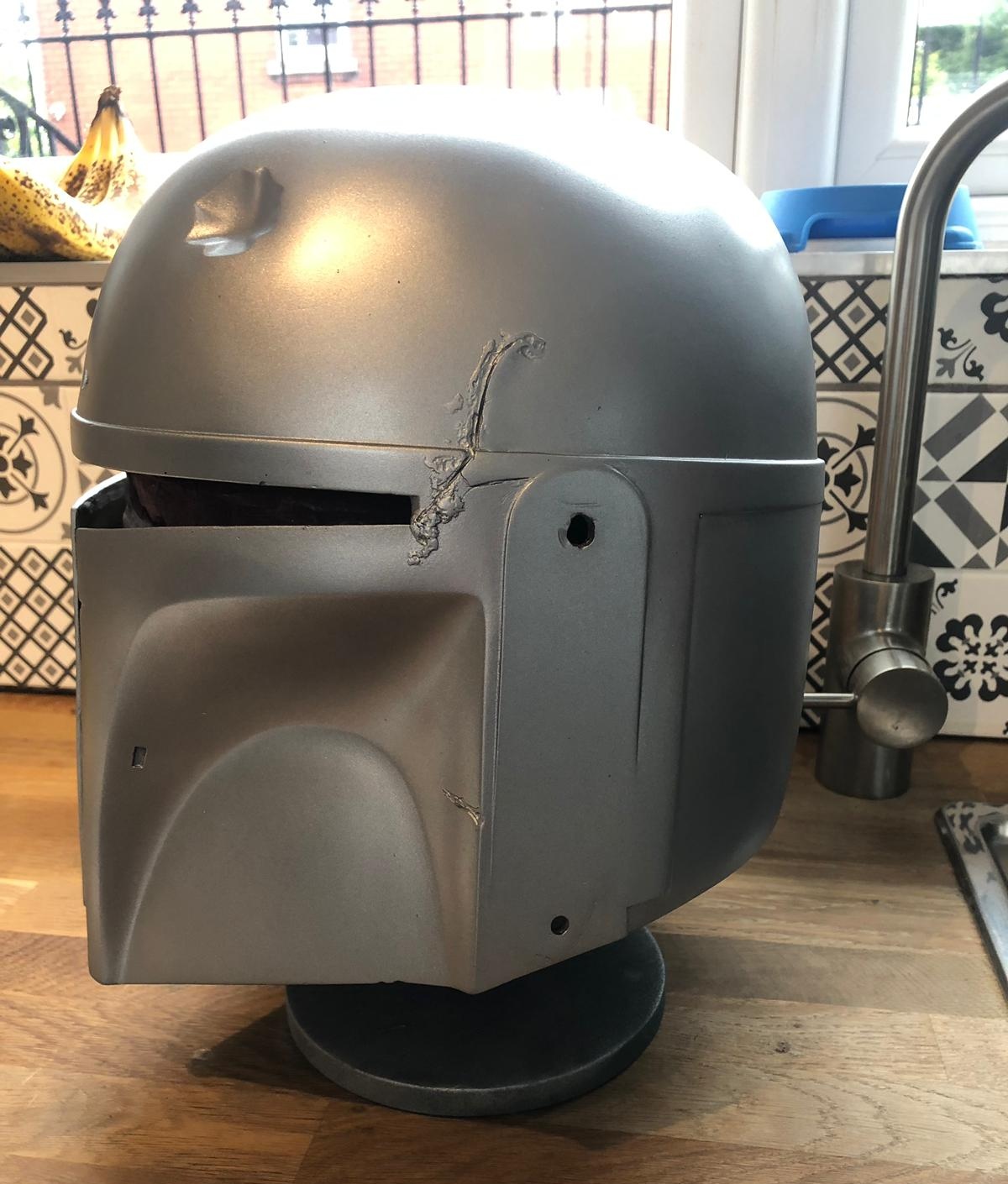

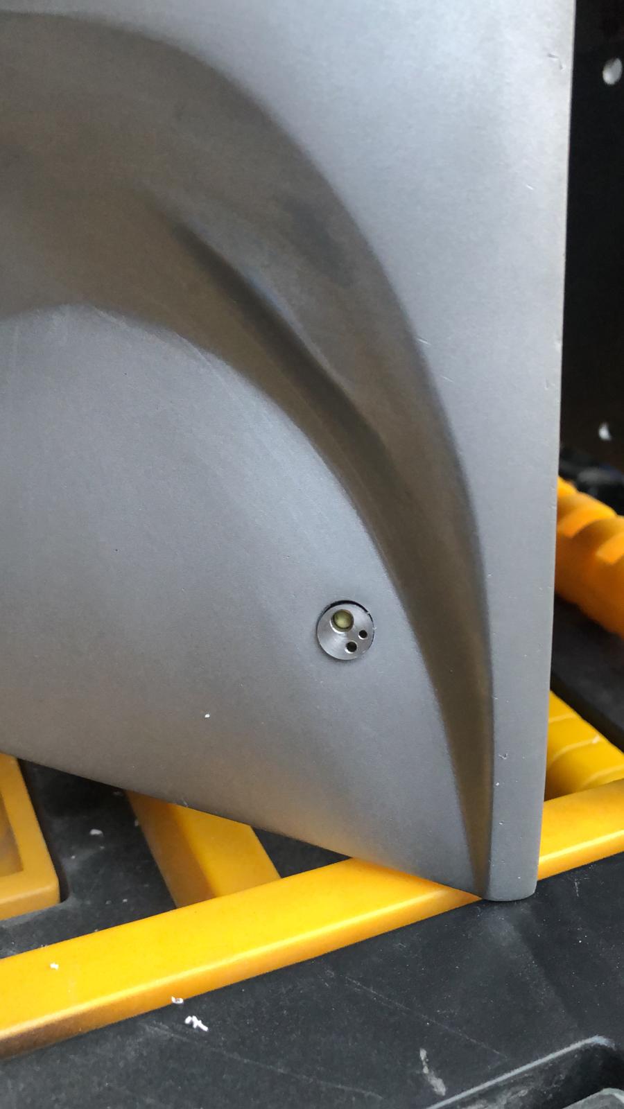

The Bulge
With limited reference material to the bulge sculpting it is is pretty much down to eye and preference. I read a thread on here by fett pride a while back which gave me the inspiration to atempt it on this and a few more recent bucket commissions.
Miliput and primer and a bit of light sanding.
I am quite happy with the end result, it doesn't look as pronounced in the flesh as it does in the images but still achieves the desired effect.

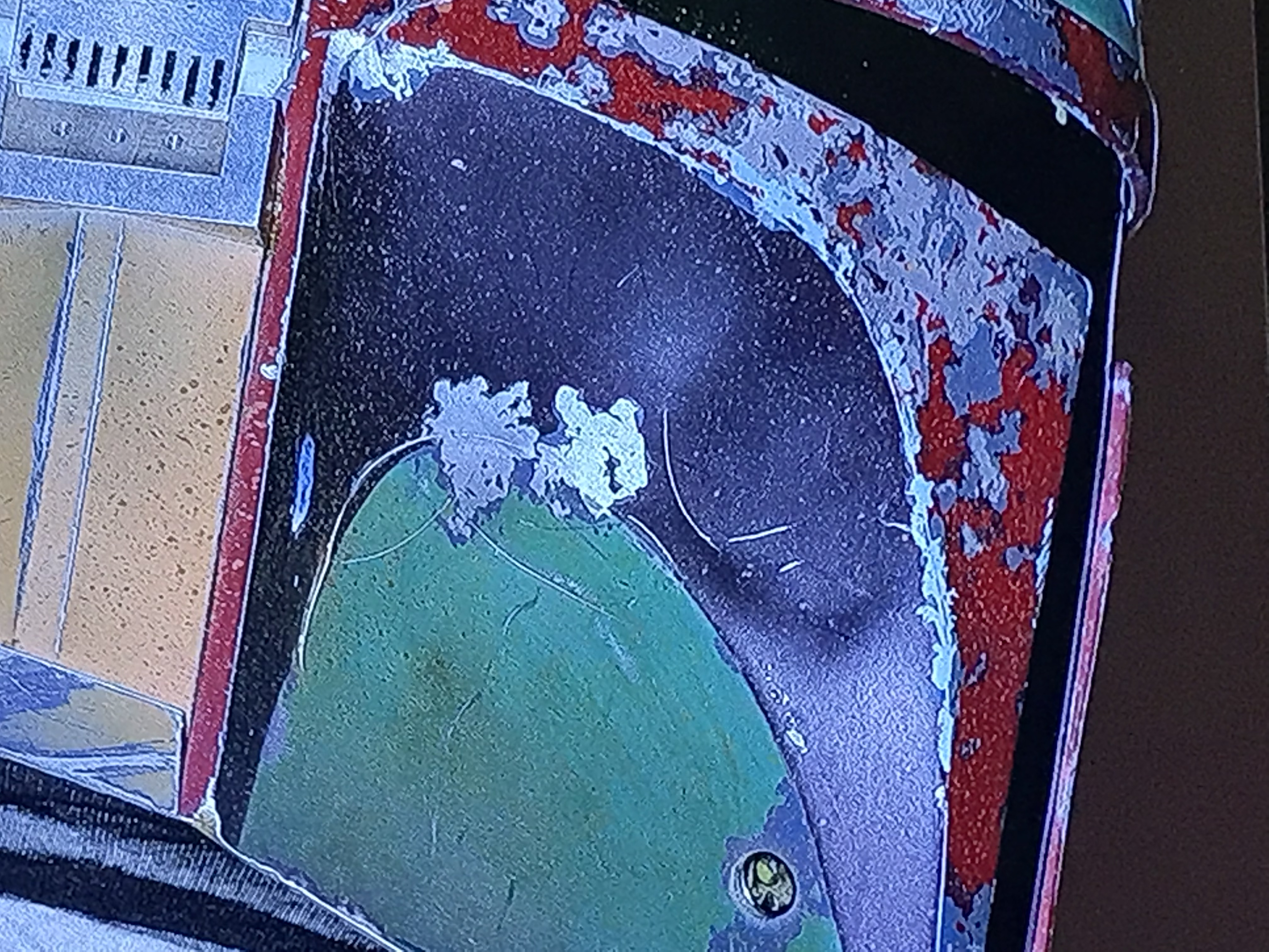

If anybody has anymore detailed images of the screen ESB bulge I would be grateful for the references.
And fitted a metal borden
rubio95
You’ve done a great job in having the bulge looking subtle. However, the ‘crest’ of the bulge is much closer to the lower cheek.
