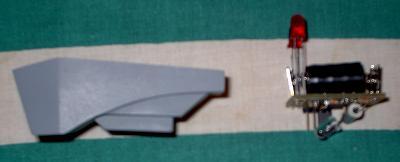

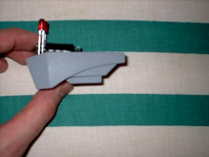

I just got my hollow RFs from BobaMaker today, and sadly, Jim's set up doesn't fit. I'll try experimenting with a few different things to see if I can make it work. Any one have any ideas? Width wise it's fine, but height wise, the tilt switch, bottom LED and jumper pins are all in the way, making the set up too tall. :confused

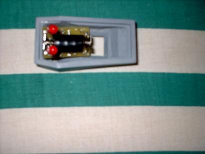

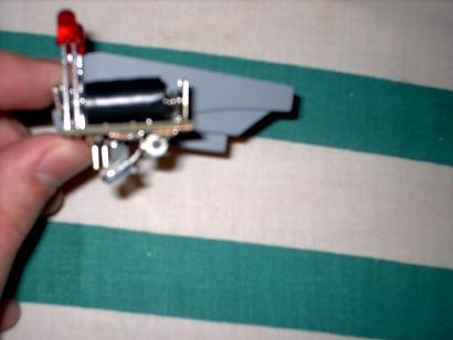

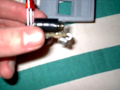

Ok, here are some pics, to give every one an idea. As I mentioned, the components on the bottom of the board make it too tall to fit in the RF, however it still leaves alot of free room to the right side (from looking down on the RF). I've carefully repositioned the tilt switch and the white LED to be further to the right side of the board (as you can see in the last pic), making that side slimmer. The only problem now is that the jumper pins still prevent the board from sitting down all the way in the RF. Later tonight, I am going to try dremelling out a small slot in the bottom of the RF that the jumper pins will slide into, which will hopefully allow the LED board to sit flush in the RF. The next foreseeable problem though is that the Pins that the red LEDs sit on seem to be too tall, meaning the LEDs will not sit low enough in the RF. Need to find a way to shorten these.
