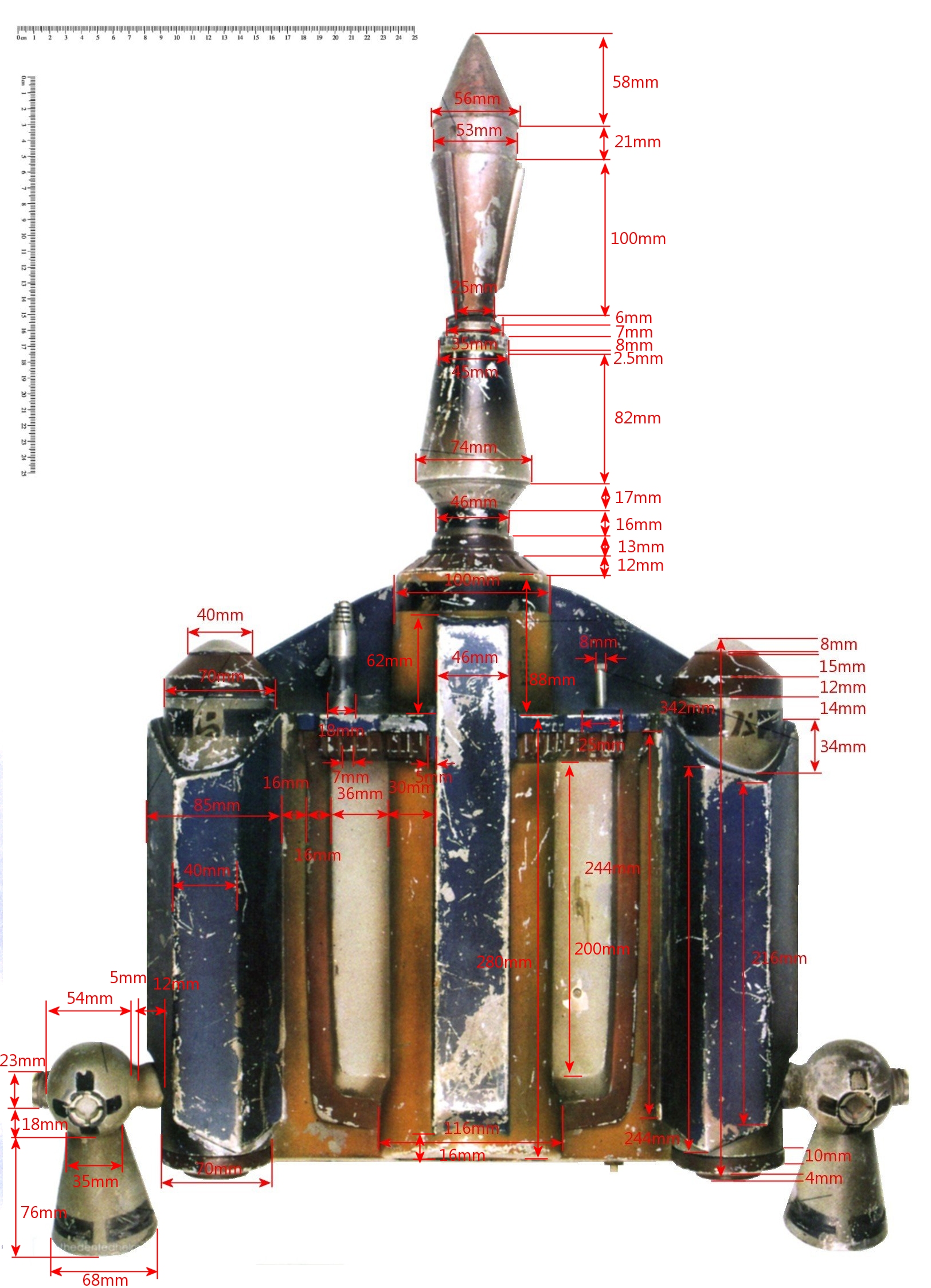

I have some basic measurements of the jetpack, but I will post the image when I'll get back from work.
RobaFett
Only just started the rib so far, going to start doing the sides now, would be good to compare you have come up with as well.:cheers
RafalFett
Here is the image with the ROTJ jetpack and some measurements:
I suggest to not rely only on these measurements as I'm not sure if all the values are correct.

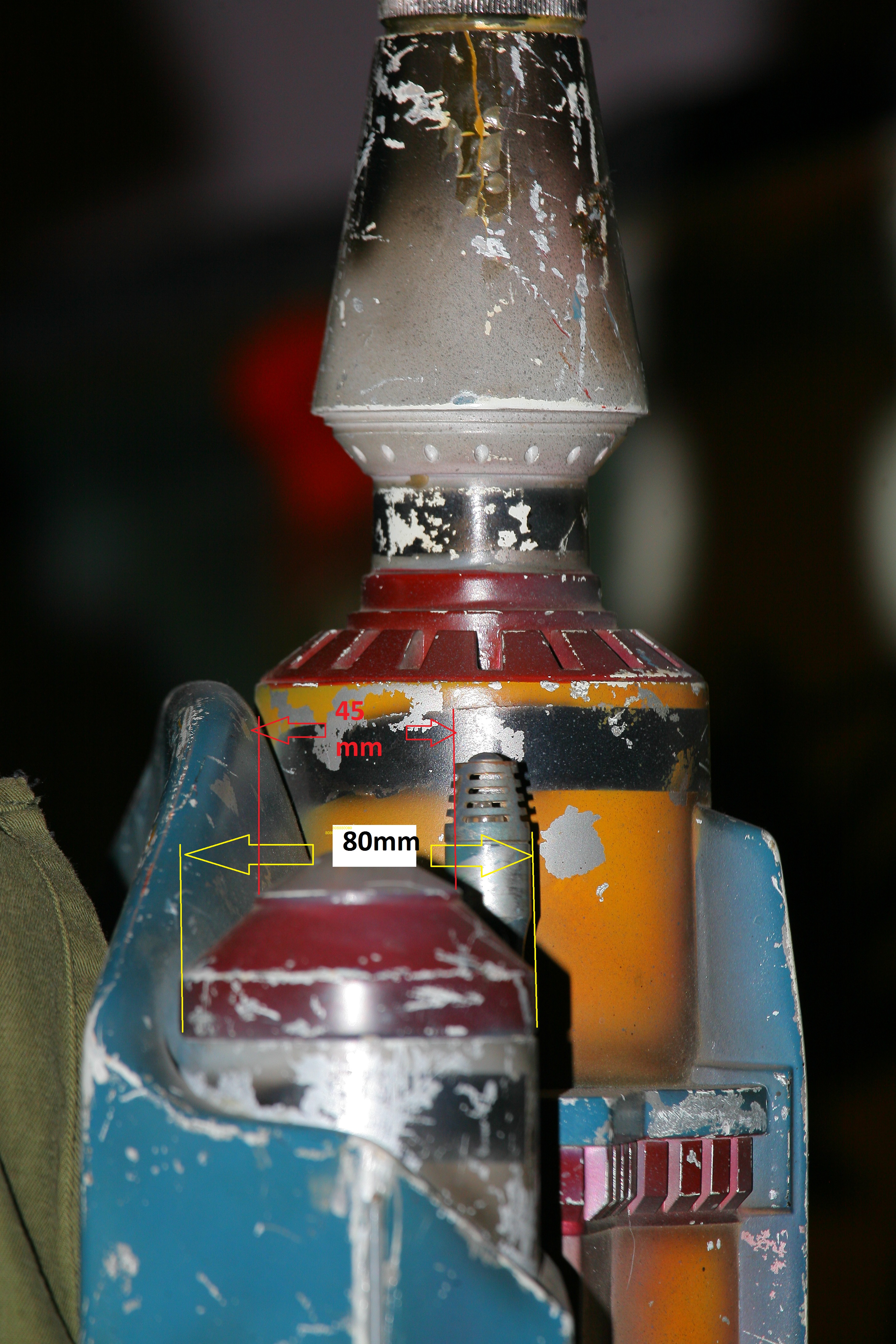

RobaFett
Ok this is what I have come up with the fuel cell cap, a lot of your measurements seem pretty spot on, cause I have already cut up the templates in cardboard ready for the foamex, I am a slow worker but will provide some progress, forgot to add to the pic the centre top of the cap diameter which I think is 15mm from what I get, sorry if my comp skills are not good with paint edit, and by the way Raf cheers for such a quick result , once again awesome effort!

Thanks for your confidence! Some of the measurements were taken from the ROTJ jetpack images from the Gallery ==> Boba Fett Return of the Jedi Jetpack - Heilman Images.
I verified the measurement you posted and it is correct! I'll have to re-do my measurements and double check it to not allow any major errors. Thanks for the heads-up!

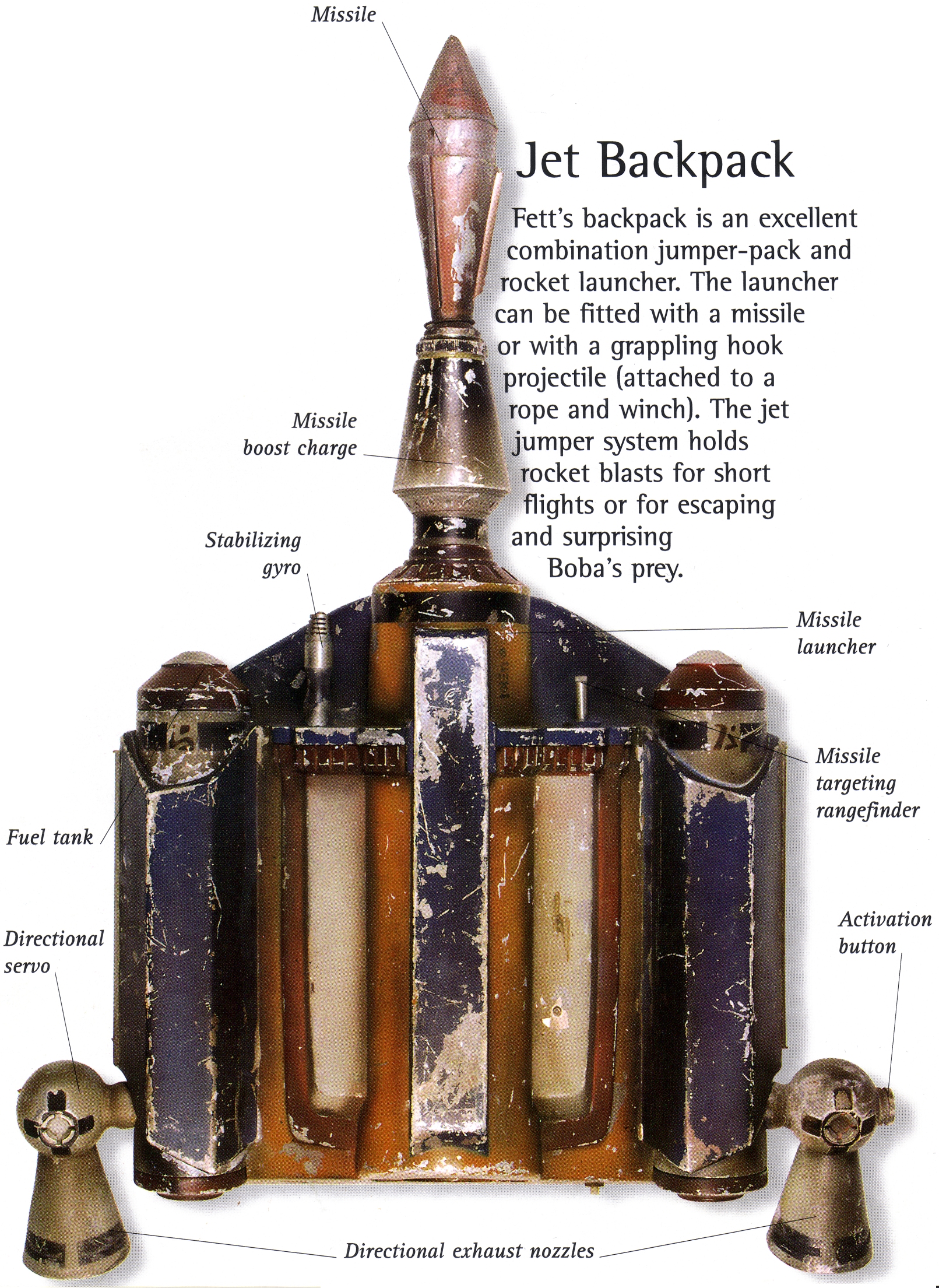

ASESOVRATES
It would really help me lot if someone could provide a detailed diagram as far as what part is what on the pack as well as plans for the entire pack. the plans and diagrams that i have found for small portions of it have been great but i need more.
