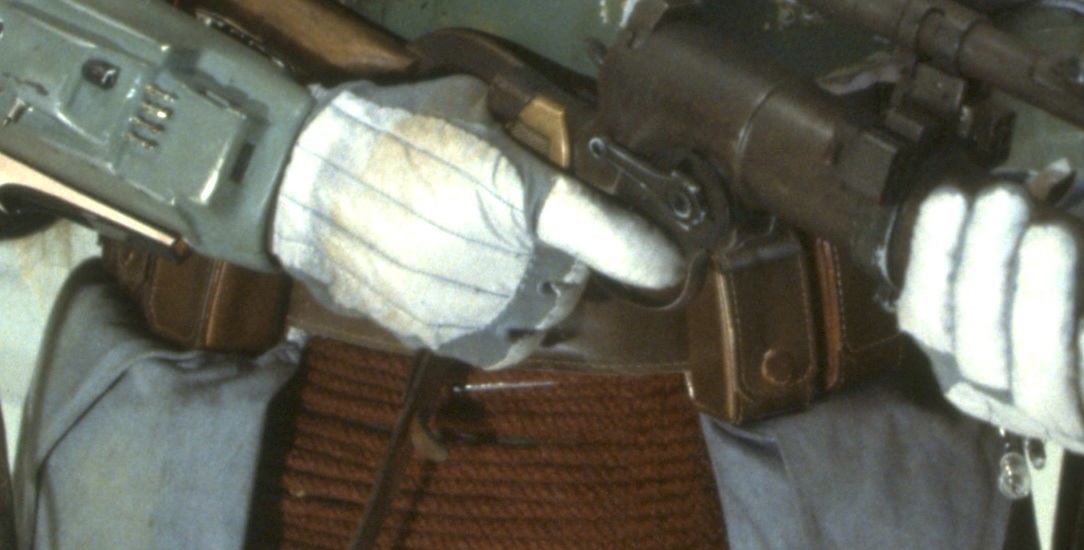

I was asked to make ESB belt, and client pointed out that 501'st CRL says: "There are snaps on the 2nd and 4th pouches (from left to right)." So 2 snaps, not 3 as was requested before. So I have question, does anything new came out that confirm that belt shood have only two snaps?
Thanks,
Mike
Think this is it here.....I've only ever used 2
The CRLs are correct as far as I can see. I even looked at the gallery to to confirm and everything I can see is 2 snaps.
At this picture the 6'th pouch that snap is suppose to be is hidden. But true, you are right guys, I looked thru gallery and 5'th and 6'th are no snpas. Jet on non of pictures I coud see last one, it is hidden under cloak on every picture. Still we can hold to two.
Thank you both :)
Mike

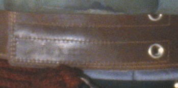

One additionnal thing i would change is that the rectangular stichings at the back of the belt should not share the same stich line than the edge stiching. I do believe your belts do not have this double stiching look:
