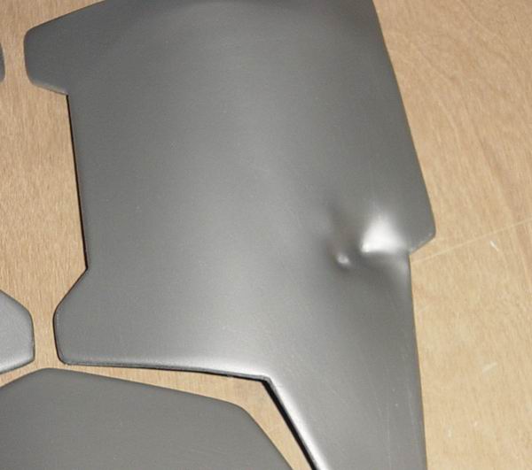

Prymer13
Here is some on my armor. It is only two coats, and I am putting a third on, THEN buffing, but it gives you an idea. I can post "buffed" pics tonight.
E2K13
If Darren buffs that a bit more, it will come out with a high sheen.

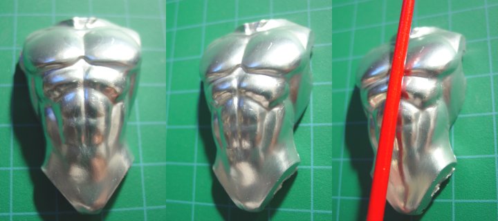

Here is a picture of a test card someone did with various Model Masters buffing Metalizers to compare the sheen buffed and not buffed.
E2K13
THis pic shows a figure painted with the aluminum plate and buffed on one side to show the sheen after buffing:

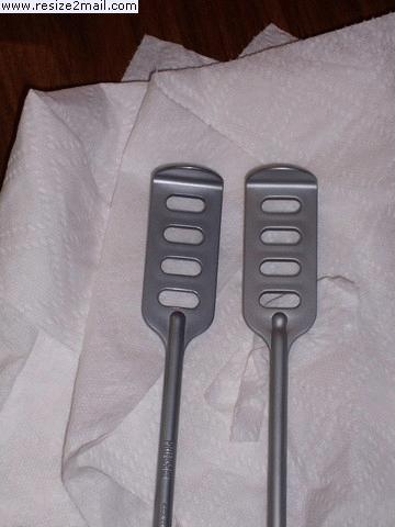

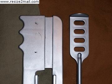

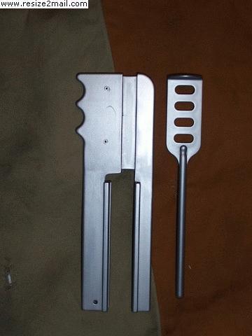

Here are my shin tools painted and then buffed with the metalizer. I need to put on the top coat but I started with a black primer and I took a paper towel to smooth out the primer after it was dry. THen sprayed the MEtalizer and let it dry between coats. I applied only 2 coats though. Then After they were dry I buffed them with the paper towel and finished the buffing with a cotton ball.

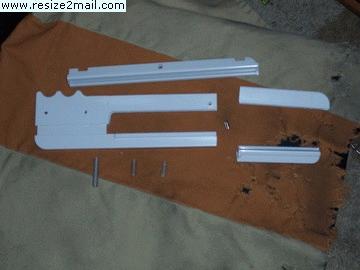

Here is the squeegee before paint as well as the stir stick comparison of the Buffed and top coat on left with just sprayed and not buffed on right.
