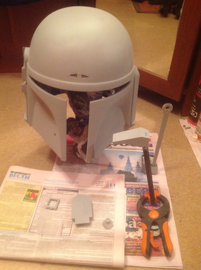

So I had painted my armor and bucket with primer and then the metal coat. Both seemed fine at this point and everything looked smooth, however, after adding my base coat after masking with liquid latex, the melmet had these "cracks" where I could very clearly see the silver underneath.
Today I sanded the helmet down, scuffed it up but didnt go all the way down to base material. Put on the primer and within 5 minutes when it started drying (automobile primer) the cracks showed up again.
I am using Rustoleum automobile primer, andn rustoleum spray paints.
Does anyone have any suggestions for paints for this not to occur and how can I salvage the helmet.
Thank You.

You primered over silver...and didn't clean it properly...I can see silver in all of those cracks. Take some laquer thinner and a bunch of rags and clean it all off....start from scratch
I've used that exact primer , on most of my armor actually. I applied very light coats and it worked great. Never had primer crack on me, so I'm surprised how bad it happened on your bucket. Hope you can get it off

Aww man, had the same thing happen to me when I painted my first Fett bucket... and it was the second to last step on the dome :facepalm
Only exception was mine was the black layer, which I used primer instead of just flat black paint. Same crackly result... damn shame.
Good luck!
Is that safe for the resin in the helmet? I dont want to damage it.
It'll be fine as long as you dont soak it in thinner. F4R is spot on. Dirty/ contaminated surface. Probably overspray from another project or sanding dust?
