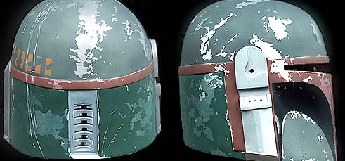

Here´s a little progress.
I painted the cheeks and added the brigther red and grey for the additional scratches. I look forward to give the helmet a wash as it is a tad to sharp at the moment. The wash will hopefully bring it all together:)
Next will be the rear..

Just a note. I've painted the rear now, but i soon found out that the Tamiya racing green were to bright and warm. My original plan was to mist the Humbrol enamel 88 on top in order to get the color perfect, but that simply was not enough, so i repainted the whole rear with the Humbrol enamel 88 which is slightly a more colder color. Now it looks spot on (to me atleast)! So please note that i've removed the racing green completely from the list.
This is how i did the rear:
I misted some grey primer, silver and black and masked of the scratched area before i painted the green color on top and removed the masking liquid. If you dont know what i talk about, check out the rear on the ROTJ helmet. It has the same type of scratches there.
These are the things left on the paintjob:
-Mist the earcaps, stalk with brown and black and gently sand the corners in order to get a weathered look.
-Paint the killstripes
-Paint the keyholes
-Add additional fine scratches with a needle
-fix some of the scratches as they dont line up as good as some of the others.

Just wanted to show the progress. I've painted the rear and scraped in some new finer scratches with a needle. I'll add some better closeups soon.
