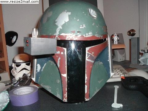

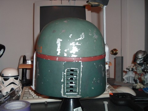

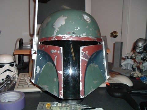

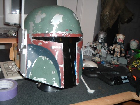

Ask and yee shall recieve (any excuse to show off my stuff). Here is my pre-pro2 helmet in all of it's glory. It is a MSH2. The first couple of pics don't have the visor installed only held in by tape the full costume pic is it completed. The first ones were taken indoors with a flash and some of the details are washed out and the colors look a little different in person. The last pic was taken indoors with a flash (I think) and under a bunch of different color lights which is why it looks so blue on top.

I love the full shot! The helmet looks awesome. Our colors are very alike.
How did you paint it? And the ever so famous question. How did you install teh visor? My Visor is taped in at the moment. Not the best method:/

I painted it using the mustard method, meaning I painted the silver base coat then masked off the scratches with mustard, let it dry, painted the colors over it, then scratched off the mustard, then did some washes. All the colors including the kill stripes were hand painted, that is why they look a little different then everyone else's helmets that are painted with the same colors but airbrushed. My visor is held in with hi-temp hot glue and plastic weld (a 2 part epoxy that makes plastic). The hot glue alone wouldn't hold the visor in on its own but a little bit of plastic weld goes a long way.
In real life my colors are somewhere in between the 2 pics, they aren't quite as dark as the full shot but no where near as bright as the helmet only pics. I think they are closer to the full shot.
Oh and the black smudges around some of the scratches were done by hand, and I mean with my hands. I put a little bit of a greyish black on my fingers and wiped most of it off on a towel and then smudged it on the helmet where I needed it.

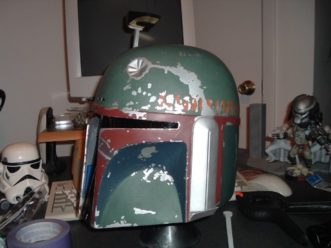

The helmet has been spraypainted silver and all the scratches are drawn on with a pencil. First coat of color soon:) Stay tuned!
