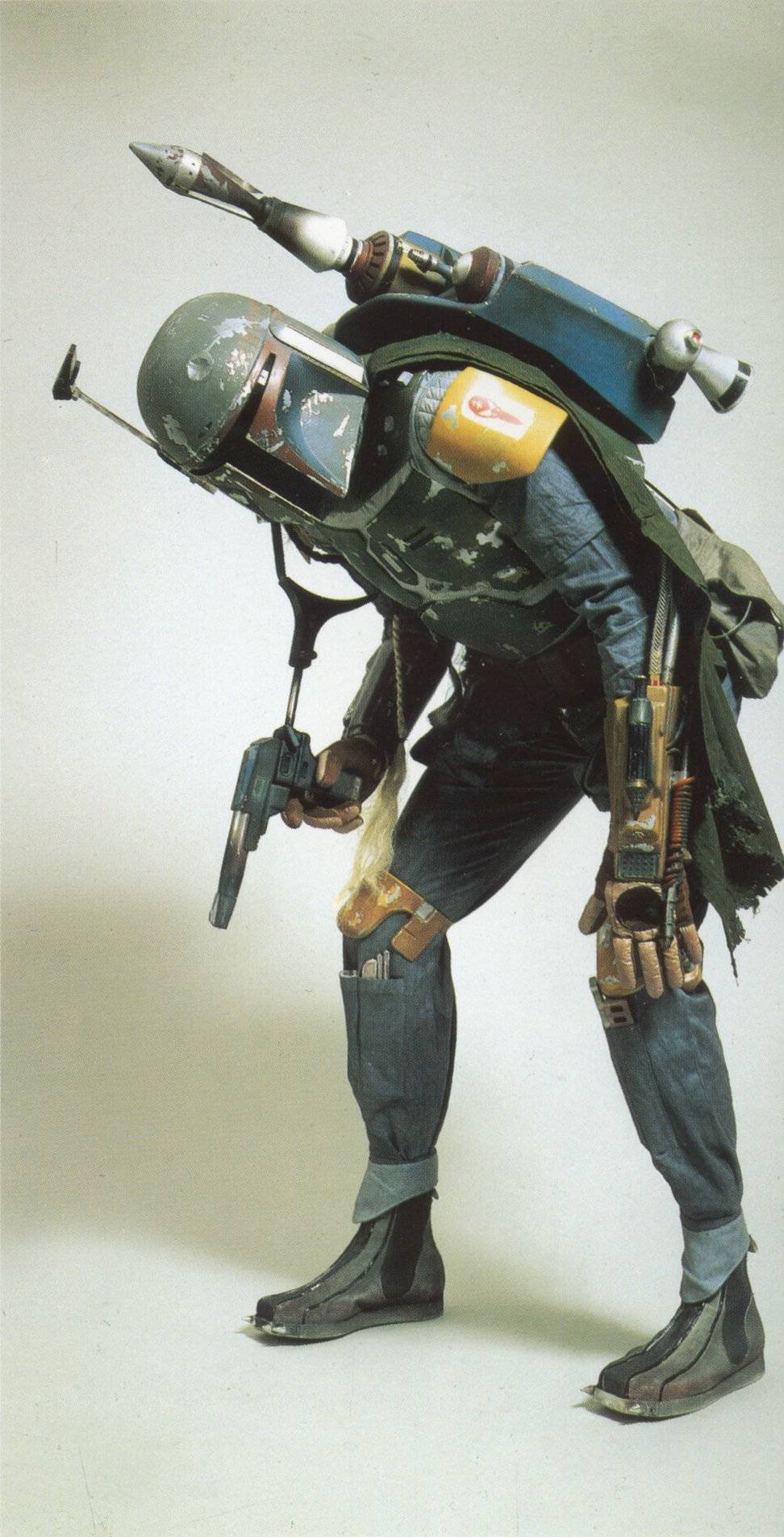

in the good ol' days Star Wars Chronicles was THE definative souce for costumes especially Boba Fett. There are a great deal of pictures of the making of the costume and putting it on the model/actor before Jeremy. I've actually only seen the book once. It's quite expensive, for a book.
This is a pic from the Chronicles:

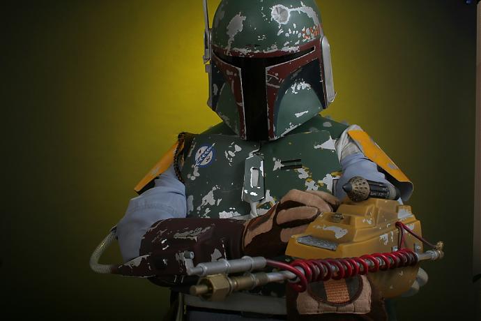

Yea I am the one that did this version of the costume. I can't take credit for the gauntlets though. Ruffkin custom made them fore me. And they rock the casba.
But I will mention that I am working on an all metal version of the brass end of it. Ruffkin told me what he used to make his master and I am working on building one.
Ruffkin's an awesome guy. How stable is the flamethrower? The Pre-Pro flamethrower has always scared me :facepalm My ESB flamethrower scares me, haha.
The tube it's self is all metal and it is rivited on so it is pretty stable. I walk around with it in it's "closed or retracted position" because it it metal it does actually slide in and out. The tip is resin and I did manage to break it on the drive from the hotel to braks's house at dragon con and several other times through the weekend at dragon. That is why I am making a metal tip.
Wow, predatormv that flame unit looks wicked. It's huge! My ESB flamethrower worries me constantly at events. It's made from resin and broke once at a Con, if I remember correctly a few other things got broken off at that event as well. I was thinking of maybe using a metal tube and then a hose attachment at the end. Maybe I should try and find something that is telascopic, for the tube.
I'm in the early stages of making my Pre-Pro Fett. After looking at the yellow gauntlet, I have a few questions about it. Of the two hoses on the gauntlet, one looks like a metal braided line like the type you would see in hi-performance autos. The other looks like a hose that goes on a sink sprayer. Are they different, or are they both the same?
Yea I am pretty sure they are the same hose. At one point they are taped together (and one stops) with foil tape. There is a small red wire running in the longer of the two hoses, and they don't go into his sleeves like all of the other suits, they run into this back armor. The red wire most likley runs from there into his jet pack. On the original suit lots of little things worked and that wire probally has something to do with the flamethrower opening and closing or something.
