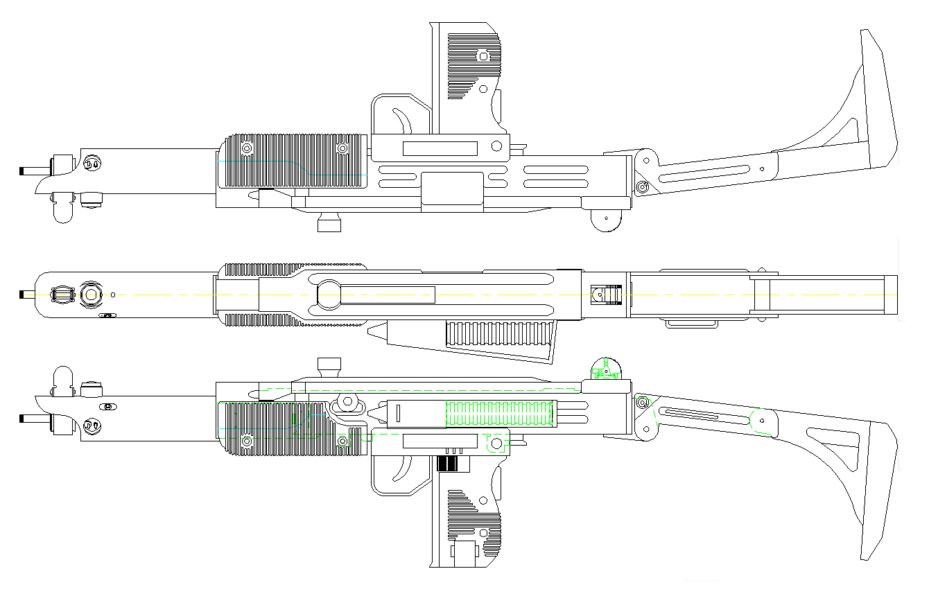

Hello,
Recently on StarWars.com they posted an article on the original Boba Fett concept in which Boba is deck out from head to toe in white. Also over on the RPF there was a thread that had pictures of the original Fett blaster rifle. Between the two there was sufficient information to draw up a set of blueprints. And since I had already done the Sling gun I needed to complete the set.
So here is the first draft. Take a look and let me know what you think.
Alan
Fantastic Alan, but in the photo it looks like the Graflex has wiper blade grips just like Anakin's saber given to Luke in EpIV. It looks like the whole thing was painted black in the old photo of the gun.

Whoa those photos you've linked are sick! That original gun looks like what you've drawn, but you're right in that photo the Graflex has turned 90 degrees. Nice work Alan.

Alan,
The stock on the blaster in the pics looks to be a one piece. Maybe a resin copy with the some of the details gone and the hollowed out section at the buttstock filled in.
The stock you have on your blueprints are too good and represent the stock on a real UZI! :)
Otherwise an awesome start!!!! :thumbsup: :thumbsup:

Thanks guys glad you like them.
Whoa!! Great job on that! How long did that take for you to draw?!
This was an easy one by comparison, I have blueprints for the Graflex and I found some UZI rieciver blueprints online and I picked up a toy UZI Mini at Party City, it was just a matter of tracing the blueprints and taking measurements from the toy and 5 to 6 hours later this is what I came up with. I am still working on them and I still need to create a few more views.

The actual prop is defintiely a casting as you noted the stock is a solid chunk or resin. I liked the idea of the folding stock to that is what I treid to depic.
The blaster uses an older style Graflex, not the same as the ones used for Luke's lightsaber.
-The "glass eye" hole is empty.
- The button is completely different. It looks like the tapping button from a telegraph.
The box on the side with the silver tip is only on the left side of the gun.
That long box is not rectangular- it's twice as tall in the back than it is in the front. It's really a complicated piece.
Thank you for the feedback. I'll have to see if I can find a pic of the old Graflex. I have gone back to the reference pics and now that you have pointed it out I can see that the "box" does indeed have a slope to it. it is difficult to see in the pics but it's there.
I update the drawings Thanks!!
Alan

I have updated the drawing in the first post based on lonepigeon feedback, Thank you. I still need to update the Graflex, but I need to find a reference pic.
If anyone has any pics that they can share of this piece please send them my way, wizardofflight@comcast.net I want to make sure it is as close as possible to the real deal.
Alan
It sure looks that way in the reference pics, so I snag the one off my JP drawings and it fit right in to place. I am beginning to suspect that the stabilizer was some kind of rheostat or a rotary switch. Maybe someboby will figure out that mystery some day.
