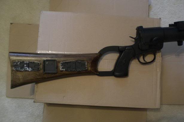

This is how I did my stock....I got some spray woodstain but it pooled too much.
Instead I have used hobby revell paint...the colours I used are below.

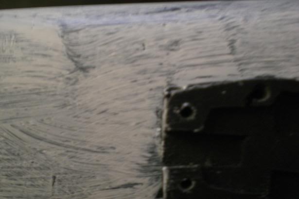

1)...same as others, paint the stock white with long strokes allowing some of the undercolour to show through.
2) I then used a 'stone' colour (revell 16# 'sandy yellow' matt) brushed lightly over the stock and thinly so you can still see the light colour underneth. (sorry I have no photo of this).

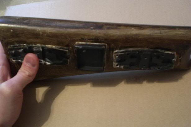

3) After the undercoat has become tacky I brushed on the mix of the three paints seen below (39# dark green matt, 153# insignia red, 73# some kind of mat dark red) I brushed this on in the same way but making sure that the undercoat could still be seen through the overcoat.
4) TIP: If you use a brush similar to mine brushing repetitively it looks as though through over use the varnish has been rubbedaway showing the natural wood colour...I thought It looked rather effective.....

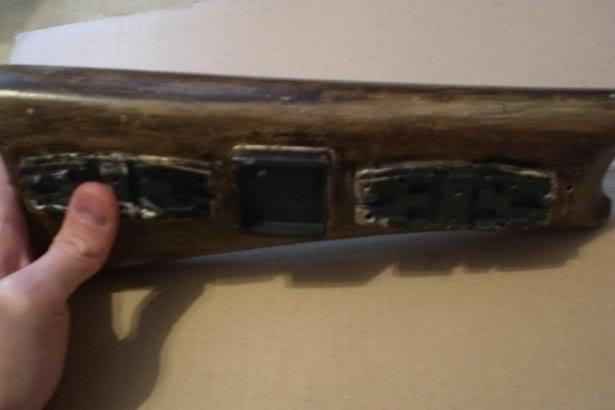

5) I will finish it off with some clear spray varnish.
Hope that was clear. Sorry the last photo is so bad, there is too much shine on it. I have been told by a 2nd world war veteran that it looks very similar to the stock of his rifle he used!!...Though i might darken it a bit.
