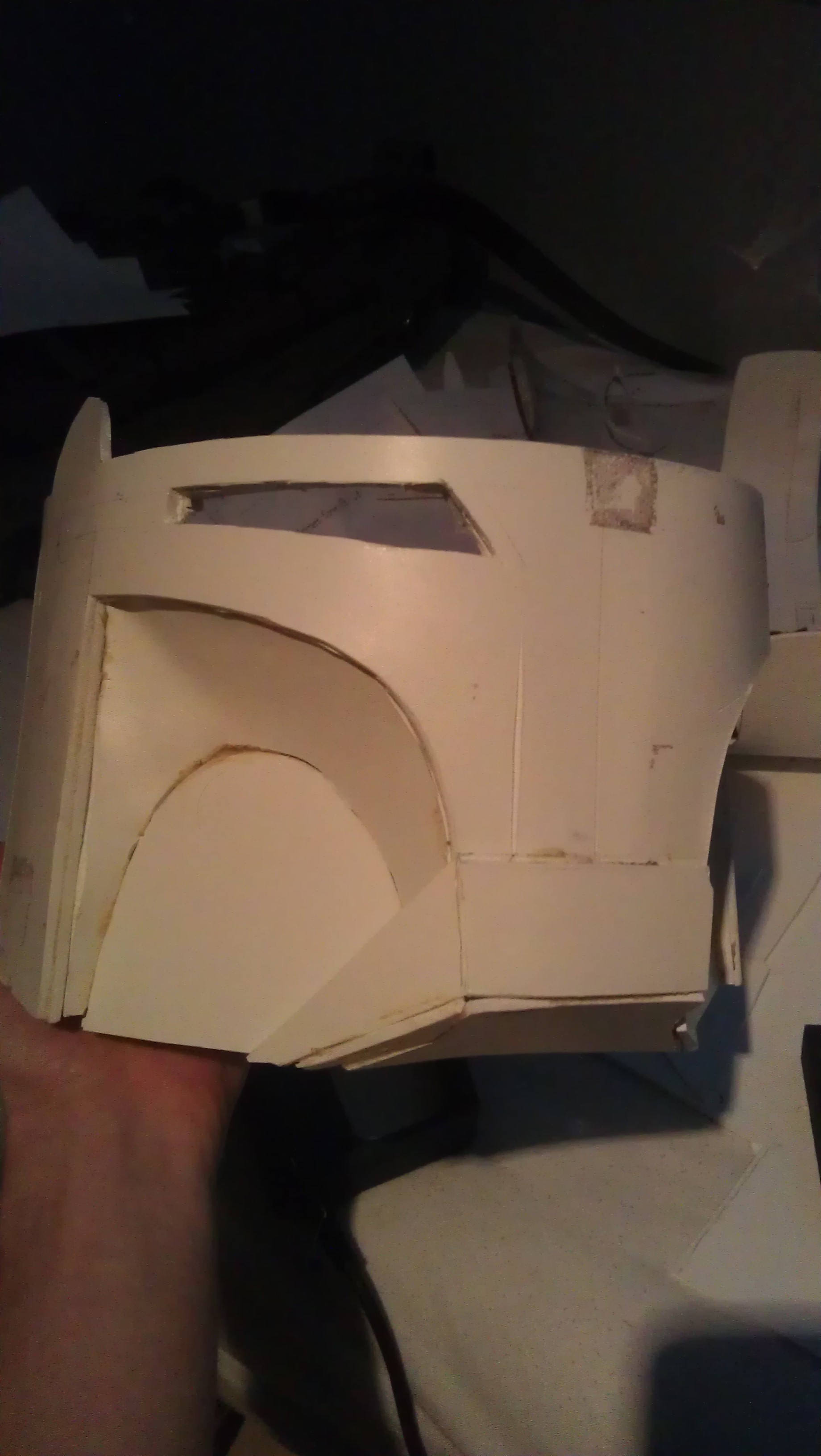

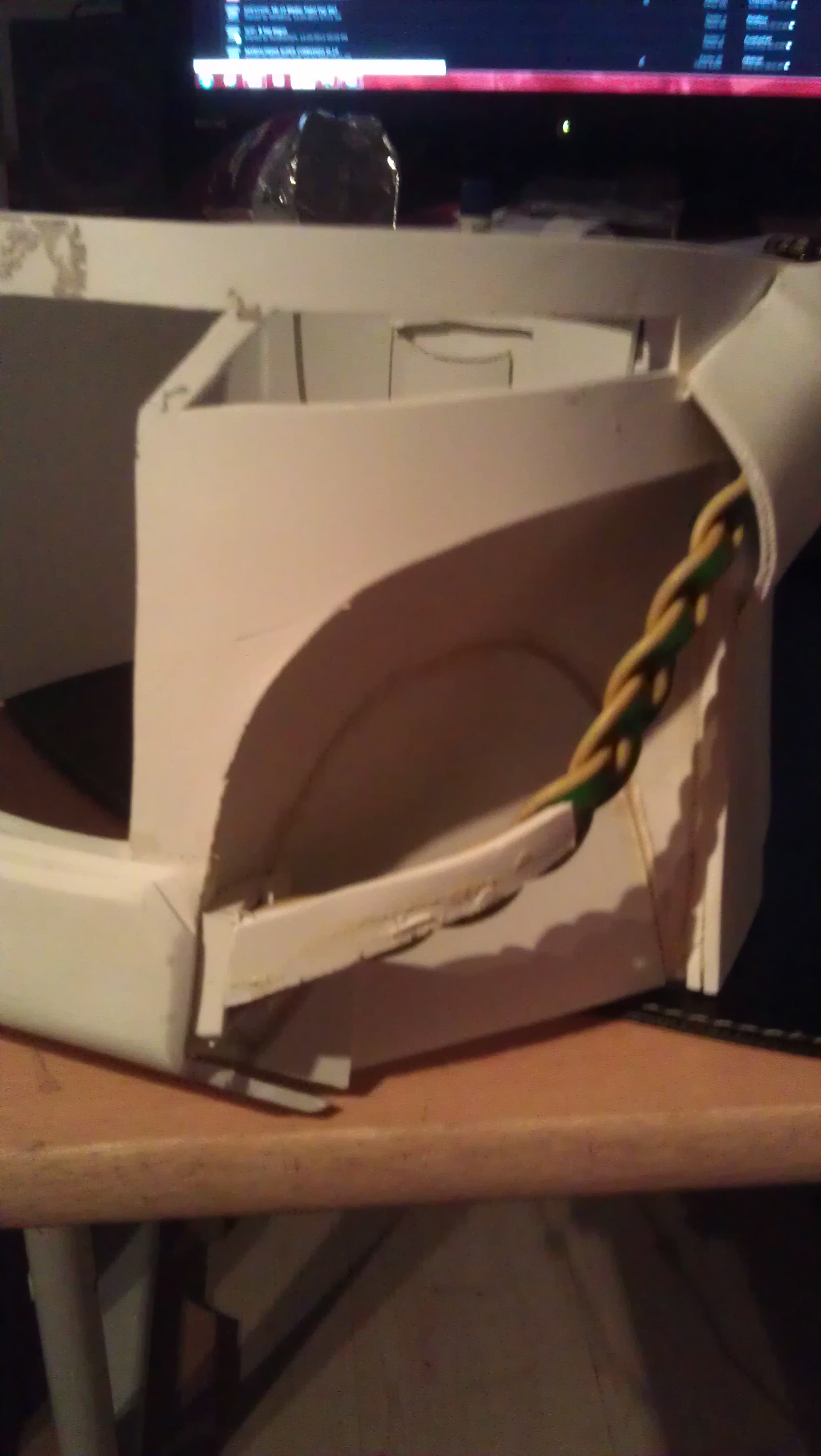

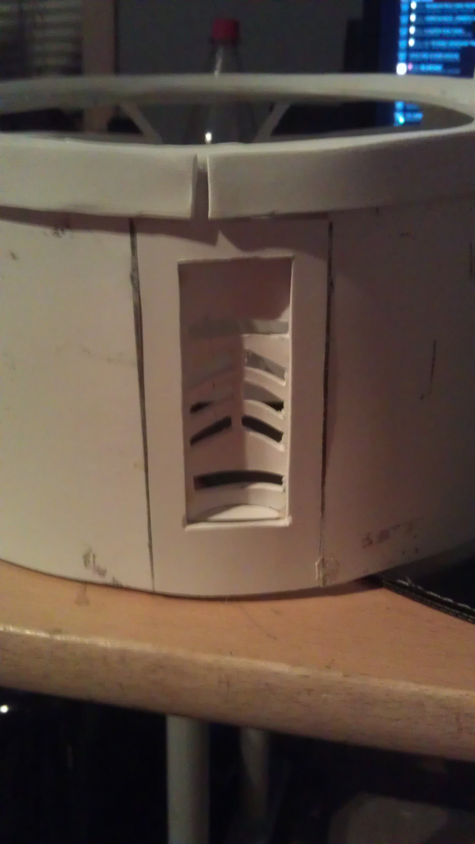

ok so iv ordered up more sintra. i wonna make a new helmet that is less clonelike yet still has a heavy look. and i want a flack vest much like bobas og jangos.
im having some problems making the dome. iv scanned the forums but havent found anything really helpfull. so any tips would be very much appreciated :D
If you have tried to use the WOF templates and not been able to do it right let me give you a tip. When I made the dome for my helmet (all steel) I had a lot of trouble getting everything to fit right and had to use extensive amounts of bondo to get it to look good. Cut out all of the pieces of the templates and attach them together at the pointed ends. Also there are cross section forms included with the WOF templates these help get the shape right. The real trick is to make sure that the material you are working with is cut out accurately. Also if your material is really thick you will have to cut off a little extra material, about the same amount as your material is thick. I hope this helps a little. If you have any questions I will try to explain further.
