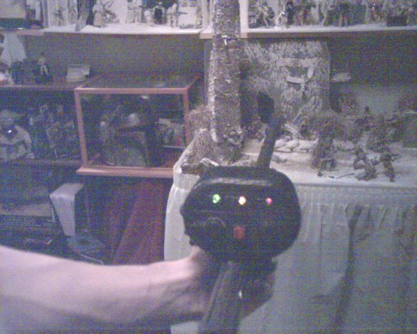

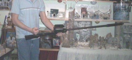

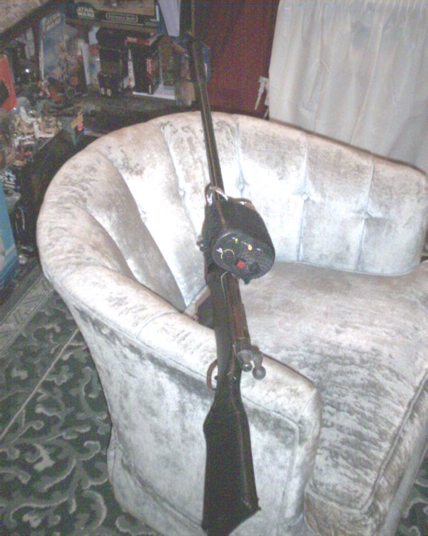

A couple of weeks ago i did a heavy blaster for my fett outfit. The other day i knocked this out in a few hours time and made a sniper rifle for the outfit. I picked up the donor gun at KB toys for 10 bucks. Cut and extended the scope with some copper pipe. Cut out and stained a wood stock for it. Misc sized pvc tubing, washer, and a few greeblies and paint. Its just over 5.5 feet long, longer then my mg42 with the silencer that i added at the end of it.

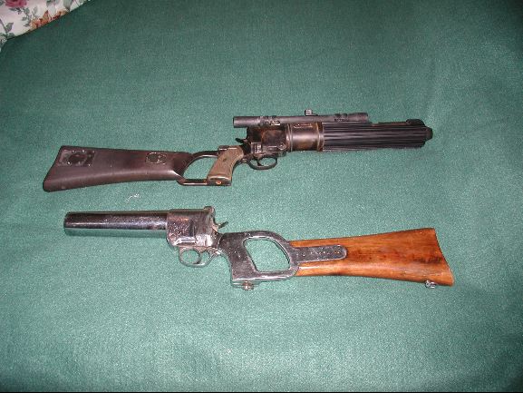

I made a set of aluminum westars but my grip is not aluminum.
I used my sons Rubies blaster as a pattern. Make a Xerox copy of the blaster, cut the grip out and use it as a pattern.
Remember the barrel of the Rubies is short by 1 1/2"
Hope these help

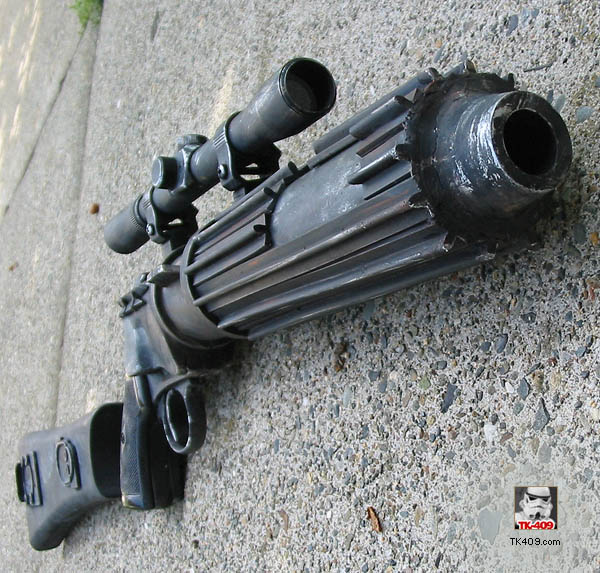

Here are a few pics of my new scratch built ESB rifle. I built the entire thing from scratch (except the pistol grip which I bout, and scope). I would love to know what you guys think..sorry if the pics are a little fuzzy

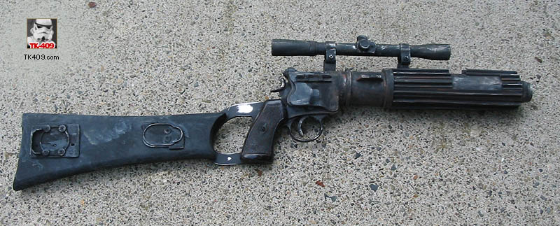

Here's some pics:
I lightly sanded the blaster first, primered the whole thing and gave it a few coats of black. Then i gently misted it with some chrome paint to lighten it. The scratches were done by carefully scrape it with a paper knife and a silver pen. Rust were done with Gouache color and my index finger;)
Let me know what you think.
