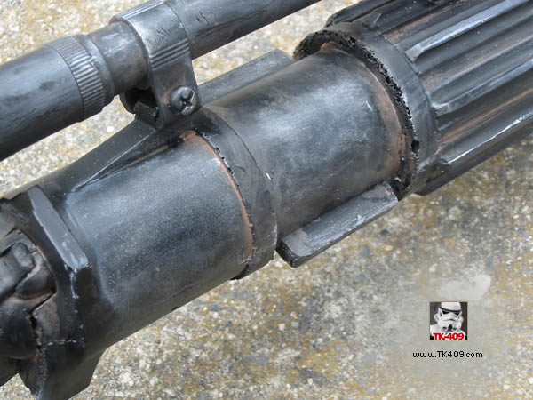

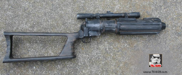

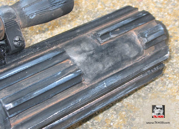

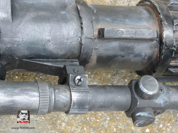

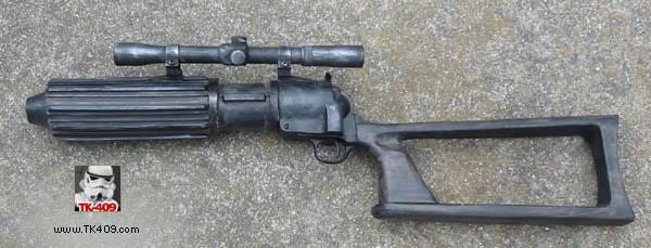

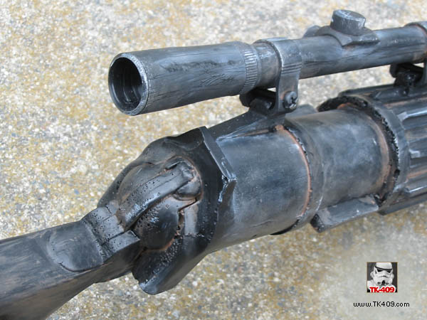

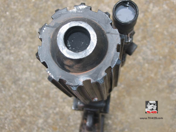

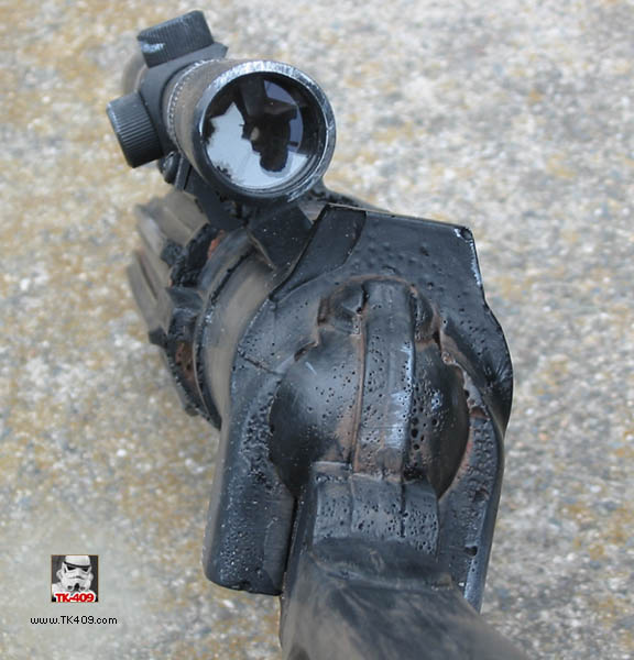

Well, I have my blaster finished, following Jedi-Bob's instructions and method, but a little bit tweaked by me. Here it is...
I primed everything with Automotive gray primer (except for the scope, I took it out before anything else). Then, I sprayed the blaster with Walmart brand Silver and once it dryed I sprayed everything with Flat Black.
For the grips, I used the Krylon Ruddy Brown Primer first, and then the Gloss Black on top, with a soft coat of Matte finish cause it was too sticky before that. After drying, I made the scratches all over (scope on) with a wire sponge.
The stock I painted with Minwax Wood Finish "Red Mahogany" instead of "Jacobean" (they didn't have it at Walmart). I added the details with the same procedure as before for the gun and before installing them in the stock (of course). I went the dowel method to install the stock connector and grips, which I used metal rods instead of wood for more resistance and durability. And the stock is detachable, cause I used Wood Screws to unscrew the stock in case I pack it somewhere for ease and space.
I have to add the "rusty" details later on with Testors Rust to give it a more realistic look, and probably some Flat Gray spots, but not sure. Like Jedi-Bob said before, I don't want it to look like the MoM blaster...too much weathered.
