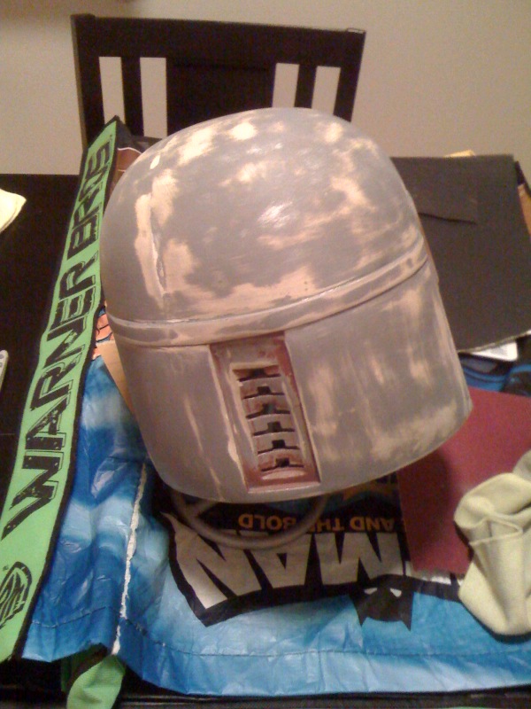

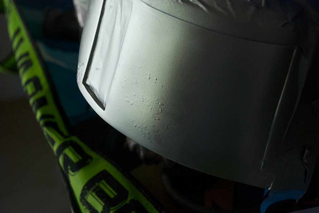

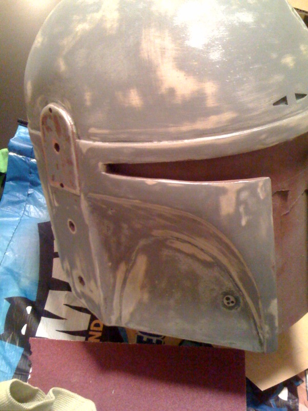

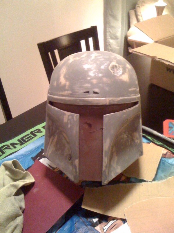

With a new commitment to get this thing done I took it out of storage tonight and sanded it down to primer:
Yes, sadly it needed to be done. I'm going to try an all layered method. I discovered that all my paint had dried out from may many moves so I need to pretty much buy everything all over again. then I can get started. I'll probably hit it with some grey primer tonight though.

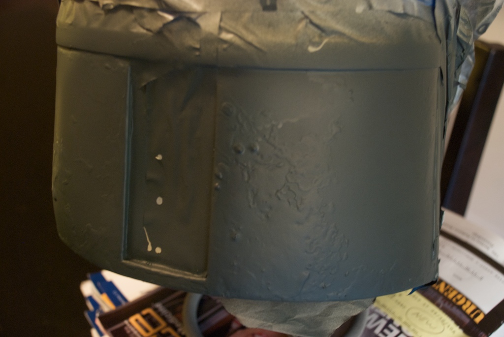

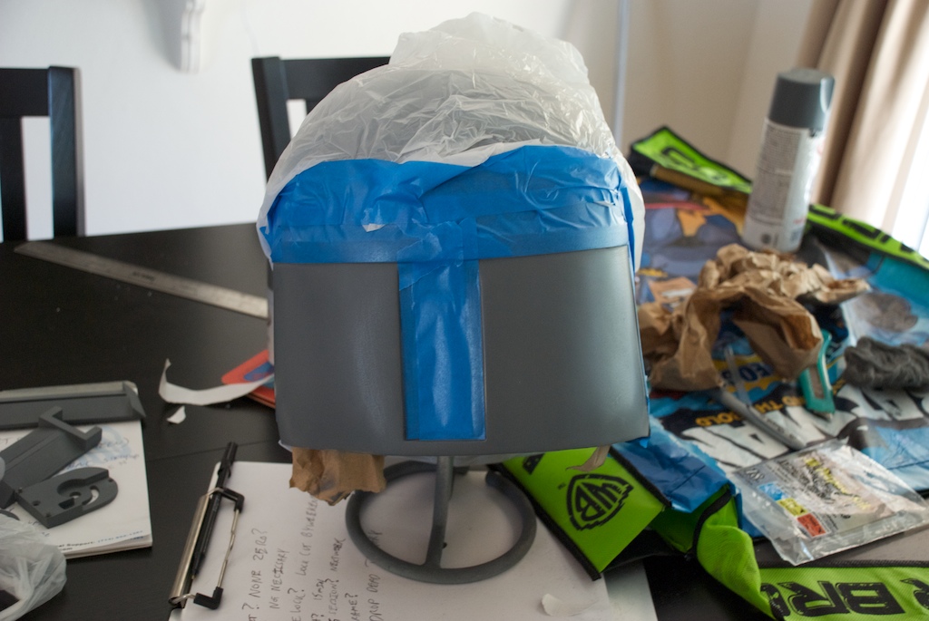

Re-primmed and sanded ready for paint:
I decided to start with the rear panels this time around so I masked everything else with blue painters tape and a plastic bag.

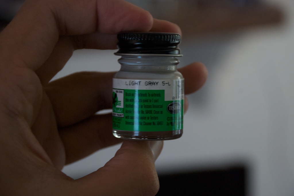

I started with Poly Scale Light Gray L-5:
I broke out my Airbrush and layed down two thin coats:

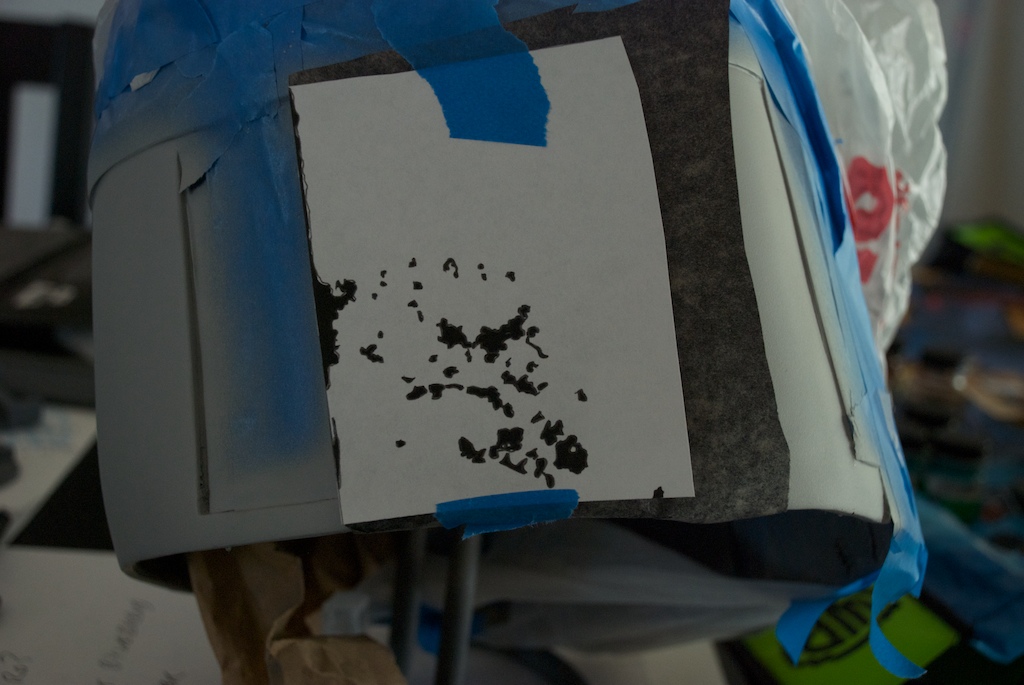

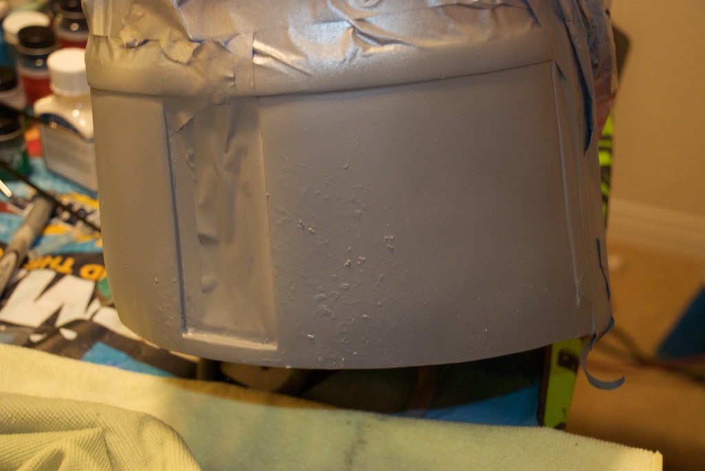

I scaled up and printed out the templates from Rich D. then I grabbed some Graphite transfer paper and put it under the template print out. I then lined them up on the back of the helmet and taped them down:
The Graphite Transfer paper worked out really well.
I then used masking fluid to cover the stencil lines and sprayed on bright silver (not picutred)
I'm gonna allow this to dry overnight then I'll peel back the masking fluid.

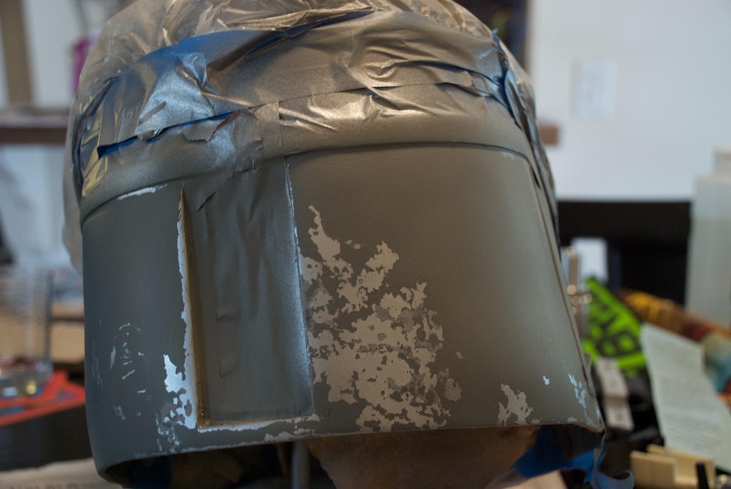

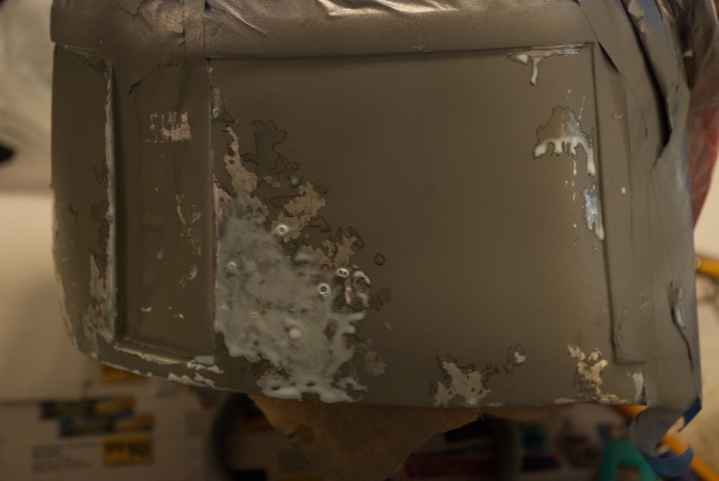

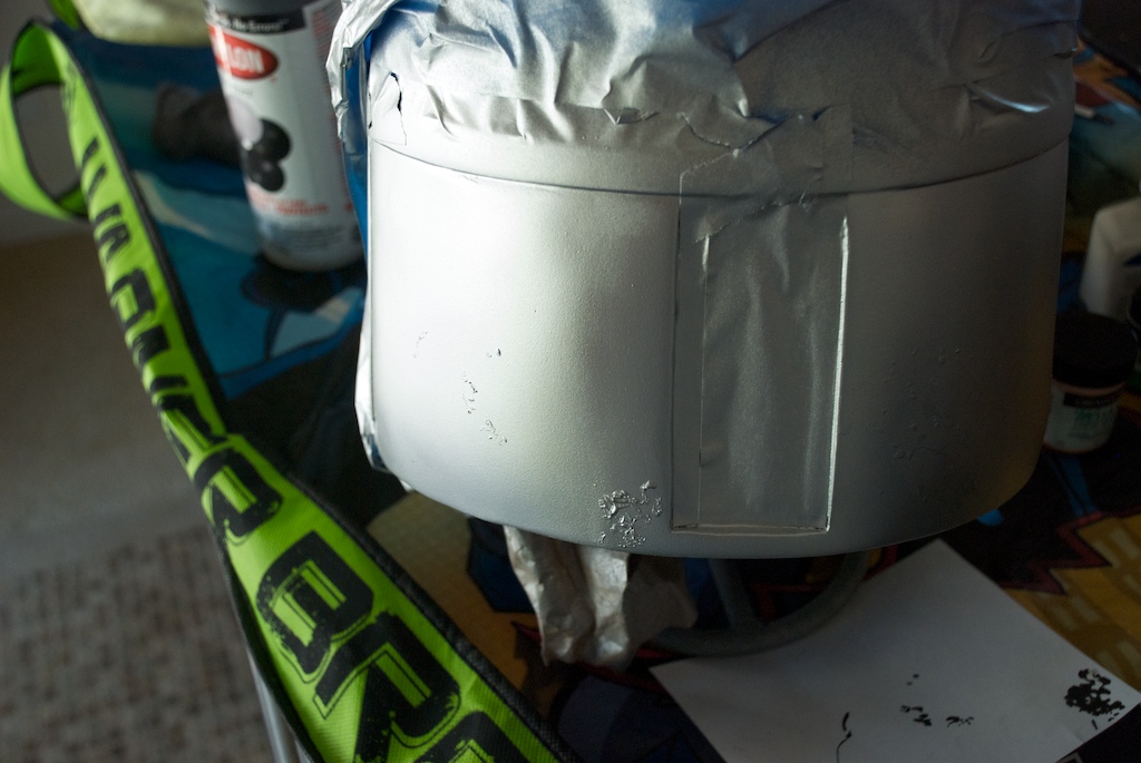

Here is the rear with the light grey masked sprayed with Bright Silver:

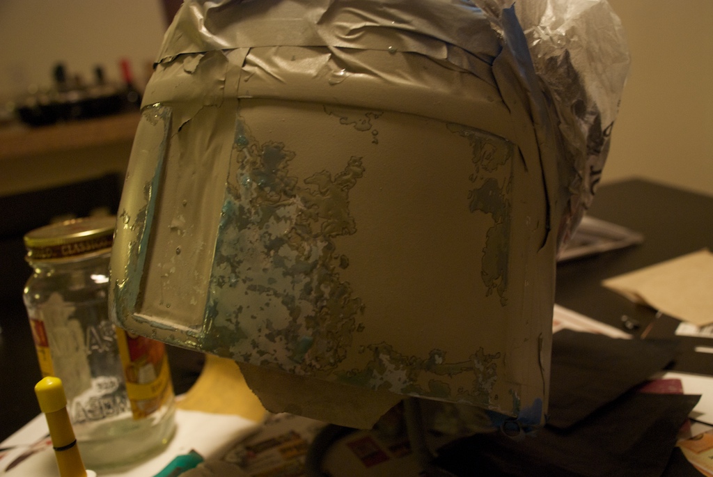

Here is where the mask is removed and the light grey is exposed:

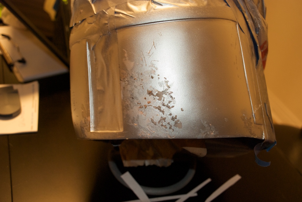

I then repeated the process of tracing the silver damage backed with graphite transfer paper. The graphite transfer paper didn't quite work as well on the bright silver but it worked well enough to mask the damage with miskit.

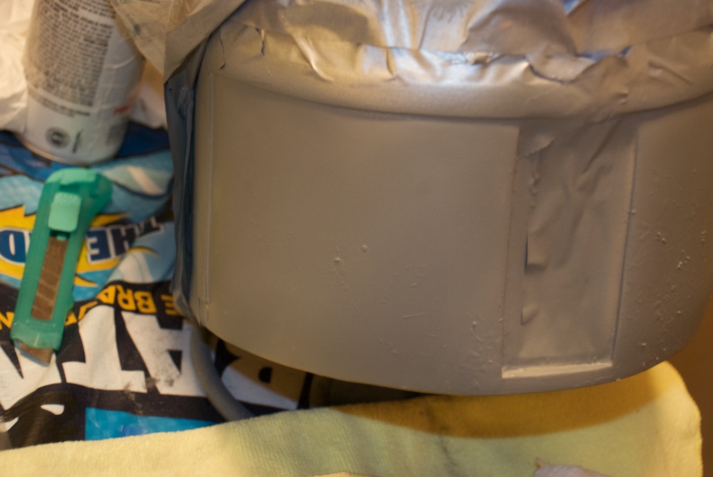

Update 10/17/2010:

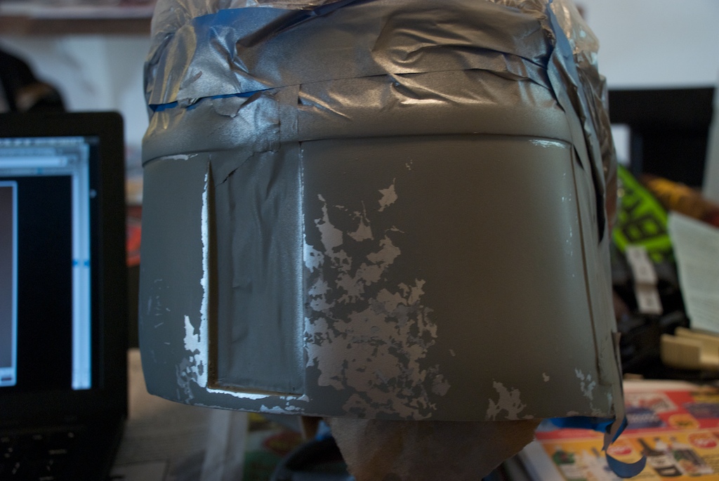

I peeled off the masking fluid:
I noticed that the masking fluid actually peeled off more of the Reefer Grey than I wanted so I ended up Re-masking a small area and doing a quick touch up with my airbrush:
I got a new masking fluid called Masque Pen. It's great especially the very fine supernib version. It's pretty much the new standard in masking for me.
Much Better:

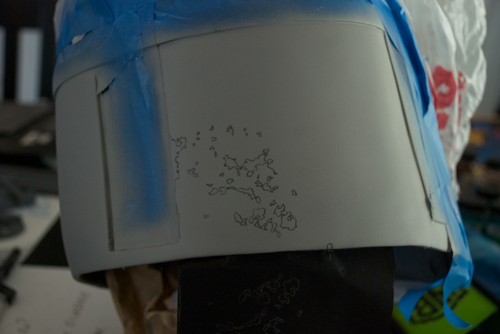

I did repeated the same trick as I've been using with graphite paper under a template.
This time I traced the Concrete damage on:

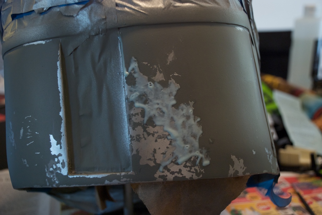

This evening I removed the liquid mask to layers beneath:

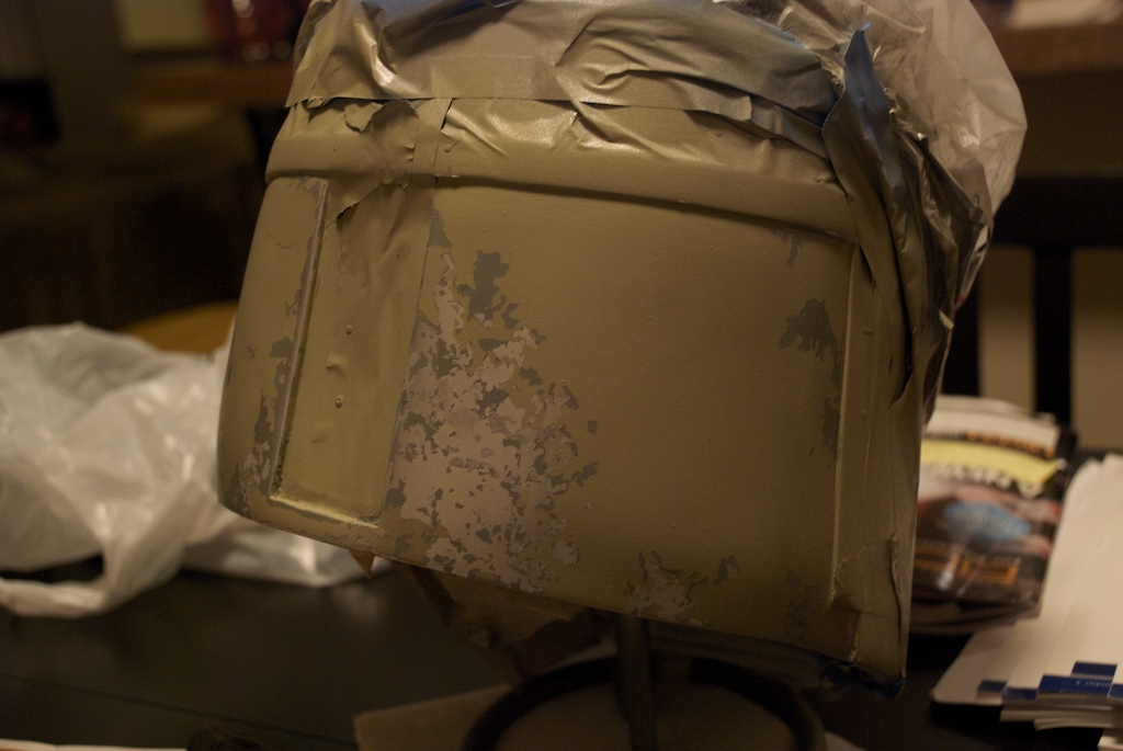

I traced the concrete damage on to the helmet via the stencil/graphite paper method.

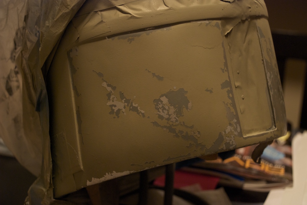

I used Polly Scale German RLM 73 Green for the rear panels main color.

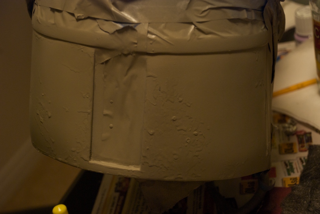

Tonight I peeled off the masking fluid to revel the final rear panel.
There is a little sagging on the left side that I might sand down slightly and re-spray. After that I'll start doing the fine scratch detail with a needle and an exacto knife. After that I'll seal the back with Testors Semi gloss Lacquer. I'm planning on dull coating the whole bucket once the paint is done so I'm not worried about the slight shine.
