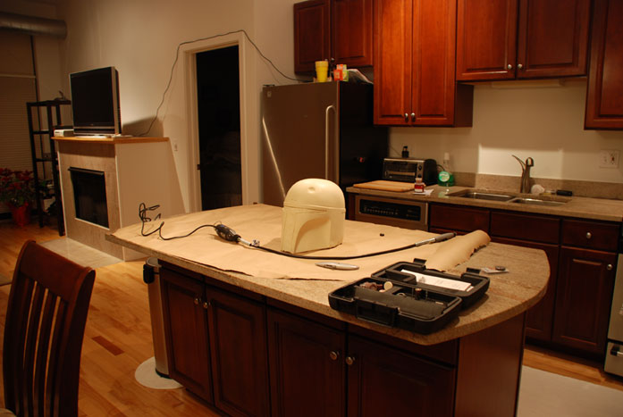

Here's my work space not exactly a workshop but it works:

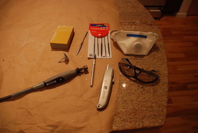

Here's the tools that I used to start the clean up of my helmet:
This set of Hobby Files is one of the best things that I purchased. It comes with a 2 flat files 1 square file, 1 round file, 1 semi-elliptical, and 1 fully elliptical. You can find them at Home Depot in the tools section, I highly recommend them:
Remember kids always where your saftey gear:

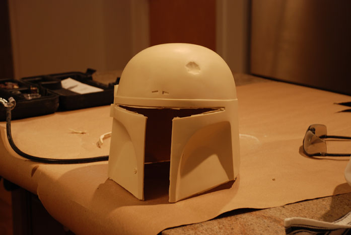

I made my first cuts use my dremel with a carbon fiber reinforced cutting discs. I went really rough on my first cuts as I was terrified of screwing up. I think it was a good idea to do trimming of large areas and then cleaning up the closer details.
I then scored the thinner more brittle resin that was left over with my utility knife and was able to just snap it off with my hands:
I then moved to the top of the t-visor and again cut it out roughly:
Once the rough cuts where done I got a little bit bolder with my cutting wheel and started cutting some of the excess resin out of the visor:
I used a combination of the cutting wheel and a sanding drum to do more of the clean up.

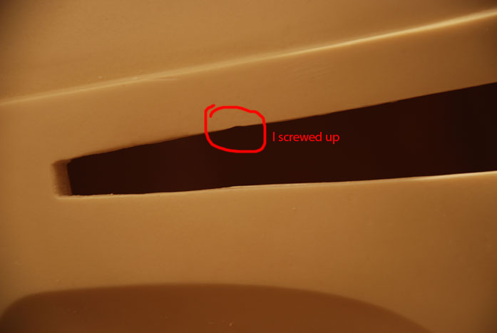

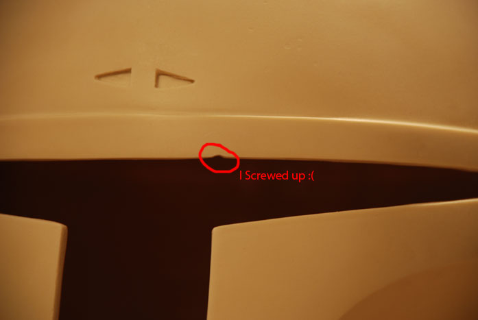

I then decided to switch to a normal Dremel cutting bit to clean out the narrower parts of the top of the T. I figured it would give me more control and allow me to clean up the detail easier. It worked out ok but unfortunately it got away from me a few times and left me with some areas that needed to be fixed. After the area was mostly cleaned I went back with my hobby files and cleaned the narrower areas up.
Screw up 1:
Screw up 2:

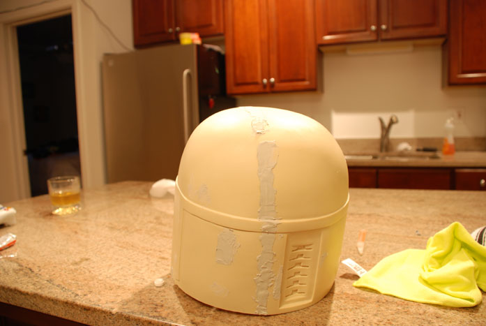

After the Visor was cleaned out I decided to start putting filler on the bucket. Here's the raw filler after it being put on the bucket. It's squadron white.
I was also able to use the filler to fix the areas that I had screwed up:
After 2 coats of filler I am pretty pleased with how the raised areas are looking:

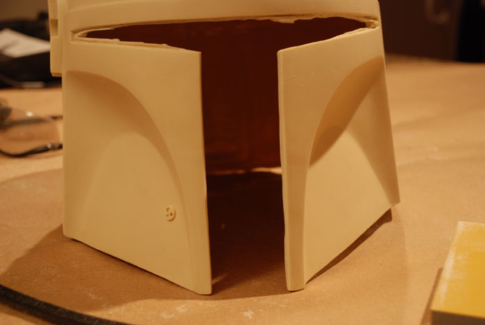

Here's the bucket almost done with the prep work. All that's left is the (gulp) ketslots. My plan for those is to do a rough cut with the dremel and then finish the clean up with the hobby files.
Aside from the ketslots I also need to even out the width of the visor opening from the inside of the bucket so that the tvisor will sit correctly.

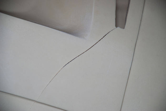

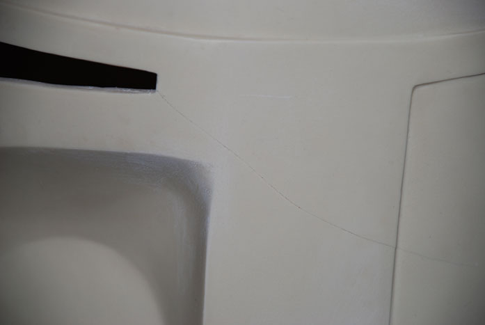

A disaster almost just happened. I was getting ready to go look at apartments and I had my bucket sitting on my bed. When I went to grab my jacket off the bed it knocked the bucket onto the ground right on to the mandible. It made a pretty nasty crack from the corner of the tvisor area to the rear of the bucket. Thank fully I was able to put some CA glue on it right away. I'll putty it up after the CA dries to cover the crack up.
Do you guys think I need to reinforce this any more than just the CA glue and putty?
I broke the mandible off my Sgt. Fang too. Be sure to use shims on the inside of the bucket to reinforce the two pieces together. No one sees the inside but you so it doesn't have to be pretty, but it needs to be functional and support the two pieces.
