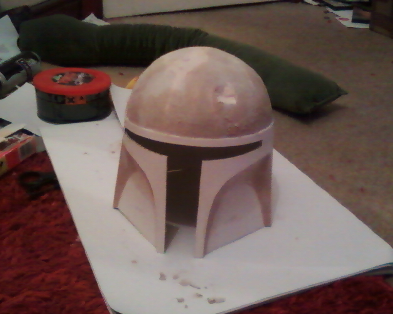

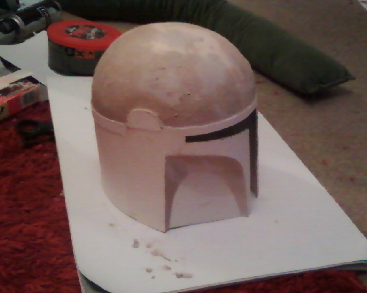

Thanks GraphiX, I am now half way through my first bucket-build, and it's going really well. I managed to find some fibreglass and will be applying it to the inside of the helmet to add strength.
I will have to be posting pictures soon :D
album.php
album.php
album.php
Yes...thats a beer can in the background. :D
I just hope the images work

no, I work in an art gallery/picture framing shop and have access to loads of mountboard (specifically white-core, it's tough cardboard and cuts nicely and is as tough as old boots, consequently my bucket is coming out surprisingly rigid). Are you in the U.K? Because this stuff is probably called different names in other parts of the world. It's not exactly cheap, but if you can get hold of it I would recommend it to you

ah...I got you, I have seen pics but didn't know the term. No, I decided to test out making the dome from mountboard, using the templates and using bondo (car body filler?) to build up the dome in layers, which works out very well, providing you don't mind the dust!!
Good news. Last night I made most of the ears, ready for the filler and sanding. I am so happy, it has started to take shape now...
