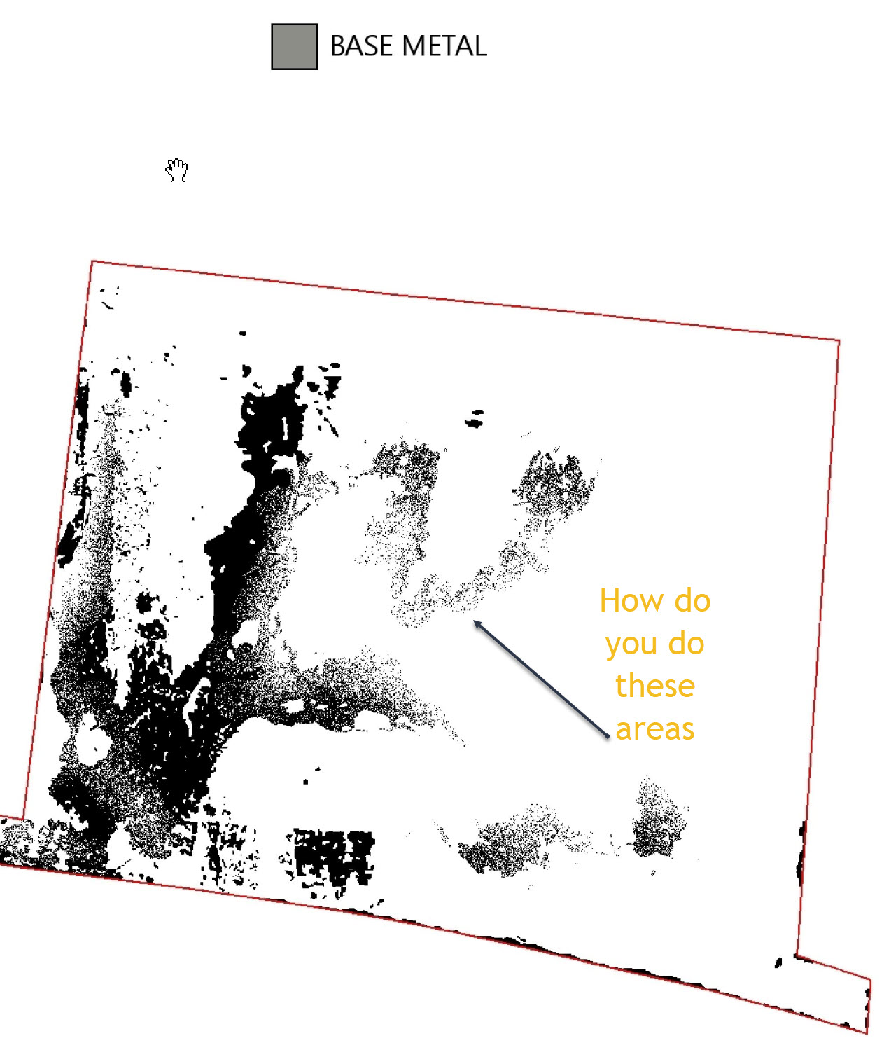

I grabbed a screen shot of Rafa's template... There's are several sections in the picture attached. I've high lighted one of those and I'm looking for any tips on how to get this shaded effect down on the helmet. I have some carbon transfer paper. It almost looks like using sponge of some sort might work. Probably won't ..... There must be a few hundred dots if you will..... How do you all get those down from the template and onto the helmet?
RafalFett
KaanE is correct: all those areas are misted paint. I wasn't sure how to best represent that effect. It is important to use images of the original helmets (be them exhibit images, promo shots or screencaps) along with the templates when painting and always double check everything.
Jayvee
Hi mate - the way I approached them was to lay the silver down first. Then lightly transfer the shapes on using your transfer paper. Here, you will need to look at many reference photos and using an airbrush, mist with a grey to the best your eyes can see, as close to the reference pics as possible. It may look a bit of a mess at this point, but it should :).
From here, you will then re-stencil your shapes, making sure you are very exact this time. This will set the shapes up to be liquid masked (I like Humbrol Maskol for this). Once masked, the green layer is added, and once dried, the mask can be peeled, revealing your shapes with the misting. Then all the weathering and topical detail fun starts! I think I have pics of the process in my ROTJ thread if you need to get a visual. Best of luck bud! :)

Thanks for the response.... I've layed down the hunbrol light grey matte. I'm thinking some liquid courage sounds about right to help me move on to the silver.

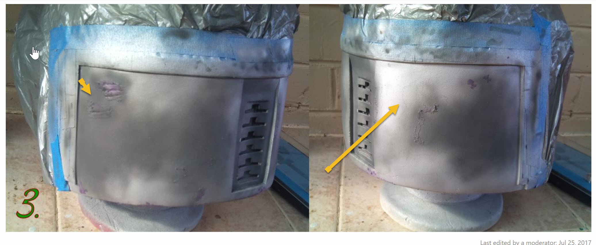

Jimbo
What color or layer is associated with the yellow arrow on the attached picture?
KaanE
The colour under the maskol is bright silver, the color with no masking is bright silver misted with gray.
Jayvee
KaanE is correct mate. Lay the silver and mask the areas to remain bright silver. Then mist with your grey to match the pics (some areas will have heavier grey, some will be lightly misted (again, to match the reference pics). It was so long ago, so had to check again, but in the first post, there is a colour list. The greys are listed in there. It reads:
“MISTING THROUGHOUT ALL SILVER AREAS - Misting over silver (11) using a combo (this should be actual fading, not mixing the colours together) of Humbrol Gunmetal (53) and Humbrol Tank Grey (67).“
Jimbo
Perfect, that's what I thought.... Thanks for the confirmation. When I was looking at your description and the photo's, it looks like Photo 4 is missing and I was convinced that was the one I was looking for. Thanks for the help Jayvee.... I'll post a picture or two this weekend. Maybe :)
