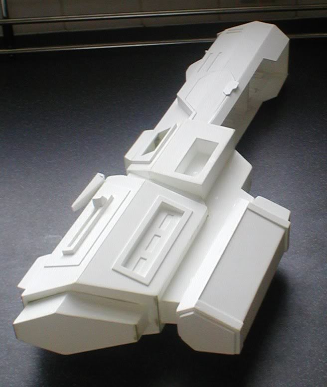

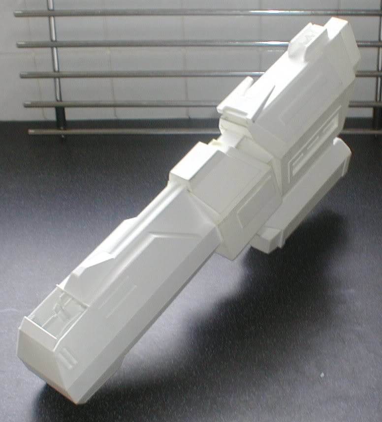

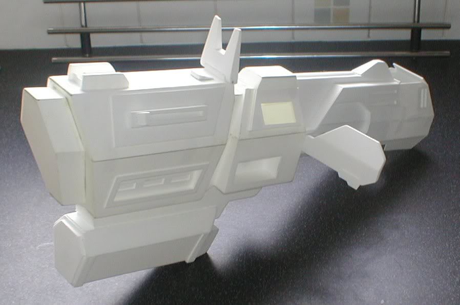

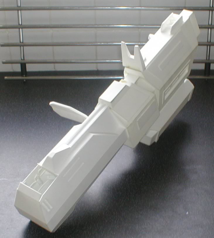

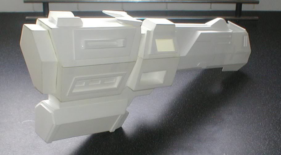

Ok, I have new pics. I had some time on this this morning so have pretty much closed up the rear end now. I had to add some serious internal support here to keep it in shape and to avoid it twisting and warping as I went along. It's all good now though.
Moving parts so far are the sliding bolt on the blaster attachment, the deployable blast shield for the AA attachment, and now an opening and closing locking clip for the different attachments. The plate for the ammo counter is also removable. I've started building the internal for that display too, not pictured.
The locking clip for the attachments serves a purpose as again I'm using magnets to enable it to lock into place to hold the attachment in place. Right now it's mostly for show but will end up serving a bigger purpose later when I make the different attachments and remove the existing blaster attachment to make that removable.

EDIT: I forgot to mention. There's a little piece you see on the blast shield that shouldn't be there?? I added that to allow me to easily be able to open the shield when need be. The shield usually sits flush with the rest of the rifle casing and since I'm not using servos to open or close that shield it would be near impossible to open it with gloves on. ;) That little flap allows me to get my thumb under it and pull the shield open. ;)

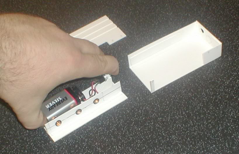

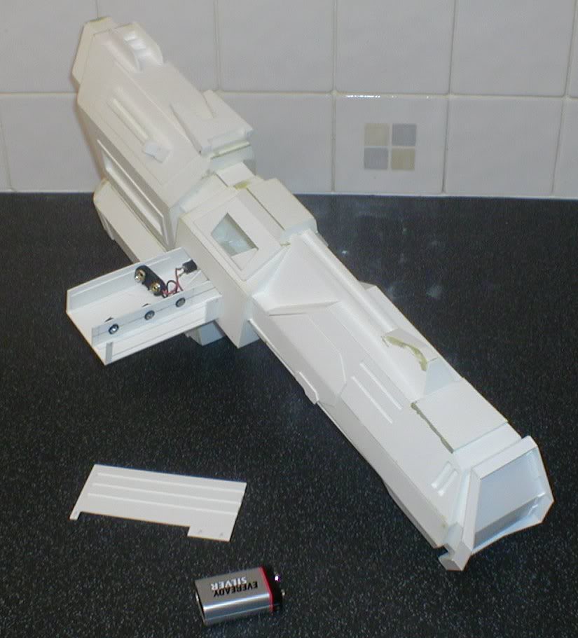

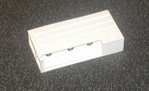

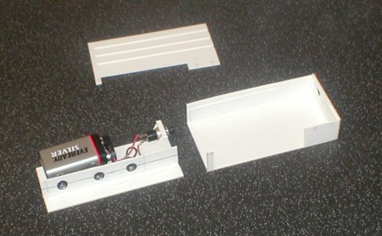

I started work on a magazine yesterday, my soldering iron arrived so I couldn't wait to try out my idea.

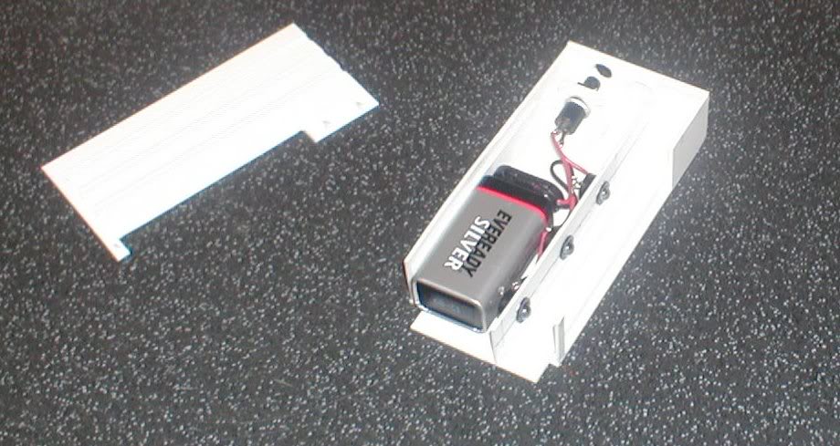

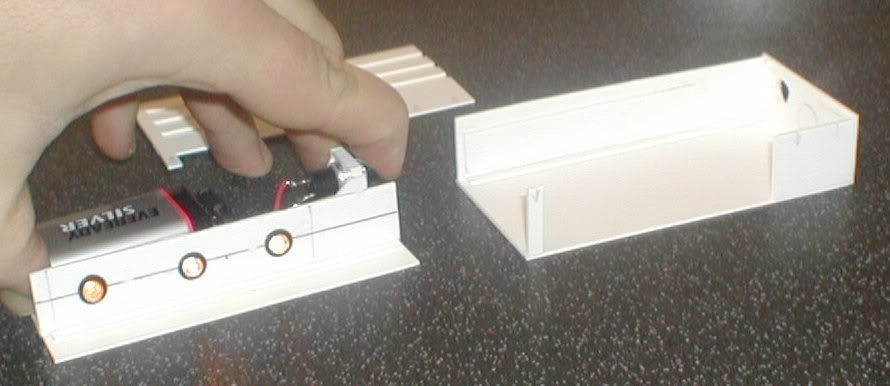

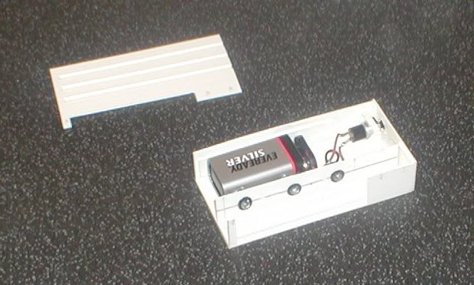

The mag has three LEDs inside powered by a 9v battery, there's also a momentary switch in the circuit. Push in for "on", release for "off". This switch slightly pokes out through a hole in the mag casing so that when the mag is slotted into place in the rifle, the switch is pushed in and activates the LEDs. When the mag is pulled out, the lights go off. This isn't how the mag lights work in game it sems but I wanted to experiment and also thought it'd be a nice way to do it.
The whole circuit and light board are seperate from the magazine and slides inside to allow battery changes or maintenance. Magnets again hold the mag closed when I'm using it. It's still being worked on but here are some pics:
NOTE: That top plate for the mag casing will be fixed into place once I'm satisfied it all works and after I've done the transparent parts.
You can now see the circuit board.
You should be able to see the switch and it's hole here.

The unfinished mag in place in the rifle.
The switches aren't fantastic, they need to be pushed right in to activate the LEDs, I'm hoping that magnets pulling the mag into the rifle will hold it tightly enough to push that switch in and activate the LEDs. If not then I'll need to find better switches so fingers crossed.
