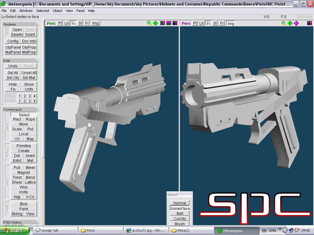

Here's three pics of the complete model.
EDIT: I've just looked at those pics above and it struck me that this pistol actually ressembles Robocops Auto9(I think that's what it's called)??? Funny. :)
No buddy. This could be textured and what not and even unfolded to create a card model for display.
Though I'm not really doing that anymore these days. I'll be unfolding this 3D model to create 2D templates or the pistol. Then those templates could be used to build you're own using sheet styrene or similar material.With a little time, ELwire could be used to light the prop too.

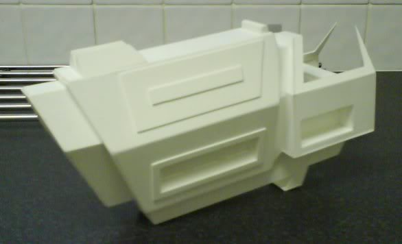

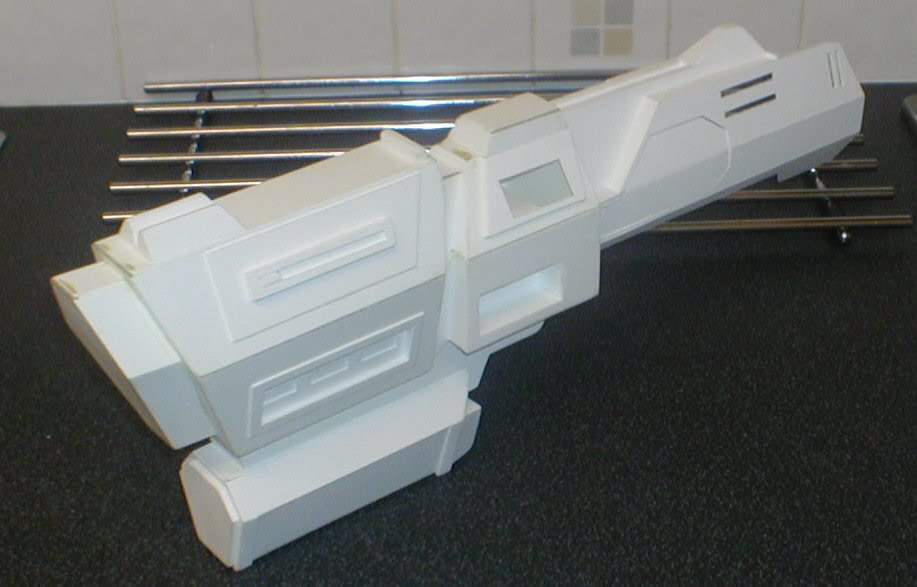

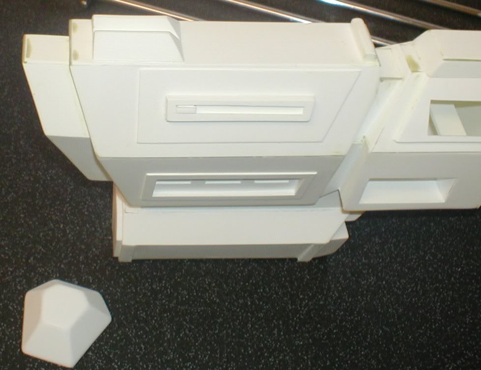

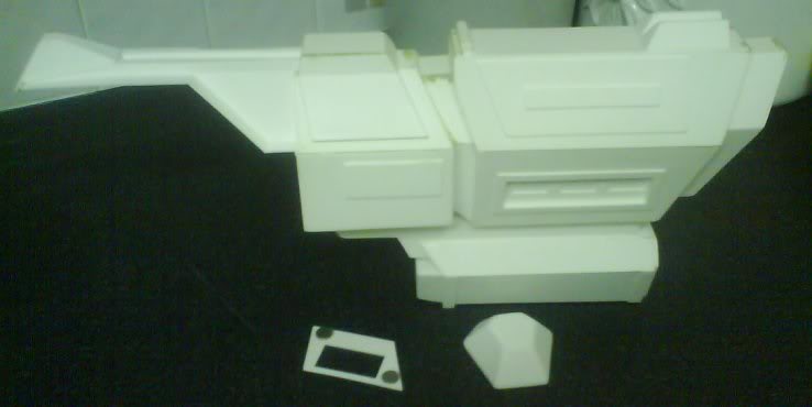

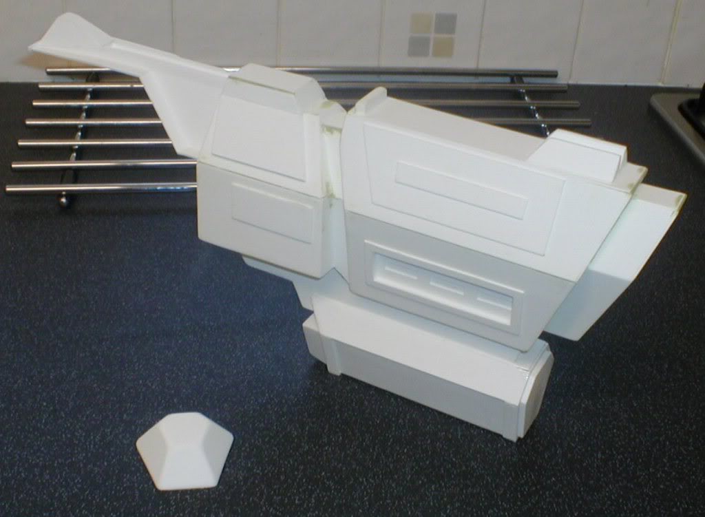

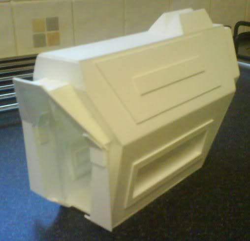

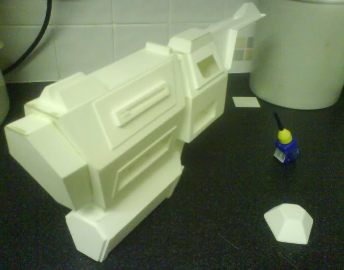

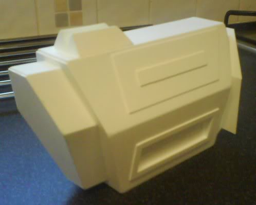

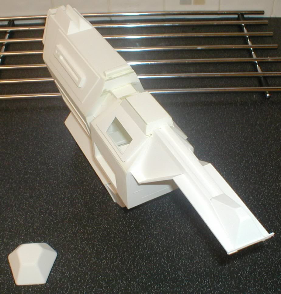

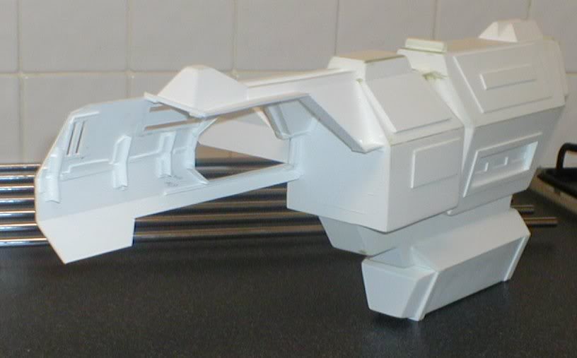

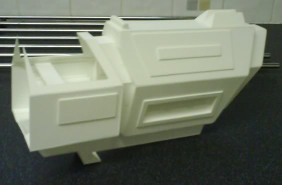

I've built up more of the mid section around the ammo counter and magazine. I've also, built most of the grip(for lack of a better word) at the front too. It's still going together really well and is surprisingly sturdy and rigid for 1mm styrene. Also, there's a plate for the ammo counter display that is held on with some magnets. Then it can be removed for me to access the inside when I need to change batteries on the LED.
I've also bought some LEDs and battery connectors for this but as yet haven't put them to use. Also got me some 20mm diameter pipe on the way to use for the barrel.
Some pics? Sorry about the phone camera! I really need to get batteries for my real camera.
I FOUND SOME BATTERIES! So I took clearer pics. Thanks very much Odran!
These will show up where I still need to sand and fill but it should show some more of the detail better too. Still a lot of work left to do but I'm happy with it so far, and I'm thrilled you like it too!

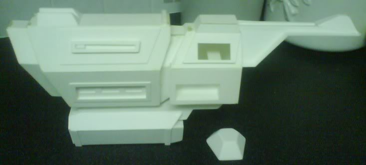

Ok, I wanted to post these pics before I go off to bed. Trying to stock up on sleep before my ik'aad arrives. LOL!

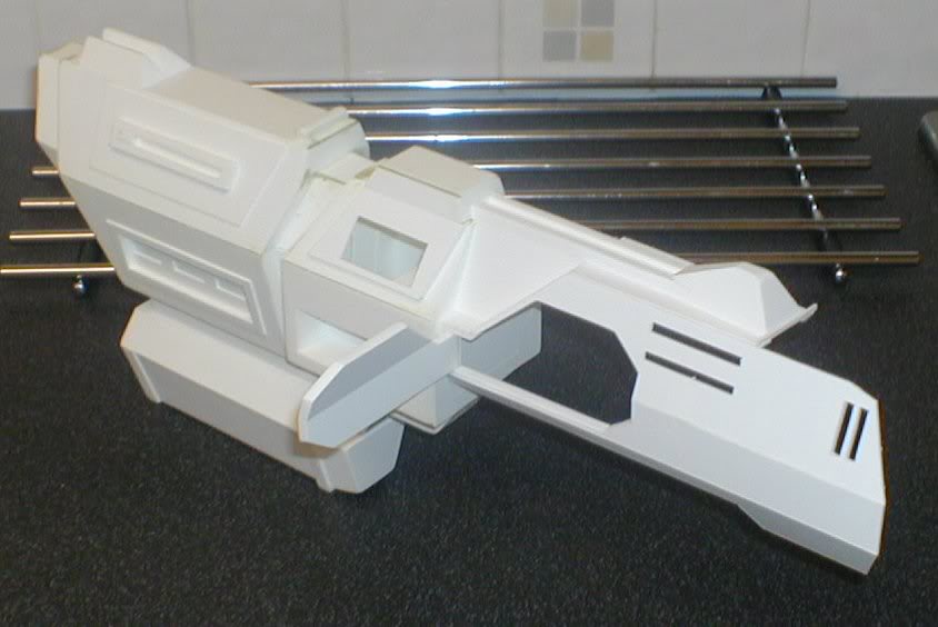

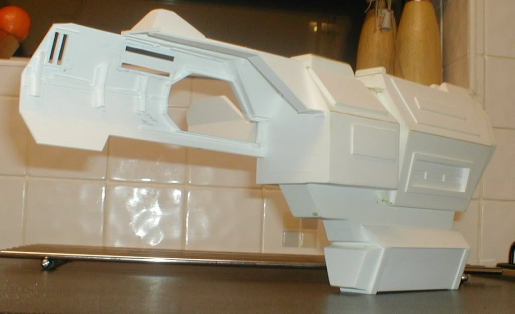

I finished the bulk of the blast shield just now. It needs a little refining and clean up but it's enough for me to show you guys. I made the flap around 4mm thick, it's hollow to allow a pin to be used as the hinge. The pin is a steel rod around 1.5mm in diameter and is strong enough to take knocks and allow movement without bending or popping out.
I still need to build in the rest of the recess where the shield closes into but that's for tomorrow. I need to add a swing arm to act as a stopper to prevent the shield from opening too far and will also have magnets that will allow it to also hold the shield in position in the open or closed positions. Again that's for tomorrow. :)
I'm really pleased with this bit even though I don't need it to function right now. Still, it's there in readiness for when I build the AA attachment eh?
Some pics for you to see. The last two are mainly just to show what I meant earlier about using scrap pieces to add strength to the seams and joints. Not the prettiest of work on the inside but it all serves a purpose.
Hope you like it guys, any feedback or critisism is welcome my brothers!
