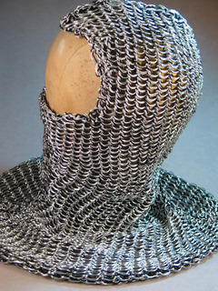

everytime i saw the helmets in the game, i imagined them being chainmail..dunno why...they just remind me of the chainmail hoods people wore in the gothic days...i cant imagine any other material being as flexible and supportive at the same time...but i also dont know too many materials
just a quick idea of what i was thinking of...if you could get the metal to the color you wanted...i think it would work out quite well
painting the metal could work and then wearing a hood under of the same material i think would make it look more solid
I make chain mail, and I must say I really don't think it would be the right material. It sags bad under its own weight. Also most paints don't last long on chain mail because of the nature of all the little moveing parts.
Not to mention you would be screwed if you got hit with a blaster bolt.
if only :(
but yeah, i had a friend in highschool who was into making that stuff...what about using a super light material? aluminum or something?
Well you could use aluminum, which you can buy already iodized in several colors. Includeing blue. But it will still sag with out something underneath it. You could reduce the sag by using more complex weavs. But the more complex the weav the heavier it gets. I think you would have to at least do a 6 in 1 weave to get a passable level of accurcy. 6 in 1 is not known to be easy to expand out. Which you have to be able to do when you creat a coif (head peice).
The alternitive is to use extreamly small rings, (around 1/8th I.D.) this would be more passable because then there would be an excuse for the game to leave out the texture on something this small. Which it would not have it if the helmet used normal sized rings. The upside to the helmet being made of 1/8 size rings is that you could easily expand it to make a coif. You are just going to need a huge ammount of rings at that size to make something that covers your entire head.
The problem with 6 in 1, is that expansion would be difficult.
Because when you expand out starting at the top, you add rings. So when you expand out 4 in 1 it becomes something similar to 5 in 1. So 7 in 1 would be a royal pain. Unless you were to use larger rings (over 3/8 I.D.) which becomes a problem with the solid look even with 6 in 1.
