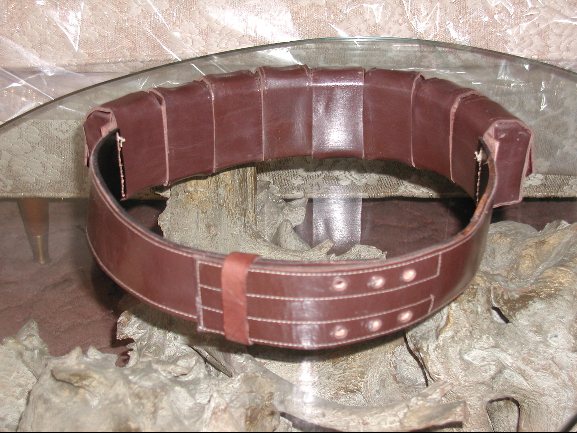

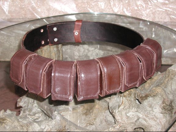

Just finished my ammo belt, it is all leather, the pouches were reinforced inside with plastic, but you can still open them and store things inside. The belt is thinner leather stiched on a sewing machine and then glued to thicker leather to give it weight. I stiched only the thinner leather first before glueing it together so I could use the sewing machine instead of hand sewing both the thicker and thinner leather at one time. I went to put the gold grommets on the holes but the leather was too thick.
That looks great! Also a good idea on gluing the thinner sewn leather to the thick stuff.
Doesn't the main belt go the other way? Meaning, when you're looking at it from behind, it would open to the left?
