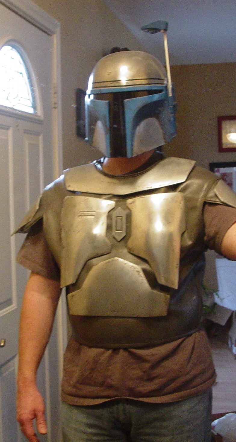

took a quick pic today. There is some adjustments that still need to be made, but I cut off the bolts and added some weathering.
Uploaded with ImageShack.us
a couple of the bolts heated up and had to be reglued. Evidently I did not put them in the same spot because the right side had a bit of a "bunched up" area on the chest. That will be an easy fix though. I did break out the craft paint and dirty up the plates and the vest a bit.
I realized after the fact I did not take a picture of the cut off bolts. They are nothing special but I had a couple of questions about how rough it would be against your body and I wanted to show them. I don't even notice the bolts with a t-shirt on I doubt I will be aware of them with all of the other gear on.
A couple of other things I am figuring out.....even though this vest was said to be cannon, the shoulders are too small and the armor extends past the end of the vest. I think the neck opening is a bit large and the distance from the neck to the edge of the shoulder is a bit wide. But as I said this is my practice vest for when my long awaited LSFU vest arrives.......
As always C+C is appreciated.
looks good...the only 2 things I see is the back edges of the collar seem to poke way up...can you bend them down to sit flush on the vest and the lower outside edge of the chest are sticking out. I would try to get them as flush to vest as you can. Also I think you are right the shoulder of the vest are little short. Looks really good and weathering looks nice.
