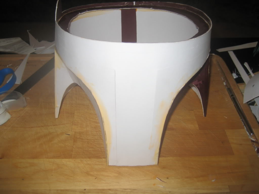

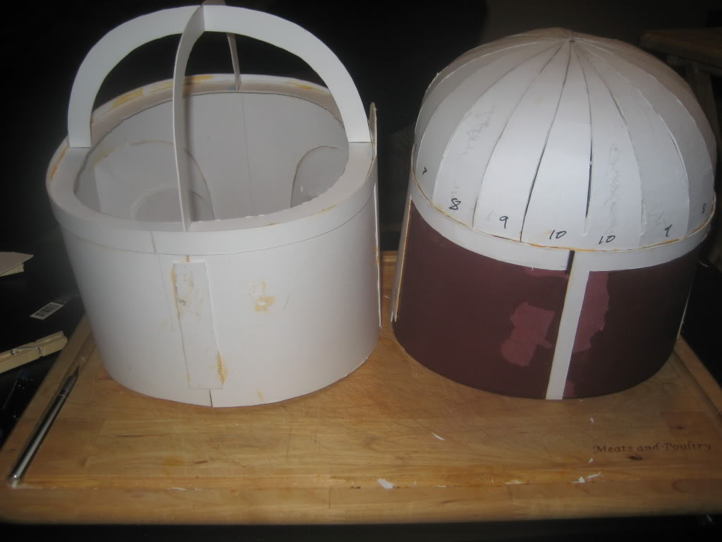

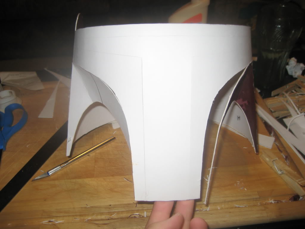

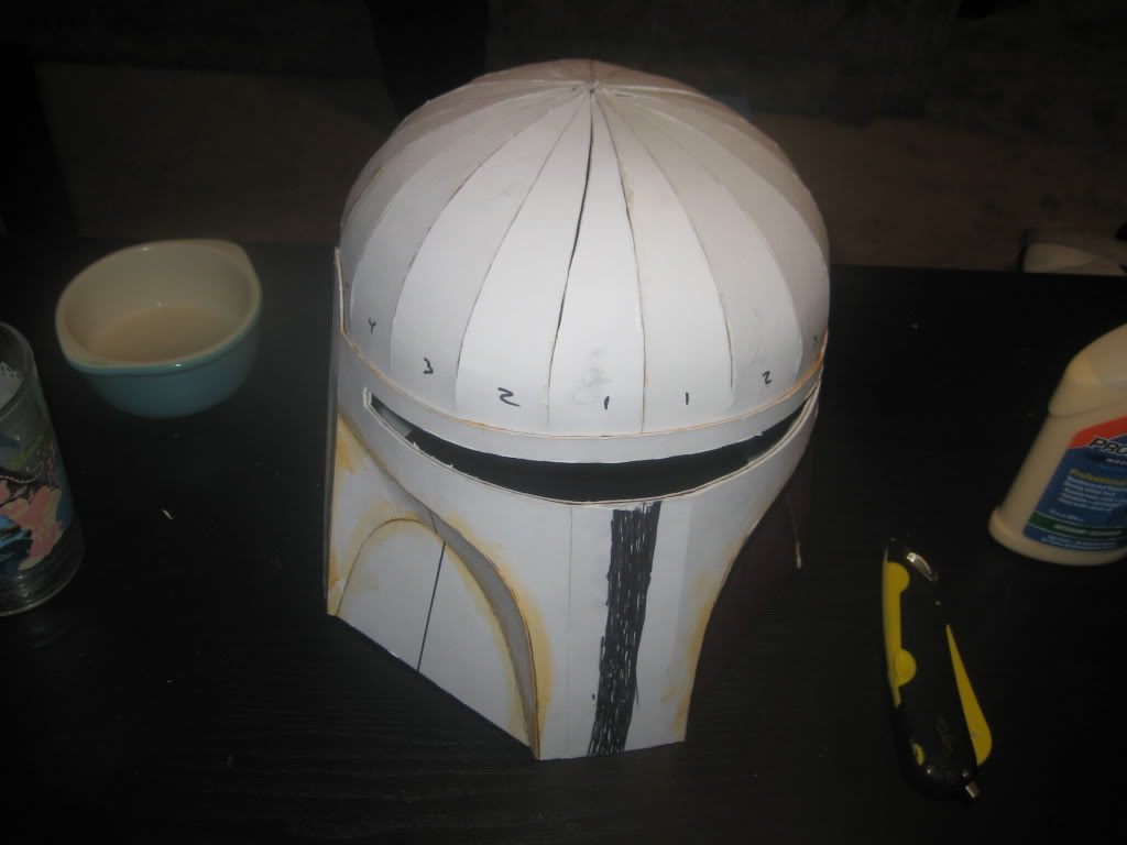

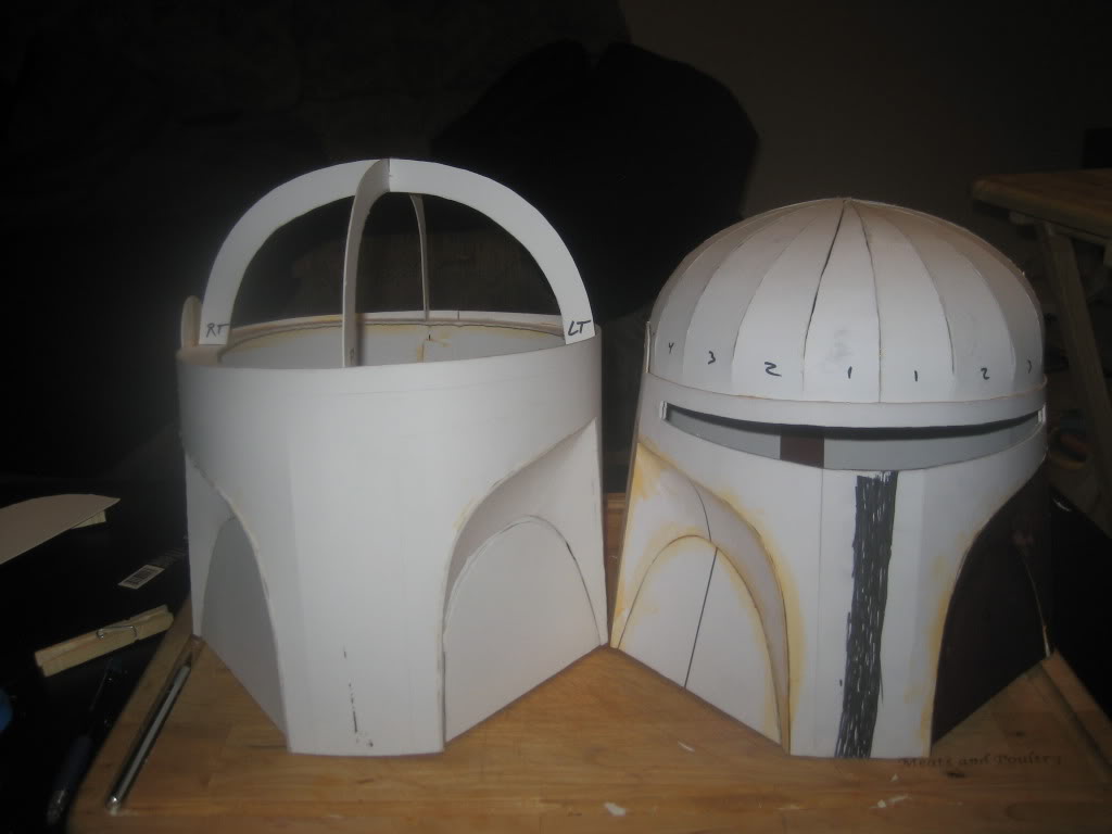

basic Bucket is formed

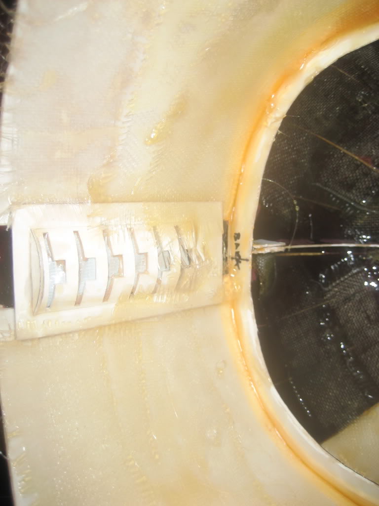

I had a hell of a time getting the dome base inside the bucket as i stupidly glued it into a tube shape first... live and learn

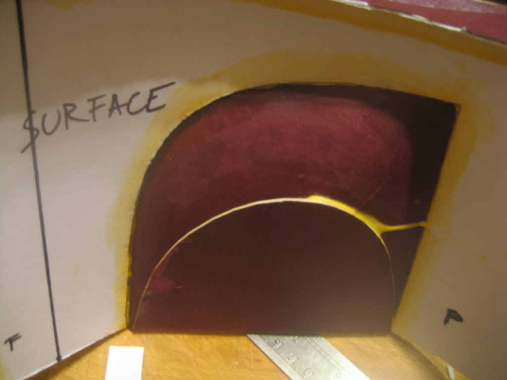

inside shot

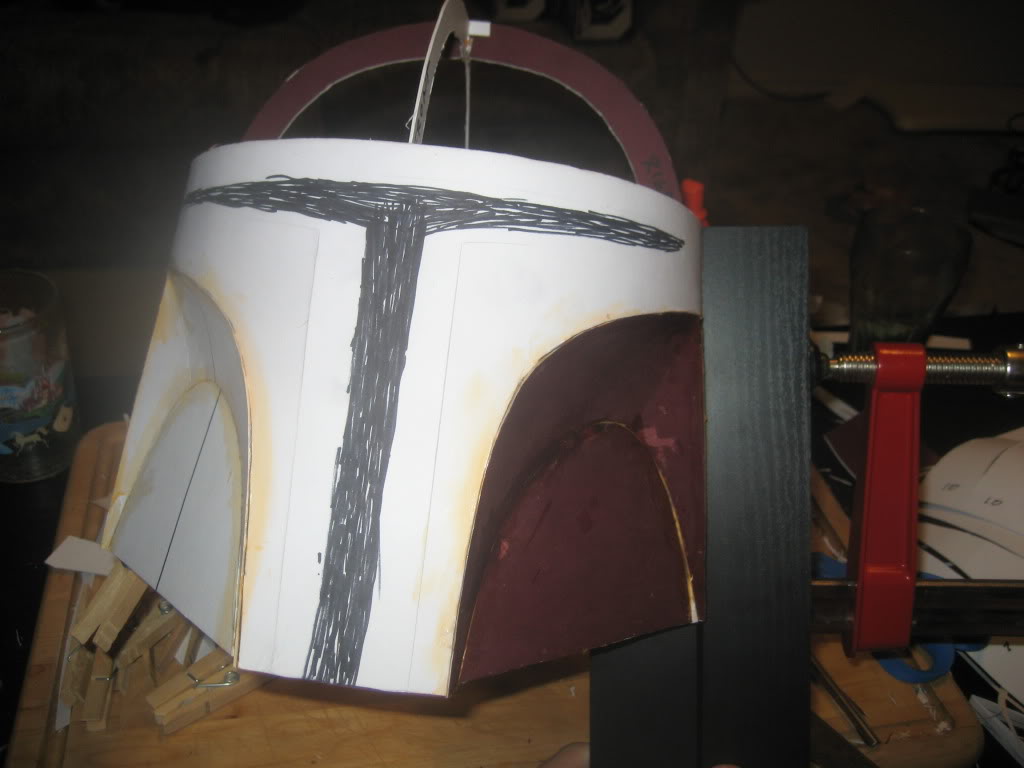

full mask glued onto the basic form
inside shot after i cut most of the dome base out

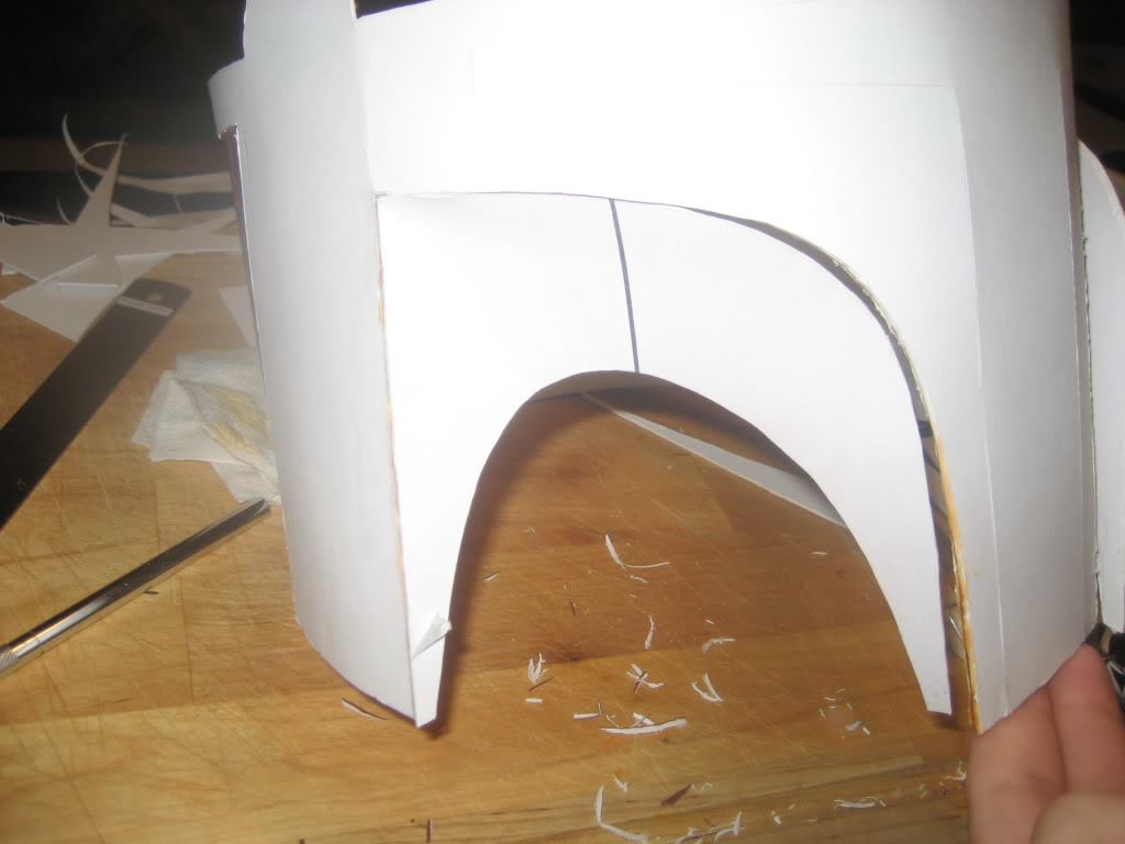

cutting the mask panels of the basic form

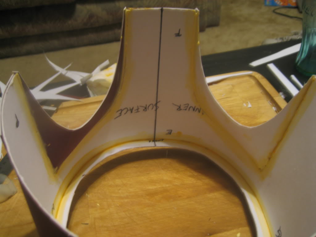

now the back part of the template included this vertical seam cover, i wasn't sure whether to cut it or glue it.. so i kept it.
the back seam is now REALLY strong...

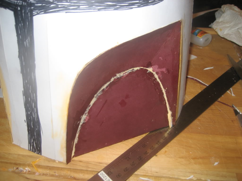

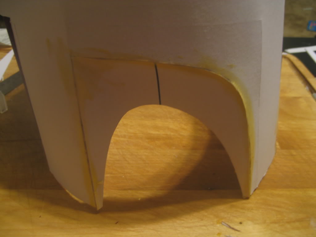

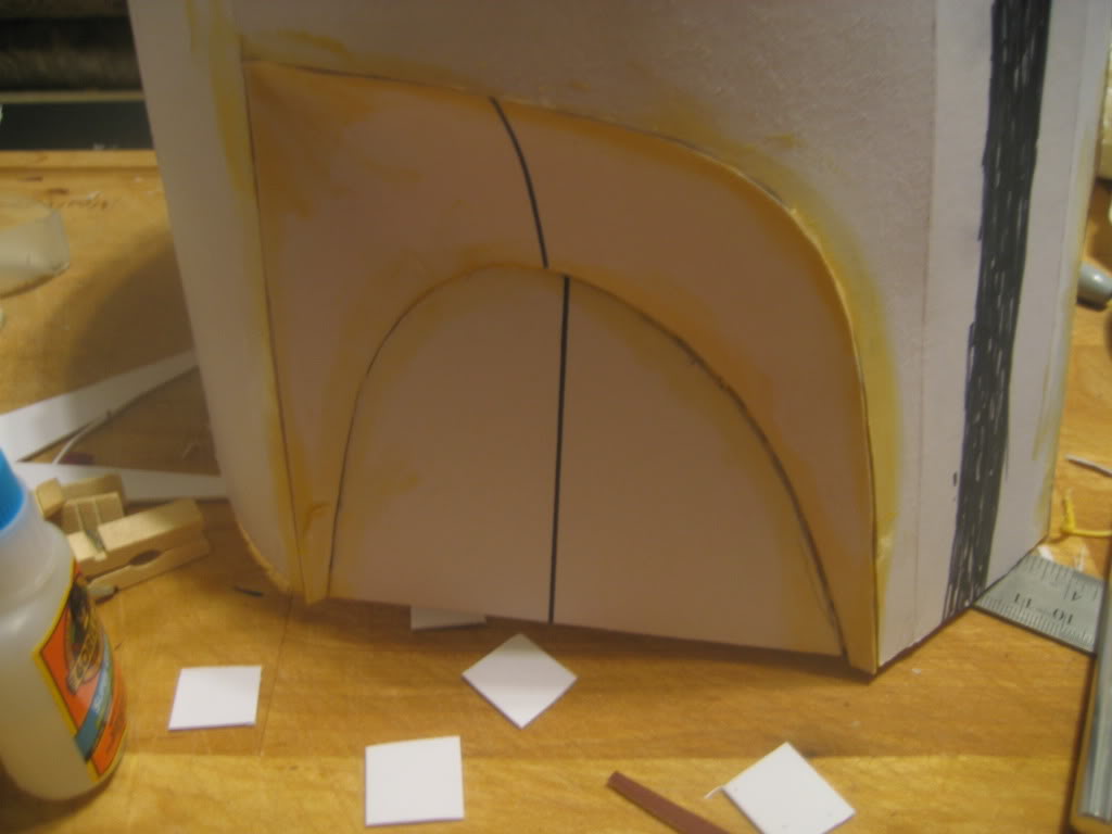

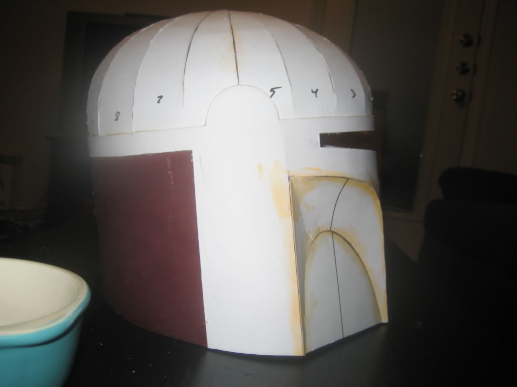

cutting the cheek panels
and fixing some serious delamination of the mandibles and ear bases due to a bad glue job on my part.
glued in the formed upper cheek panels
for some reason the left one glued in perfectly on the first go, the right one took me 4 or 5 tries to get half glued in. had to come back and glue the other half a few minutes later after the initial glue had set. I used super glue for the tacking into place then covered the whole seam in sandable wood glue.

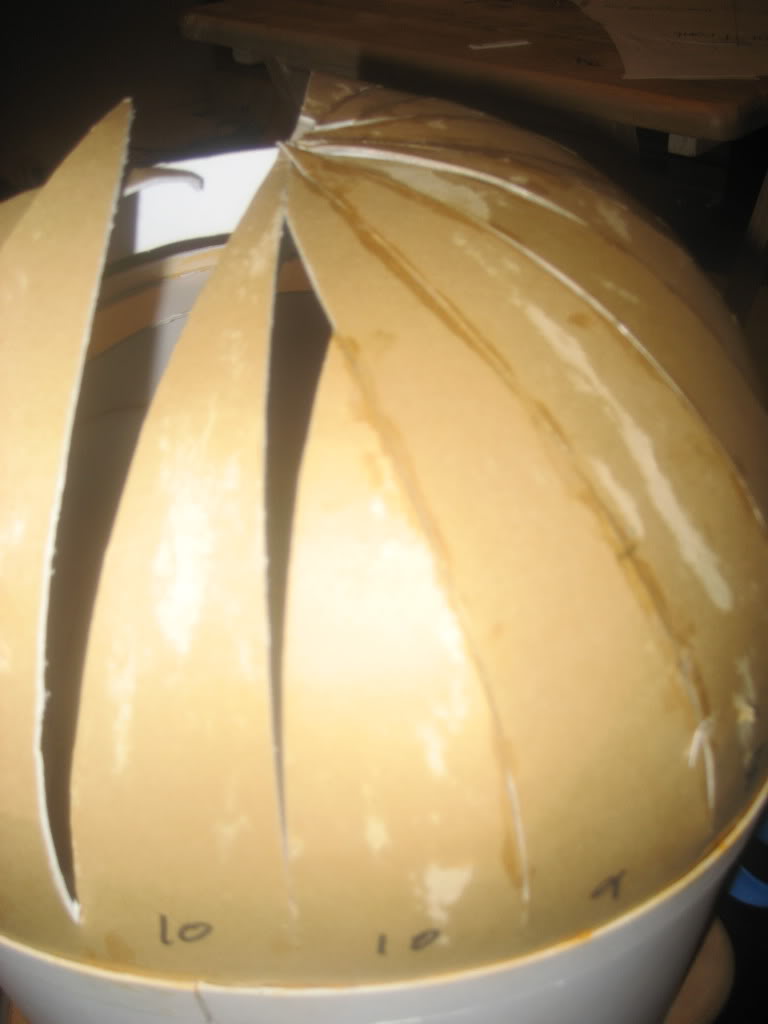

shortly before "fetching" me the drying, formed rear dome section and tearing 2 triangles off in the process.
the formed dome sections drying
as with the cheek panels i found Mr.Antman's advice to form with fingertips like clay to be an excellent analogy.
after moistening both sides with my trusty sponge they shaped readily into the appropriate shapes.

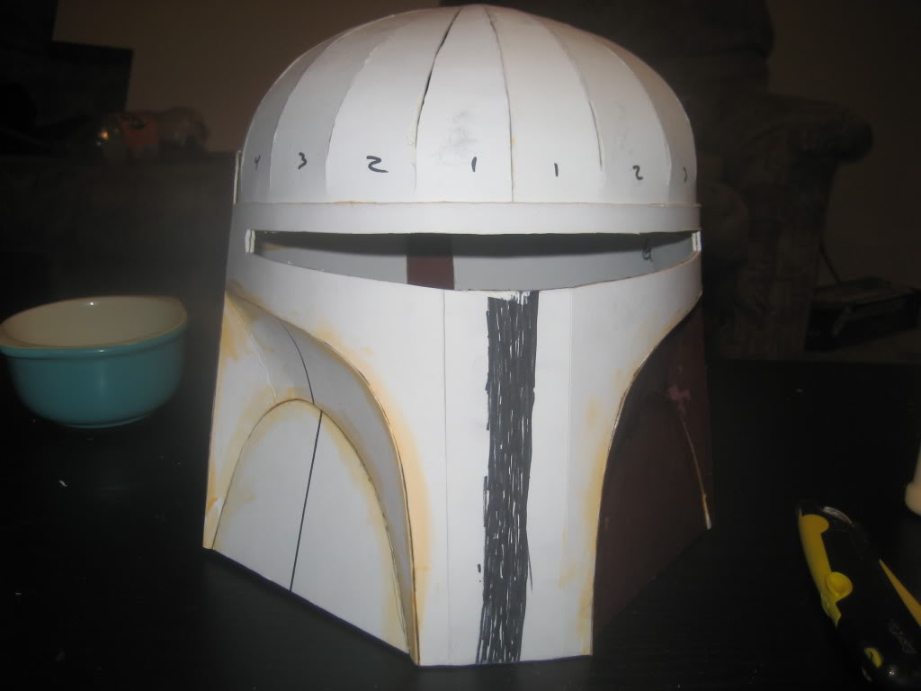

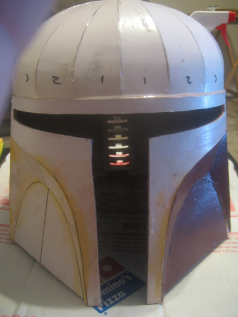

While i am using the Boba Fett Helmet Templates i am going for a custom Mando buy'ce...
and more progress:

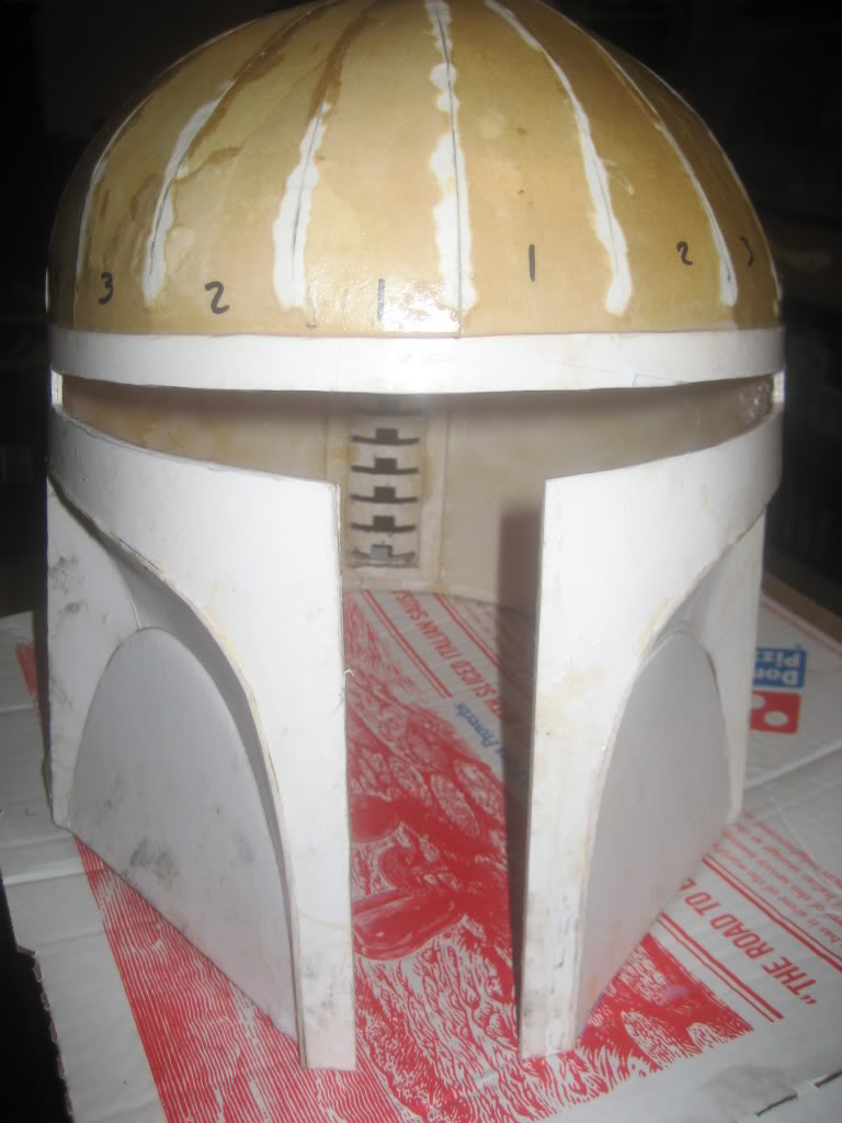

finished glueing the upper cheek pads
lower cheek pads in place
attached dome guide and sharpied visor in out of boredom... watching glue dry is fascinating stuff
also re-re-laminating the left ear area as well as flattening it.

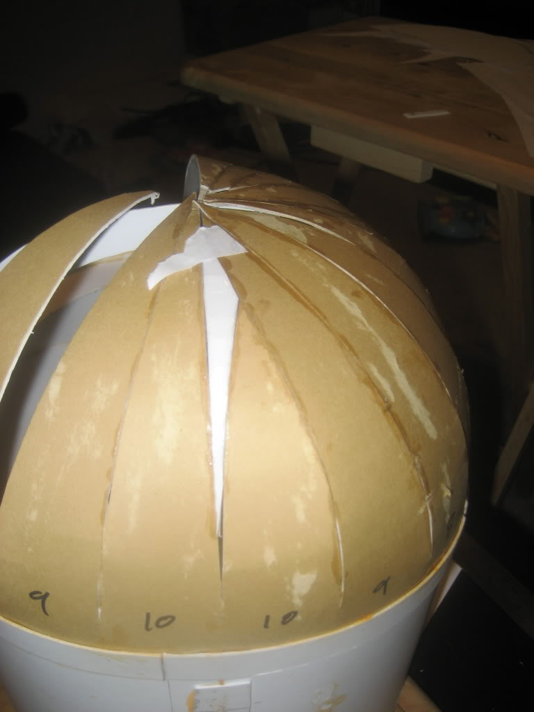

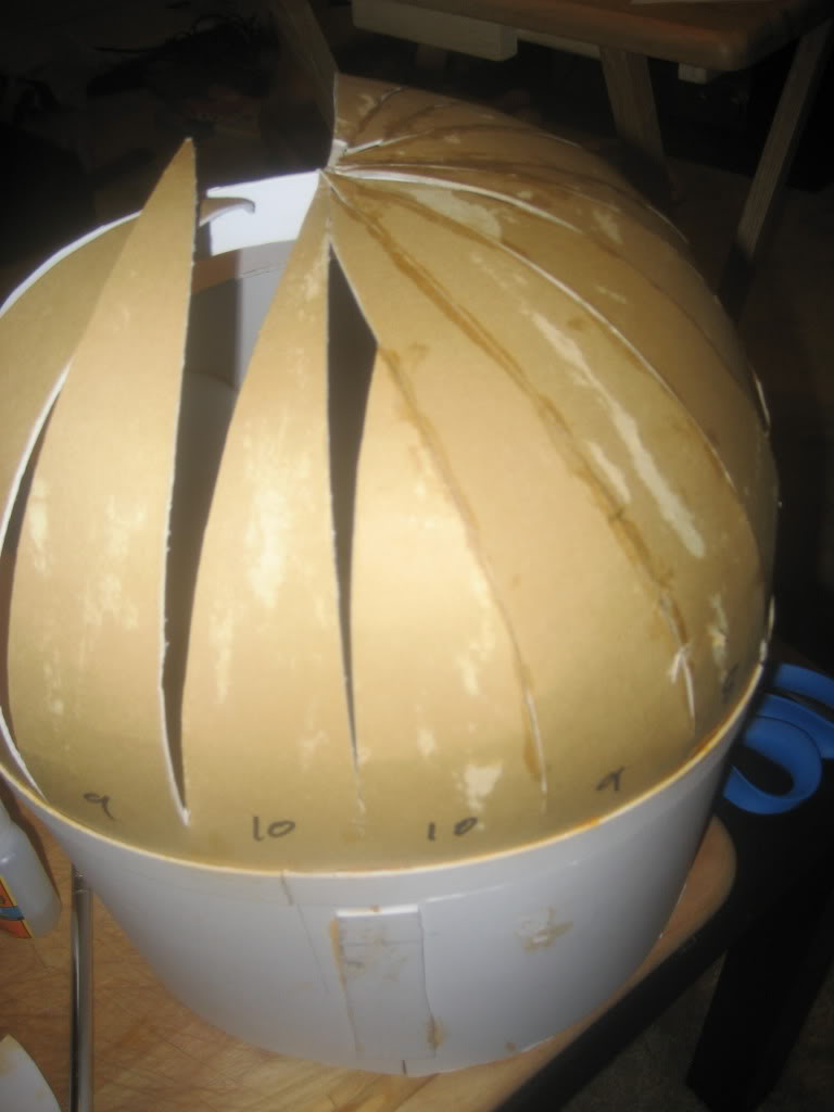

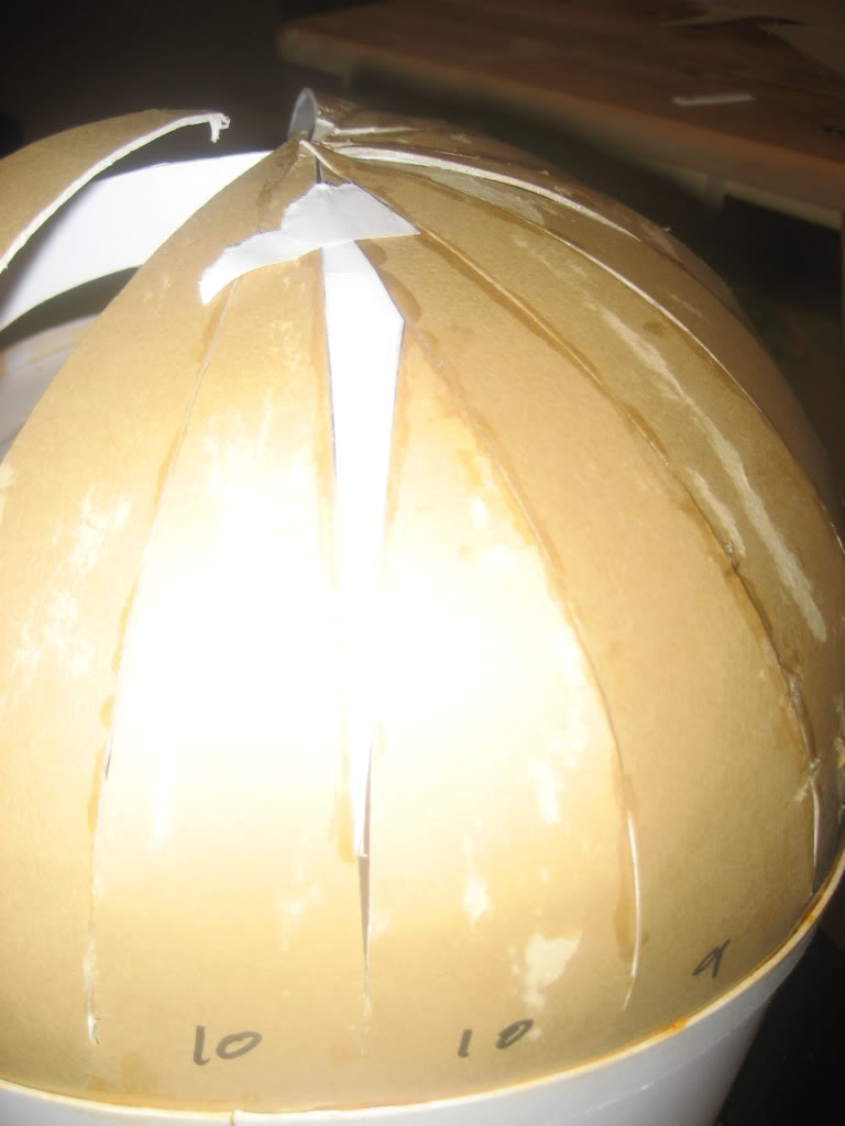

and finally closing the dome, working from the front in both directions to the back
more later after i've slept off all the fumes...

done with the cardboard build, 4 days at a relaxed pace.
will start bondo/ glassing after this hurricane/tornado passes and we stop drowning in rain.
on to next bucket at 110% and time to rig a paint booth.
I had to re-trim most of the triangles so they'd fit snugly,
not sure if that is normal or a result of templates printed wrong or a mess up of my own.

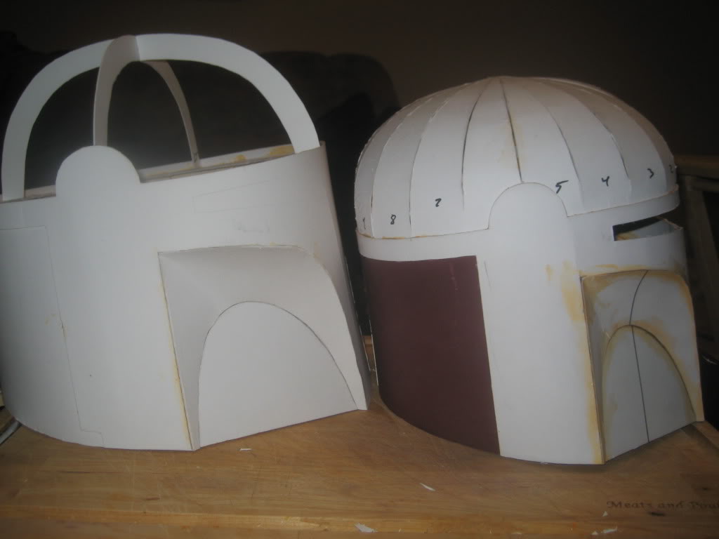

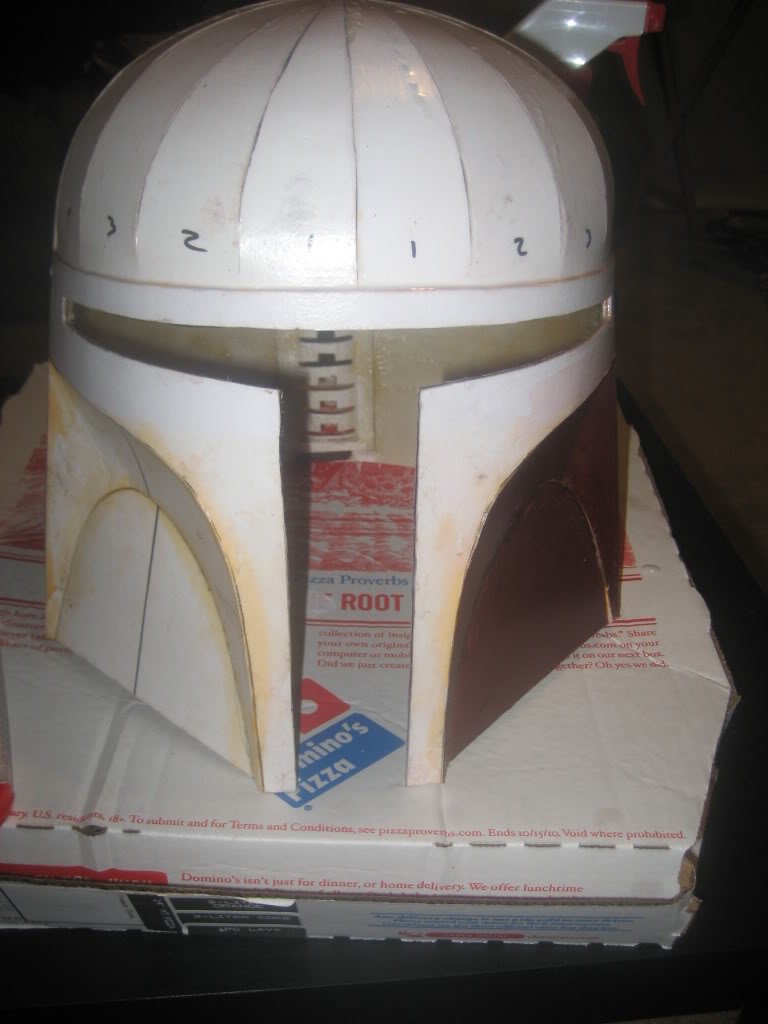

bucket #2 is taking shape much faster, only about a day and a half.

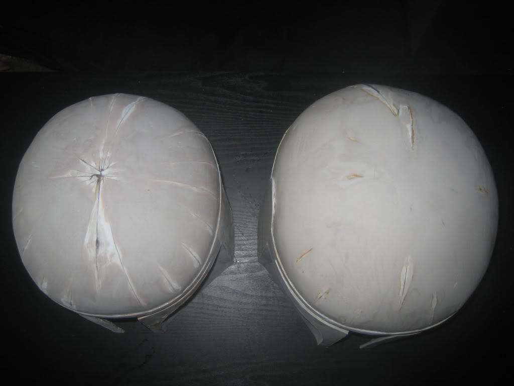

since bucket #1 seemed REALLY snug i figured i'd make one 110% and see how it comes out.
without further ado...

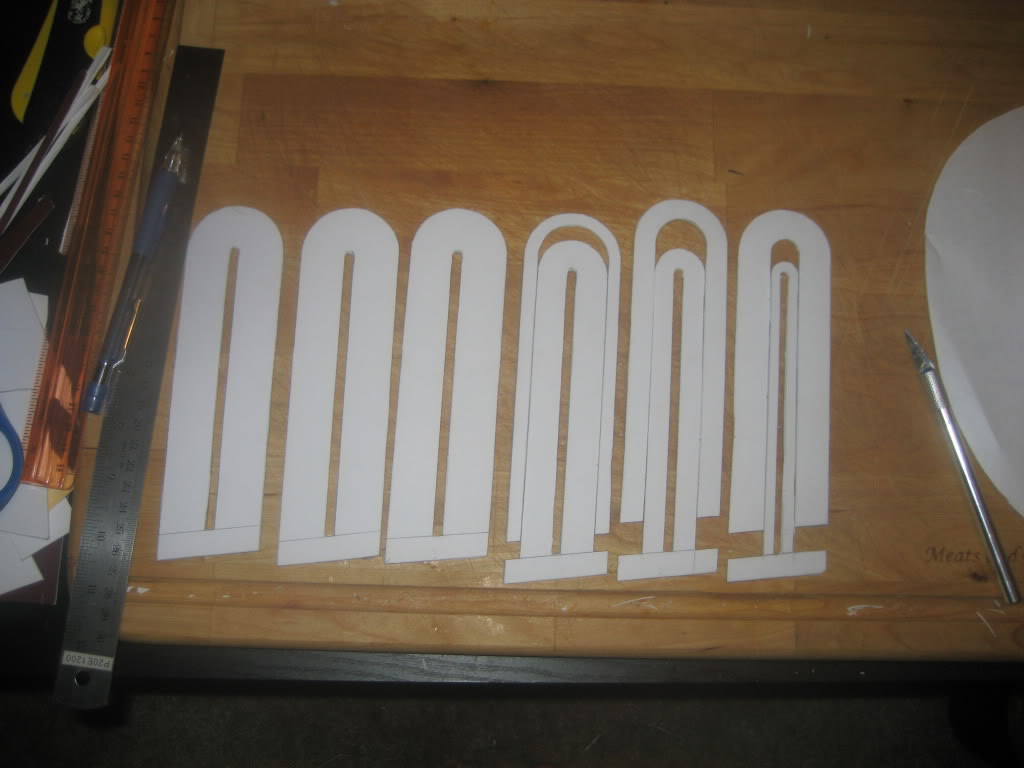

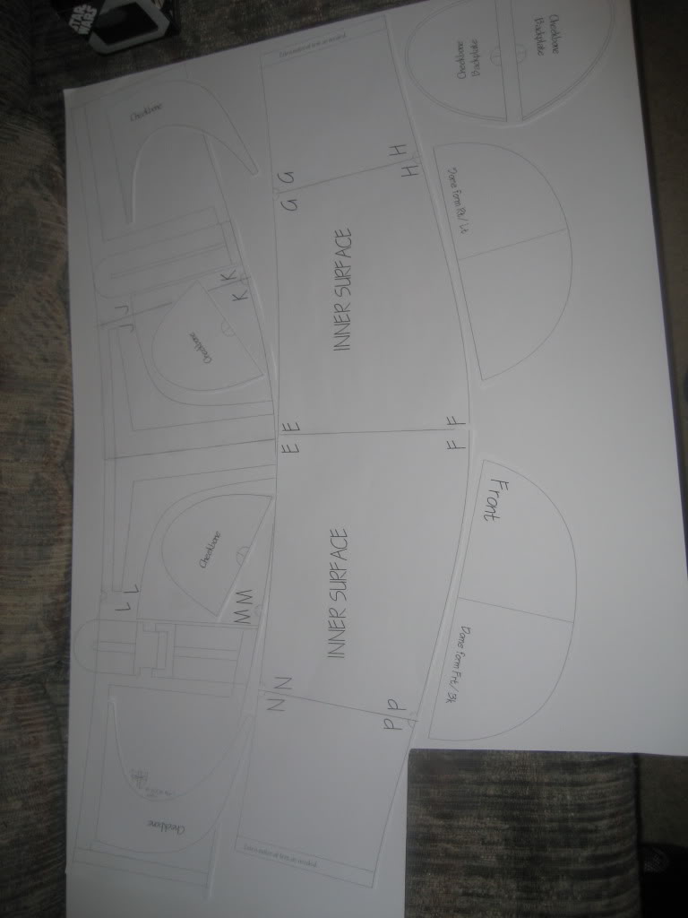

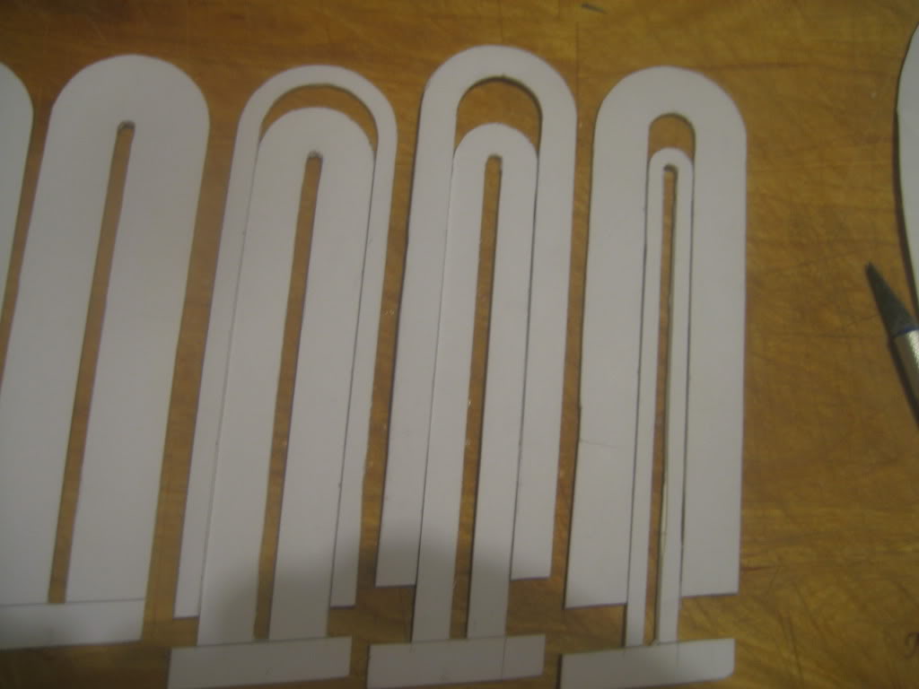

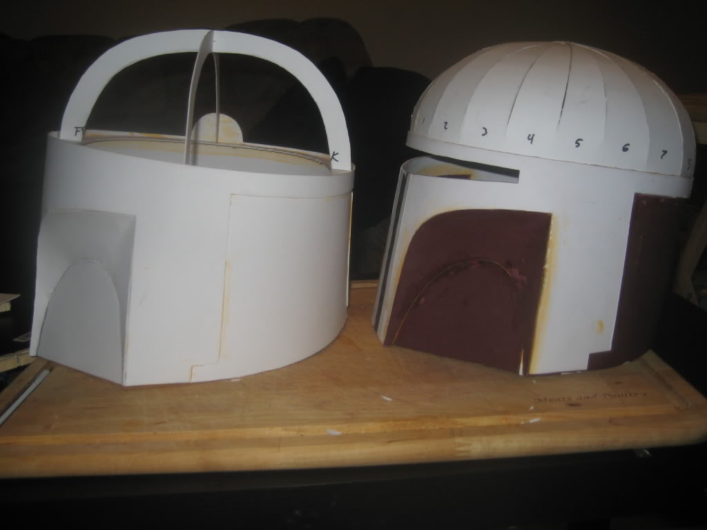

efficient template layout
and initial size comparison between #2 on left and #1 on right
currently working on cutting and shaping the dome pieces.
next up earpieces for both, though we'll be going RF-less.
the weather seems to have cleared up nicely so i'm anticipating sealing/bondo/glassing over the weekend.

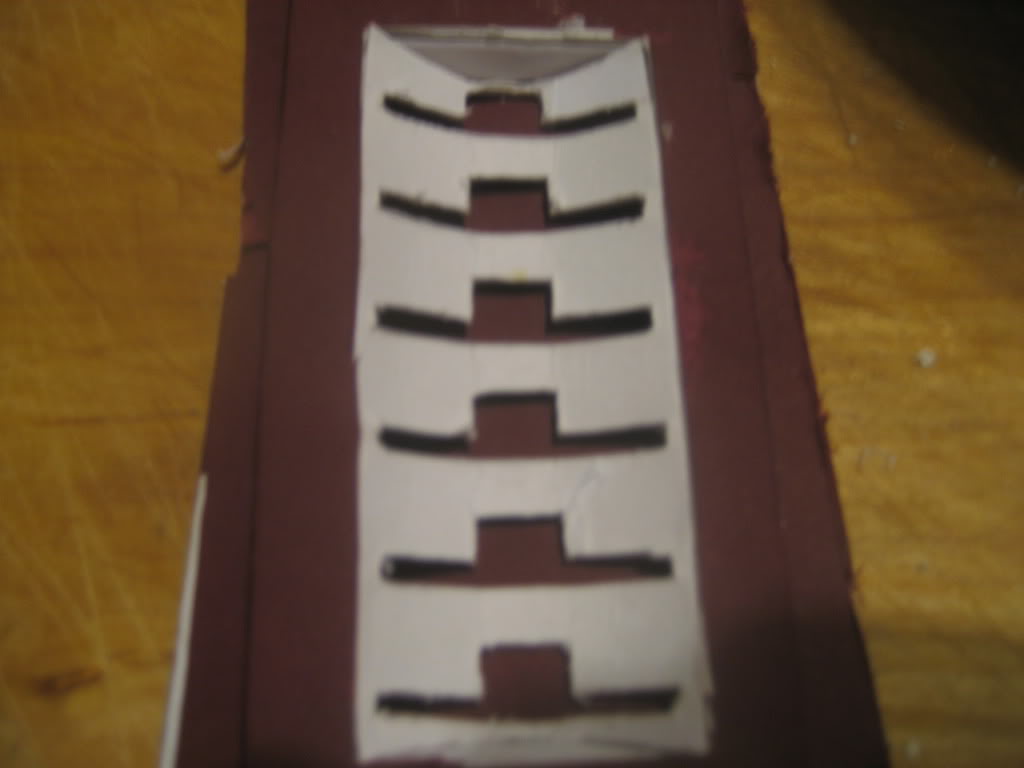

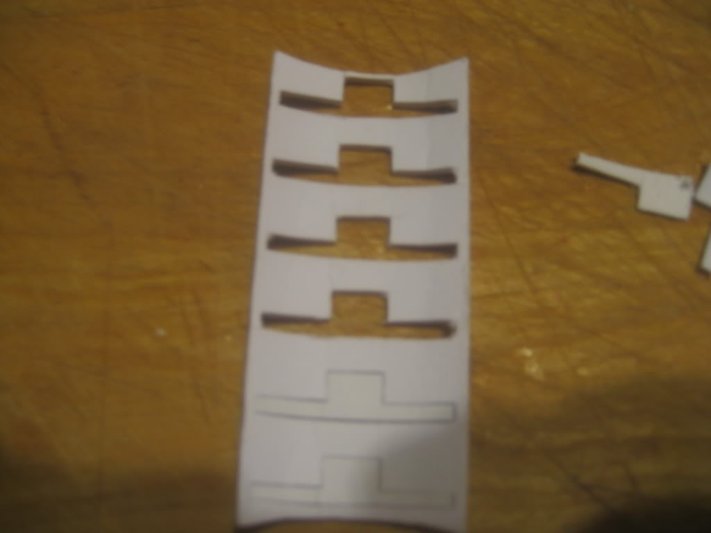

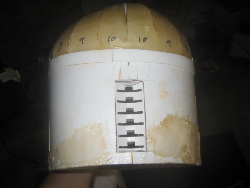

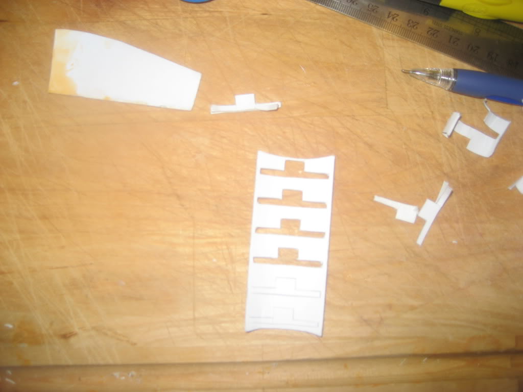

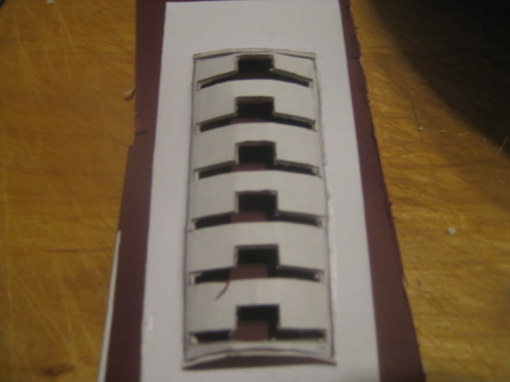

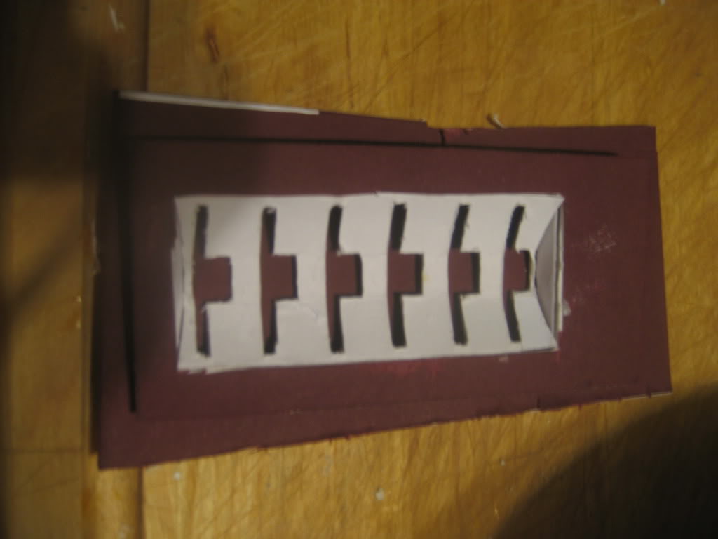

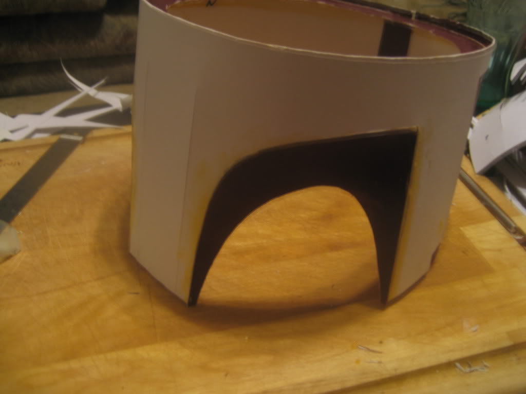

on a separate note, i discovered the hard way that one should cut cardboard on the side to be presented. after bending and cutting (in this order!)
the first keyhole slot (pics forthcoming), i had to cut out the keyholes from what turned out to be the backside.
it would have been MUCH easier to simply cut it out from the inside of the bend, not to mention a better looking end product.

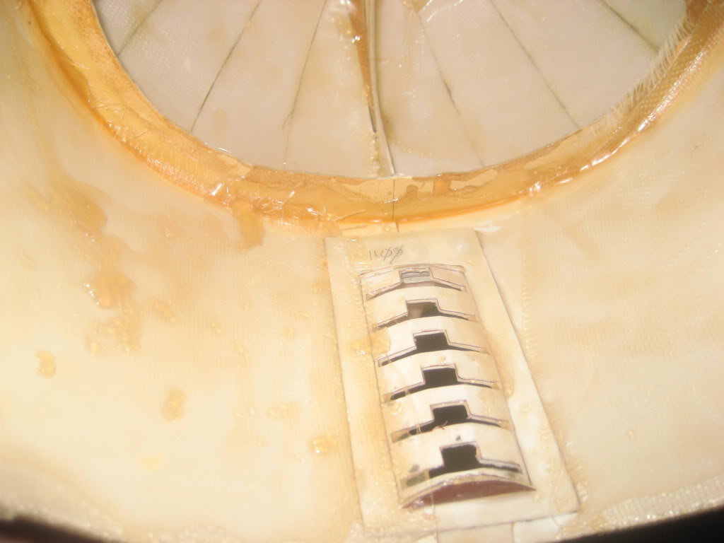

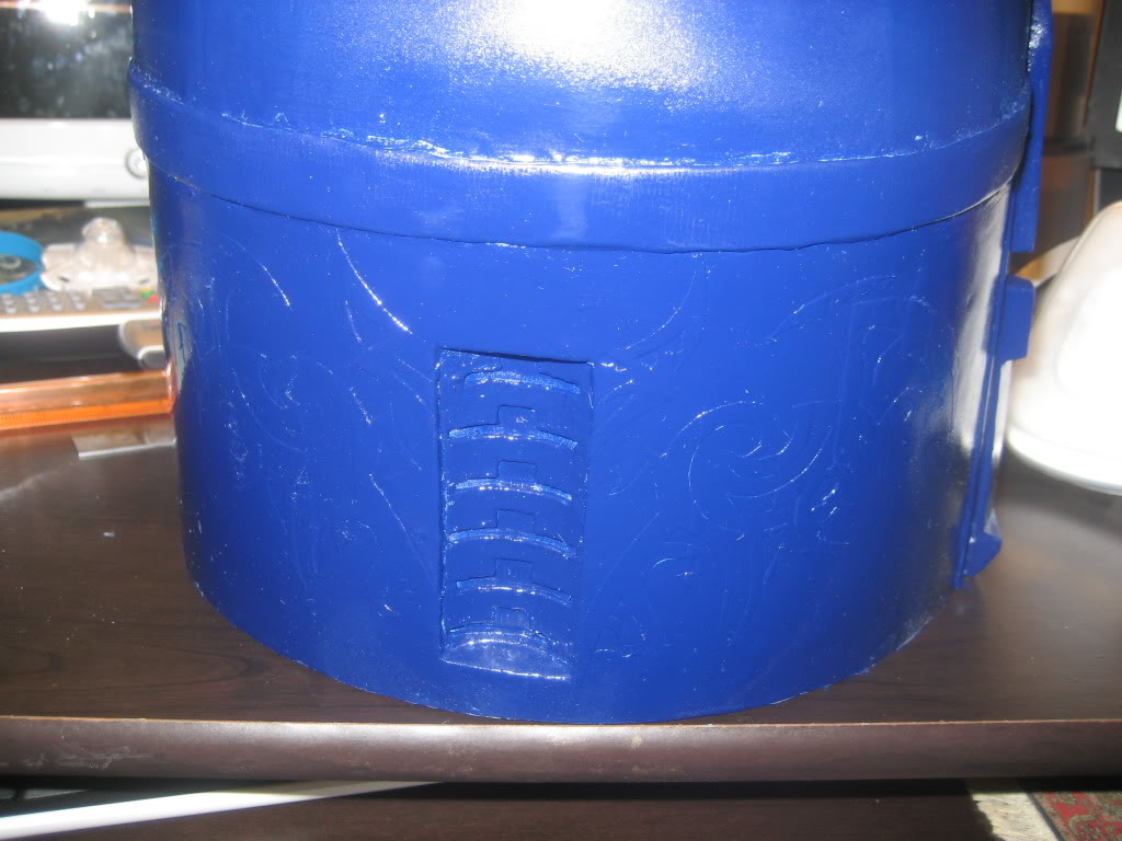

110% vent:
Ghostwalker
Jr Hunter
while the glue is drying a quick update:
-both rear vents are cut, cut out, shaped and glued.
-dome is closed on bucket #2
pictures are taken, will upload sometime later today.

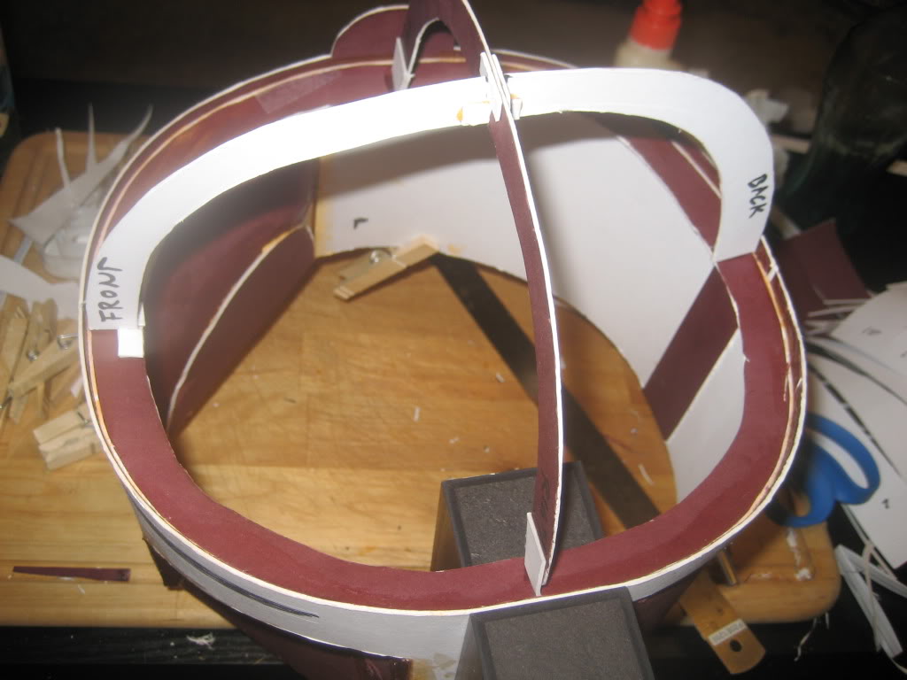

lesson learned today: when making your basic bucket out of the dome base form and the inner surface(s)
ensure the seam is in the front (what will become the visor area). if you look through Antman's threads you will notice that
his first bucket has the seam in the back (like both of mine) but his second one has the seam in the visor area. Reasoning behind this is
rather simple once you come to think of it... the mask will cover and reinforce the seam in the front above the visor and the rest of the seam
will be cut away anyway, leaving a perfect seamless rear end.

100% vent:

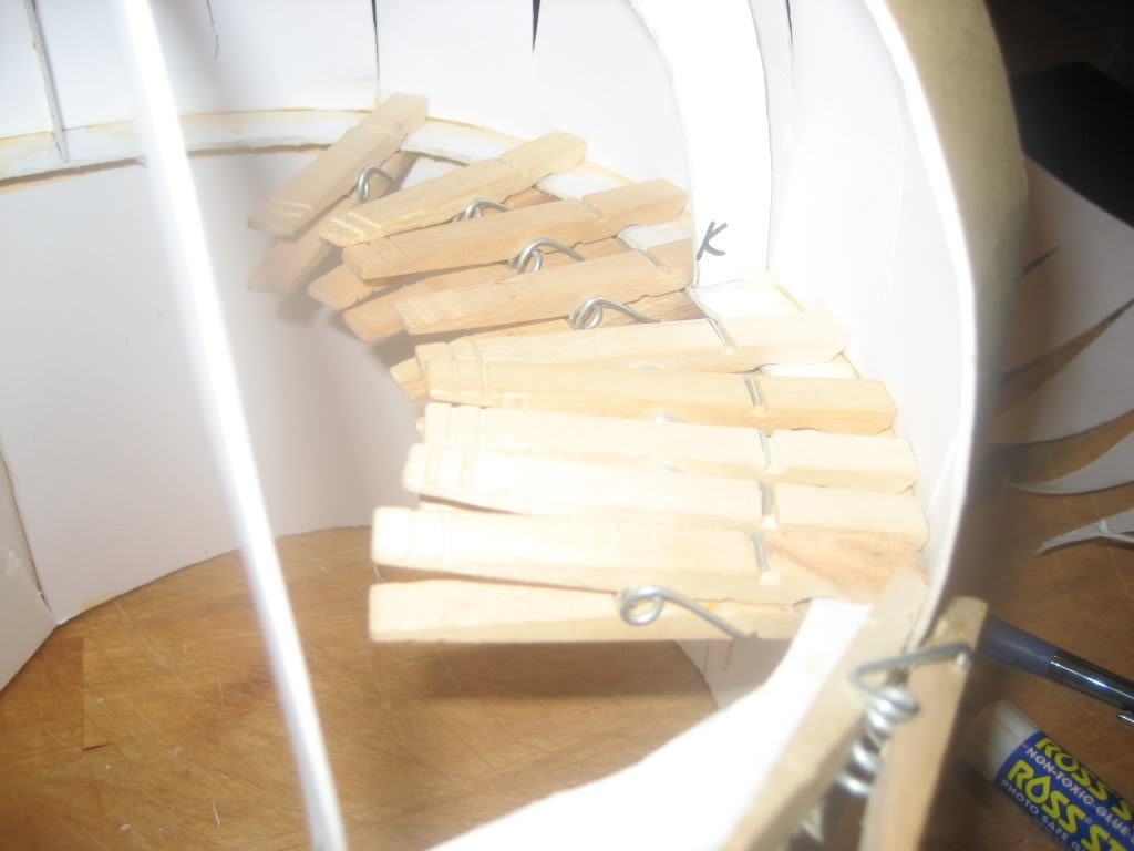

closing the dome (110% bucket):
the clothes pins are used to keep the dome part pressed against the rim and previous dome part during drying.
I seem to be screwing something up every time, this time i had to massively trim a triangle to maintain shape and bend.
nothing that can't be fixed by adding a scrap piece of cardboard though...

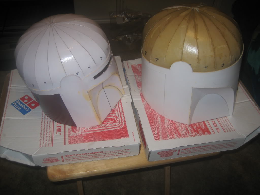

both Buckets drying off a double layer of minwax:

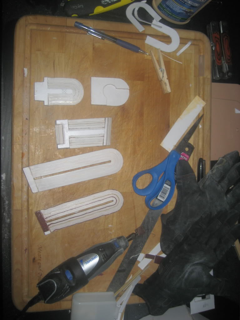

my fingers hurt after cutting all that cardboard, so I'm taking a break before building the 110% right ear.
this weekends lesson learned: splurge on a GOOD exacto knife/ razor pen... i bought the cheapo Revell razor knife and broke it about 6 times. turns out that the inner part that holds the blade and screws into the pen handle is made from ****** plastic that snaps quite easily and wont stay glued together.
Also ... wear gloves when carving with a knife, carve away from the body not towards it (remembered that the split second the knife sliced open my thumb.)
wearing gloves and safety glasses is a good idea when using a power tool (even a dremel)... one of my sanding things came off and bounced of my eyebrow... guess who went looking for his goggles?
without further ado, the pictures..

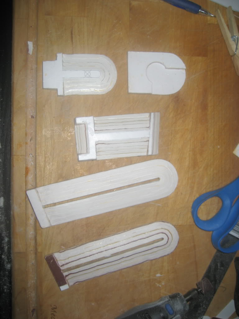

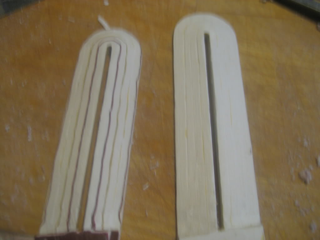

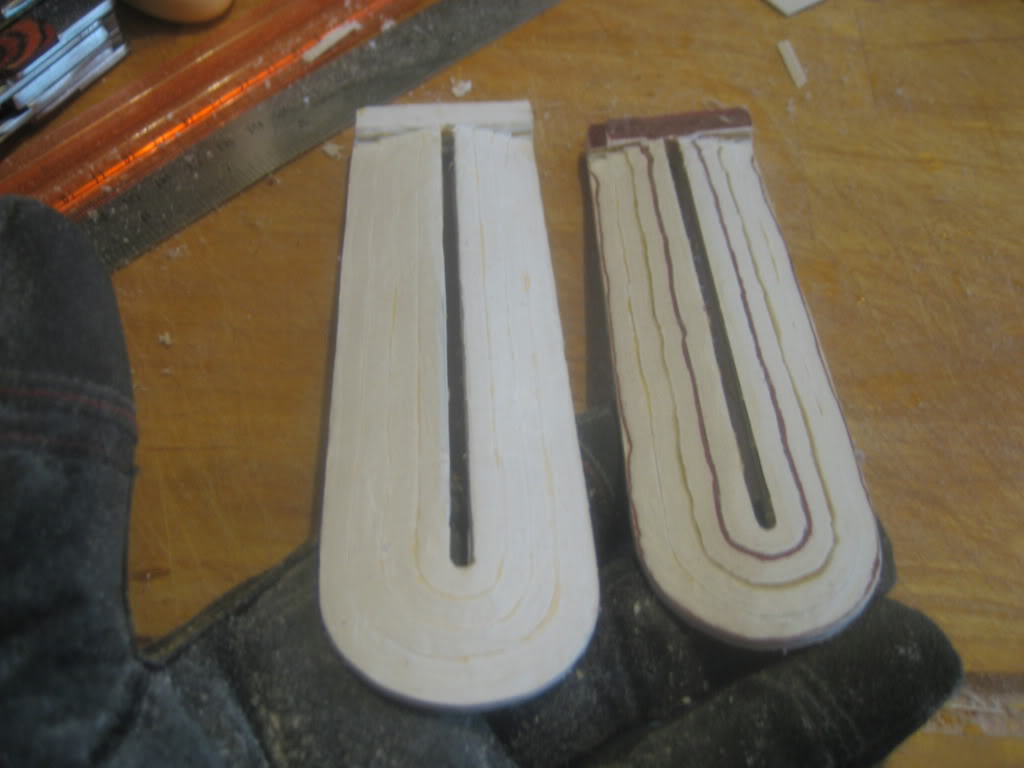

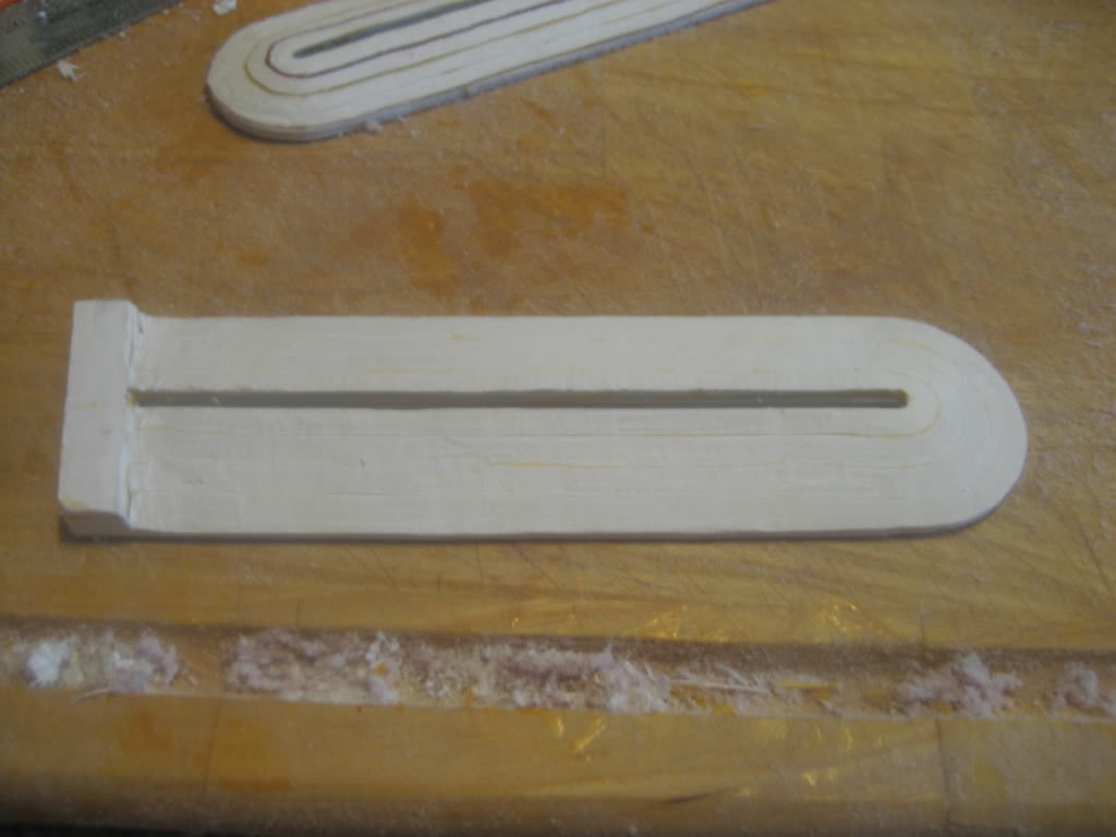

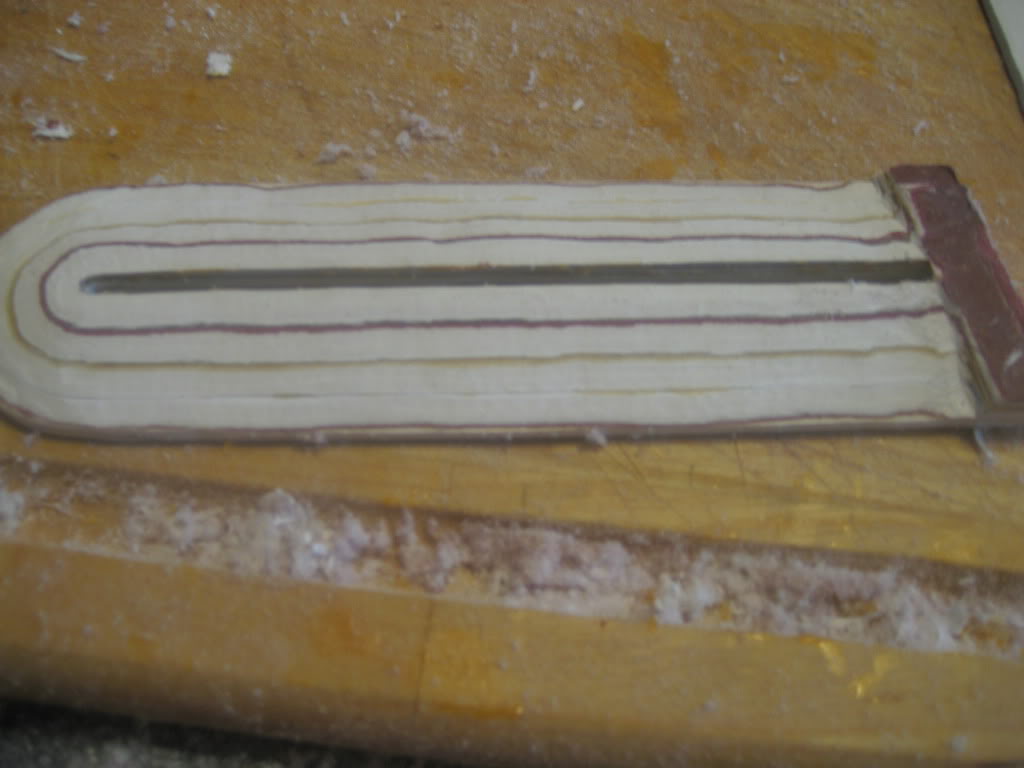

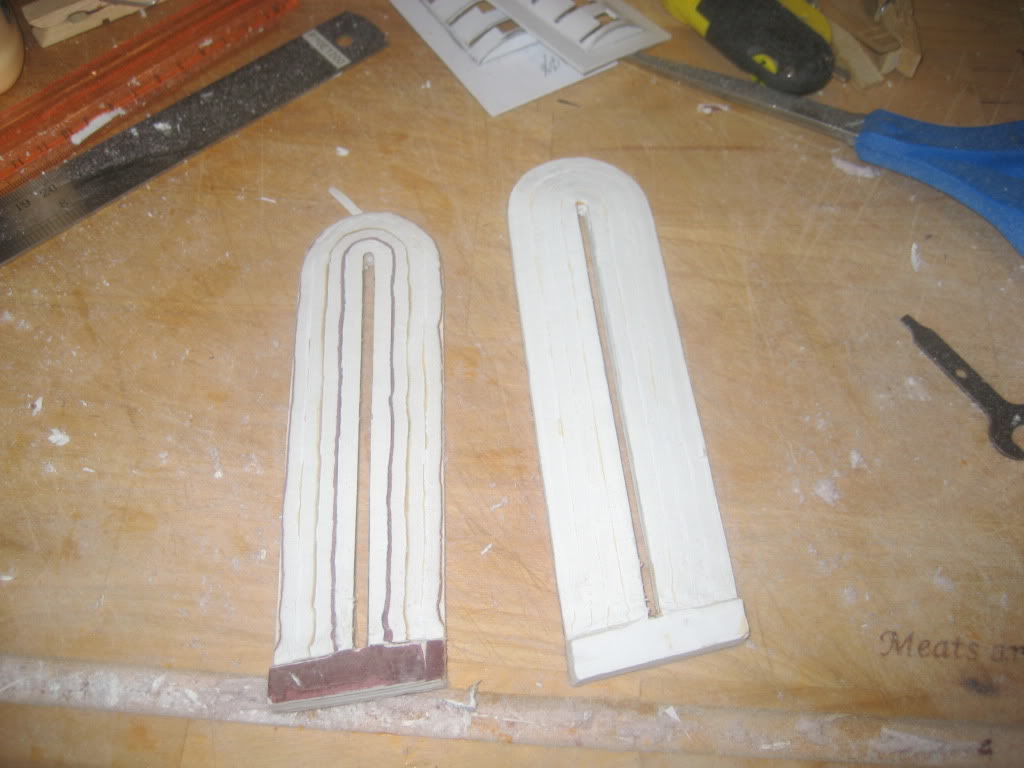

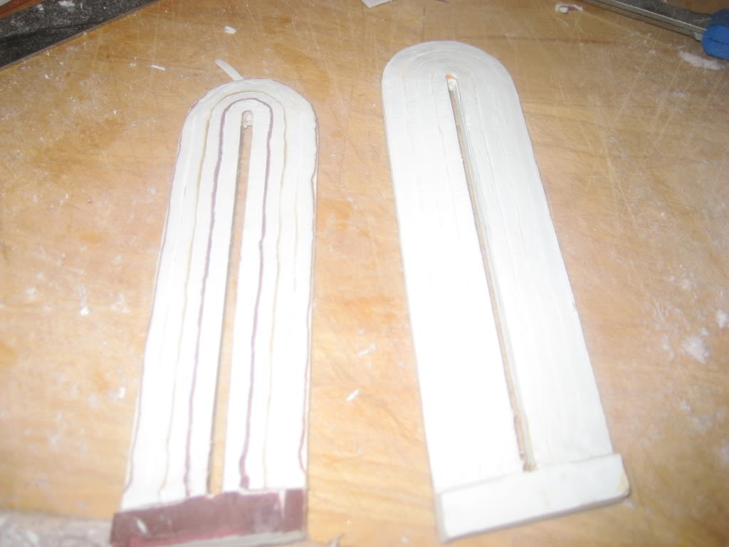

left ear piece, done straight ala Antman
I forgot to take pics while drying and during the MTE stage as i was building the others.

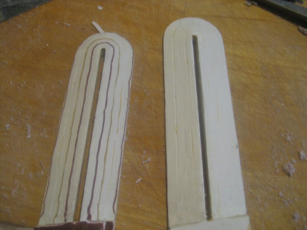

here are both 110% and 100% left ears, the 100% has an amazing layer effect due to different color cardboard used in the layers.
those layers actually helped me sand to a uniform angle all around.
all 3 ears are made 100% from scrap cardboard accumulated during the bucket construction.
the 110% left ear, and both 100% ears including cap
close ups of left ears
100%
110%

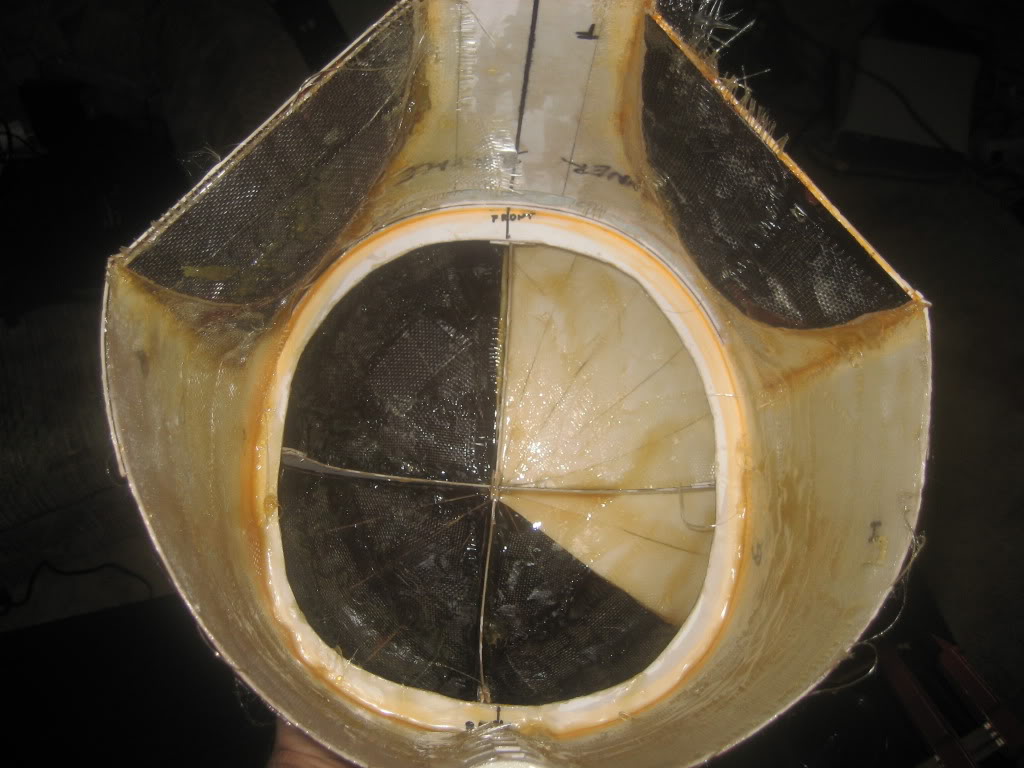

I could use some advice on whether to glass the inside first or bondo the dome/cheeks first?
Ghostwalker
Jr Hunter

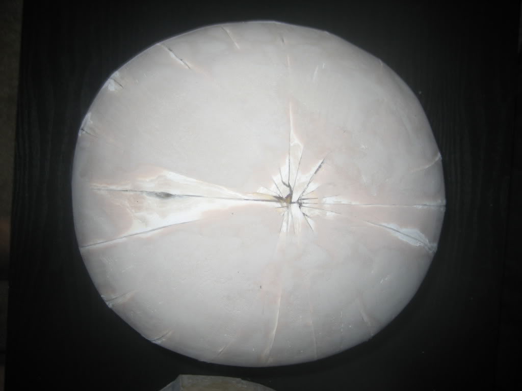

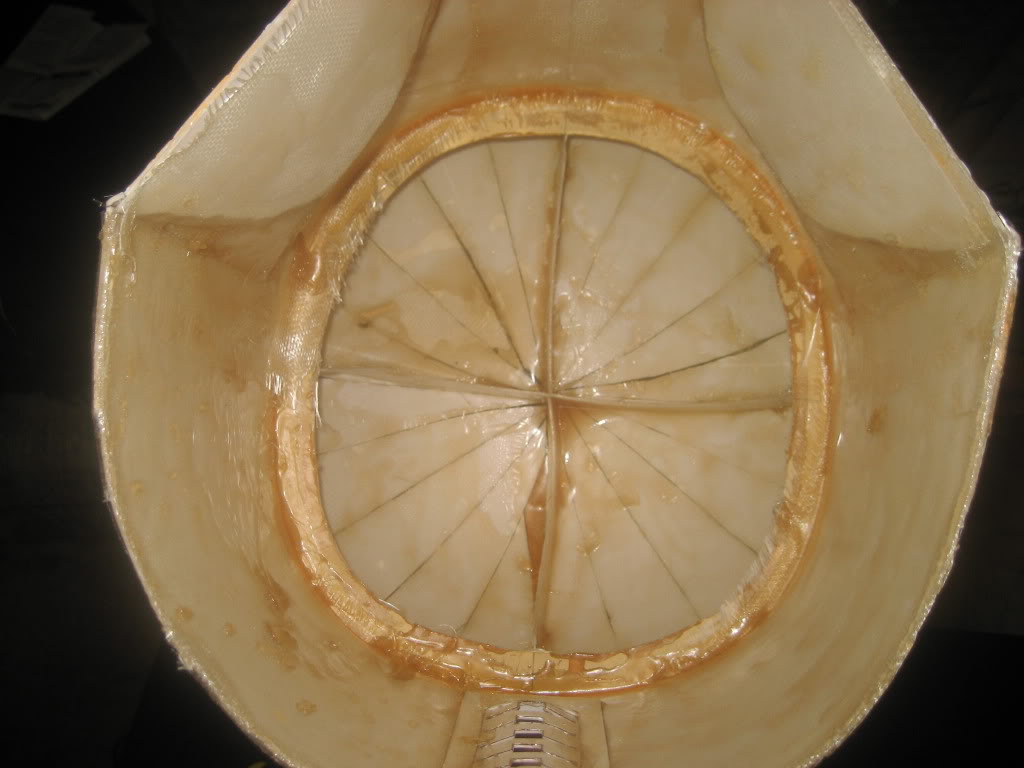

decided to Glass first and bondo later.
after a bit of trial and error i ended with the following results:
100%
110%
I have slowed down quite a bit again, having to teach myself how to work with fiberglass.
next round of buckets ought to be much faster as i shan't have to figure things out again.
As it stands these Buckets are darn sturdy but yet give a little.

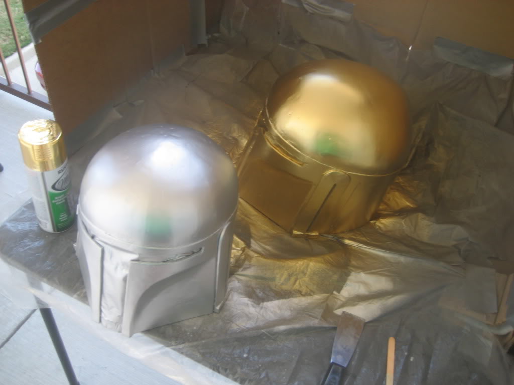

Next up:
- Bondo Face on 1:1 bucket,
- Add another coat of Resin to the inside of both buckets.
- Face shields got here today and are ready to be fitted.
- Prime and paint.

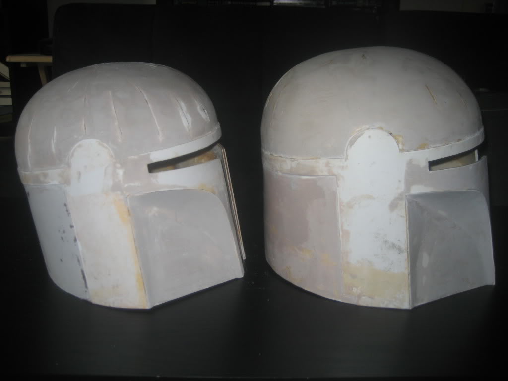

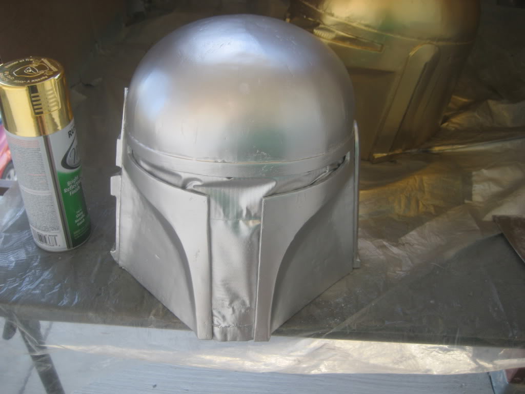

Camera recovered from it's POW camp deep in the jungle of my wife's desk drawer.

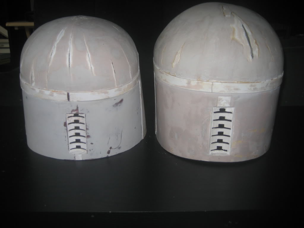

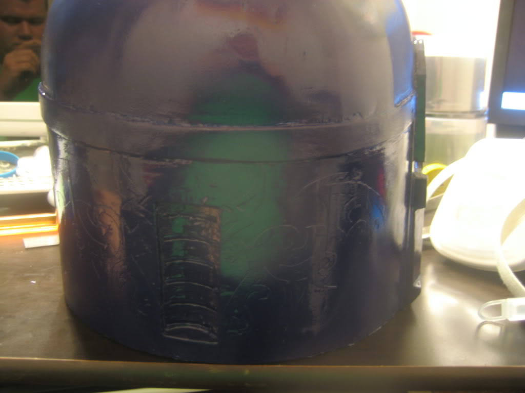

The Buckets post Bondo
Left side
Front
Right side
Top down
1:1.1 scale top down
1:1 scale top down
not much to say really, the 1:1 Bucket looks like it could use another thin coat in the photos but in person the edges are almost unnoticeable.
The big bump on the back right side of the 110% Bucket is still easily noticed in Top down view, much less from other angles.
I have decided to keep it as it is and make it look like a sloppy weld job fix.

Quick Update:
Last Ears built Sunday, sanded, shaped and glued onto Buckets Monday, Bondo'd seams and Ear surfaces today.
It is a really good idea to Bondo the ear pieces BEFORE gluing them onto the Bucket.
Tomorrow will be a right pain in the shebs when I have to sand them on the Bucket.
Also laid another coat of Resin (no mat) on the inside of both Buckets.
It's a lot smoother now, all sharp edges, pointy stabby bits are no longer.
It also gave me a chance to fill in the areas that had previously bubbled up and underfill some of the raised areas of mat.
The rigidity of the Buckets was noticeably increased by this extra coat, they are much stiffer and quite resilient to impacts.
Ended up accidentally proofing my work when the 110% bucket rolled off the table while I was coating the 1:1.
Four foot drop onto concrete, impact on the crown ... bounced and rolled no damage sustained whatsoever, not so much as a scratch in the Bondo.
I really hope to wrap up this build over the coming weekend as I need to get cracking on 2 sets of Armor plates.
Armor Party is coming up fast and I need to be ready, best case scenario with Buckets in hand.

many coats (layers) very thinly applied.
I used a small scraper and put a small "sausage" of Bondo on the end.
Then start at the bottom of the dome (i rest the clean side of the scraper on the top of the ring) i scrape the sausage onto the dome in an upwards motion.
VERY THINLY! Move from Triangle to Triangle around your dome. Let it set and start sanding each Coat when it is hard. Sand around the Dome horizontally and over the top from side to side. You will lower your "Ridges" and barely sand your "Valleys".
This is a bad drawing of the ridges and valleys of the dome, with "---" representing the layers of Bondo. ( the "..." are for spacing)
1. Coat
___ . . . . . . . . . ____ . . . . . . . . . ___
\_______/ .. . . . .. \_______/
2+ Coats
___ . . . . . . . . . ___ . . . . . . . . ___
\________/ . . . . \_______/
Last Coat
___ _ _ _ _ _ _ _ ___ _ _ _ _ _ _ _ ___
\__________ / . . .\__________/
for the Larger Bucket I needed 5 Coats before my "Valleys" were filled level with my "Ridges". You can still see the different Coats by their slightly different colors as they near the "Ridges" they feather into the lower Coat then into Cardboard and in some of the very tall "Ridges", Resin.

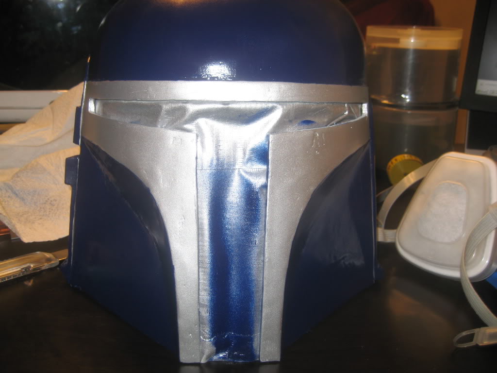

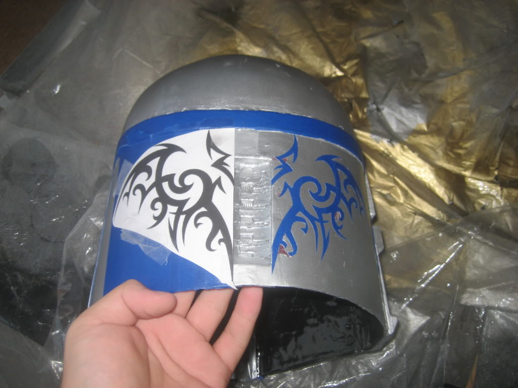

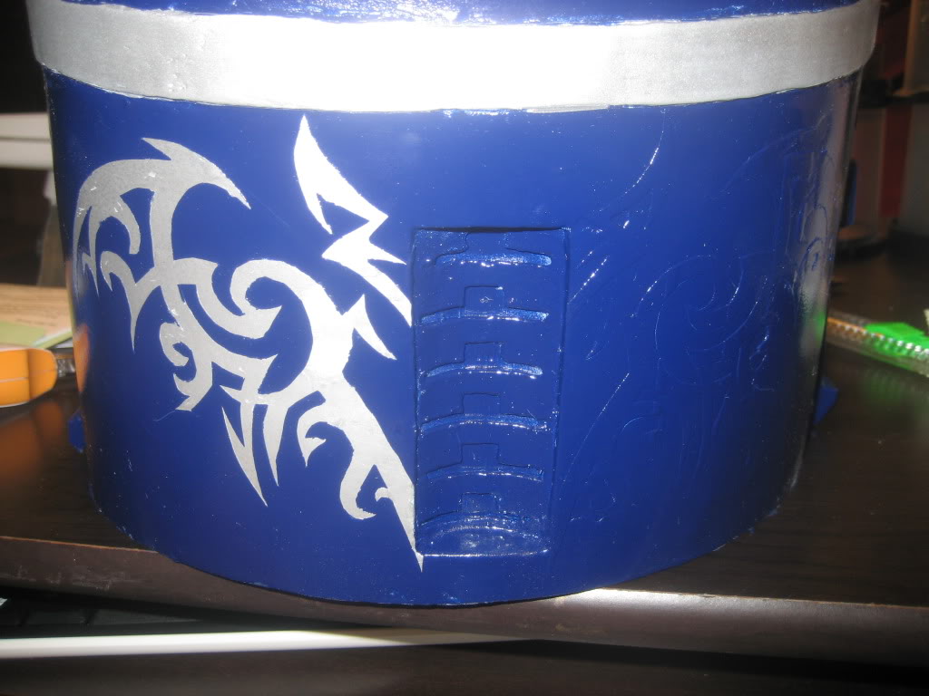

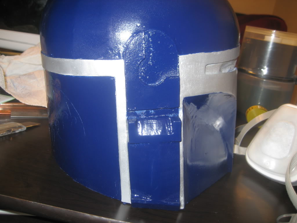

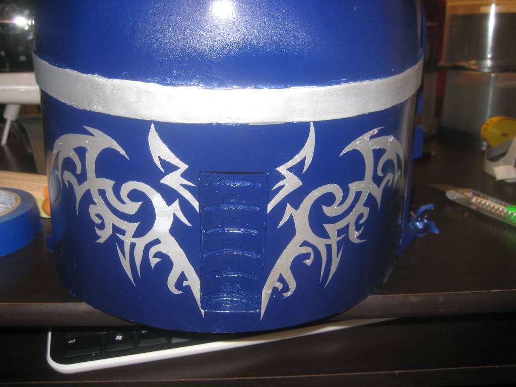

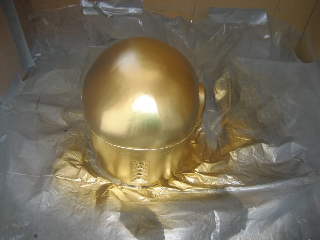

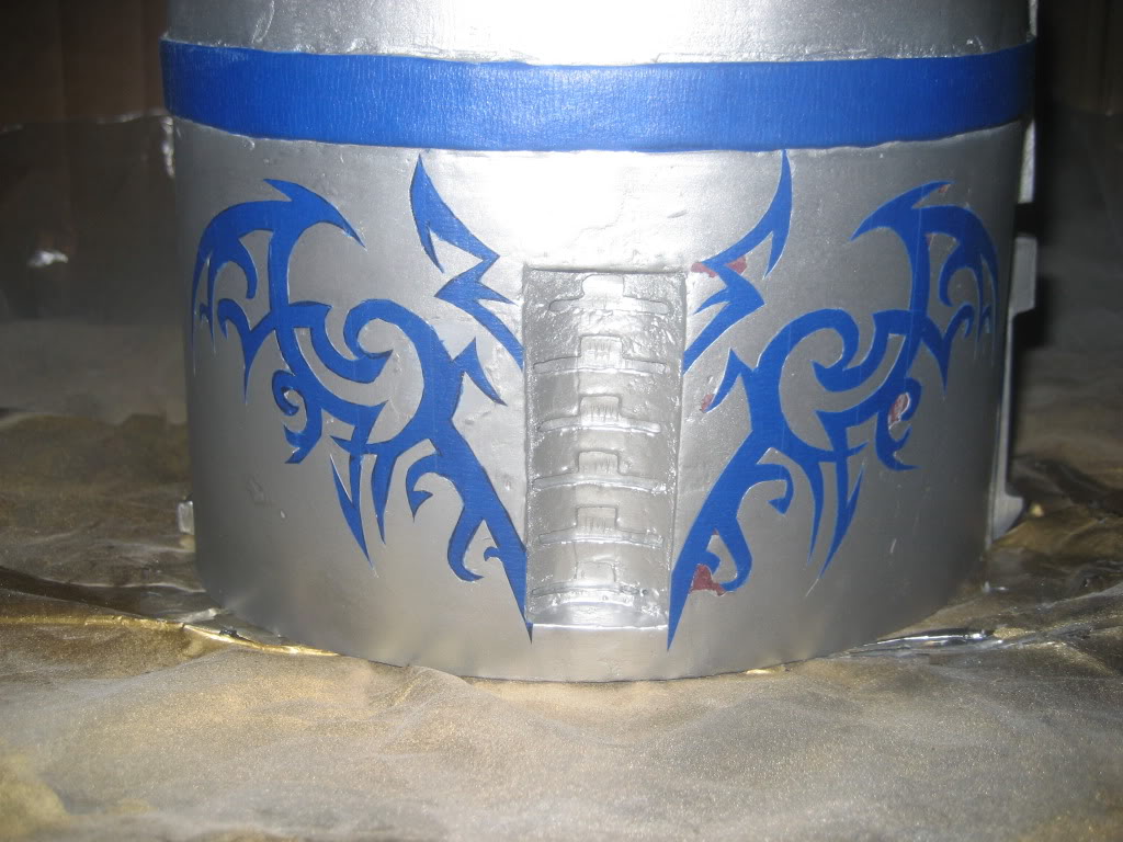

okay too long between photo updates!
I'll spare you photos of primer gray buckets.. enough of those around.
LET THERE BE SHINY-NESS! (cue lighting and thunder)
Silver is my Wife's 1:1, Gold is my 110% Bucket

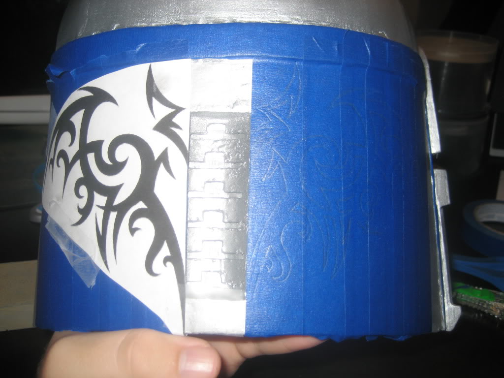

still too vanilla, let there be eyecandy!

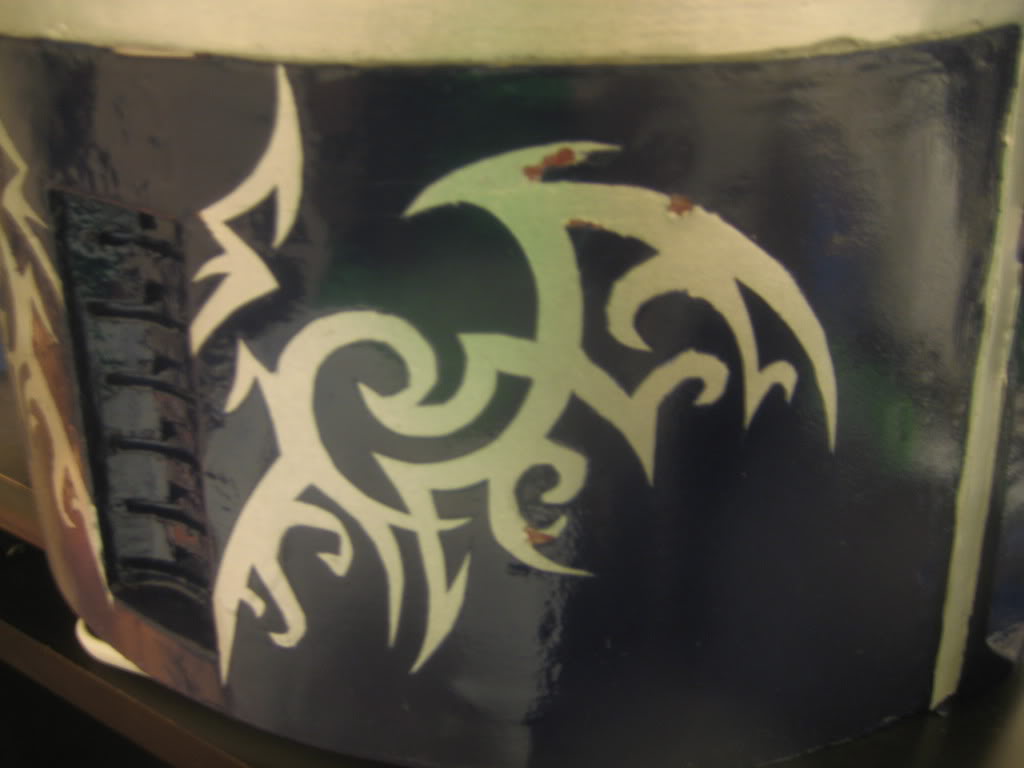

transferred, traced, cut and peeled.
phew done, just in time too. the light is fading and my hands are cramping.
time to take the Shyness down a notch, neighbors are trying to tan off the reflections.
where my wife decided on a negative Jango, I am going with the time old favorite... Black
some Eagle Eyes may note that there is more masking tape on my Bucket than strictly required.... well spotted.
my design is a surprise, not quite as elaborate as my Wife's though.
there you go, hope I delivered what you were expecting to see today.
until next time Vode.
