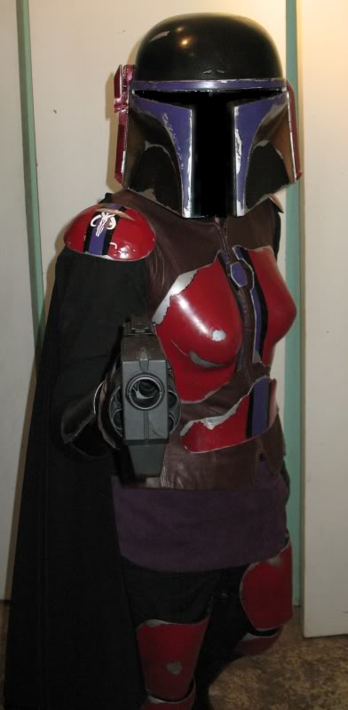

This is my very first kit. I wanted it ready by Halloween and am very aware that I have much to finish, but everyone at work loved it. My coworkers think I'm such a big nerd and I truly agree with them. I'm trying to have this finished by the Fiesta Bowl Parade in Phoenix, so everyone wish me luck. Still need to get a clavicle piece, girth belt, leather pouches and some fine tuning with the flight suit. I'm definitely thinking of going with a 2 piece. I'm also needing a smaller helmet since mine makes me look like a bobble head, :lol:.
A big thanks goes to Solus Kyr (One End-Thomas), my twin sister-Sandra (she sewed the cape and made adjustments to the flight suit) and to Co Loar (Variant) "Allen" for all of their advice, help and much needed information:thumbsup: And of course to my wonderful husband for supporting me and helping here and there with the hard parts. Hey, I did the bondo, sanding, painting and cutting out pretty much on my own. He helped with the snaps, cutting the thigh armor and taking off all the soft parts from the catchers gear.

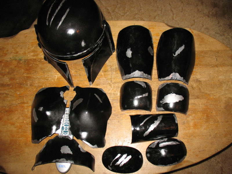

Top left gauntlett. I used sports armor and basically cut out all the foam and then used bondo glass to fill in the holes and smoothed it with a dremel and then used sand paper to smooth it even more. I didn't think about taking pictures of what it looked like before I started making changes. :wacko
I used a baseball catchers shin guards for my thigh armor. I cut off the portion by the knee and then filled it with bondo glass and smoothed it with a dremel and then sand paper.

I used rubber cement to make a weathered look on the armor, then spray painted it black.
I decided later, that there was too much weathering so I got rid of some of it. This is a picture before I made that decision. I forgot to take pictures of it painted red. I would rub off the rubber cement then apply a fresh coat and added a coat of red paint to give it a chipped paint look.

My almost finished kit. Were in the midst of remodeling, so excuse the mess. I still need a clavicle piece, girth belt, leather pouches, gun holster and of course a new T-visor. The helmet is considerably large, so I'm going to go with a Rubies Jango Fett 1 or 2 piece. I should have read the tutorial that Falin Skirata had for sizing helmets. Hey, it's my first bucket and I'm definitely learning :)
http://mercs.firespray.net/forum/index.php?topic=13291.0
Thomas warned me about the pony tail/hair sticking through the holes, so I'm fixing that and should probably have a bun or something. I'm shortening the cape about mid-thigh length. My twin made it a little on the long side. The cape looks great, though.
So let me know your thoughts and any suggestions. :)

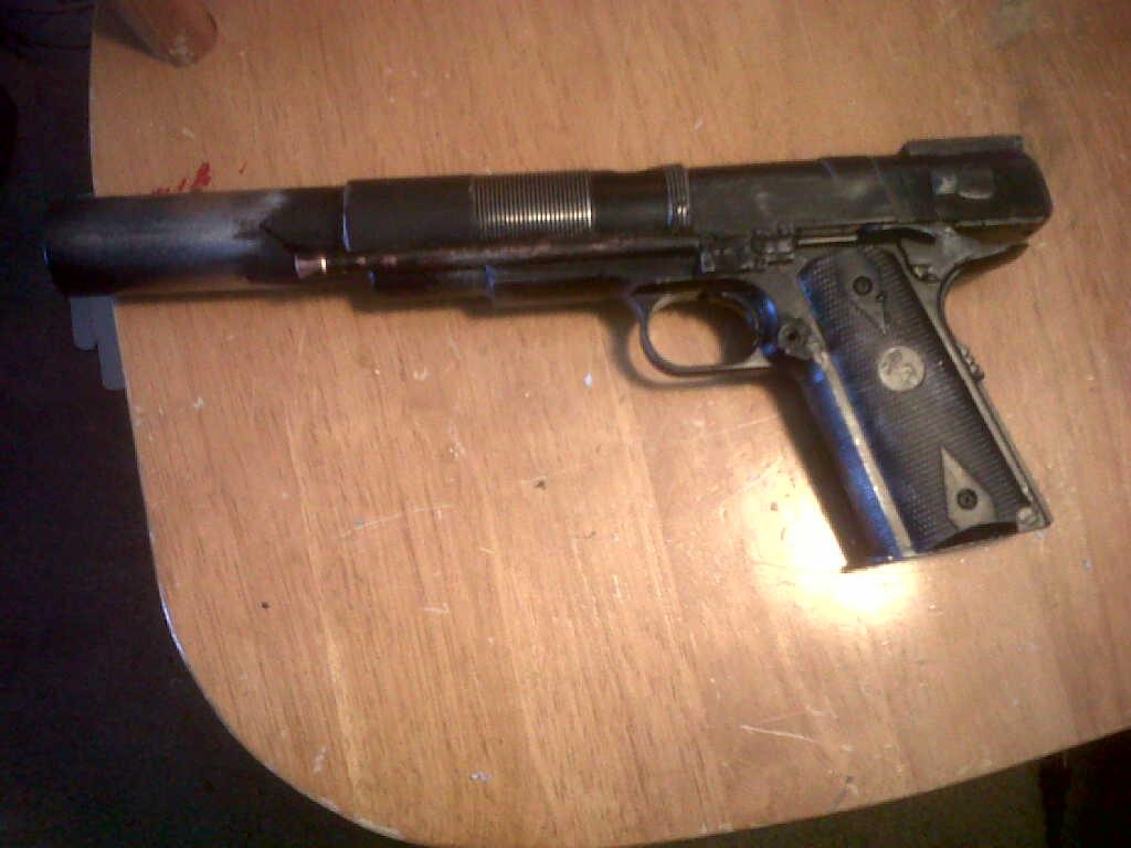

Sorry I haven't been on for awhile, so I have a lot to add. I've revamped my kit and the changes have received incredible responses. Phoenix Comic Con 2010 was my 1st con in full gear and it was a big success, 14000 in attendance, not including children. Also I became an official member of the Mandalorian Mercs just before Fiesta Bowl Parade 2010. Thanks to the help of Thomas (Solus Keer) Mandalorian Mercs and Allen (Ca-Loar)/Variant. Thomas made my holster and Allen made my gaunts and blaster. They also attached all the armor to my vest. These guys are awesome.
