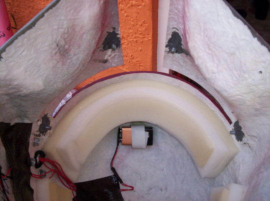

for the visor installation I used 2 part liquid metal (similar to JB Weld) to place bolts on the lid. You have to make sure that there is substantial mixture around the bolt heads as well, this is very important or the bolts WILL snap off (see the pic)
This holds the visor with no probs at all :)

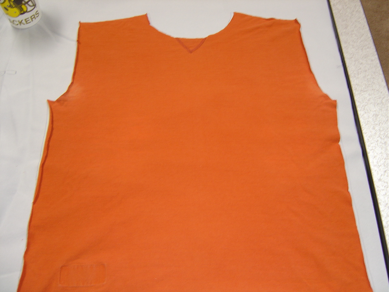

Sorry it took so long to get these posted. It was a fairly raucous 4th weekend with the family! But here are the pictures of my vest progress so far.

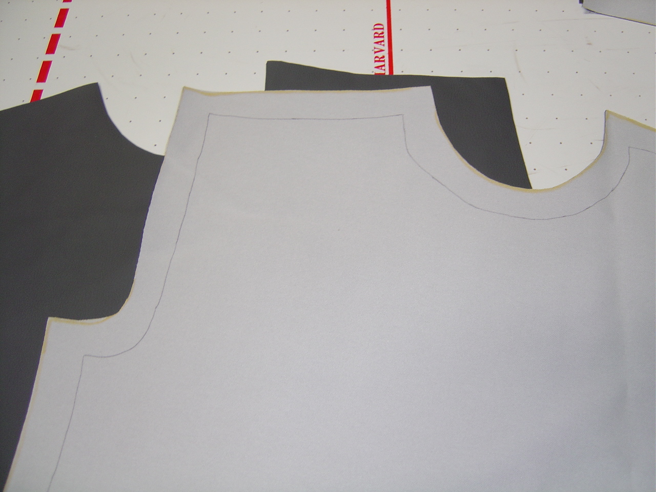

First I traced an outline of a t-shirt that had the fit I was looking for in the vest. I left it a little long in the waist on purpose. This way I have some length to play with until I decide where I want the waist to fall on the jumpsuit. Most of it will be covered by girthbelt anyway.
Next I made another line that follows the traced line to allow for extra material during sewing. This will allow me a little room as well should I want to reconsider the fit.

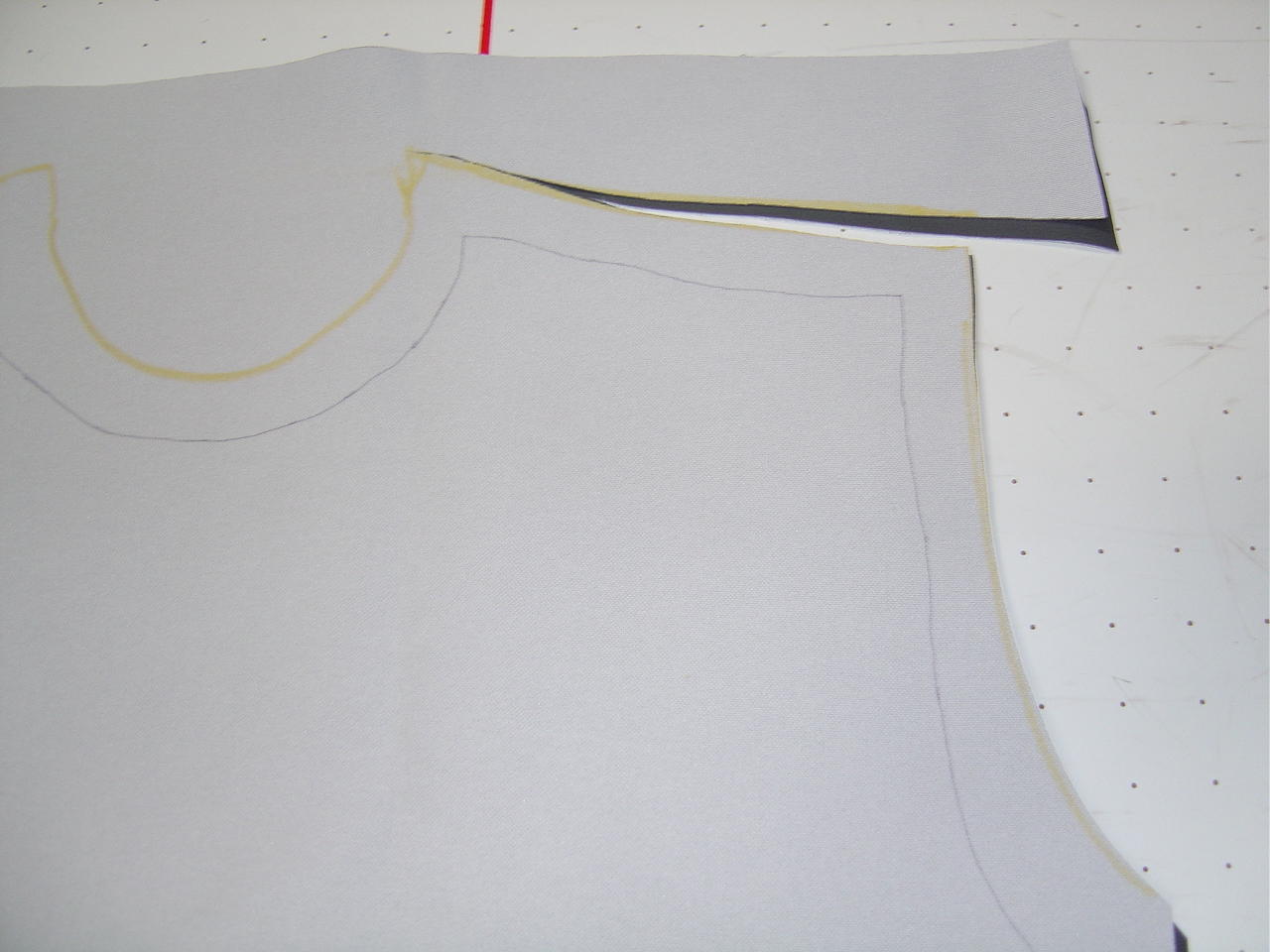

Third, I folded the vinyl in half and cut along the outer yellow line. This gives me two equal halves for the vest.

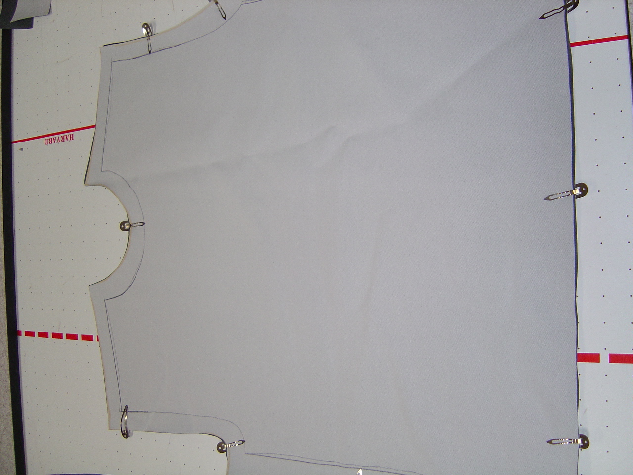

Next, I pinned the two halves together (gray sides facing each other) with sewing clips. Also, I used a straight edge to sharpen and even the inner line where I'll sew. I want them to be as even as possible so the vest will lay correctly on both sides.
I'll post pics of the actual sew line and the fit tomorrow. Didn't mean to dumb this down but I wanted to be clear about what I was doing.
are you going to drill holes on visor?, and if so. will the vizor not crack? lookin really pro. i always wanted to istall the vizor this way ... but wasnt sure if the vizor would crack or not

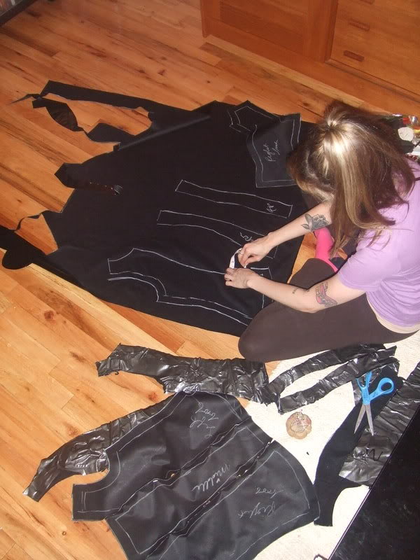

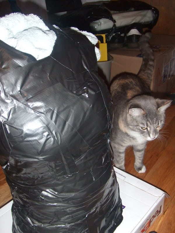

This is a duct tape cast of my torso. I learned about this awesome trick to getting a custom form- fitting vest design on the Mercs Board. Again thanks to everyone who helped out, hopefully the vest making mystery is solved for more than just me. :)
Yep holes need to be drilled in the visor (as long as you are careful it should not crack). It is important to drill the holes in the visor first, as you will need to line up the visor in the helmet in order to mark where to place the bolts.

Thanks for posting those pics. I was wondering if there was a trick to the vest. I wanted mine to sit closer to my body, too. I figured I could use my little duct tape friend as a model, but cutting it and using it as a pattern never came to mind.

To ensure that the visor doesn't crack when you drill the holes, tape it with painters tape ( I find the green stuff works best ), and drill slowly and carefully. I find it best to support the sides of the visor, on either side of where you're drilling. I rest it on my lap as my legs will give a bit, yet still be solid/stable enough to prevent the visor from flexing too much. ;)
