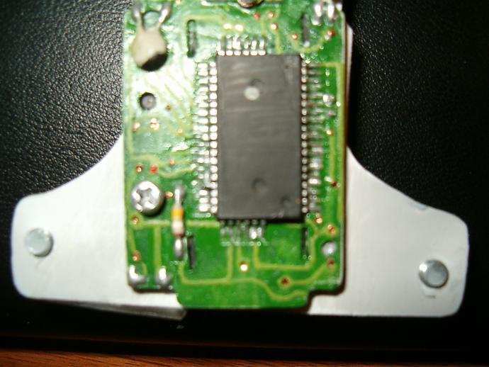

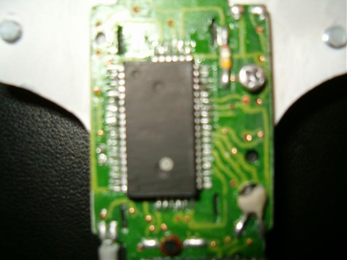

want to know what you guys think...good and bad b4 i mount this to the bracket. i have a few slight touch-ups yet, and the brown is still only a base coat.....i just couldt do nemore at the time... man all the details are soo tiny! :wacko good lord my eyes :lol: and my cam suks too only 3.2 mgp.so sorry for the jumky pics.
Looks good to me, but what do I know.

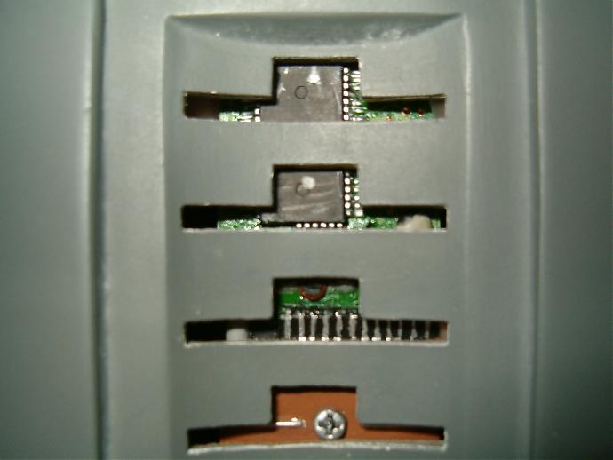

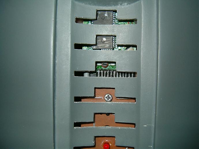

I do know it sits behing the keyholes on the back of the bucket, but how much can you see. Can you post a pic when installed?
here is a couple pics of it mounted behind the key-slots. (key-slots are only rough trimmed yet) ...i added a lil red light for kicks (non-functional)
ill tell ya, a great cast can show some amazing detail! thanks to FP ;)

I can't comment on if it's screen accurate, but I can say it looks well made. Nice job.
that looks great, i thought it was the real deal just looking at the picture (purty pictures first, read second) but, the screen used prop was painted a solid color before it was installed in the back if I'm not mistaken.
ya i no :lol: but i wanted a real looking board in the helmet instead of the painted over one. and i figured might as well paint the whole thing instead of just what shows :wacko
something a lil different ya no....for the rest of the helmet it will be screen accurate though:thumbsup:

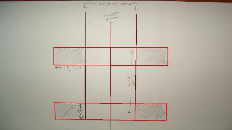

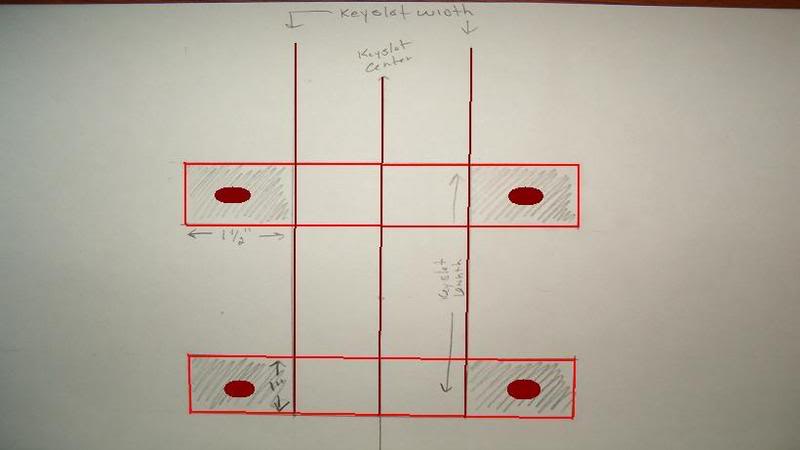

first you need to make a template to find the proper dimensions to make the bracket for hardware placment on the helmet etc....
~Step 1

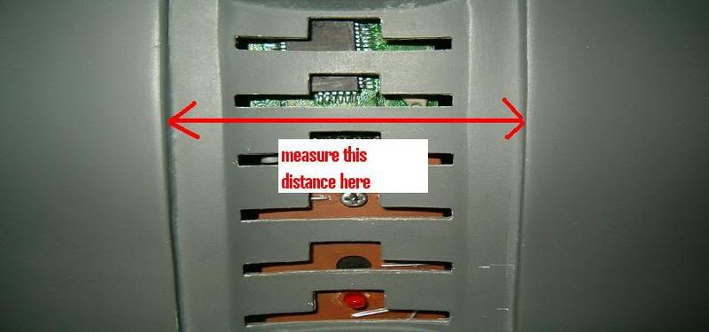

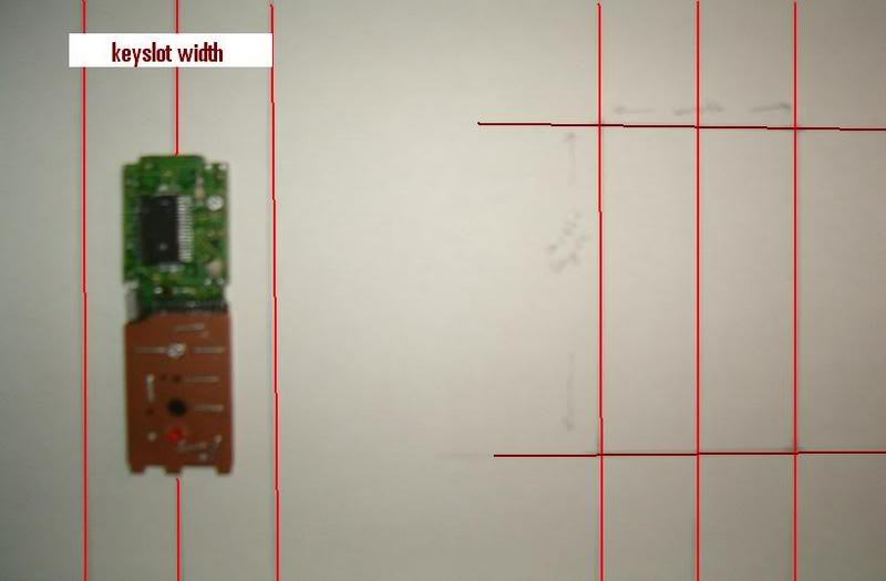

on poster board make a grid starting w/ the width measurments of the overall keyslot area ( from the outside of the helmet ). then find "center" on the measurment.
this will help find placement for mounting the hardware around the "texture" inside. as each side may need different length "tab" to be as level as possible.
~Step 2
draw lines for the length of the board, subtracted one inch off the top and bottom then draw those lines basically creating the capital letter " I " making the "tabs" or "feet" for the bracket screws.
each tab extends 1.5" off each side.
cut out the template.
~ Step 3

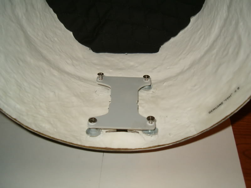

on each "tab" of the template mark a centered hole. then cut out the hole so its sorta oblong (horizontal). this way u have space to play with and move the screws. side/side, angle it etc.
~ Step 4
hold the template inside ur lid flat against the keyslots to get an idea of screw length needed.

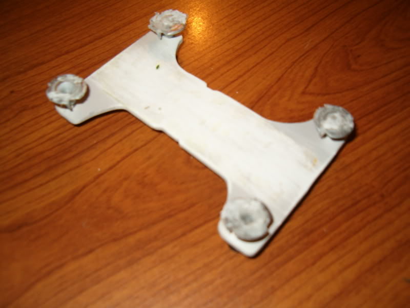

then attach the screws with the "tee-nut" on the end. hold flat on keyslots and move the screw/tee-nut around untill u find the right placement inside the helmet. trace around the tee-nut for placement.
bond the tee-nut too the helmet interior with what ever application u prefer (epoxy, goop)

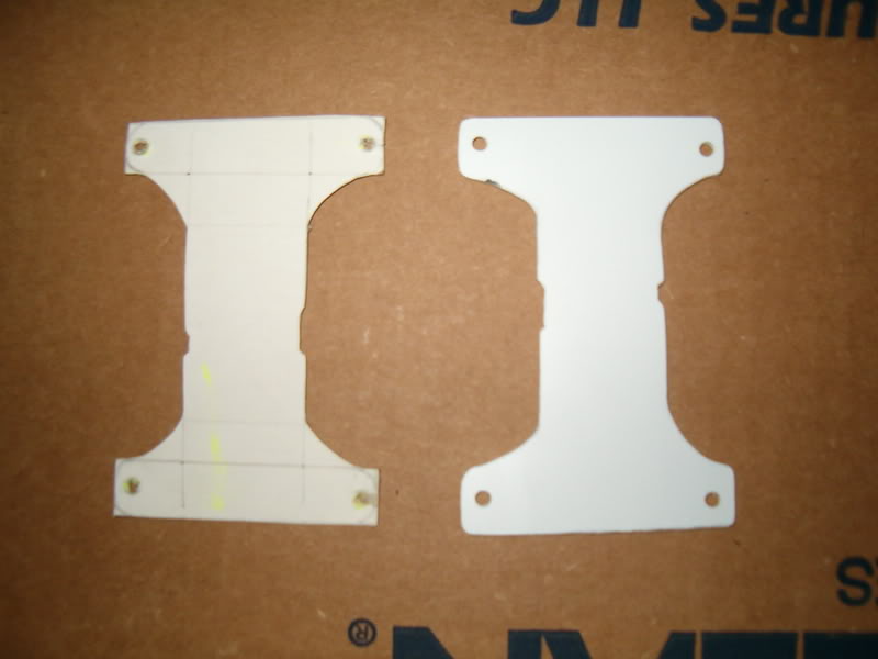

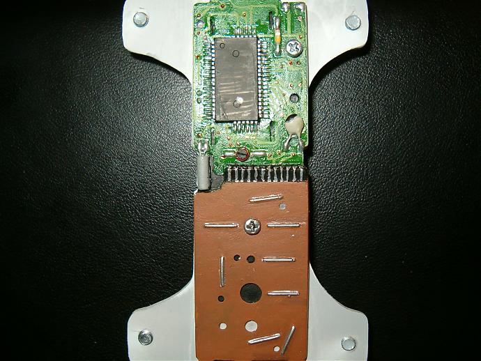

while that is curing, trace around the shap of ur MQ-1 onto the template and cut away any desired excess u dont want around the board.
shaping what u want the bracket to look like. round off corners etc............ this will now serve as the template to trace ur permanate bracket onto the styrene.
trace, cut, trim the styrene to the desired shape. i used .80 styrene for mine.
sand if to paint, and also for roughing up the surface for adhesian.
before permanatly attaching the MQ-1, tape it to the bracket first and do test fits incase u need to make any last min. changes for screwhole size, alighnment, test fitting ur helmet....
if need be add a washer or two to secure a snug fit with the scews and ur set.
its really simple, but it sounds like alot of steps. this is to ensure a really close and calculated placement for the bracket, and saving the most room as to not waste precious space inside the lid!
