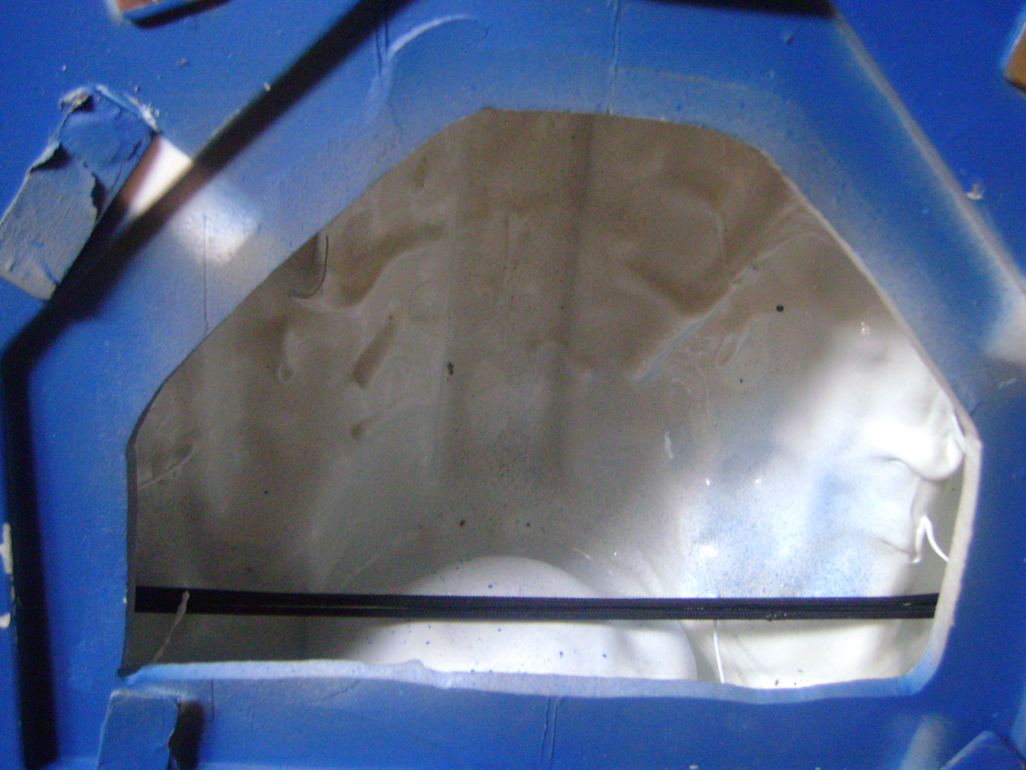

i put an ABS "plate" on the inside with magnets to attach the thrusters on the MOW pack. One on each side..i just hot glue it in. you can see it in one of my build threads, but i need to make one just for this so people can see it more clearly. I will be doing that soon with the current packs im building

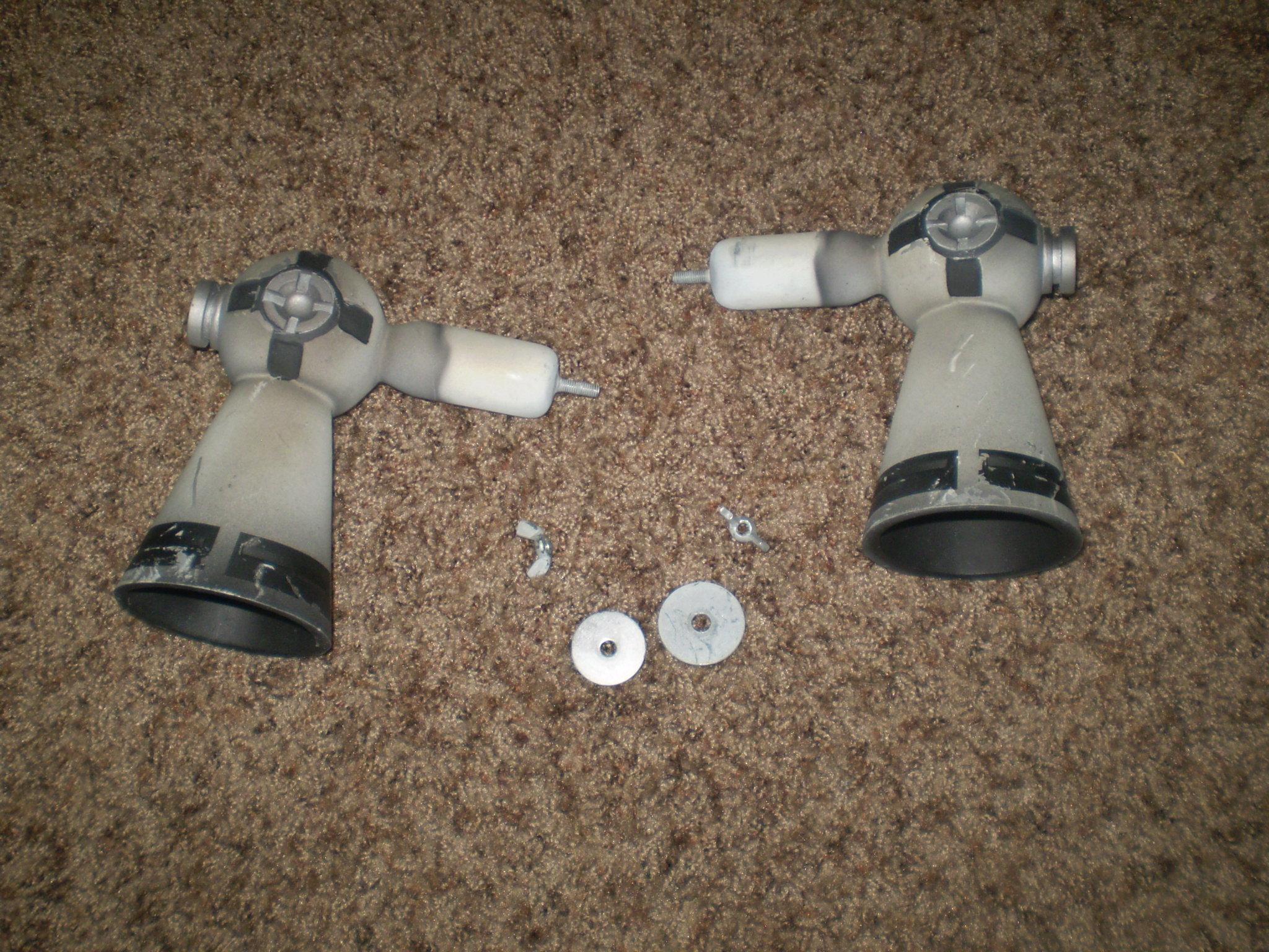

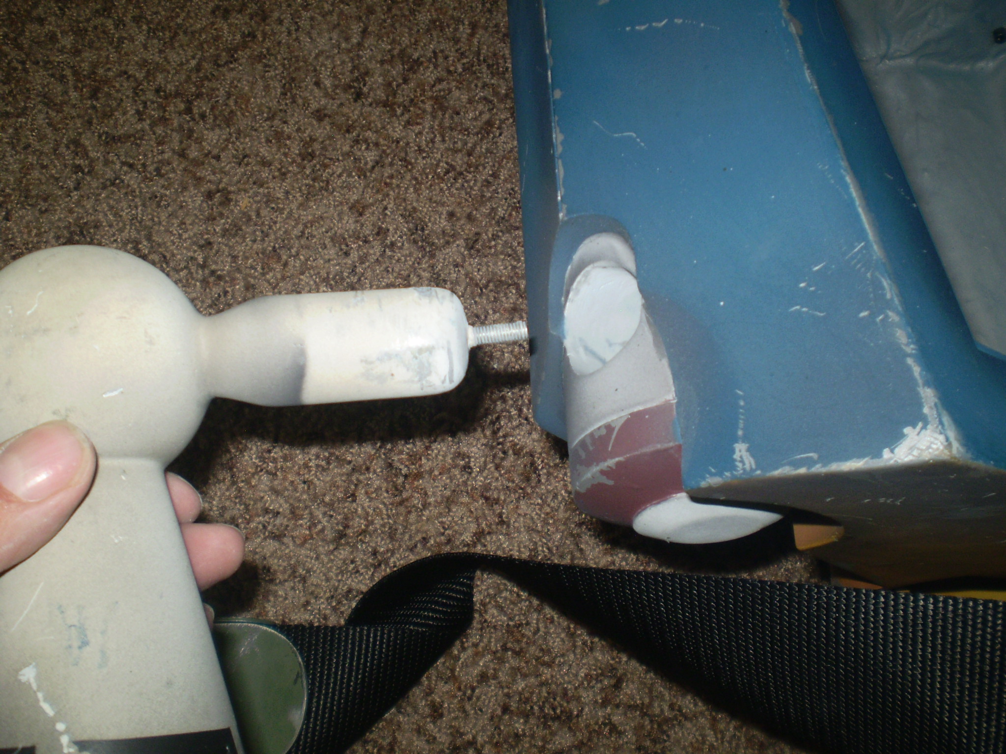

Tap a hole and insert a threaded rod into the thruster
Drill a corresponding hole inside the jetpack thruster hole
Then use a washer and butterfly nut inside the pack.
It's not Rocket Surgery ;)

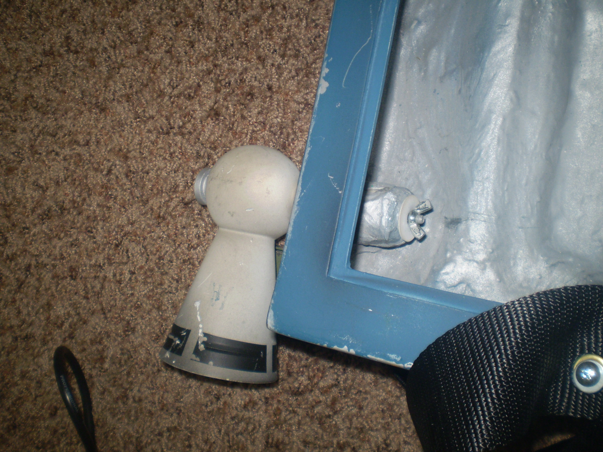

Why not take an end cap for the PVC and glue it inside the Jetpack so it will effectively have the same setup add a bolt to the thuster and drill the end cap and use a wingnut like BFUK JP does. U may have to shape the open end of the end cap to make it work.
I was just thinking the same thing. It should work.
Great minds...was just thinking the same as well. Thanks, brothers!

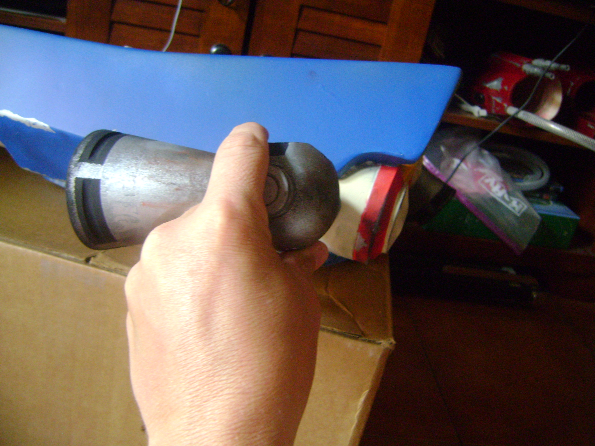

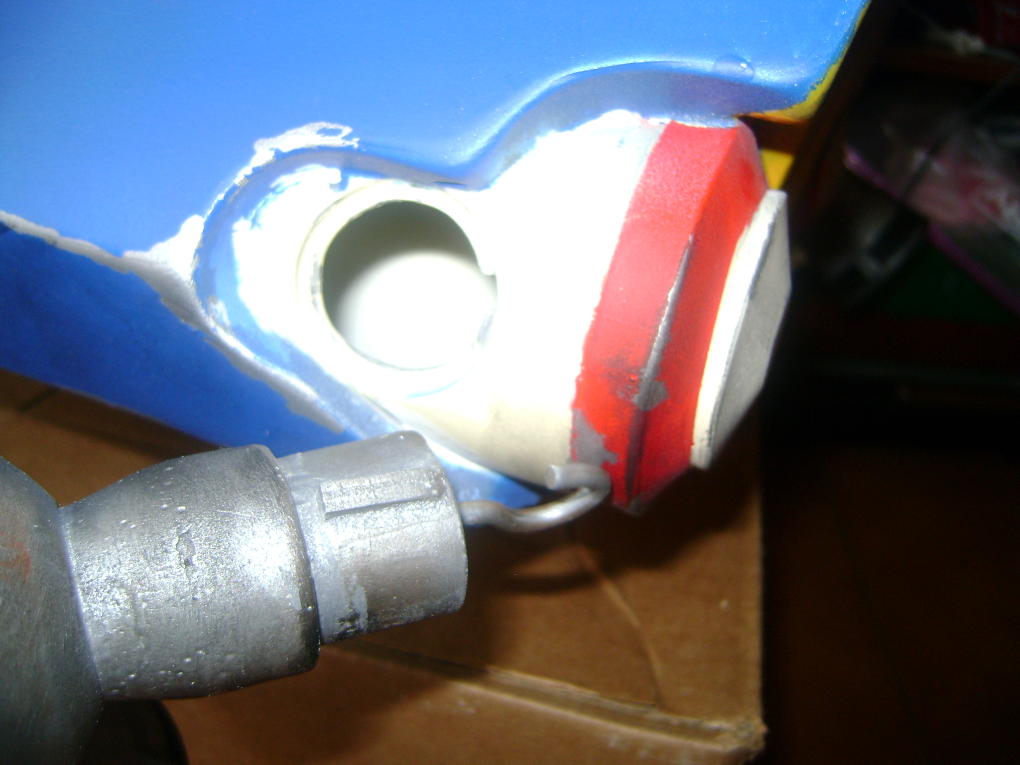

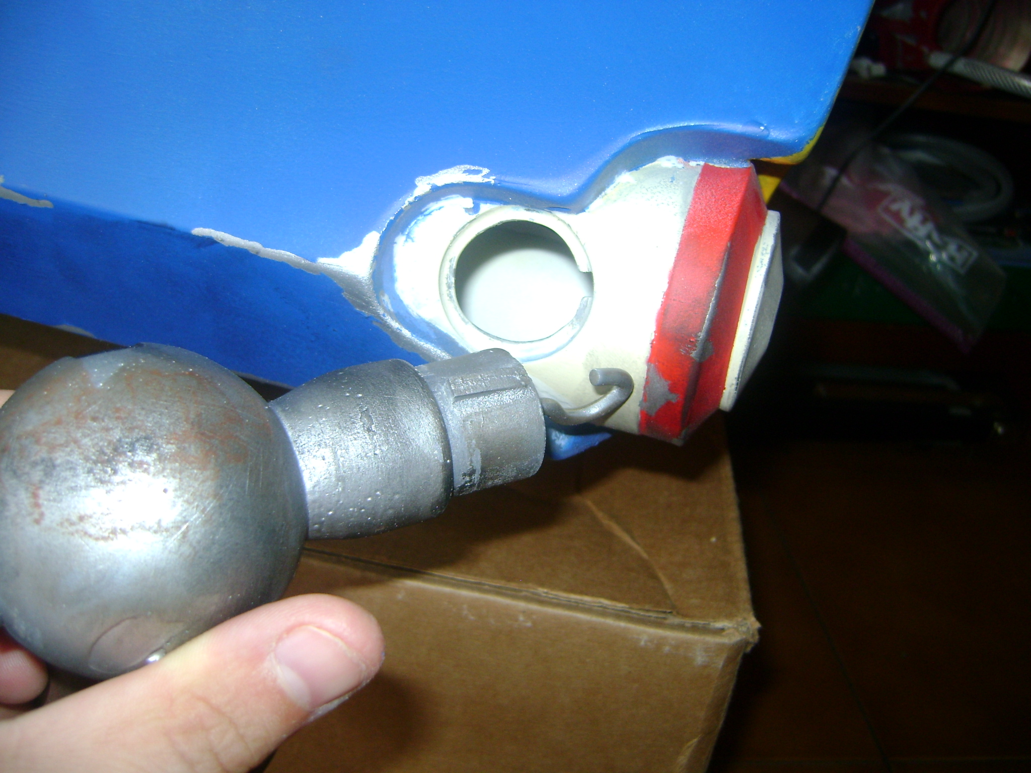

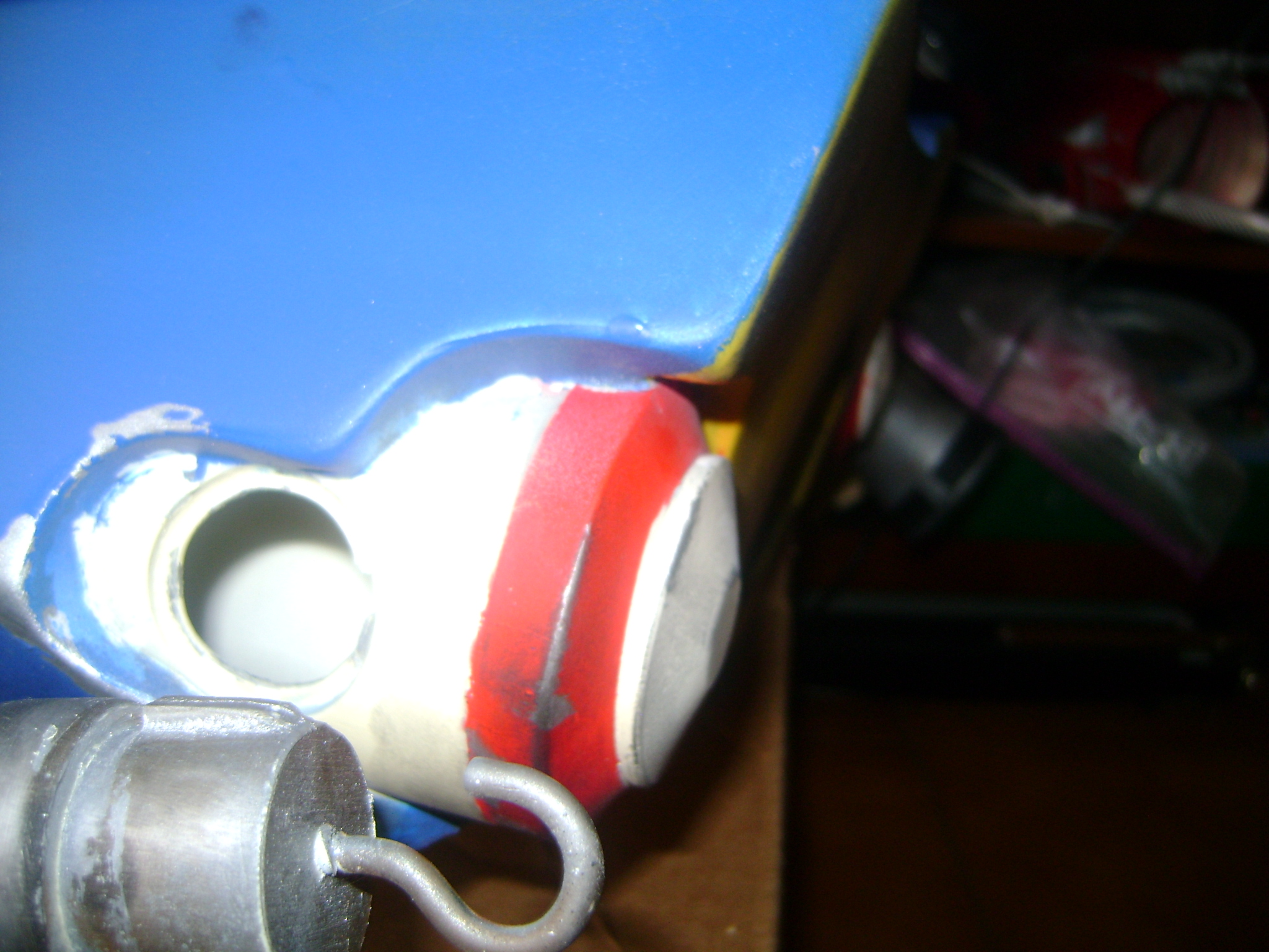

I made a key hole slot for mine, I glued a little notch onto the thruster assembly arm, and cut a notch out of the hole it slides into, hence the key hole. The thruster is inserted upside down, then rotated, the key tooth on the thruster arm keeps it from slipping out of the hole unless rotated upside down again for removal. The hooks on the end are where I attach an elastic band, that put the thrusters snug to keep them from sagging, but still let me move them around if I wish, and also gives them a little give, just in case I were to bump into something.
So, I can remove the thrusters at will with very little work involved, and they wont fall off or sag. Hope this helps.
