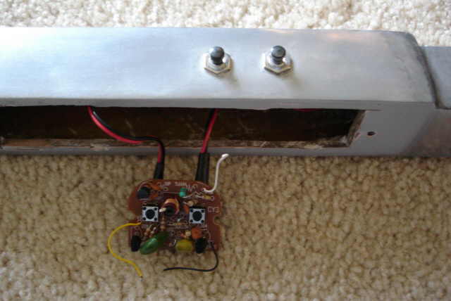

Since I am no electronics expert, I was about to break down and buy the hyperdyne kit, when I found a cheap RC car yesterday at KB toys. It was on sale for $3.00. The thing that caught my eye was that the remote has two momentary switches. One for forward and one for reverse.
I tore it up and hooked it up just like the zip zap and eureka!! It worked like a charm. With just two AA's it works awesome. I piggy-backed a couple of wires off of the switches on the transmitter board and conected them to the momentary switches I have in my left gauntlet flamethrower. I ran the power wires through my hose and put the 9 volt in my sleeve where my hoses connect. I also put the antenna in the hose.
So not taking into account the money I wasted on several trips to radio shack, I got this thing to work for 40 bucks.

Perfect! That's the exact same one I used for my last helmet. I wasn't able to find another for my new helmet, so I picked up a a cheapo car that had the basic left/right and forward/reverse controls. I only needed to use one of them, so I might the other to turn on the LEDs in the right gauntlet (which don't aren't on in the movie). I'll take some photos when I start installing that, which should be very soon.
Just to repeat krillindb's advice, if you go with one of the cheaper cars, be very careful and make sure you note where all the wires go. Probably best to unsolder every wire and replace it with a stronger one so you don't have one pop off all of a sudden and you don't know where it goes!
