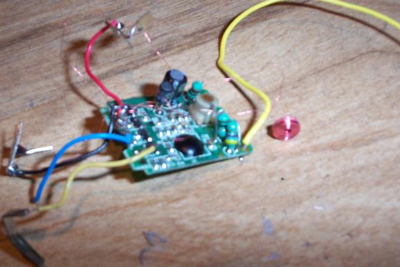

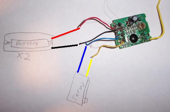

OK, I will be using the zip-zap car method. In these pics (lifted from Krillin) it shows red/black going to the battery. Do both go to the same battery terminal? He recommenends a bettery caes... There are blue and yellow wires rom the controller board, what wires do those go to on the servo? Blue to blue? Is the yellow unneccesary? Help! (Thank you for all the help thusfar!!!!)
Shinobi
Shinobi
One of those yellows is the antenna isn't it?
