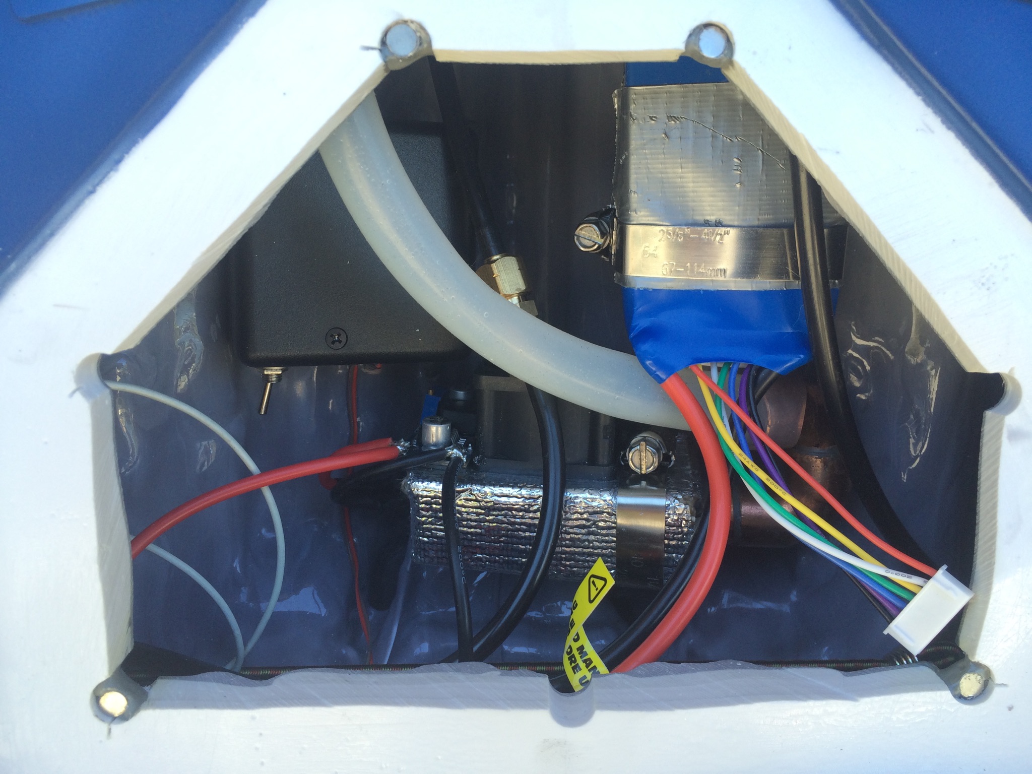

I have a lot of stuff inside my jet pack but the beacon power supply is set with some screws into the back:
