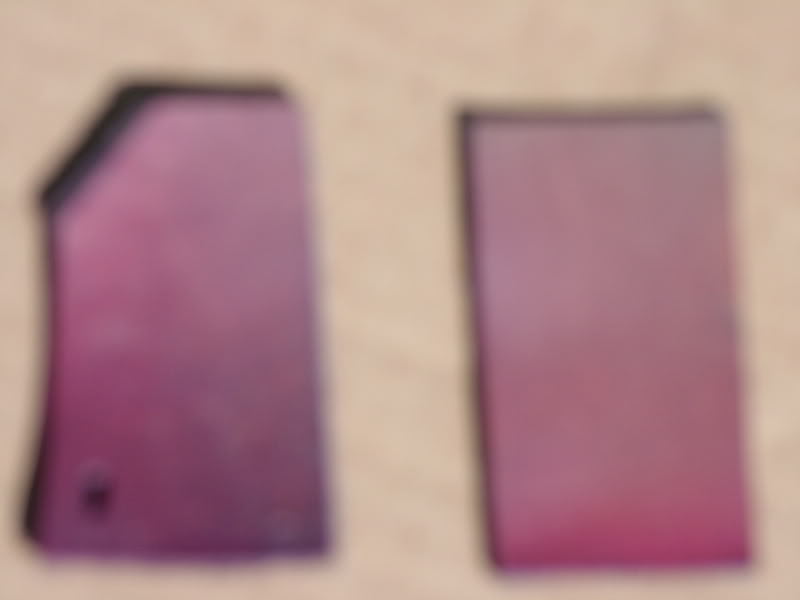

Right What ive done here is stick water in a container, add a few drops of each color (ive tried a few combinations). Then the leather is dunked right in straight to the bottom and held there so the little air bubbles come out and it will sink. Ive left some in for about 8 hours and some only for 30 mins Ill post up in a sec some of the effects ive got.
I dont think it would work on a whole hide as it doesnt permeate through the whole of the skin, just the sides back and front but it does create a beautiful soft natural looking finish, i have to say i was dubious because i liked my airbrush squares but if i could get this the right color i think it would look lovely.

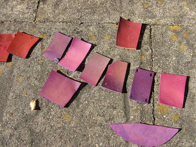

Few more of the testing colors here
Nice finish :)
Buy a cheap plastic washing basin thingy and go nuts Bee.
Get a ratio right with that pipette thing. (lovely word)
Transfer that to the basin, fill it up (add the same amount of drops again) and test one.
If it comes out cool dye lots and lots of em :)
The 1st purple one on the left (maybe the 3rd one in), the funny shaped one on the bottom and the totally punched one looking totally rocking!

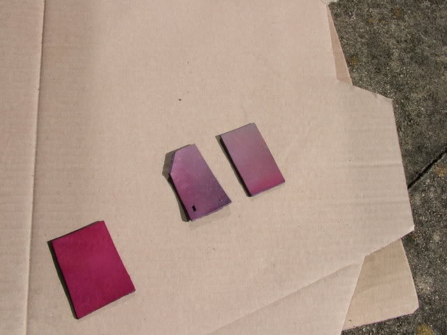

Becky tried to dye more but made the mistake of getting the colour wrong and adding more colour.
Word of warning to anyone trying that...only thing that'll happen is it'll just go a darker colour
