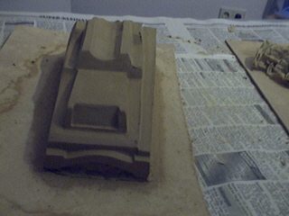

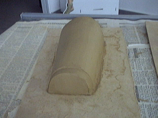

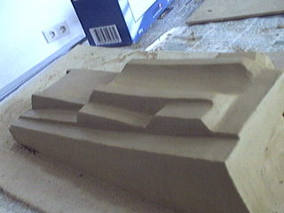

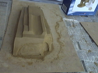

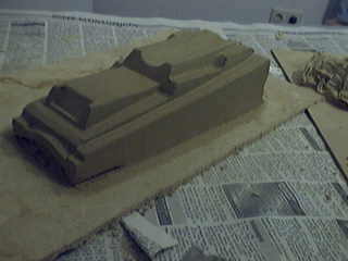

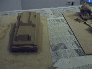

..here i would like to show u the process of my gauntlet models.
here the left upper part. but its not finished yet.....
my girlfriend and i use reference pics from the exhibition shots and others i have collected ;)
it was not easy! cause we want find the best size to fit it out...

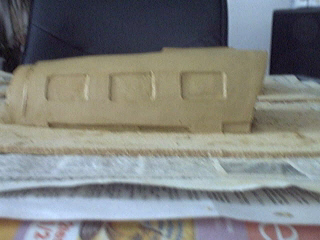

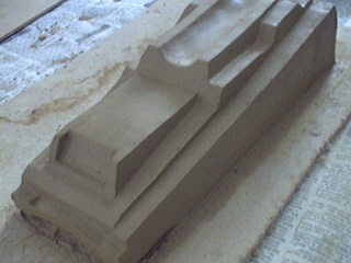

UPDATEs ....
Bleahhh, thank for ur kind words but its far away for any casts.
now the clay needs to dry a bit before making new molds.
You have more courage than I do my friend for making those out of clay. Looking good. Keep up the good work and determination!:thumbsup:
Cruzer
..man thanks i need that motivation :lol:
well... here a short update. we (me and my girlfriend) have made a plaster cast. cause clay shrinks while it dried.
we could start with fiberglass, but we would destroy the plaster cast to get out the gaunt.
and making a new gaunt with clay ervery time and making plaster clay etc... is to stressfull.
we are searching for any ideas to fix a mold like the plaster cast, or fixing a gaunt ...
oh i forgot to say searching time :lol:
enjoy!

Here is what you do but it will cost money.
First pour Silicone rubber into the plaster molds and i mean fill them completely.
Once the Silicone has set up remove the solid Silicone positives and don't worry if you have to destroy the plaster (and or Ultracal) in the process.
Now you have 2 Silicone positives.
Flip them on their backs so they look like your original sculptures.
Brush layers of Liquid Latex over both of them to create jackets of rubber. Silicone will not stick to Latex.
Brush enough latex to cover any undercuts and be patient letting each layer dry completely.
Now you can back that with either strips of plaster bandages or Ultracal for support.
When it's all dry flip it over and remove the Silicone positive.
Now you can fiberglass into the Latex mold as many gauntlets as you want.
Remember once you start glassing to use a mold release on the latex.
Keep the silicone positives in a plastic bag in a dark area for creating future molds as the Latex ones wear out.
