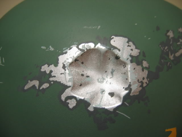

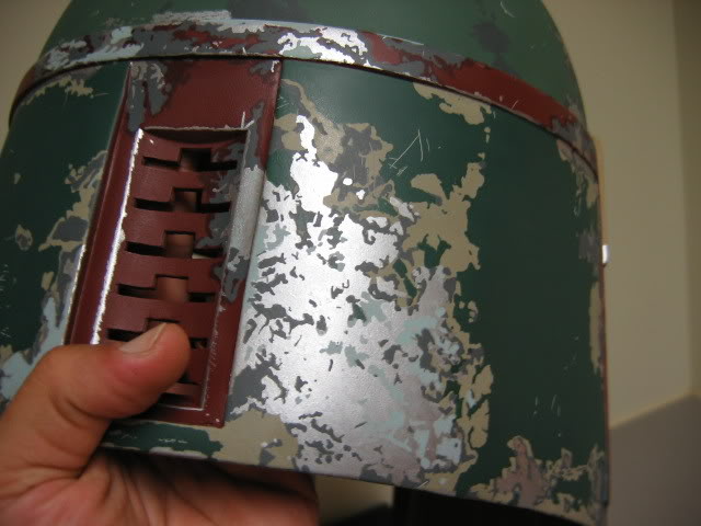

OK, after talking with Chris I added the "contrasting" color which appears within some of the silver damage. This is an interesting detail and it's something that seems to change depending on how the light hits the helmet. I remember discussing this very thing with Alex when things were coming together during the JB Project, and when I got to go to Texas for the unveiling, I got to take a look at Darth Miller's amazing ESB helmet, and by pure coincidence, we used almost the exact same color to do these little areas! :)
So here's how it came out.
With photos, it's just not possible to show how the color seems to blend in or pop depending on how you turn it to the light. But Chris will see what I'm talking about soon! :thumbsup:

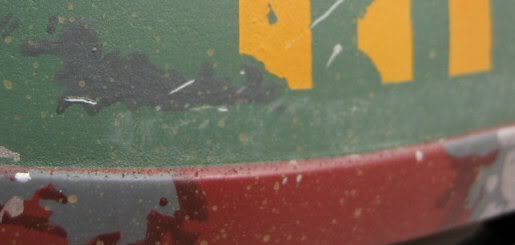

I finished detailing the Borden connector on the cheek by drybrushing some of the base Panzerolivgrun, and then some Tamiya Khaki. After that, I went back and redid some of the chips/scratches with silver.
I spattered the whole front of the helmet using the Khaki again. I use an old toothbrush to do this, and I thin the paint about 50% with water. I just flick the thinned paint onto the helmet until it appears to match the reference pics.

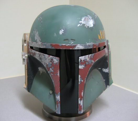

And that was pretty much it. Here are some final pics with the visor temporarily installed.
Once again, I have to say that I'm using my "old" 4.0 mP camera, so some of the subtleties of the colors don't fully come through. :(

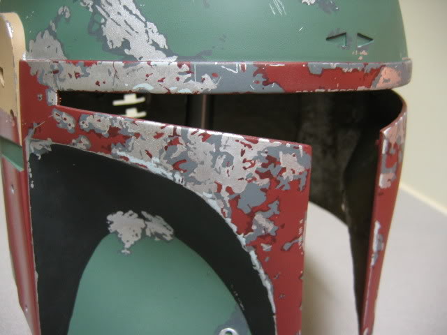

A couple of angled front shots.

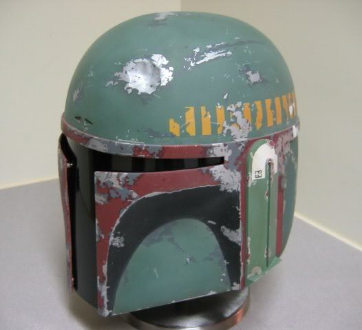

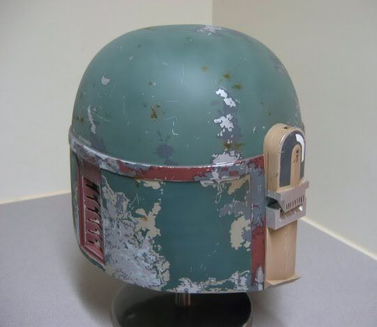

Some shots of the back. I had talked to Chris about adding those greasy looking stains on the back of the helmet and I used some Game and Citadel inks to do these.

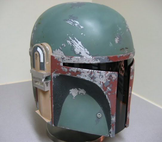

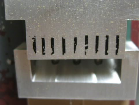

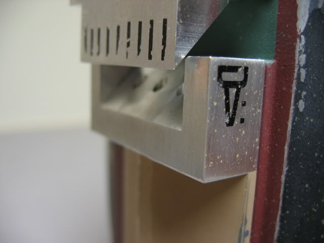

Here are some close ups of the dry transfer details on those gorgeous metal ears. :love

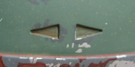

And here's a couple just for fun. The "turn signals," detailed with pastels.
Finally, a section of the kill stripe area.

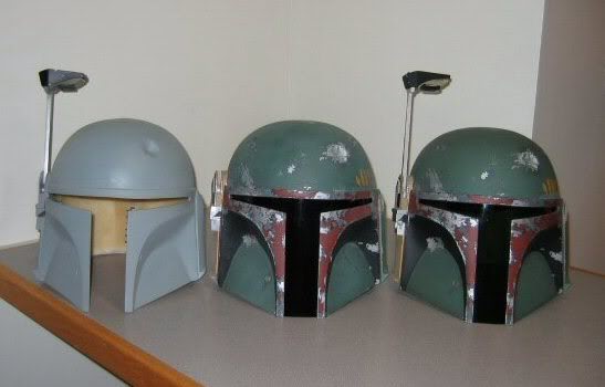

OK, here's one more shot for fun.
It's a group shot of the usual suspects.
The middle helmet is Chris's just-completed FPH. On the right is my FPH.
To the left is my new TerminalFettler helmet which will become. . . my latest super duper top secret project! Mu-ha-ha-ha!! :lol: ;)
