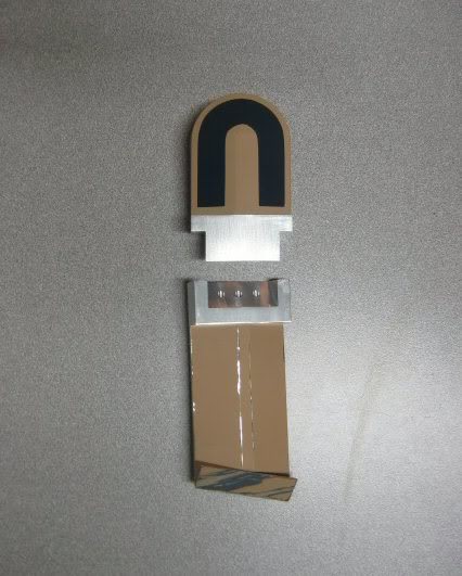

I've also begun the detail painting on the RF ear. I did the damage on the lower half, using the same SP Lark Dk. Gray as on the rest of the helmet, then physically scratched through to reveal the base metal.
The arch on the upper half was masked and airbrushed on.

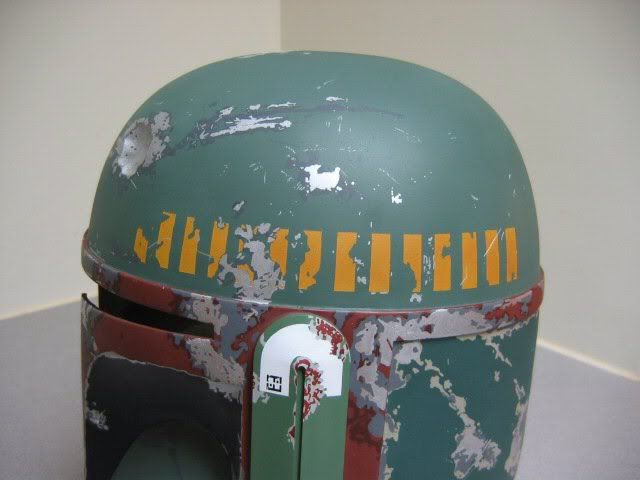

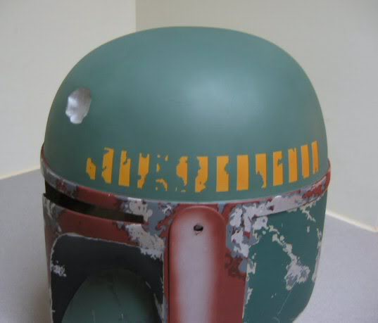

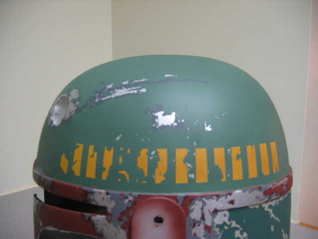

Got some killstripage on there now! I masked off the stripes using some trusty painters tape, then used liquid mask to mark off the chipped sections.
When I paint the killstripes, I use a dense make up sponge to apply the yellow. I have airbrushed these on in the past, and find that it takes many coats to cover the green of the dome. By sponging on the yellow, it saves a lot of paint. I also don't have to completely mask off the rest of the helmet, only the areas immediately around the stripes. (I'm lazy :lol:)
Before I unmasked the stripes, I added some reddish orange pastel powder. I start from the back and work it in with a big soft paintbrush, letting it fade lighter and lighter going toward the front.

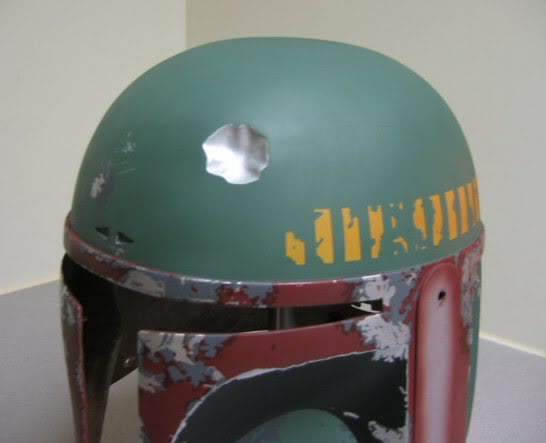

I've also painted in the basic shape of the dent, and the next step will to be doing the surrounding damage.

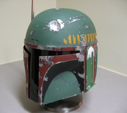

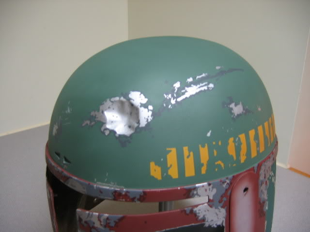

I've detailed around the dent and done the streak coming back from it. I've also just barely begun to detail in between the killstripes.
The larger damage area between the stripes is still to come, then the big scrape across the crown.

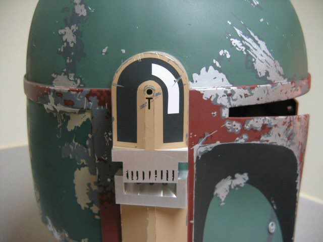

I've temp installed the ears to show a better view of what the nearly complete helmet looks like now.
To detail the RF ear, I added some dry transfer letters for the fine details, and used my SP Lark Dk. Gray for the gray damage, and scratched through to the base metal for the silver damage. These metal ears rock!!

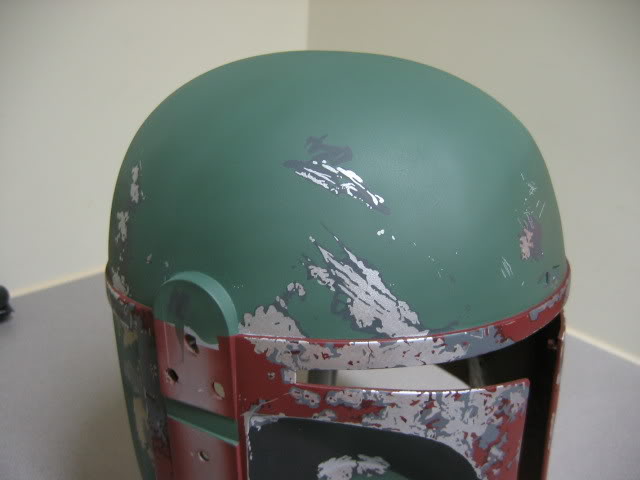

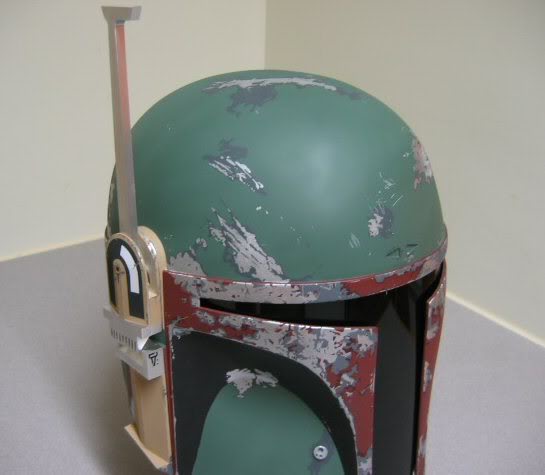

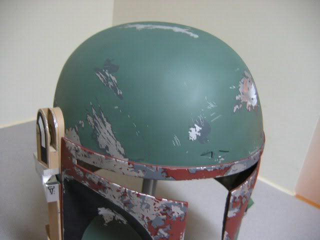

Well, it's really close to being done now. :) All the "basic" painting is finished!
I completed the gray around the big scrape on the top of the dome, then went back with my compass and hit all the fine scratches.

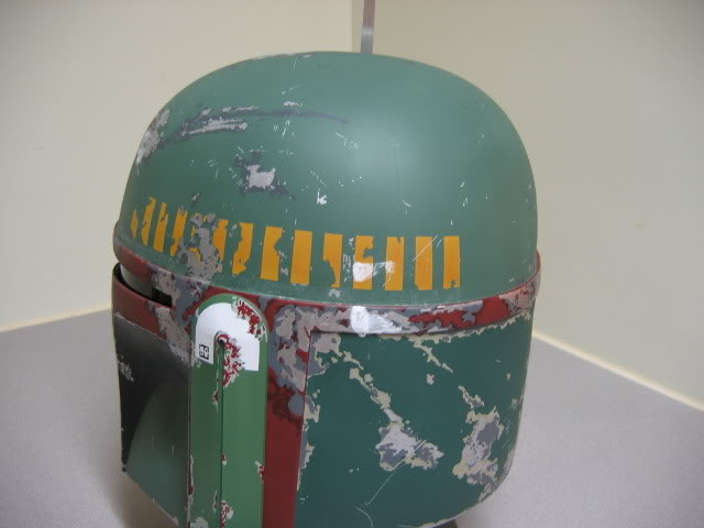

I also did the white "thumbprints" in the killstripe area. (These are there in the screen shots if you look carefully! :))

Here's some shots of the helmet as of tonight.
I've just temp installed the ears and RF stalk to show what everything looks like all assembled.
And here are those thumbprints.
