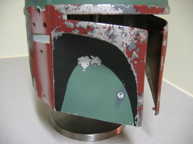

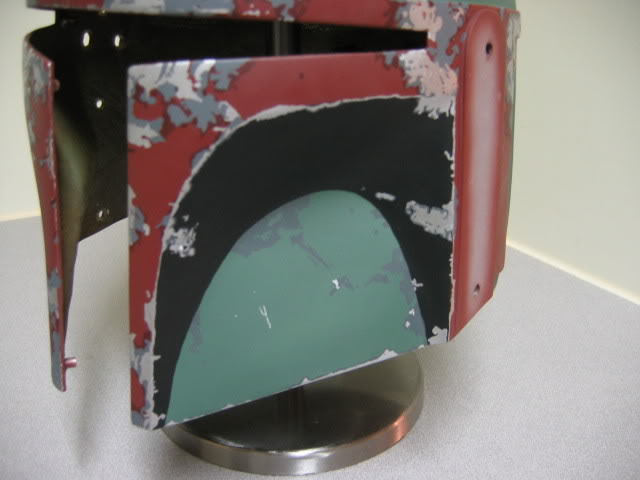

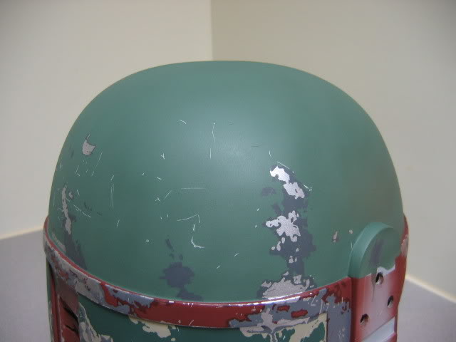

I completed the detailing on the upper cheeks, and moved down to the lower cheeks, too. When I paint the gray details on the lower cheeks and dome, I use the 2nd custom color of this whole project. The SP Lark Dark Gray is very similar in tone to the Panzerolivgrun. I don't feel there's enough contrast to make it show up like it should. What I do is use the PRR Brunswick Green (the color of the upper cheeks) and add a few drops to my Lark Dk. Gray till it shows nicely against the lower cheeks and dome.
Here, I've also given the Borden a base coat of silver. It will be detailed toward the very end of the project.
So that completed everything below the dome. So what to do next???? The dome, of course! :lol:

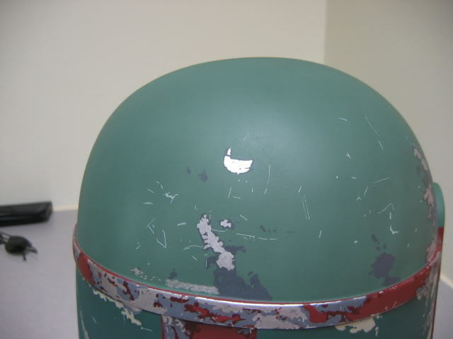

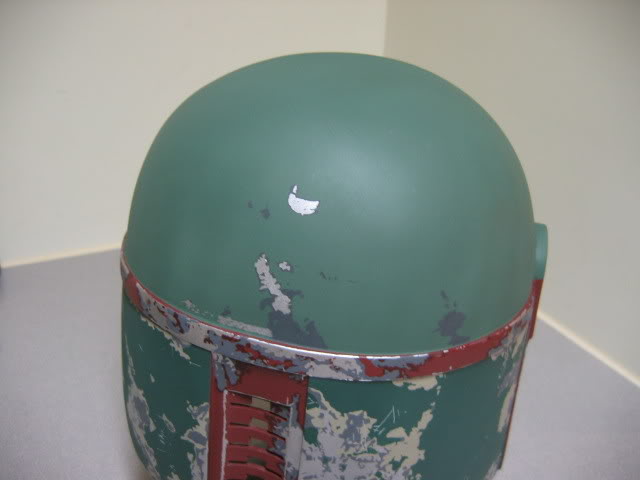

I started at the back, doing small sections at a time while working around toward the front.
Here are a couple of shots of the back of the dome with some more painting done, plus a bunch of the really fine scratches.

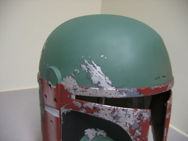

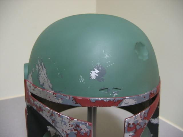

The next detail to paint is one of my favorites; the cat scratch! I just think this is a really cool looking scar. :thumbsup:
Finally for this round, the damage above the "turn signals" on the forehead. :)
Still to come: The Dent! Maybe some killstripes, too. ;)
