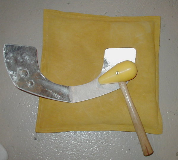

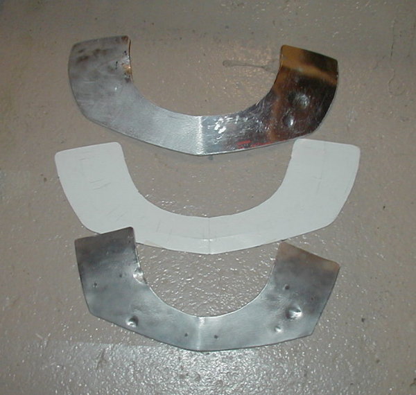

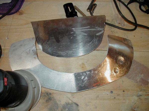

I used my existing small collar piece to make a poster board template, which I drew larger, cut out and tested on my chest / shoulder area. I then transfered the template to a piece of 1/8" aluminum plate I picked up from a local metal distributor. I cut the piece out of the plate, and taking a que from
American Chopper I bought a pannel beater bag and mallet, which I used to shape the armor. I added the dents using the mallet and a some cold chisles, roughed the surface with my orbital sander, and presto ... collar armor that fits.
