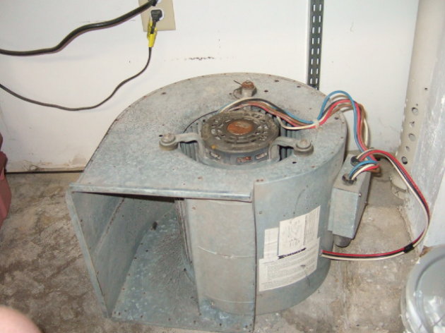

I said I would post pics of my paint booth in another thread, but I can't find that one now so I will post here. This works great and now the Wife doesn't complain about the smell of paint and other stuff anymore. The small box on top has a fan like the one pictured in it that does all the work. I was lucky and got the fan for $35( off E-bay) , the plywood for free, and the rest of the material was about $25 so for $60 and about 4 hour I was able to make a killer paint booth.
