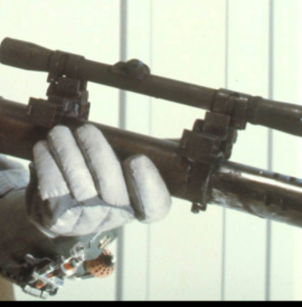

Do you have more info on the shrouds used for the scope mounts to barrel mounts. I'm trying to accumulate reference photos for why there are different versions

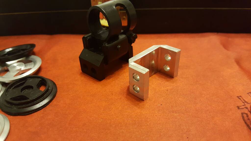

This is the 3d version someone created
This was the solid casting I had from years back and a prototype in aluminum I made
Trying to figure out what is actually correct. All the screen captures from the movie are blurry
That's the best picture I have to make me think the low profile version is probably more accurate. But I'm not sure if they have holes on the side. One some screen grabs I thought I saw light coming through suggesting holes but in this one not so much

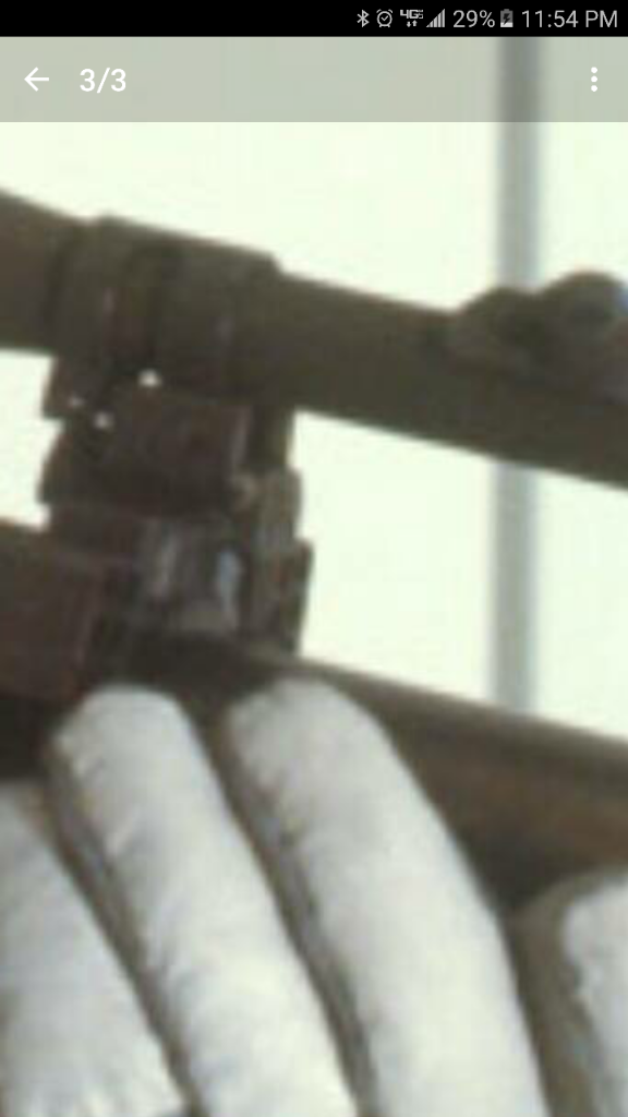

This is zoomed in even more. Looks like there could indeed be two holes although they may just be spot faced or lightly counterbored
