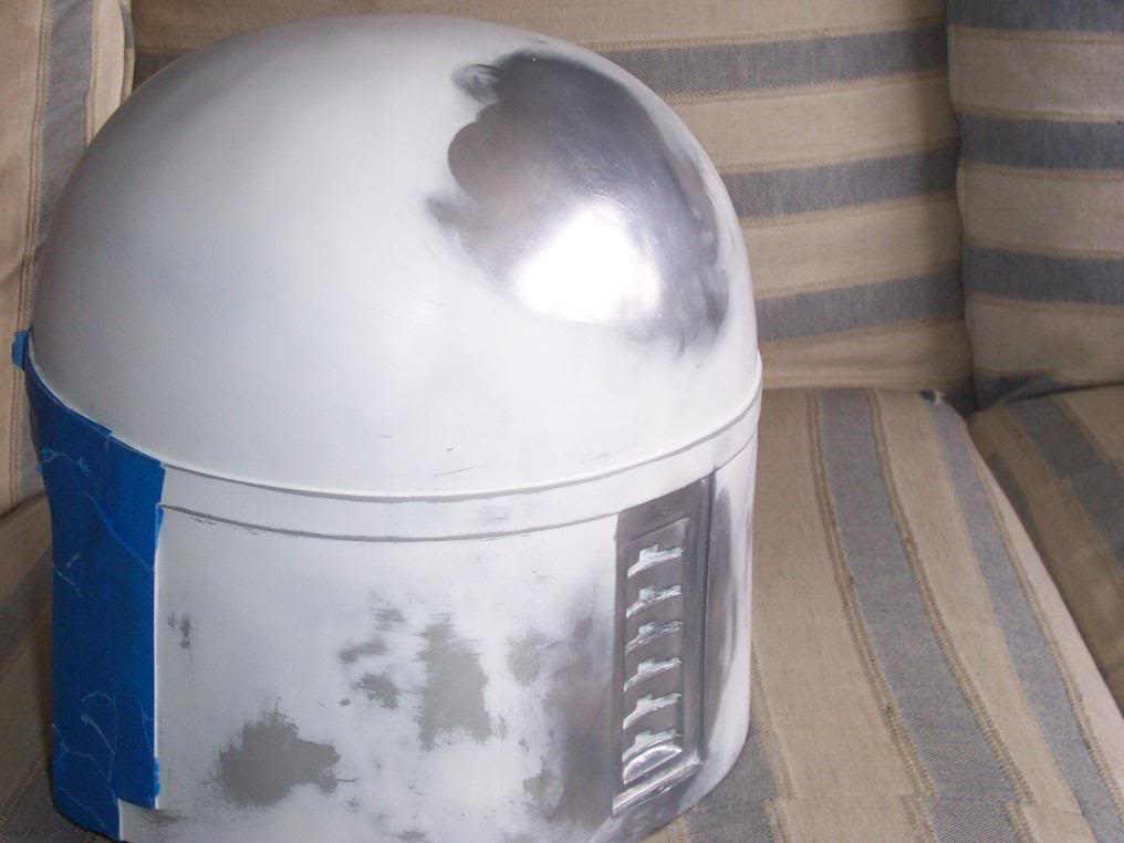

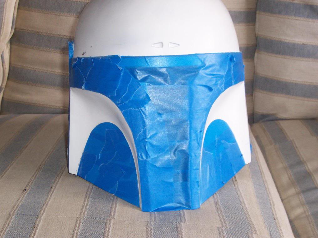

Before I left, I decided to try and do something other then the priming and sanding, and that was to tape off a section where I think I might start to paint. On top of that, I also tested the R&B on the backside. I did the keyholes, which came out fine, but I will put 1 or 2 more layers on it later, but the dome section actually screwed me over, because I found a ruffspot while applying the test coat, and it looks nasty, but the areas around it that was smooth looked really nice. I was wondering what is te best chemical or solution to removing the R&B so that I can sand that portion again, without ruining the fiberglass?
Heres some pics..
Taped off section so far
Rub and Buff test

bigkidbiggertoys said:
No need to use any stripper, just wetsand the affected area & it will smooth it out & remove the RnB.
Thanks BKBT, I'll give it a try. I thought about doing that, but was afraid that it wouldnt be affective.

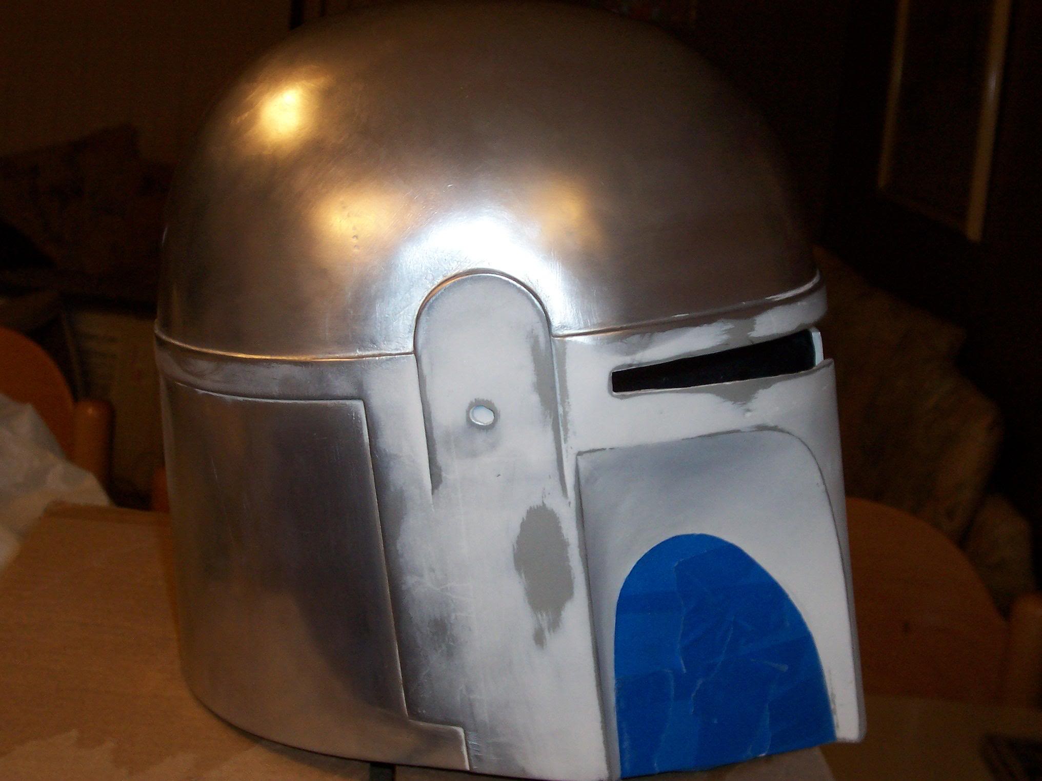

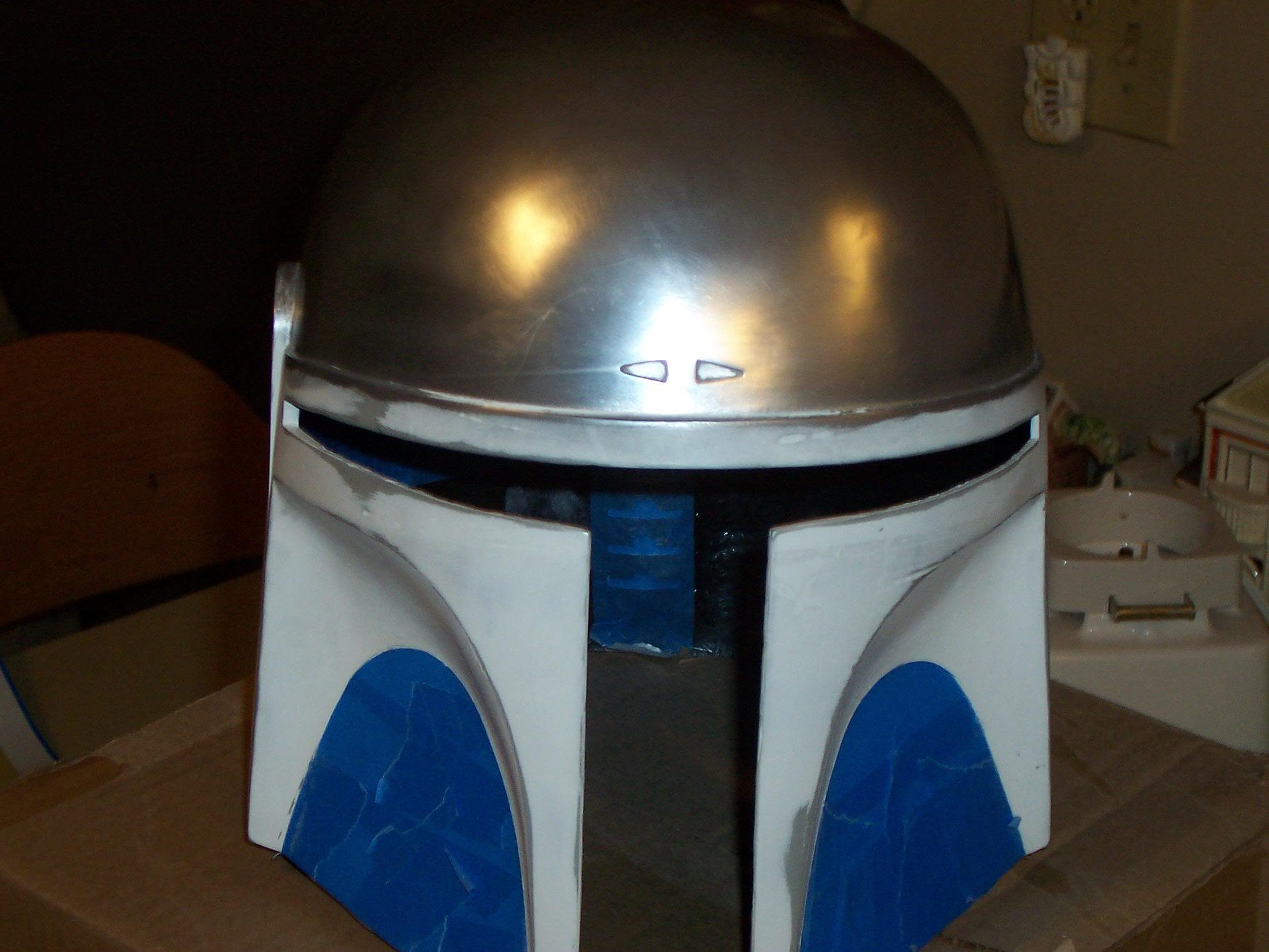

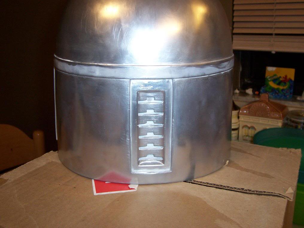

well I decided to start with some painting. Ive started on the ear cap pieces and rub and buffed the areas that require silver with the exceptions of the lower cheek portions. Thats it so far, here's some pics. Enjoy.
Please excuse the terrible lighting, its shinier then it appears in the picture.
-tubachris
Make sure the surface is ultra smooth by using between 600 and 800 wet grit sand paper, then just rub it on with your finger and keep spreading it out to you can't anymore, once you get your entire surface covered, come back and buff it with your palm and/or paper toweling.:thumbsup: Hope that helps bro'!
P.S. A little goes a long, long way!
:cheers
What i did (after sanding it of course) i apply the R&B with my fingers until evenly distributed over the area, and then I use my palm, and rub that area hard for a few seconds, and then take a rag, and rub the same area until it wont shine any more. That usually works the best. I guess I did a good job on mine, cause both my mom and friend came in and thought it looked like real metal, so I guess I pass the test. I also put another coat of the paint on the ear pieces.
