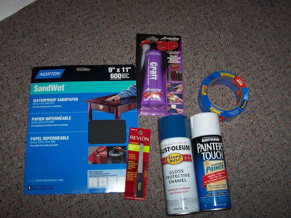

Just got back from Home Depot...
Only was able to find 4 things I may need. Got Rust-olium royal blue, as well as rust-olium painters touch white sandable primer, scotch blue painters masking tape, and 600 grit sand paper. Need to go by an ace hardware, or walmart to get everything else. I also decided to use the screwdriver method for removing the keyholes. Gonna try out the super glue with baking soda for gap/hole filling. Anything wrong with anything Im doing so far? Just need to know before I screw it all up. Thanks.

SCREWDRIVER??????? Dude that sounds like a bad idea to me or an easy way to crack your bucket...:eek:
bigkidbiggertoys
I agree, bad idea! Just drill some small holes & use a small file to get in there to square everything up. You can get small inexpensive files at the hardware store or hobby shop.
Galactic Hunter
TUBA! DUDE! Please don't do the screwdriver method!!!(n) Above and beyond "WRECKING YOUR PRIZED HELMET or MAKING MORE WORK!" When applying preasure to the helmet, there's a "HIGH" % that you'll slip and or the screwdriver will let go from the desired area and either go into your Support Hand, Arm, Leg or the WORST an Eye. :( DRILL A SERIES of small holes until you can sneak some small modeling files into the slotted areas, like previously suggested!(y) (y)

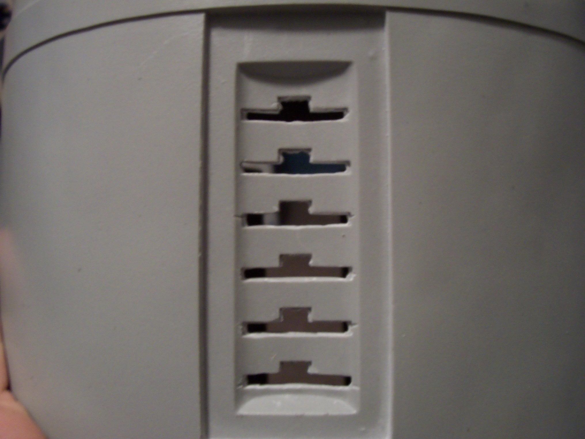

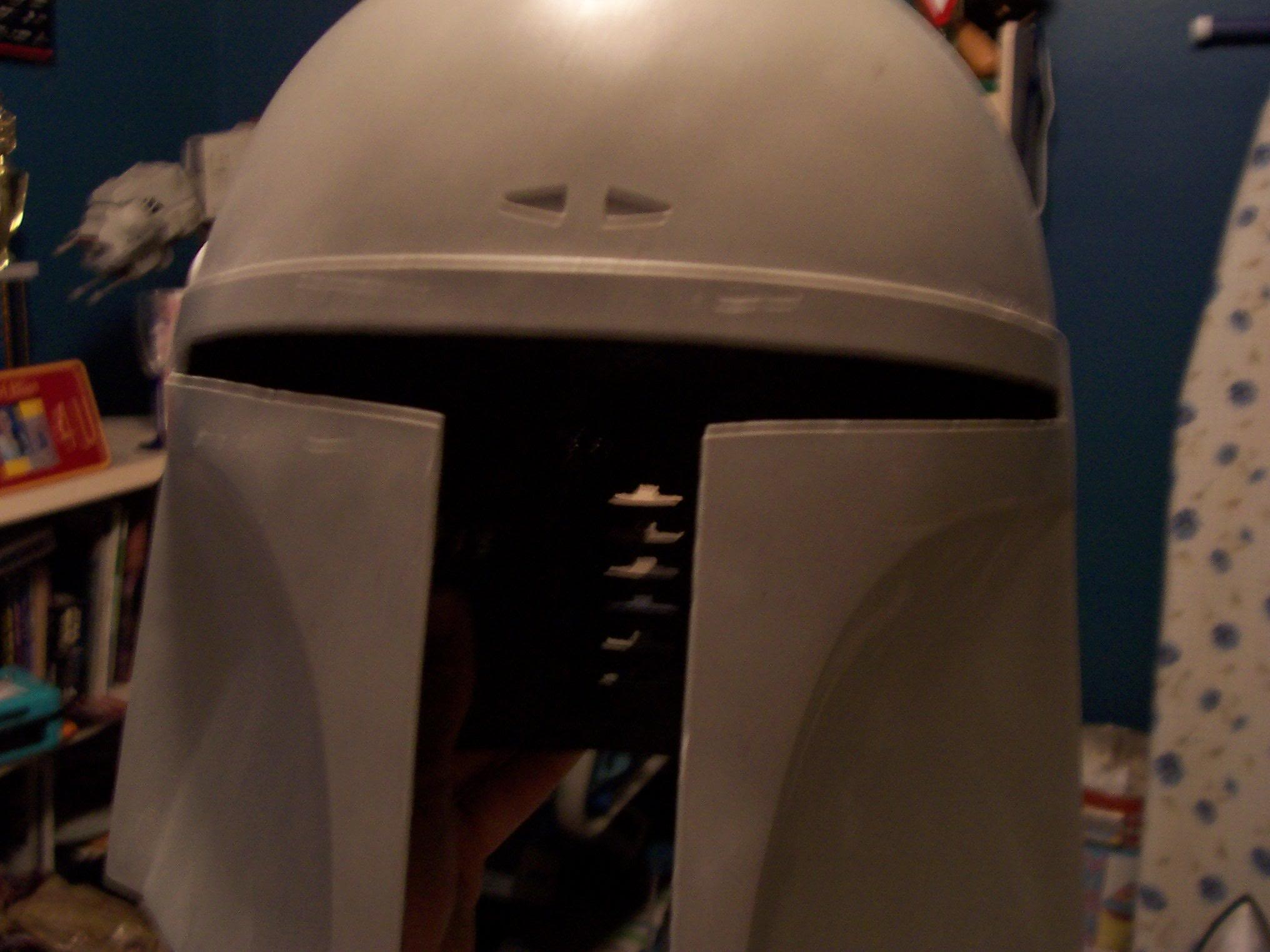

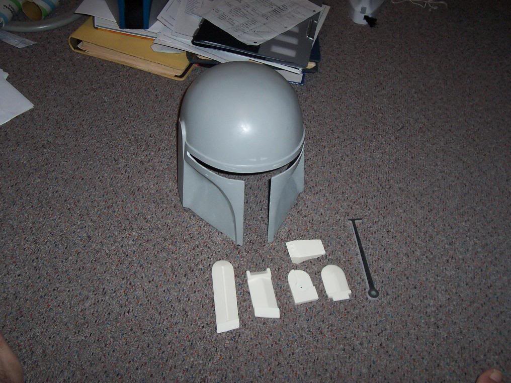

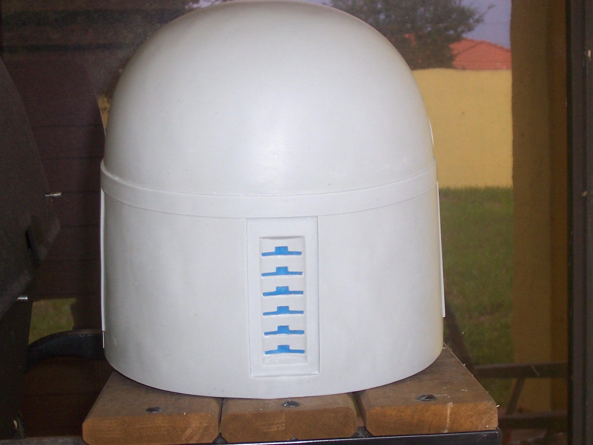

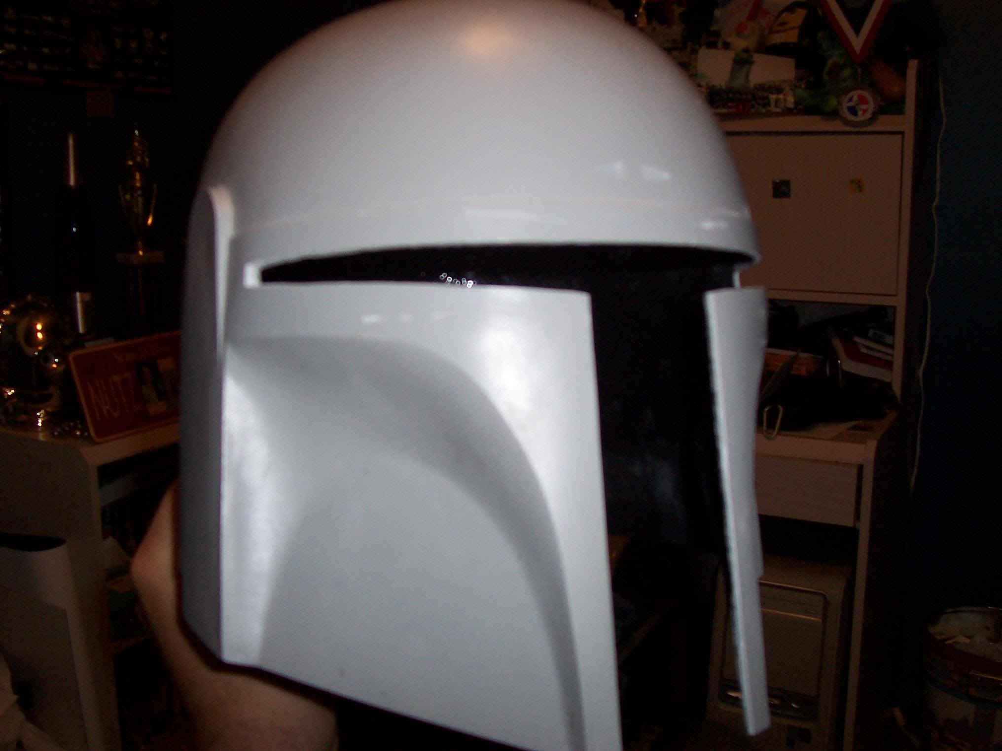

LOL, Dont worry guys, I didnt use a screwdriver. However, I did experiment a bit with my friends dremel and bit atatchments. I dont know the names of the smaller atatchments, but I used a combination to cut the keyholes, which were a series of small, needle, drill like bits. And no, I didnt mess it up fortunatly. I may be an idiot at this kind of thing, but im not a blithering idiot at least. Finally got some batteries, and now I have pics. So far, I cut out the visor, and got a small metal file, along with the sand paper, got about 99.9% of it done. The keyholes are cut out from my dremel experimenting, and with the metal file, I sanded what I could, but still need to get a thinner file to finish it up. I still need to know if that rust-olium painters choice white primer will be okay, cause I havent opend it, and I can always return it if its not okay. Here are some pics.

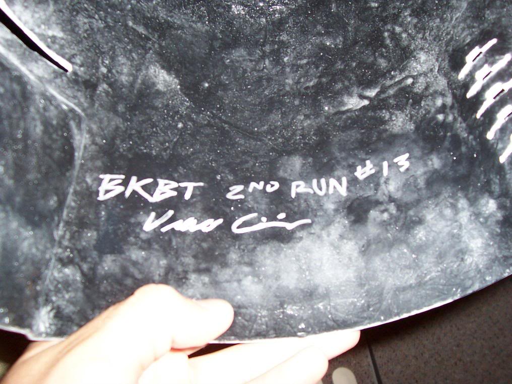

Lucky Number 13....
Visor cut out
A better look
Hmm..6 slots, only one key...
The "Lone Rangfinder"

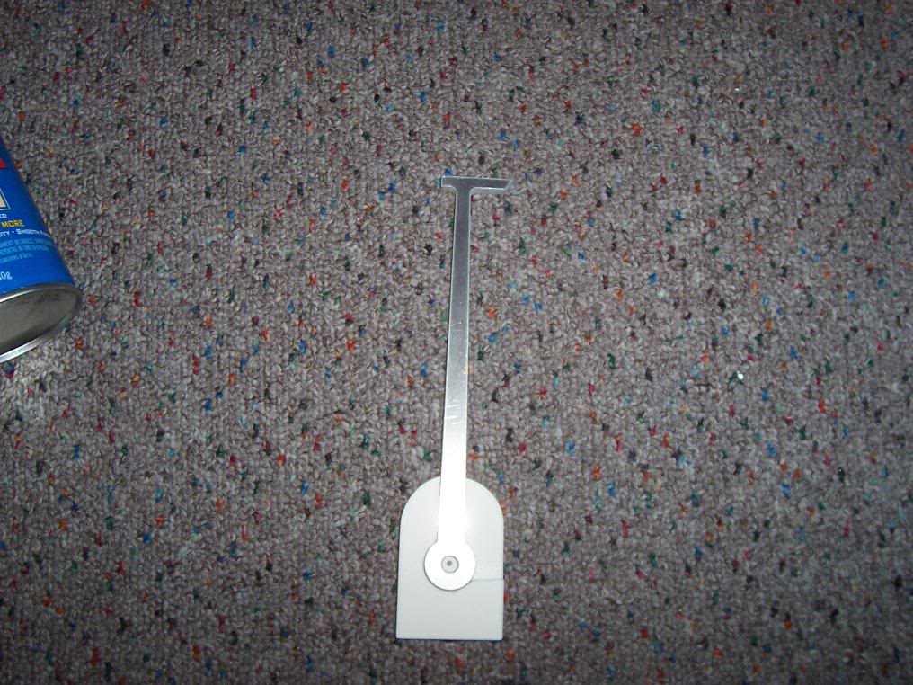

Sorry for the lame pics above, reminds me of how a 3 year might take pics, I'll post better ones later of course though. Fortunatly, my G-friends grandfather has a better know how of some of the work needed to be done, so I went over, and he helped me countersink a screw into the stalk (not a "screw" 'screw', a smooth bodied bolt, with a screw that fastens into the side) I dont know the technical term for it, but you'll see in the pics later on. As well as getting the proper "screws," we put holes through the resin piecs and the helmet itself. Aslo we drilled 2 holes on the top, underside to where the RF box would be attatched, as well as pilot holes for the screws that I will add after painting. Other then the RF attatchments being finished really, I as well finished sanding the visor and keyholes. The only thing left now, is to sand the helm, prime, sand... and then paint it. I plan on using a q-tip to swab on some Goop to fill the small holes in the resin pieces, as well as some smaller, descret portions of the helm. After that, I paint it all, rubb and buff it, add some elbow grease, and that will be it I guess (minus the liner, attatching the wire mesh behind the keyholes and of course, attatching the visor) Seems to be going quicker then previously expected. I just want to confirm also that it is a "1/8" inch black stripe, went out, and bought a roll at an auto store.

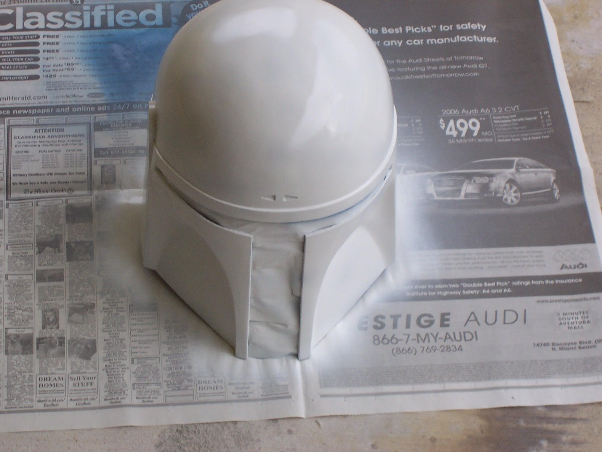

You can also use autobody glazing putty for any tiny holes & minor scratches. This is the air dry stuff & it sands off very easily. CA glue mixed with flour works well for the pinholes but is harder to sand off. I usually just put on a couple of coats of sandable primer. This is much thicker than regular primer & helps build up any low spots without the use of bondo. In fact, when I do my own work, I jump from 120 grit sandpaper to the primer. But then again, I a lazy painter;)

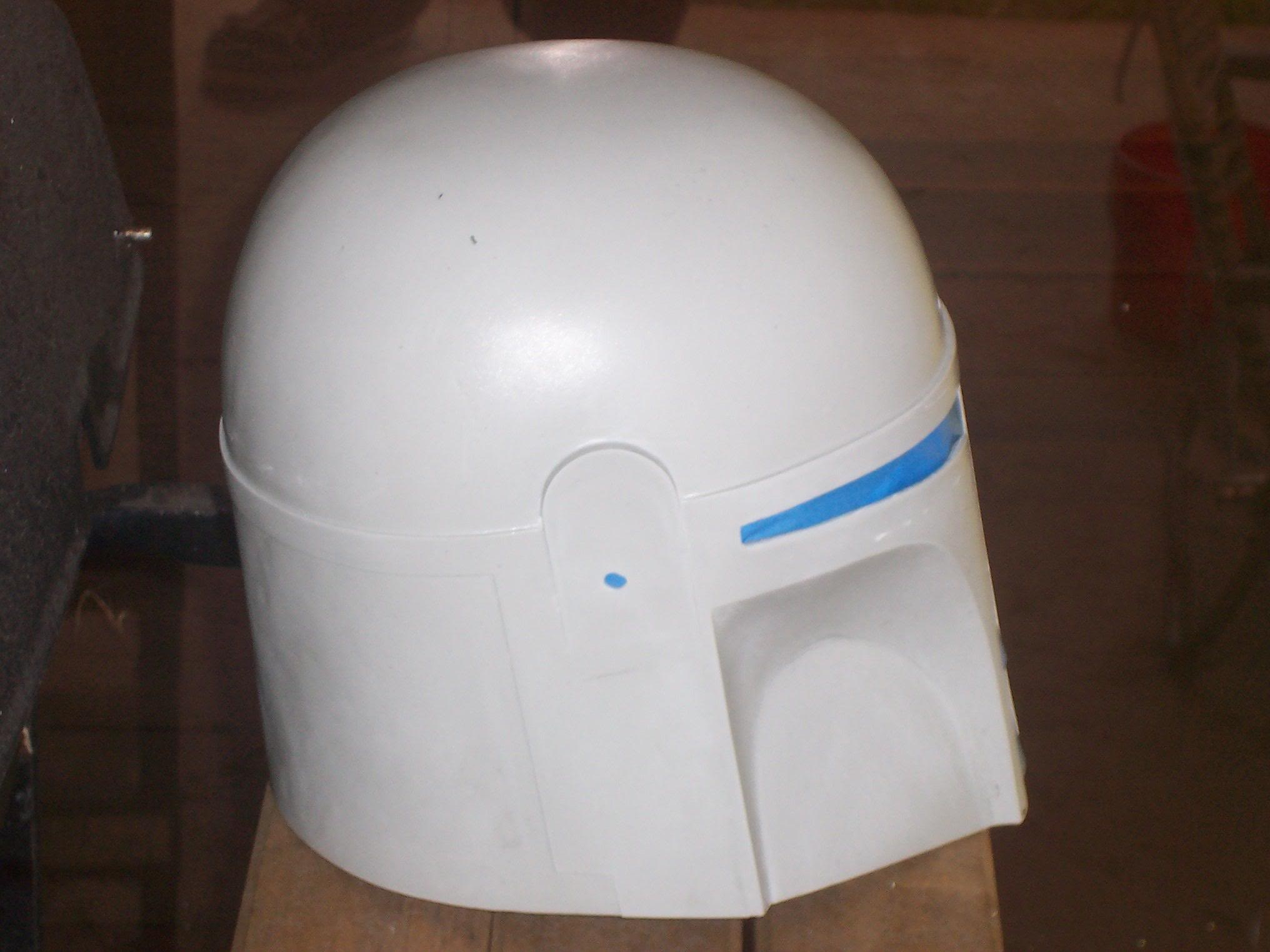

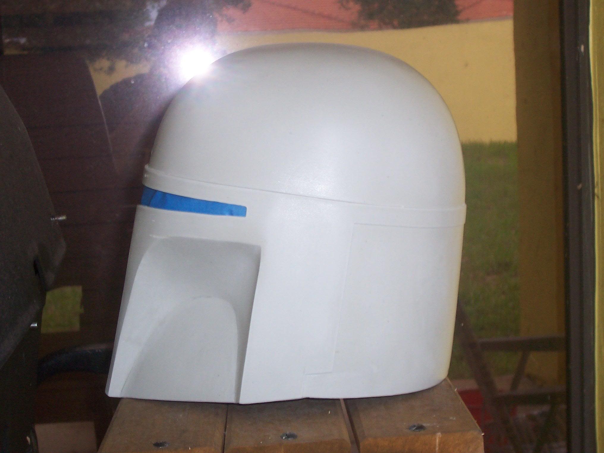

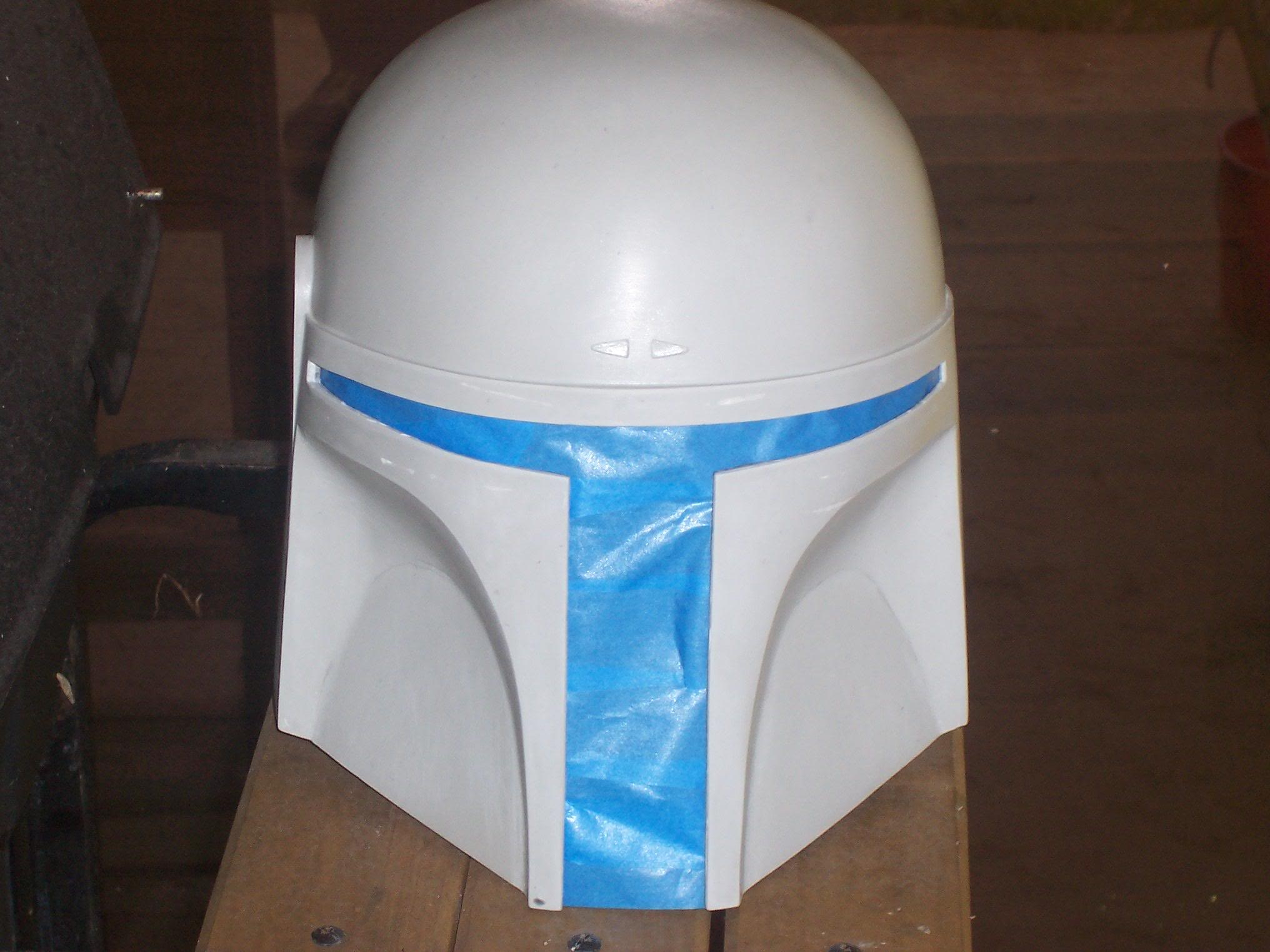

Okay, new update. I managed to finish the sanding the rough areas, and corners of the helmet. Just today, I wetsanded the whole helmet with a sanding sponge, and then with 600 grit sandpapaper. I applied the first layer of primer as well over the whole helmet. Right now waititng for it to dry so I can wetsand it again. Here are some pics as of now.
Just after wetsanding
As of right now with primer layer 1 (note: part of the dome looks kinda dull due to reflection from the fresh primer)
