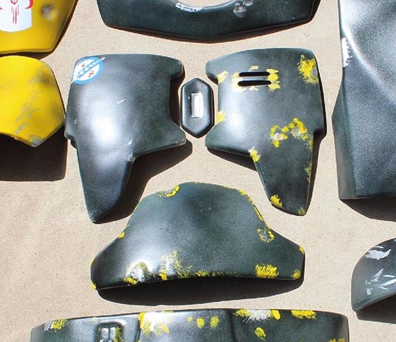

That's the diamond piece I'm referring to. What is a 'return edge'? Is that a kind of lip to the armour? No, mine does not have this if so. It is thick but flat and made of strong fibreglass. Can you tell me what is wrong with the weathering? Wow, I'm shocked how off it actually is. Can't escape the facts though!
From my inital glance, I would agree with the others have told you.
The center diamond piece does have an insert that's too big.
And yes, for 501st approval, your armor does need to have a return edge, as that's how the production versions were done. The pics in the gallery from the exhibition suits will show this detail the best.
The return edge is referring to a radiused edge that is rounded, suggesting depth, instead of square edged which makes the armor look flat. If you study the reference pics, you'll see that the armor has rounded edges. Some replica armor is extra-rounded and appears very thick, too much in my opinion, but it should at least have a rounded edge.

A picture posted without context doesn't help. The Detachment Leader for the 501st (Major) stated your armor does not have a return edge. It will be rejected. The armor posted above, while the paint job is not spectacular, does have a return edge. A spectacular paint job on armor that does not qualify does not magically make it qualify. The return edge was always in the CRL but was recently updated to its current wording because the previous "show depth and thickness" was too vague for some GMLs who approve the armor. You really need to post detailed pictures of your armor on thebhg.net and Major and others like myself will help you through the approval process if that is what you want.
There are other issues besides your armor in your setup I can see from your walking around pictures. If you want 501st approval those will need to be addressed. This forum (TDH) is more for Fett fanatics who share the love of Boba Fett and enjoy the costume. This should not detract from your work done, but LFL clubs (both 501st and Mercs) have their own approval standards and strict costume guidelines which differ from what is posted here on TDH sometimes.

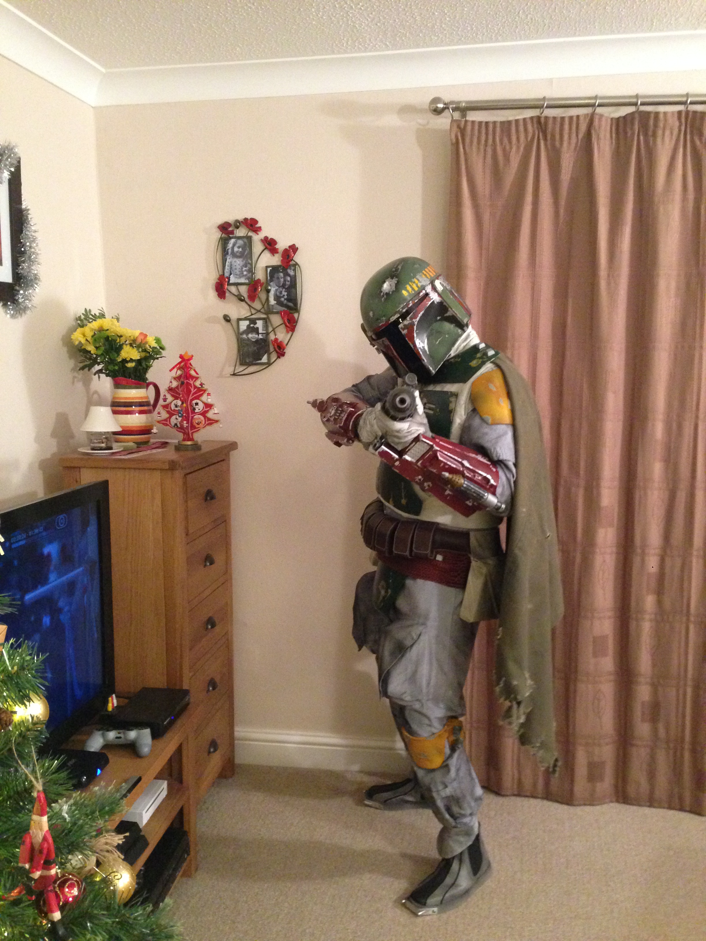

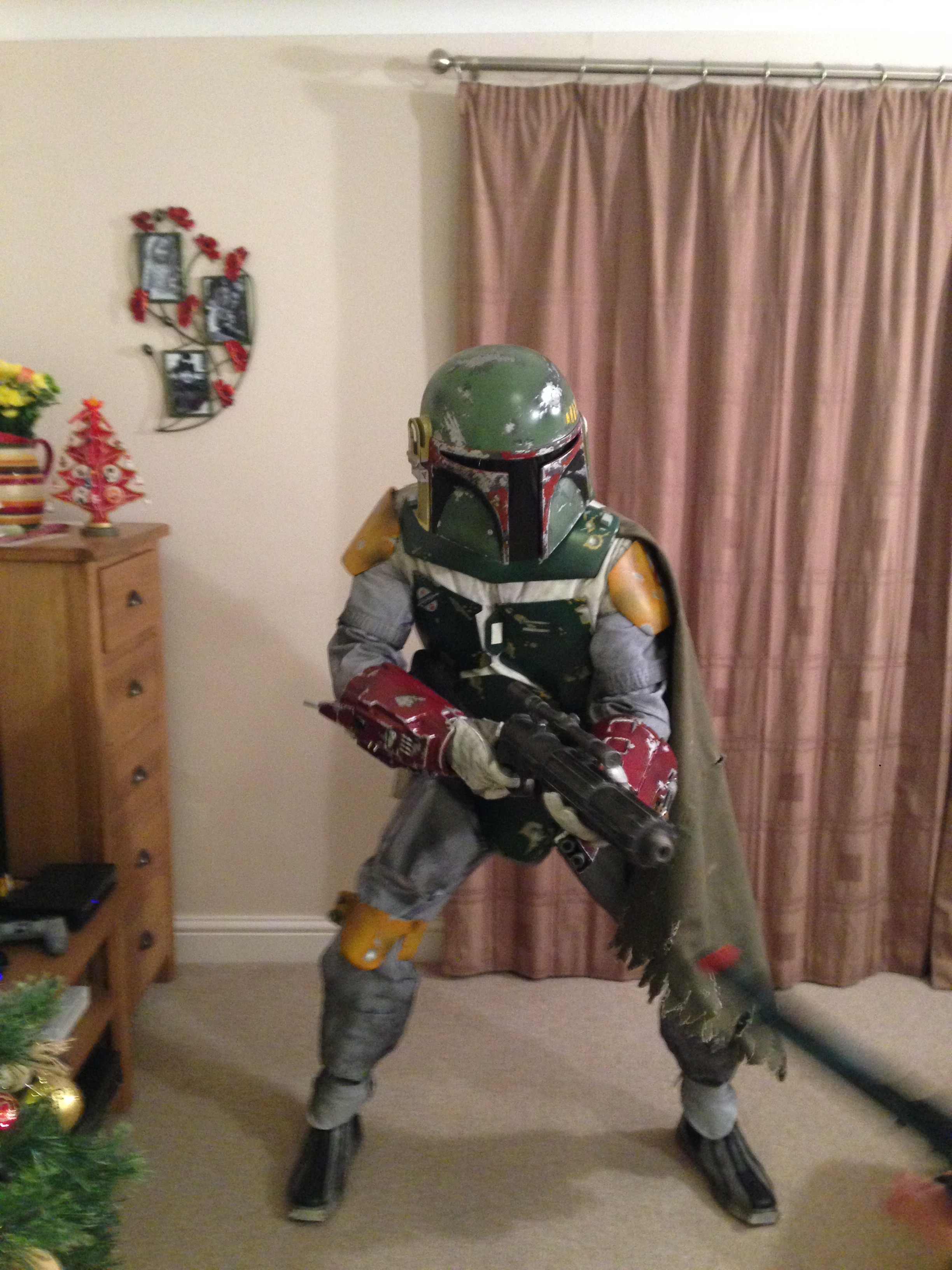

Just a few updated photos of me wearing the suit. Fit's perfect except for the knee plates slipping down. Tighter elastic needed. I hope it looks ok to a few of you out there!! I know the pics aren't great, I'm missing a few bits like range finder, shin tools, gauntlet pipes, back plate, jet pack etc, but I do have them all. The jet is a bigger project than I thought it would be (like everything fett I think). Apart from the armour not having a return edge, I hope it doesn't look to bad even for the purists out there.
