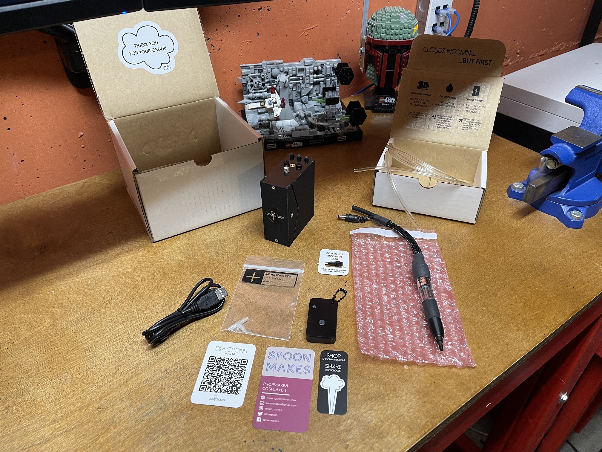

Hello there Fellow Fett's,
After pondering this for some time, I made the decision to get a Smoke Kit for the Thrusters on my Boba Maker Jetpack. My Jetpack, still needs to be finished in terms of painting. I've done a bit of searching and came upon a vendor that makes one that seems to fit the bill. I was looking for something low profile while also having the option to emit the smoke wirelessly. The vendor is Spoon Makes. I ordered the kit ($220.00 w/options), and within 5 days it arrived in my mailbox. Here is what that kit looks like....
Included was the following:
1) CosClouds 2 Base
2) CosClouds Vaporizer
3) Wireless Fob
4) USB Charging Cable - for the base
5) T-Shaped Splitter (Optional Add-On)
6) Extra Tubing (Optional Add-On)
I was highly impressed by this vendor (whose name is Alina). The kit is manufactured very well and the packaging you could tell was taken with great pride. Also, when I sent her email inquiries, she was fast to respond. And she definitely seemed to know her stuff when it came to producing cosplay smoke.

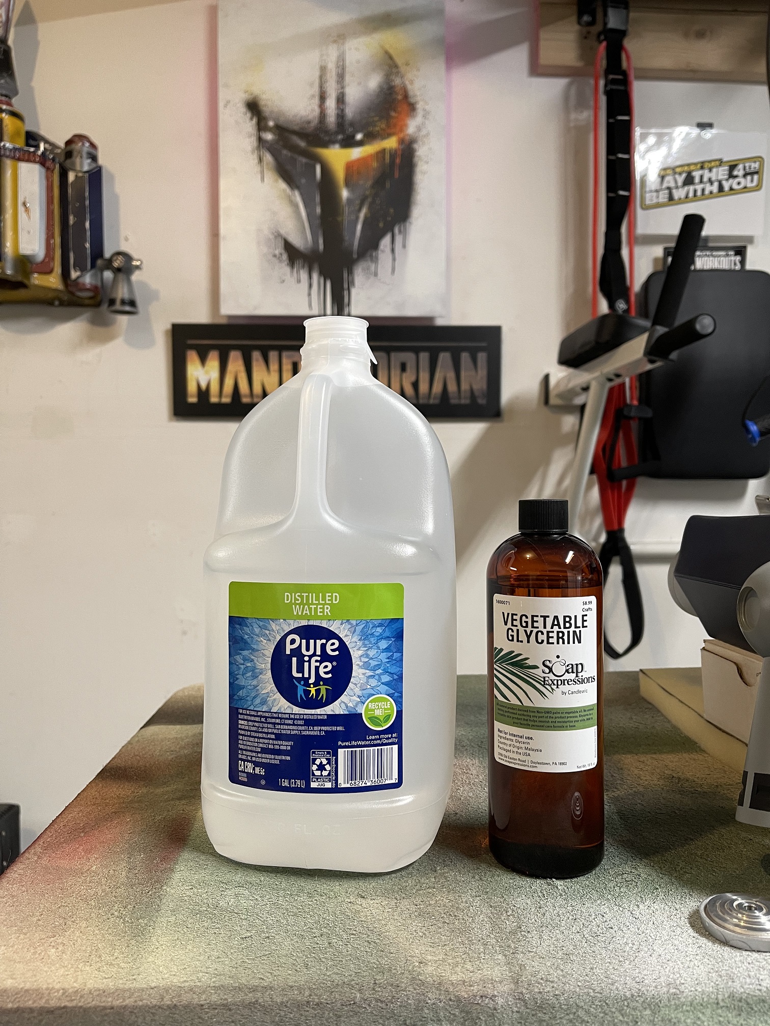

The things not included were the ingredients to make the smoke. Alina informed me that Vegetable Glycerin and Distilled Water were the way to go. So I went to my local Hobby Lobby and Grocery Store and picked em' up...

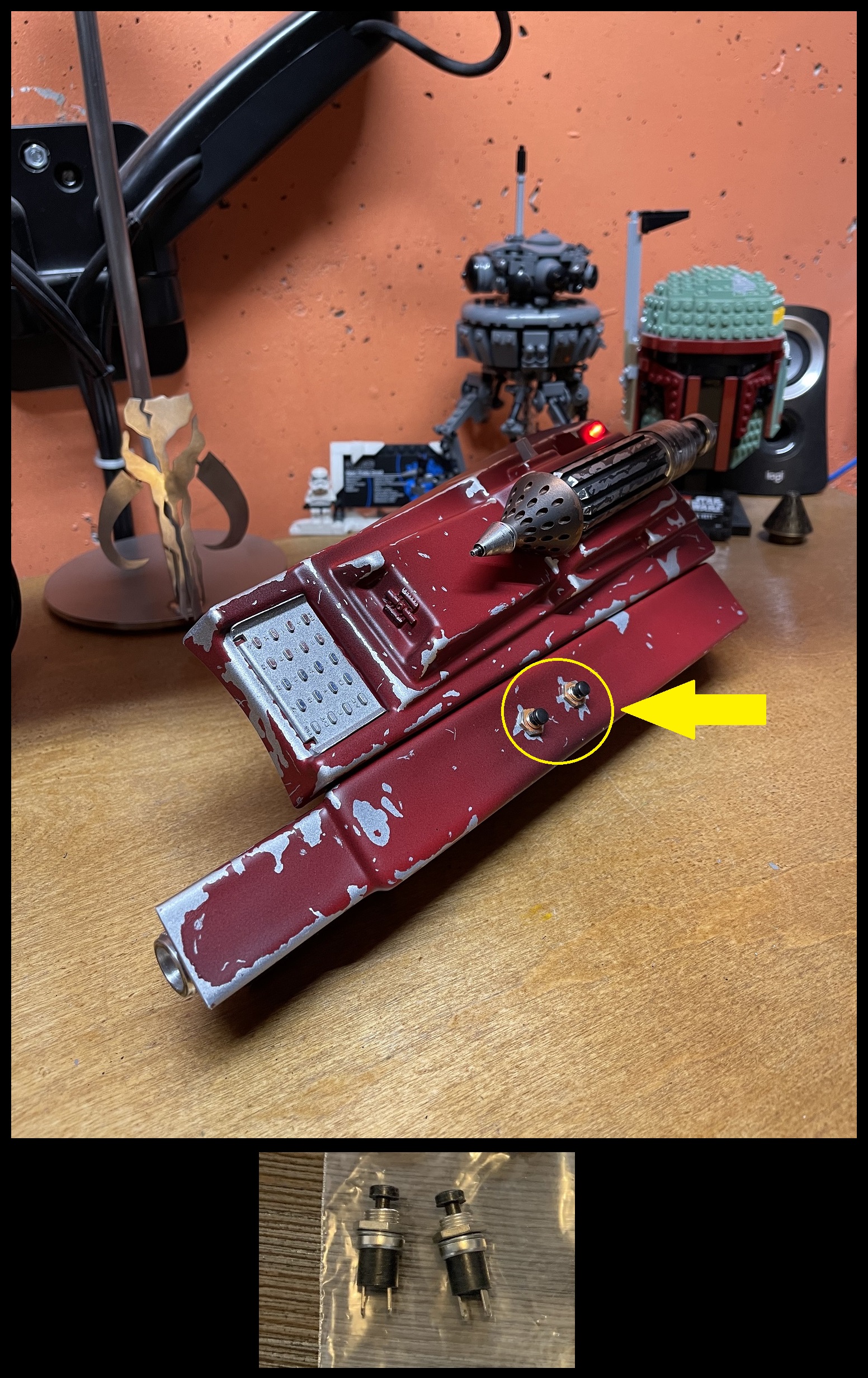

One of the coolest things about this kit was the fact that the Wireless Fob has a spot to where you can wire it to a button....
My idea is to get it wired to one of black buttons on the Left Gauntlet...

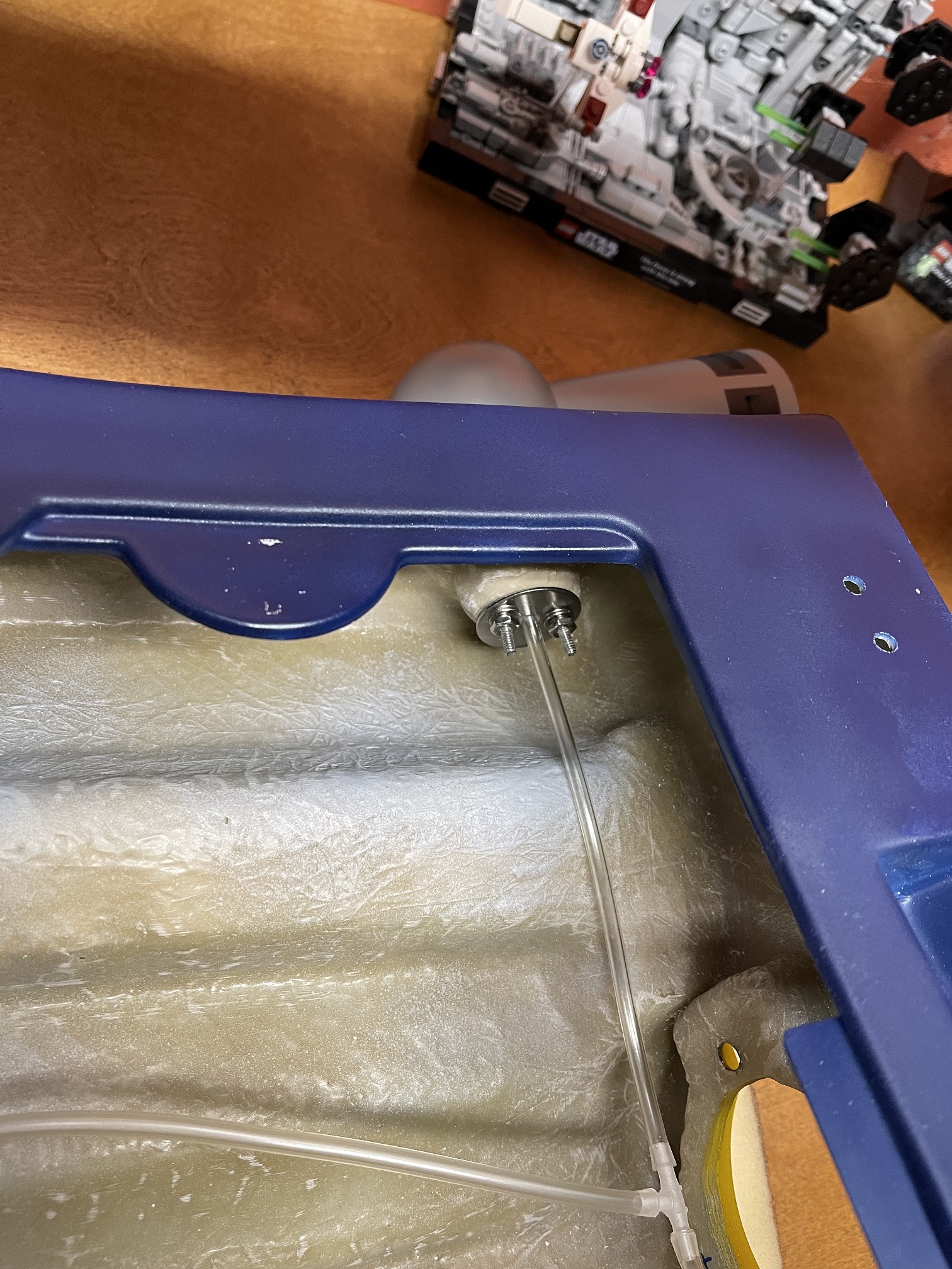

After receiving the kit I was pretty excited and began the install. Since Boba Maker configured the thrusters to be removable via bolt and wing nut, I had to extract the bolt so a hole could be tapped to feed the tube through - which wasn't too difficult...
I still haven't decided yet on how I plan on fixing the Thrusters to the Jetpack, but it'll most likely be permanent.
I got all the tubes cut to length, and I like the placement of the CosClouds Base unit in the Jetpack. For now, this was merely duck taped to the inside of the Jetpack, a more permanent solution to follow....

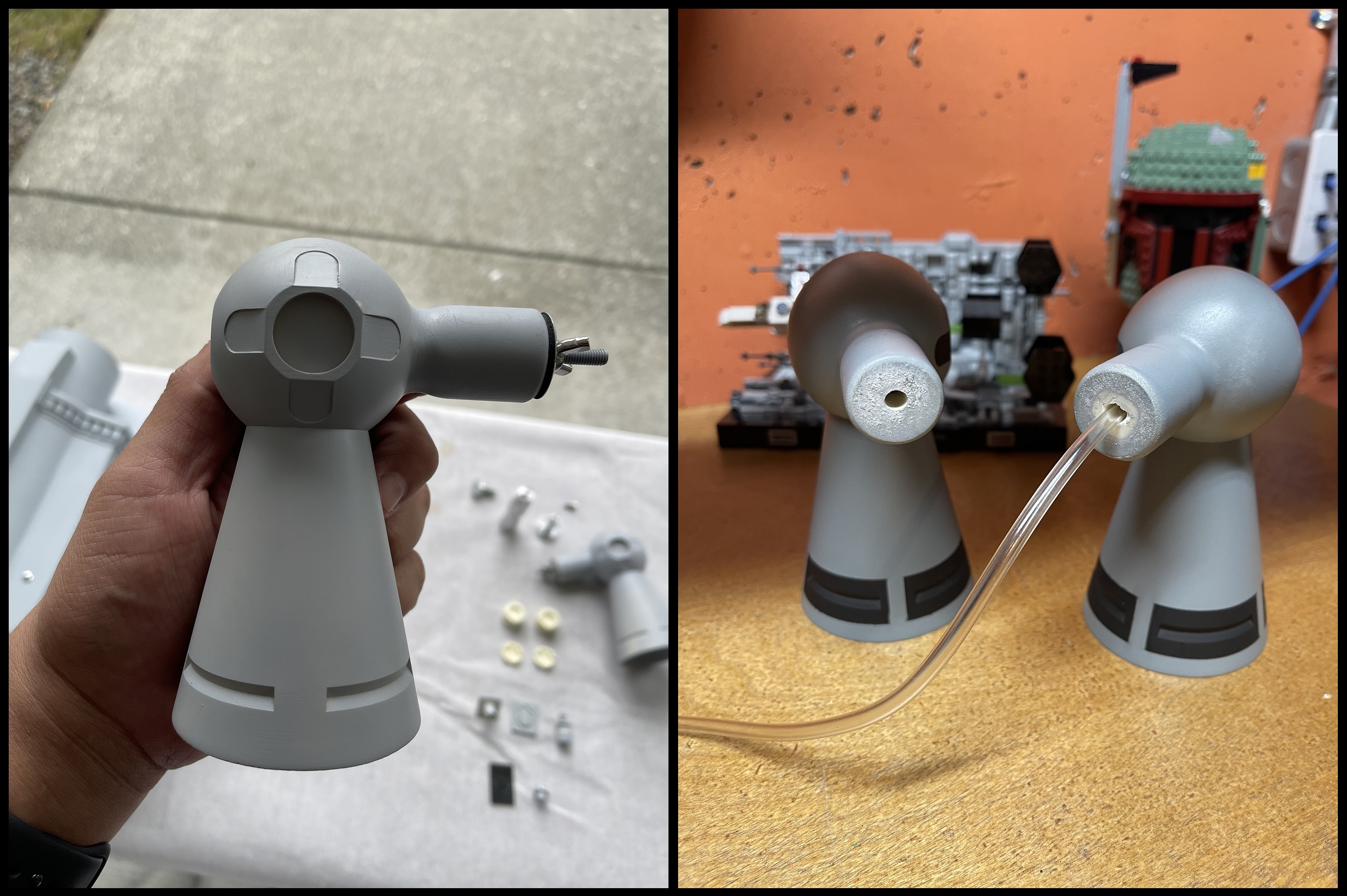

Another Jetpack update.
On Post #409 I talked about the Smoke Kit I recently purchased for my Boba Maker Jetpack. In the video, I showed my jetpack with the smoke effect. What you don't see is that the Thrusters are simply placed in my jet pack for that video - they are NOT secured in any way. In fact, I had a large pillow at the bottom during filming in case the Thrusters decided to fall off. And so, this is what I'll be focusing on in this post - Securing the Jetpack Thrusters.

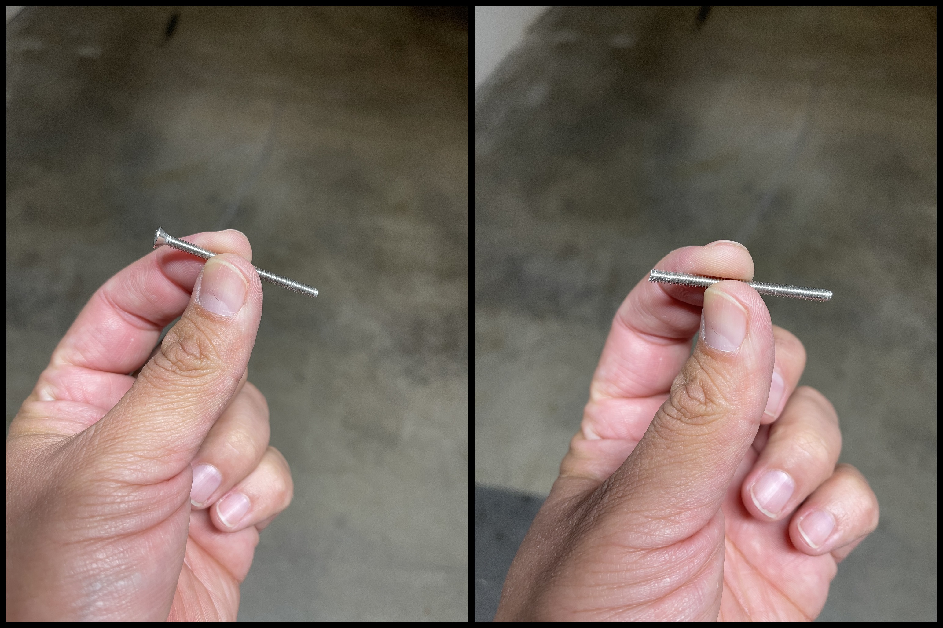

When I received the Jetpack from Boba Maker, the Jetpack Thrusters came with a single bolt embedded in the "Thrusters Arm" (I'll call it) center mass with a washer and wing nut for easy installation....
Being that it has a single bolt that made it so the thrusters could be turned and positioned. However, in order to install my hose (that the smoke goes through) so that it goes through the thruster arm, I had to extract that bolt and re-tap the hole to be a little bigger to accommodate the hose. But since I did that I lost the ability to have the Thrusters securely attached to the Jetpack. So I had to think of a way to get them attached securely. At first I thought epoxy, but I wanted to be able to remove them if need be, for serviceability.
After thinking about it, I thought up a solution - so I took a trip to Home Depot and obtained these items.....
Using the hardware pictured above, this is what I'll be using to get the Thruster secured on the Jetpack.
I took four of the #6 Bolts and lopped off the heads with my Dremel - in order to create a quantity of four, 2 inch pieces of "Threaded Rod"....
I tapped in two new holes in the jetpack's thruster channel where the bolts will feed through....
I then positioned the thrusters on my jetpack and from the inside, marked where I should tap the holes in my thrusters. Then using my favorite "Plastic Bonder" epoxy from JB Weld, I got the bolts embedded. They are embedded approximately 1 inch into the Thrusters...
The Large Fender Washer is to be used on the inside of the pack for added durability. I had to tap in two holes that lined up correctly with the holes I created....
I gotta say, it is pretty satisfying in coming up with a solution that works the way you envisioned it....
Sure, I lose the capability to turn and position the thrusters by having them mounted in this fashion. But to have smoke trial out of them instead, yeah, I'll trade it for that feature any day!

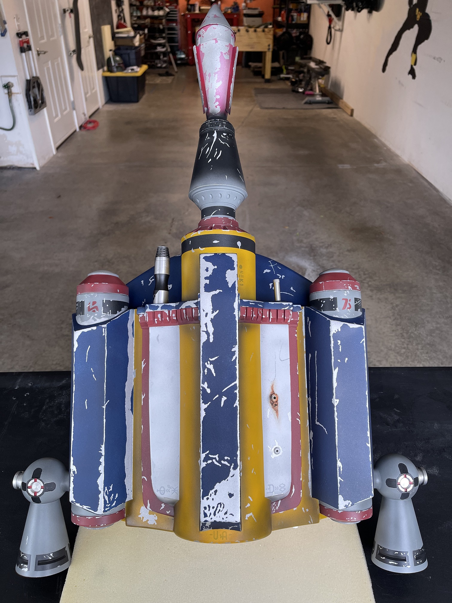

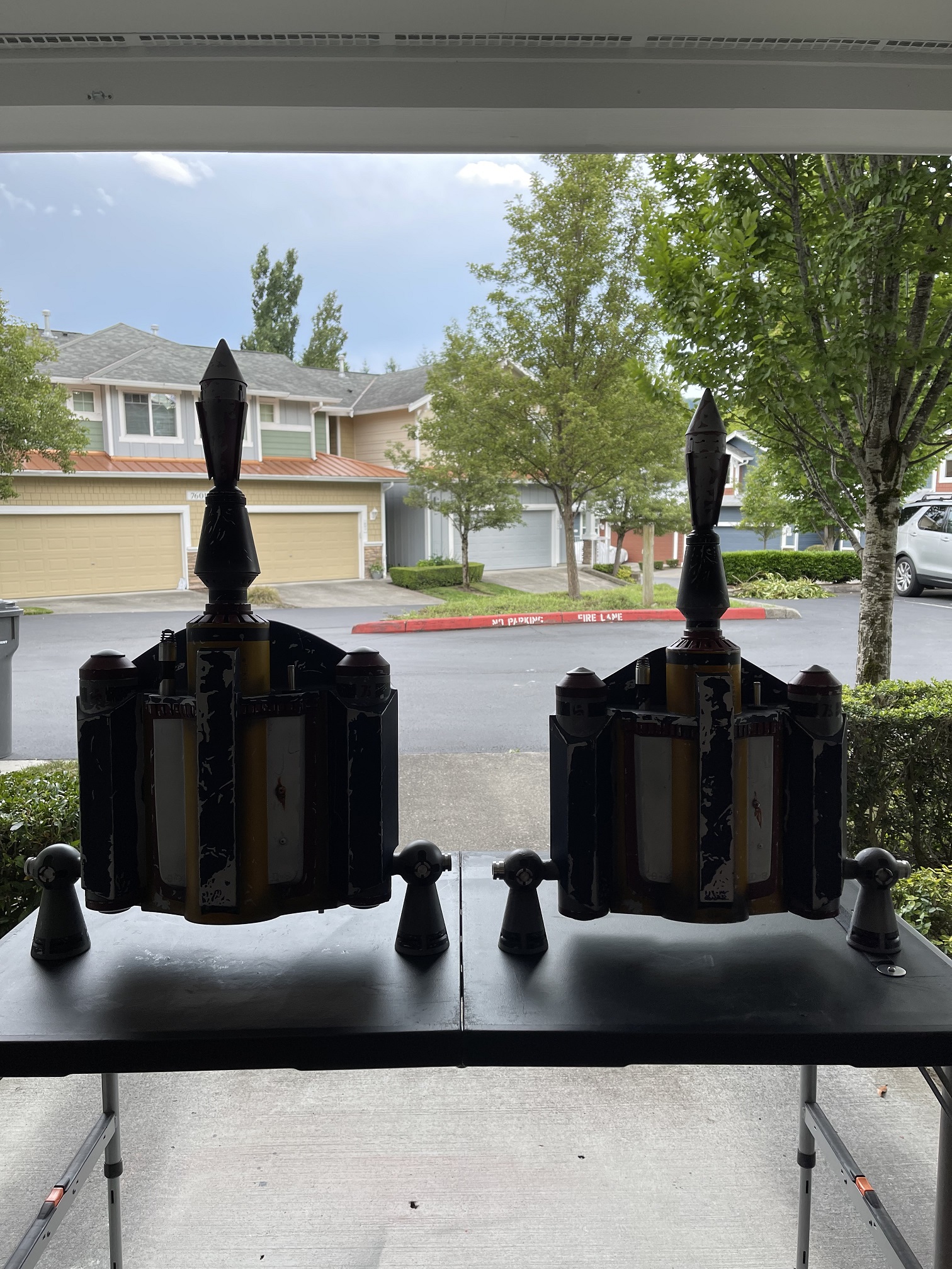

I finally got my Jetpack 2.0 (by Boba Maker) completed this past week! Just in time for....
I was hoping for cooler weather, but had to make do with mid-70's and 80 degree weather.
But here is where my Boba Maker Jetpack ended up at. (Big shoutout to ShortFuse for his kickass Jetpack stencils)

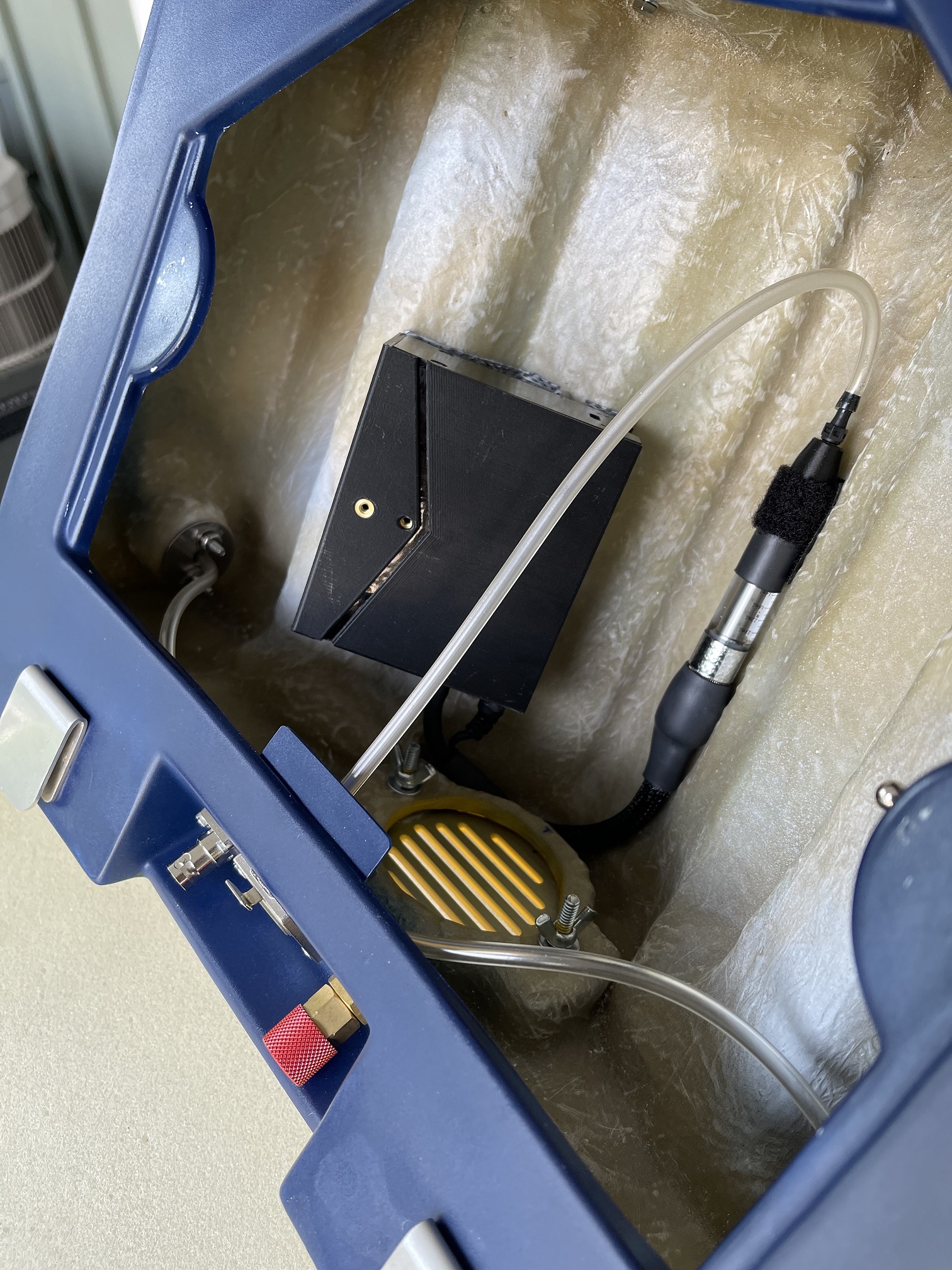

And here is the final resting places of my Light Kit for the Jetpack Beacon and Smoke kit are at....

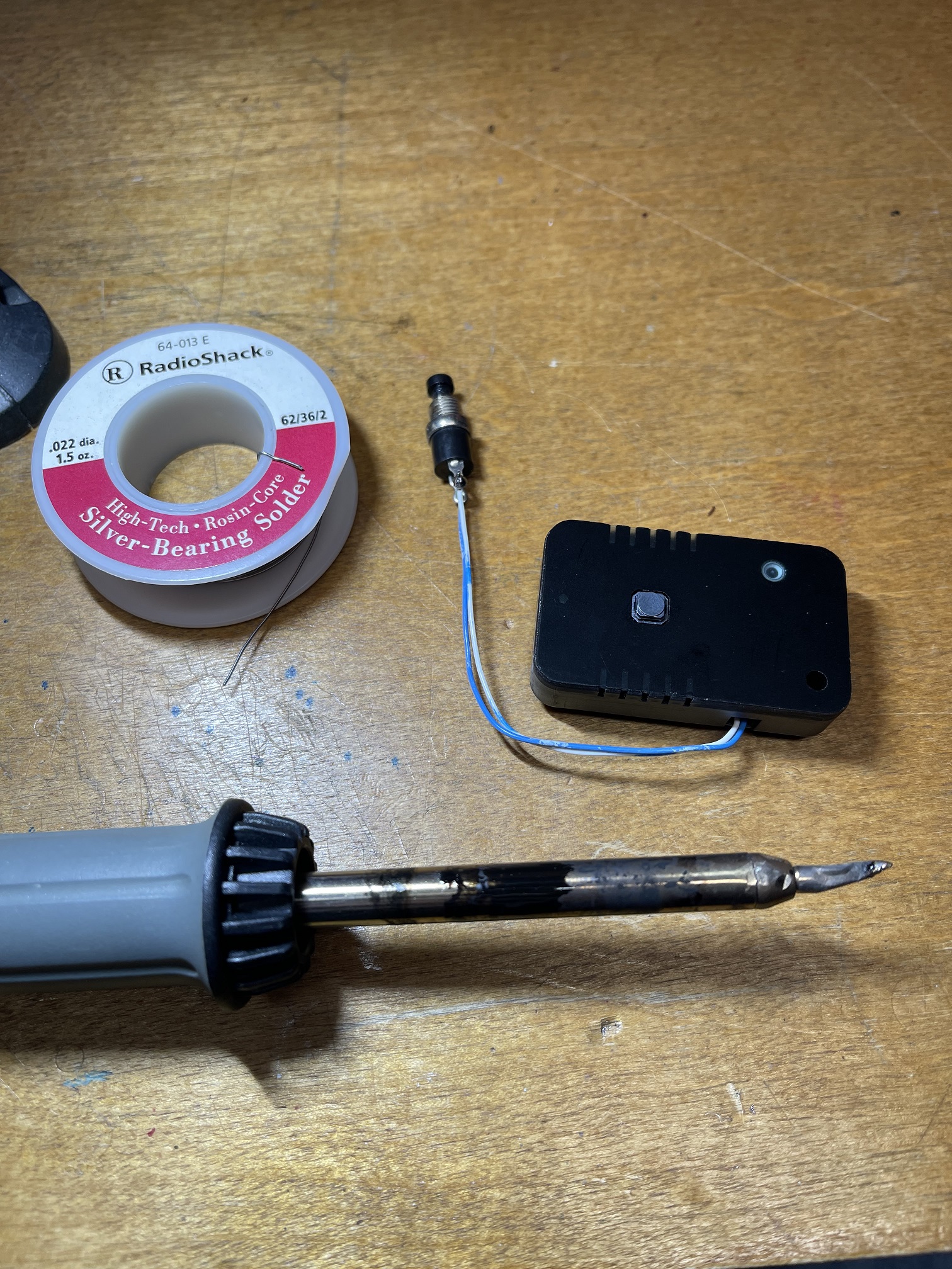

How is the smoke engaged you ask?
I soldered the wires onto a board and then onto the button....

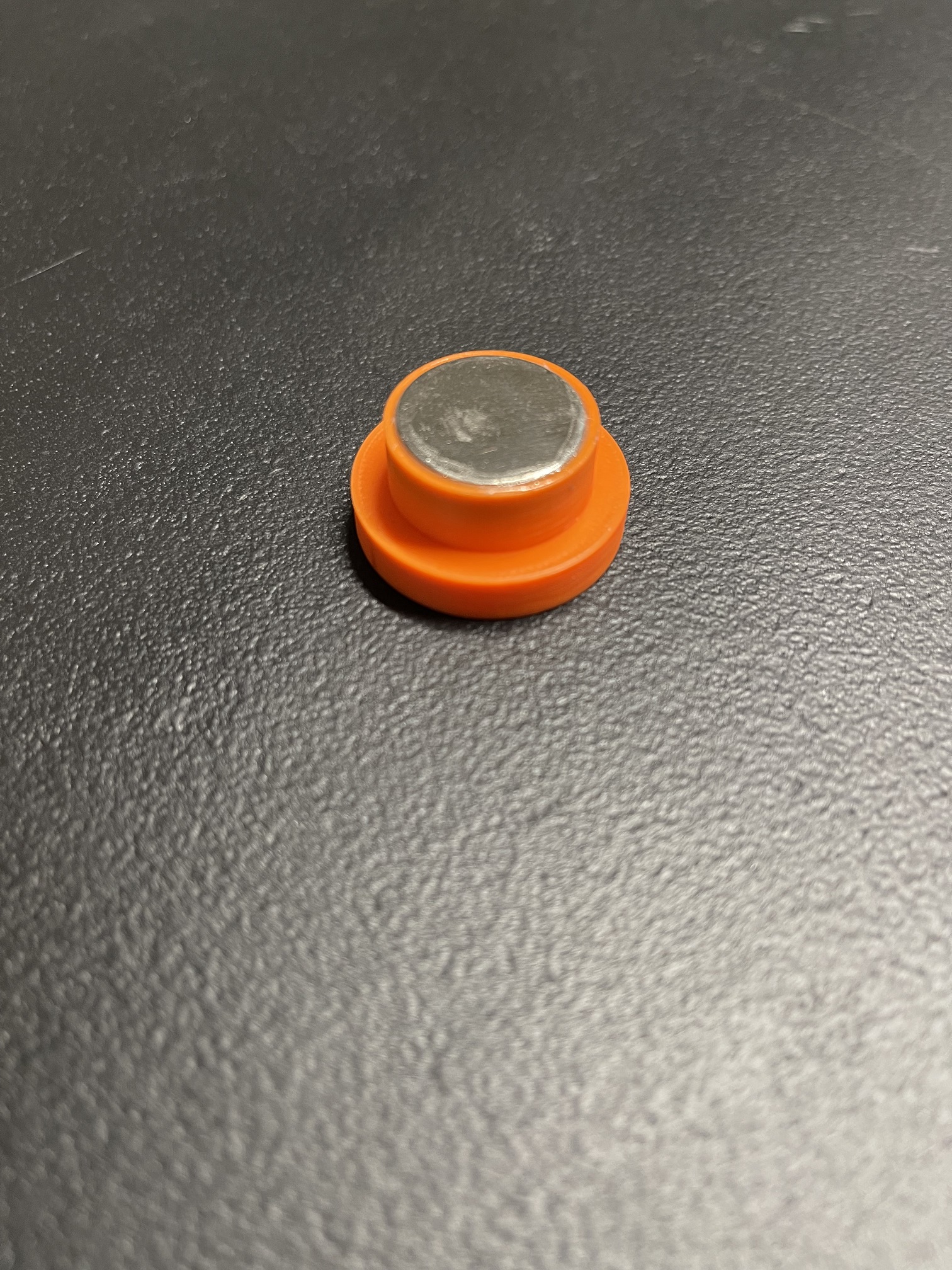

Over the summer I had my buddy create an Orange Tip for my Sindewinder ROTJ EE-3. Attached is that .stl file if anyone is interested. I epoxied a rare earth magnet in the orange tip so that the Orange Tip can be installed and removed from my EE-3 with ease. I also took a piece of round metal (like a washer), painted it black and put a hole in the center for looks and epoxied that into the barrel of the EE3. This way when people wants pics at conventions I can remove it easily (I then put it in my Ammo Belt Pouch). I know nothing about 3D printing - but if there are any questions I can ask my buddy and get his input for clarification(s).
-Iron
