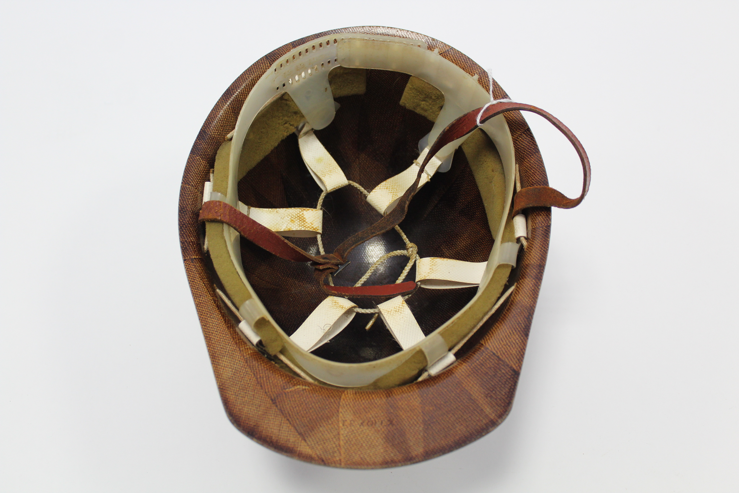

I think I used 3mm or 4mm nylon cord. I remember I bought several samples of different thickness but can't recall which one I went within the end. I want to say 3mm. I'm pretty sure I felt 2mm was too thin and 5mm was definitely too thick.

The truth is that I simply do not know. Certainly this cradle was in it when efx had it and obviously it was in that photo, which is relatively old but post filming. The ROTJ helmet originally had a piece of open cell foam taped in but latterly had the same type of cradle attached. This same item has also been seen in ROTJ Stormtrooper helmets. My suspicion is that this photo was taken in the early 90s or late 80s; it was the photo that was available to me when trying to recreate this aspect.
It is not yet glued in. As previously stated, it is easier to handle the item for painting without a load of stuff inside the helmet. I did make a minor adjustment to the cradle some time after the latest photo of it to change the leather padding forehead band.
Thanks, Andy. Yes, I've noticed that the RotJ TKs had them as well and they were also glued in (which I found a bit unusual). I've just ordered a really inexpensive construction helmet on ebay that has quite a similiar liner I plan to use. The only thing I'll need to change is the webbing against a 19mm herringbone nylon webbing and it should be just like the original.
The only other thing worth mentioning is the construction of the cradle itself. The model used on both the ESB and ROTJ helmet has the webbing tape threaded directly through the detachable plastic delta shapes that detach from the headband. If you look at post #5 this will make more sense.
I have had a fair number of different models of climbing helmet even since this thread was first posted. I have had some that were very early, which are always the closest, but in every case the webbing is attached to those little delta shapes by a small vinyl tab. I've never managed to find a model in which the webbing tape passes directly through the plastic in the configuration seen on the Boba Helmets. All of these climbing helmets seem to date from the mid 70s onwards. I recently found this same type of helmet cradle on something that dated from the 50s or 60s. The tape was not black, it was white, but crucially the tape does pass directly through the deltas without further littel vinyl tabs attached.
