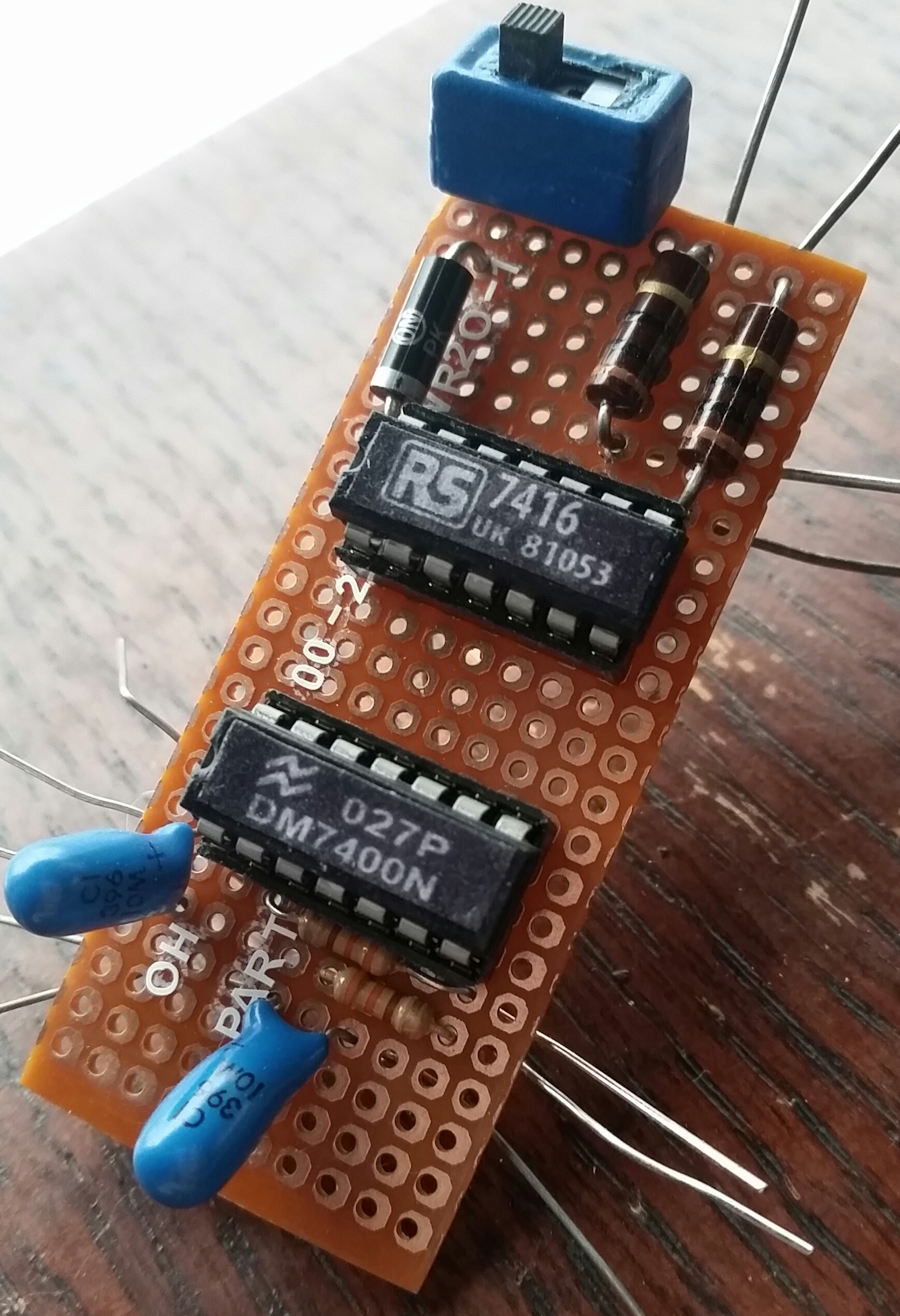

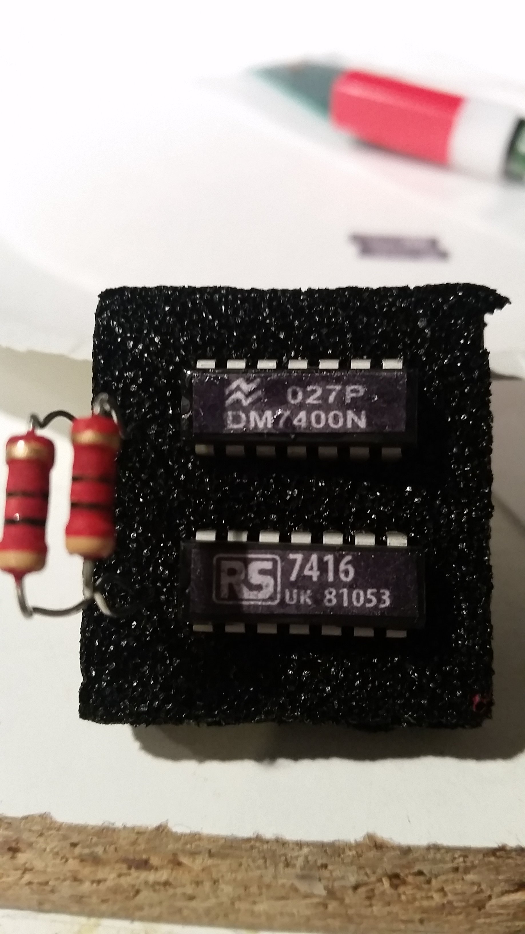

I basically re-made the print in photo shop and printed the files@19mm x 5mm. I used superglue to attach the prints and used the superglue to paint or blend the print into the superconductor. I was careful to avoid the white font. I will spray with a bit of dullcote tomorrow to knock that shine out. PM me your email and I well send you the files.

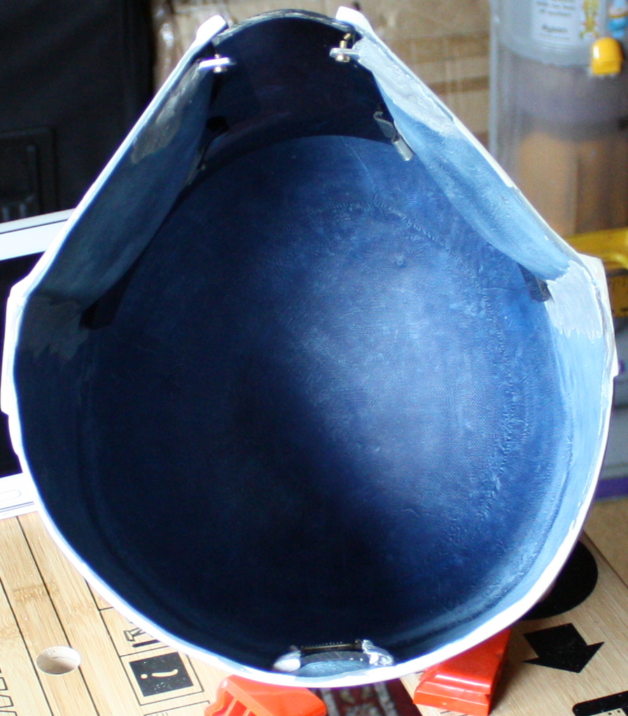

Not at all. Completely an aesthetic choice to try to mimic the putty applied in the same areas on the ESB hero but otherwise completely pointless. Better colour match required but no time for these things at the moment. The ESB helmet appears visibly thinner than the others which is probably as a result of the cloth (and not chopped strand matt) construction so the putty repairs on the esb at those points doubtlessly has real value because that's where cracks would appear.
Any structural considerations I added are hidden by the layer of FG cloth that is now painted blue and although that was itself another aesthetic choice rather than a structural one it was also a useful tool to hide the sins of surgery.

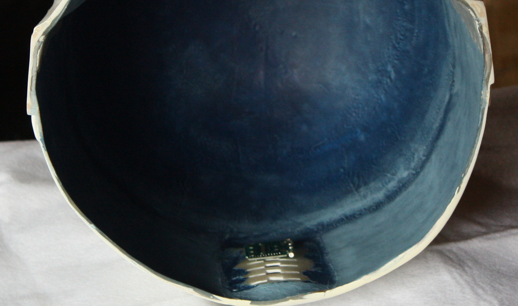

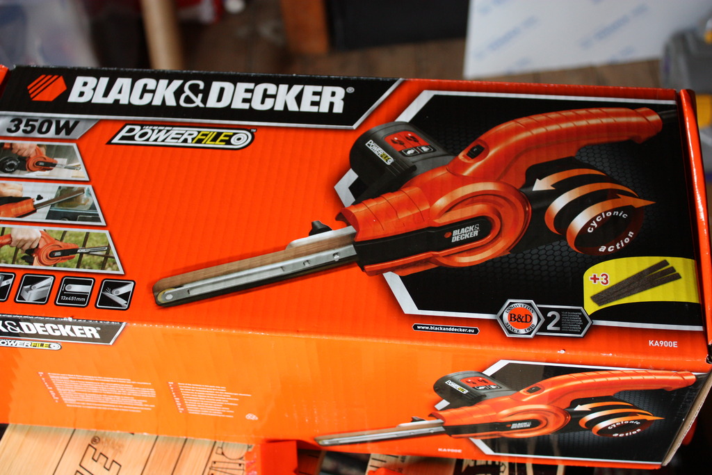

I've been working the interior keyslot area. From what I've seen virtually every helmet tends to end up with a lot of extra internal material at this point (also happens by interior of visor) and the fiberglass or resin tends to be very thick and requires thinning. Because of my general aversion to power tools I've done all that thinning by hand with files, rasps, and paper. Following a piece of advice from Ryan Day I've bought one of these for my next helmet:
I chose this brand because it was on sale but I'm sure they're all much of a muchness.
Once I'd thinned out the keyslots to the desired amount I lined up the calculator piece; there are loads of pictures in the gallery you can do this with. I chose one from 72 picture Edinburgh Art of Star Wars set to use. Although I don't find it particularly good as a long term glue I used Super Glue to hold it in place. It's good for this purpose because it sets quickly and it's enough to hold it in place until the other stuff goes in.
Once you've done that you'll need something to cover the lower slots. It looks to me like the material on the ESB helmet is of the same stuff as the visor. I still had plenty of off cuts and scrap from the actual visor cutting that I'd kept for just this purpose. I made my piece about 4.5 cm by 3.5 cm, again cut by hand with my trusty coping saw but any saw with a fine bade will work. Once you've cut it you'll need to line it up and lay it in place. Once it's in I used the same heat gun from the visor to shape it into place. I tried with gloves but needed to use my bare hands to feel it properly to make it fit so you might end up hurting your fingers here. Mine held itself in place quite well just under the MQ 1 piece.
I used Milliput to hold fix all this down permanently. I used superfine white because that's what I had most of. I considered getting some of the standard yellow colour for this but as it's not the right colour either and I knew I'd end up having to paint it anyway I went with what I had. Make small sausages and go slow being particularly careful when doing the MQ 1 piece so it doesn't come loose (hold it in place with one hand whilst applying the putty with the other). Once you've put some putty in so nothing comes loose you can work around the rest. Make sure you inspect the outside too because when you press it into place some of it will naturally become visible from the outside. I used a needle file to keep it tidy from the outside.
The putty is firm within about an hour and in twenty four it's rock solid. I need to do some paint tidy up around the putty which will be done after I've painted and finished off the putty itself. I think I might have gone a bit wide but overall I'm happy with it so far.

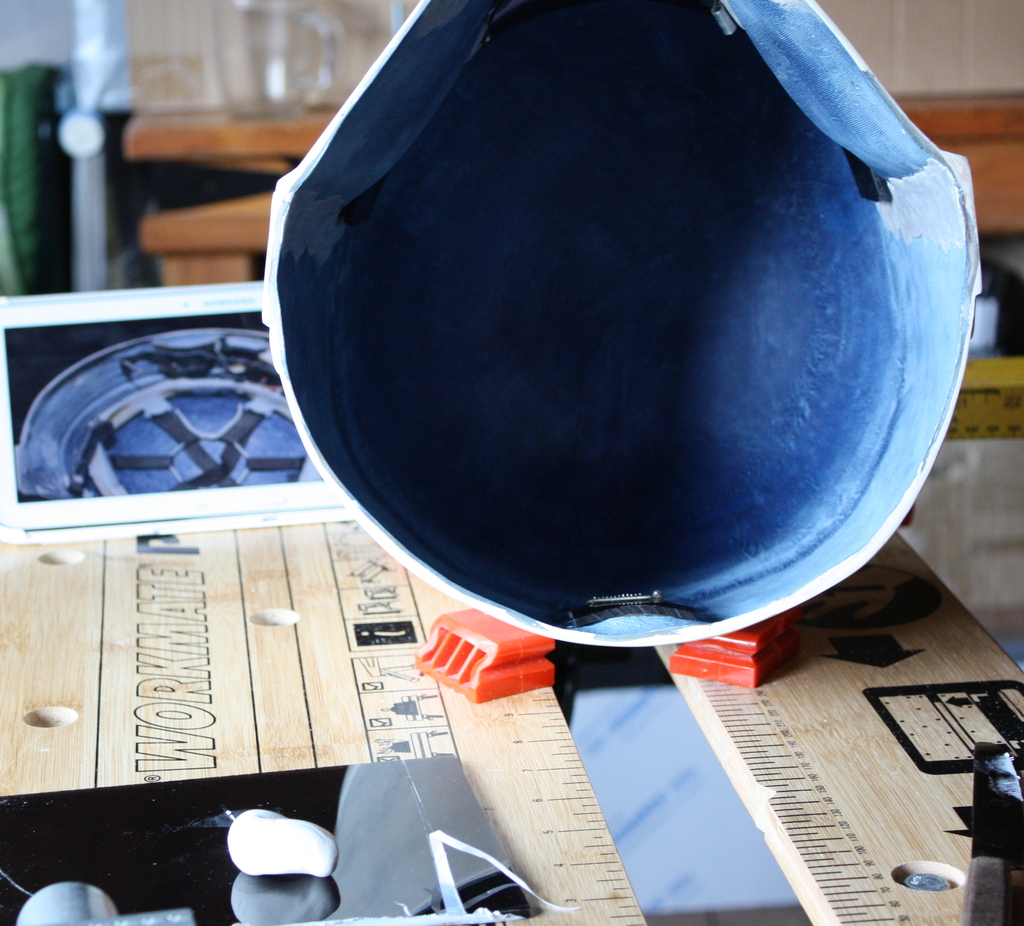

I used six or seven different acrylic colours from the citadel/games workshop line. I painted a pale blue base coat then really dark blue over it and then dry brushed each layer getting lighter each time. There was nothing overly scientific about it. Once I'd decided the interior looked like a pair of faded jeans that was what i aimed for.
What kind of paint did you use for the inside? :)
The Colours I used were:
Kantor Blue
Caledor Sky
Teclis Blue
Calgar Blue
Hoeth Blue
Fenrisian Grey
Etherium Blue
and more or less in that order as they get progressively lighter. Once the darkest colour was laid down each successive colours was dry brushed over the top. The switch started out black but was painted with one of the blues (Caledor or Teclis probably, I can't remember). The fine white putty was painted with Pollyscale Aged concrete.

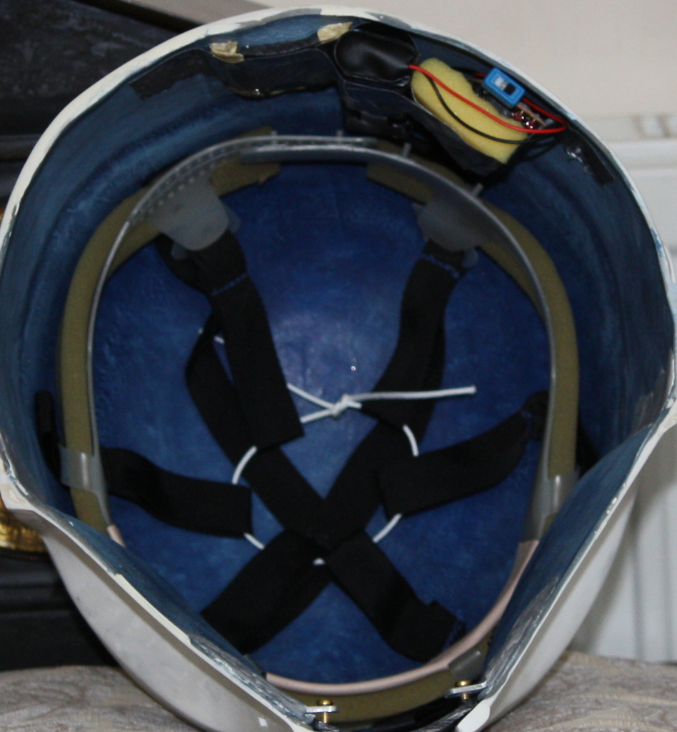

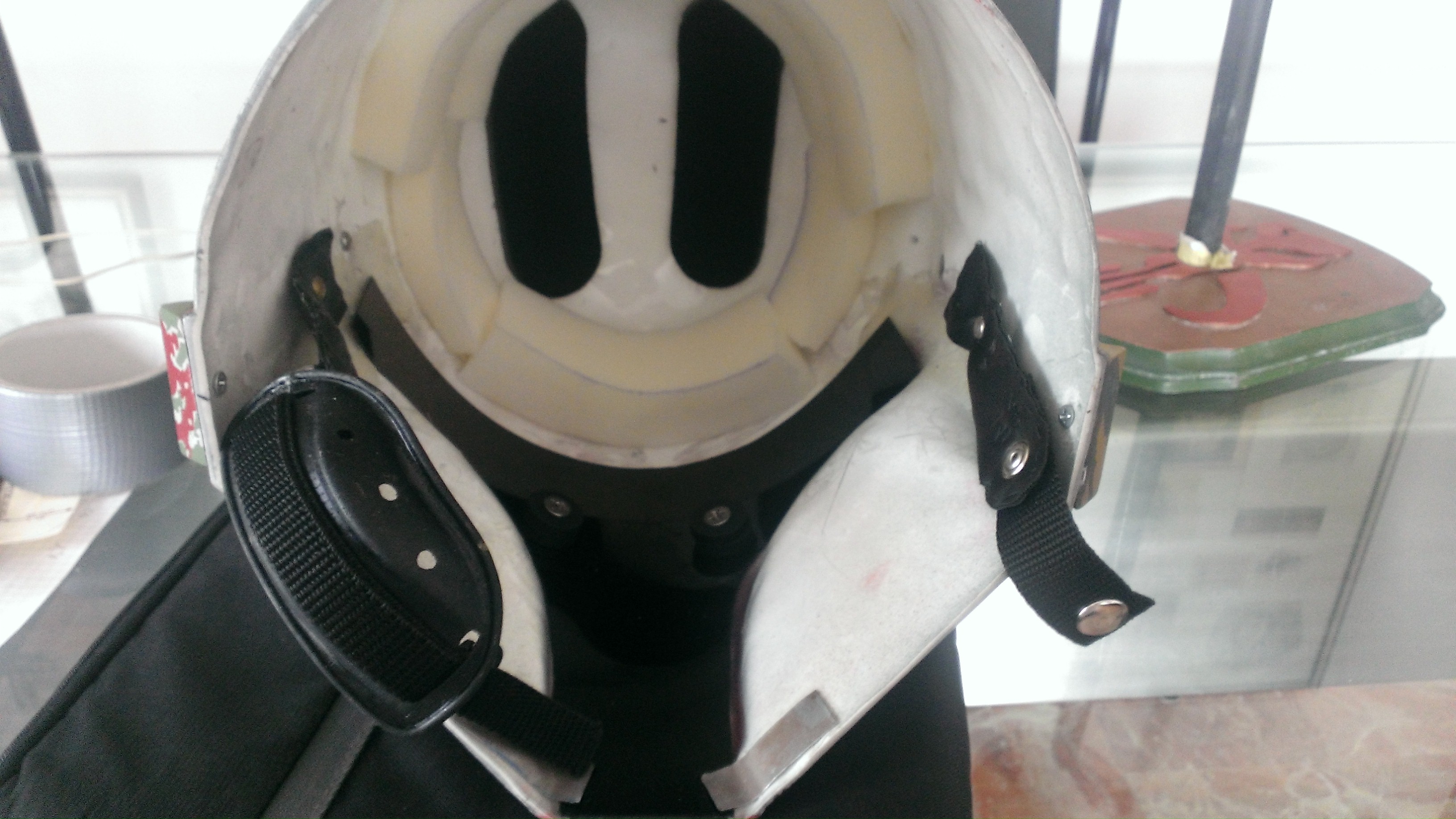

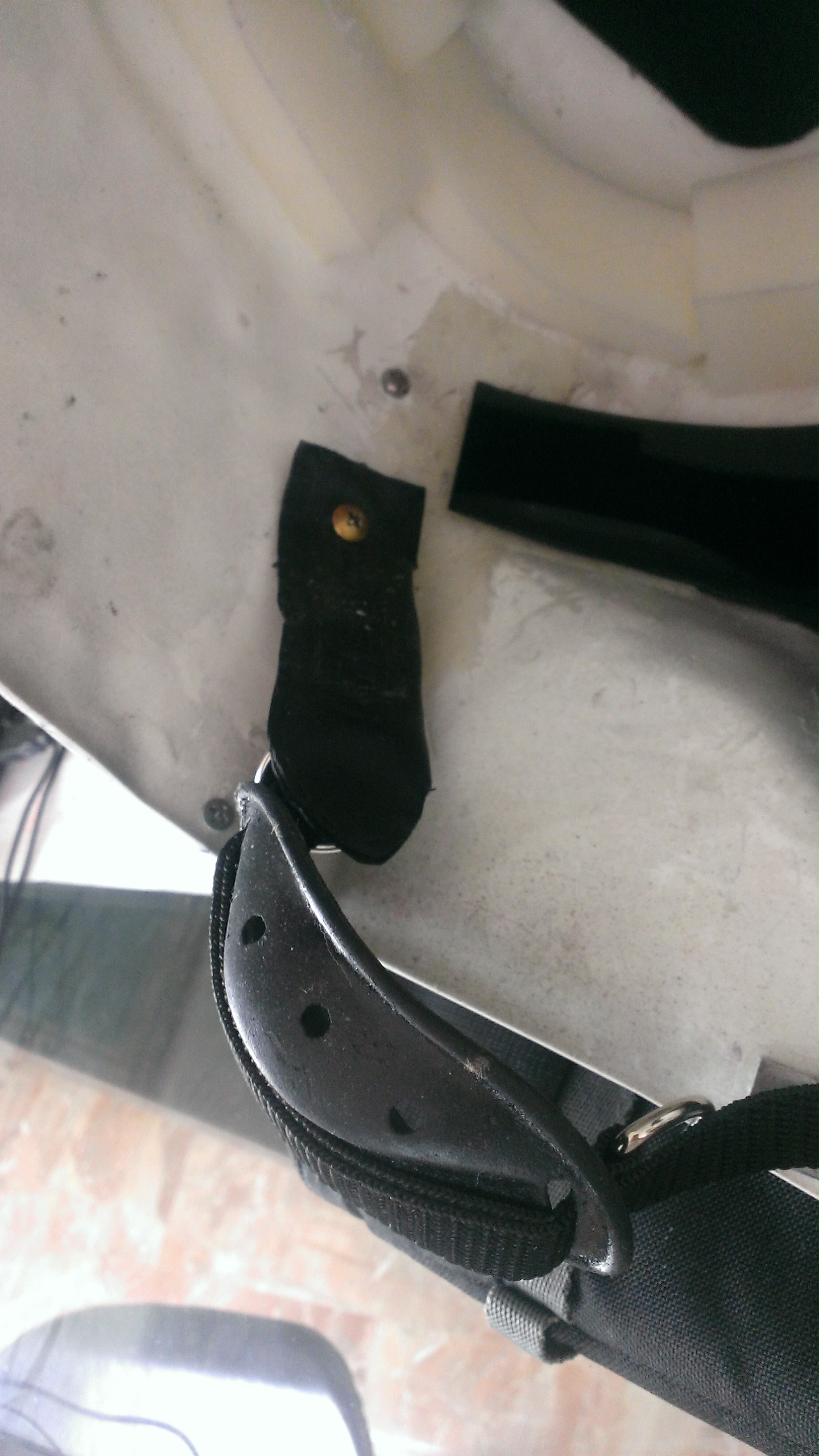

Fitted my cradle and test fitted range finder electronics and batteries. Just need to play around with the weight distribution and where to fit the Troopacoola remote control fan cooling system now. Thanks Andy for all the info this thread supplied . Just need to change the halo chord that connects the webbing together. Any information on what this should be made of ?
I think I used 3mm or 4mm nylon cord. I remember I bought several samples of different thickness but can't recall which one I went within the end. I want to say 3mm. I'm pretty sure I felt 2mm was too thin and 5mm was definitely too thick.
