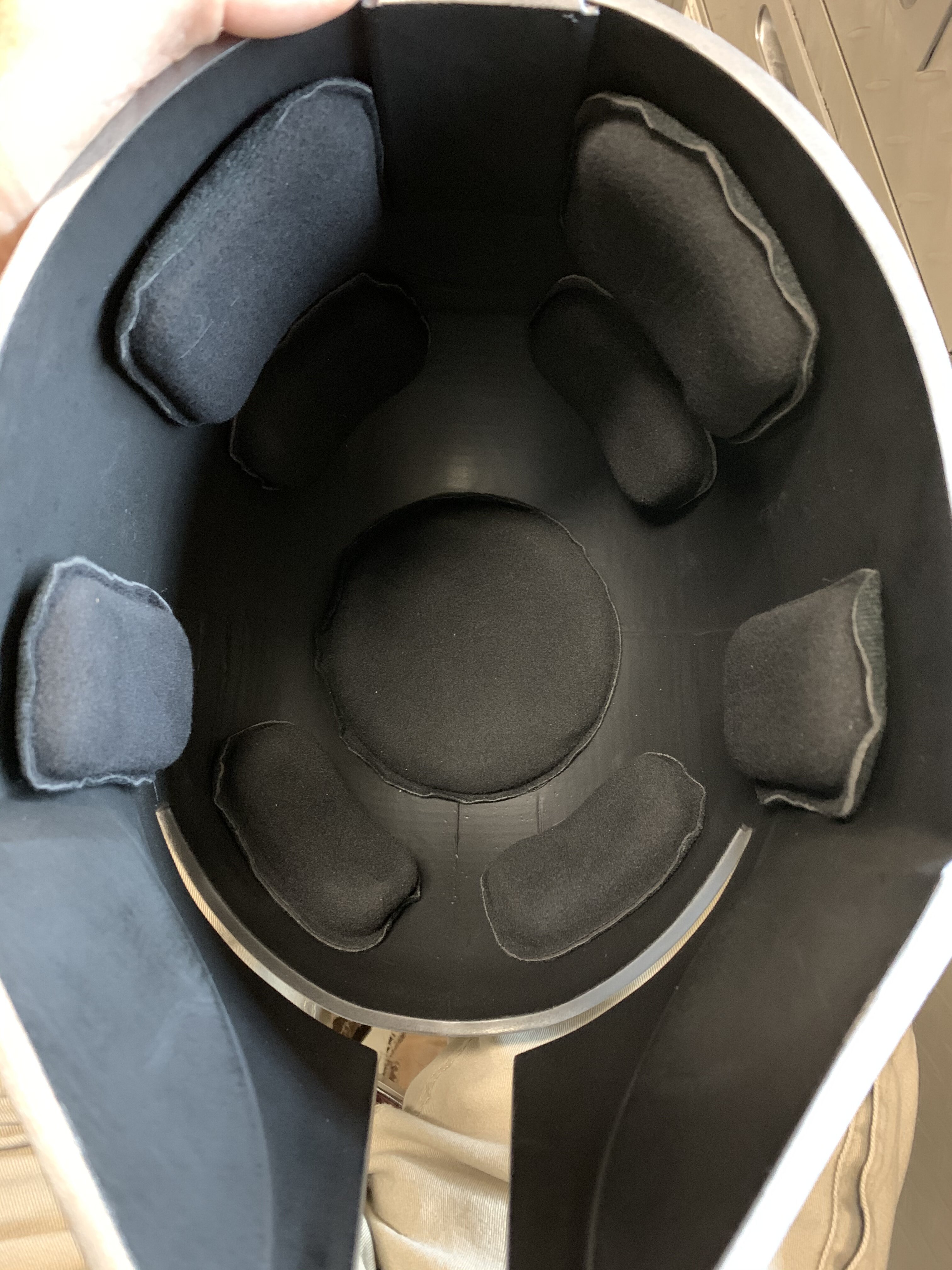

For padding you can buy replacement pads for a sports helmet pretty cheaply.
This is what I used although I have since repositioned the pads
