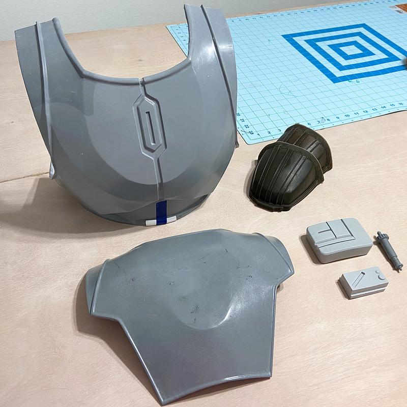

Acquired back, chest, belt greeblies and boot armor from T&A as well thanks to a trade.

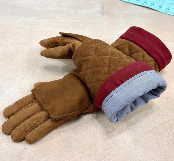

Long time no update! Got a set of gloves/gauntlets done.
Fabrics:
-medium weight 2-way stretch faux suede
-thick batting for the forearm section
-cotton lining
-soft minky fabric for the inner glove to give it a padded look, but it's very stretchy so movement is unimpaired
I think I'll want to remake these in real suede if/when I buy a leather sewing machine I have my eyes on.

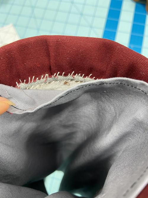

Here you can see the lining.
Tried to match the correct number of rows of quilting vs. screenshots, etc.
All layers were stay-stitched for durability.
These of course will get weathered/airbrushed when I get all the fabric pieces done.

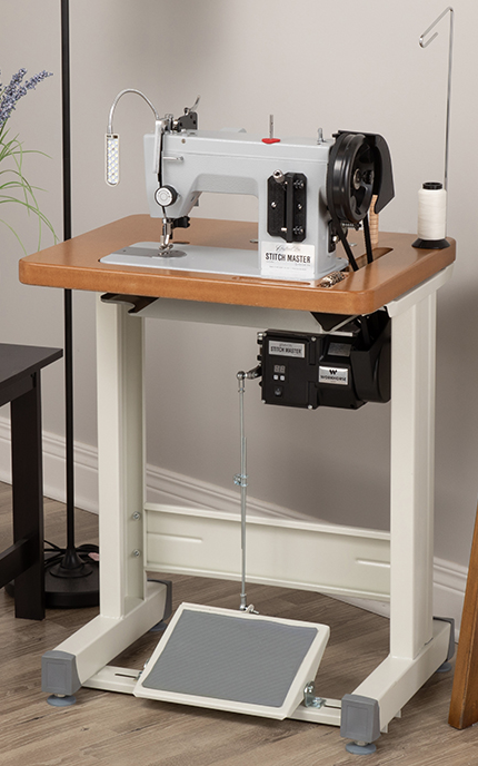

I will also be gathering some leather to tackle her skirt, boot covers, belt and gloves more appropriately because I picked up this beast, the Sailrite Stitch Master leather sewing machine:
I haven't sewn leather extensively before, but I do know it's laborious, and I just don't have the time to hand sew. Since I'm tackling Din/The Mandalorian next, this will most certainly come in handy too.

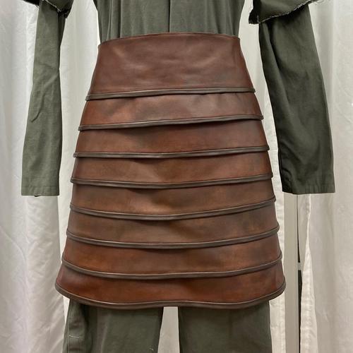

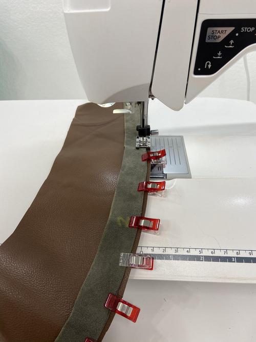

For the skirt, after mocking it up in muslin, I moved onto leather. The tiered layers are cut from a 3oz hide, and the binding is cut from calfskin. My methodology is a little unique for this skirt. The hide is a chrome tan hide, so the urethane layer was removed from the tiered levels after sewing the binding down.
The binding is sewn down.
The binding was glued down and then glued again under each piece since there is no visible topstitching on each tier of the skirt.
The urethane topcoat was stripped with acetone. Proper respirators and ventilation is absolutely essential when working with solvents.
I then used Tandy Eco-Flo waterstain, touching up areas as needed with Angelus leather paint.
After staining, painting and sealing the leather, I sewed down each tier onto a cotton-stretch underskirt. The pieces move well together between the stretch of the underskirt and the 3oz leather. I will need to wait until my Sailrite sewing machine is repaired in order to work on the tabard portions on the back of the skirt.
I may lighten up the brown tones at a later date, but I'll see how weathering the rest of the costume goes next.
