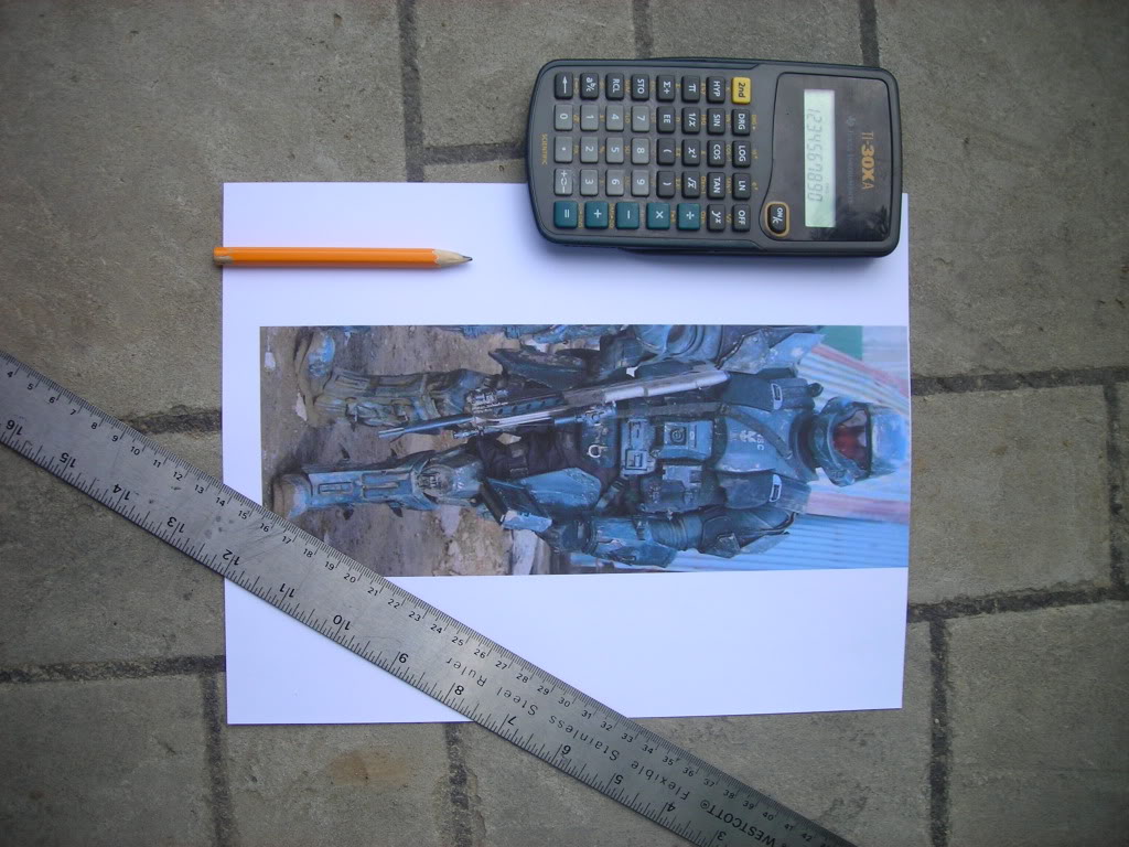

In a few moments, I will explain each step in detail, but first off, let’s talk materials. You will need:
1-A Ruler
2-A Pencil
3-A Piece of Paper
4-A Calculator
5-A Printer
6-Pepakura Desinger (Any Version)
If you do not have a printer, use one at your school if possible, or use a friends or family members.

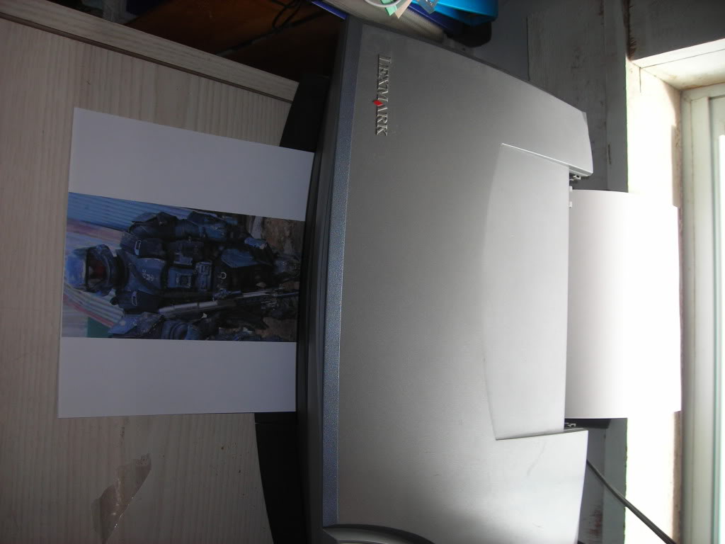

Now, you need to print the picture you will be using. Make sure the picture has the full character in it! Make sure no parts of the figure are cut out of the picture. Now, print the picture off your computer using the printer and common sense. If you do not know how to use the printer, get somebody who knows how to use the printer to help you.
Once you have the picture printed, it should look like this:
ATTACH]

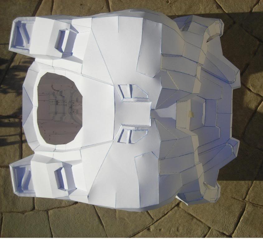

Now, finally for the Last step-Making a dream a reality. Input the height of the armour piece you just scaled (AKA for me, the helmet) into the pepakura desinger you own. Print the pieces off, and pep the piece. Once finished peping, the helmet or what ever piece you just printed off using this scaling method, should fit perfectly.
Remember, if you have the right picture, you can scale that piece to be perfect for you.
Now, just as a last thing for this method, I can totally say, that this scaling method, if used properly, is one of the best possible ways to scale your armour. Using this scaling method, I have scaled My ODST helmet, My ODST chest pieces, my ODST torso, my ODST shoulders, MK.VI Chest, Shins, Thighs, Helmet and Hayabusa Helmet, and they all fit awesomely. None of the pieces have any fitting issues, and every piece is very easy to put on and wear.

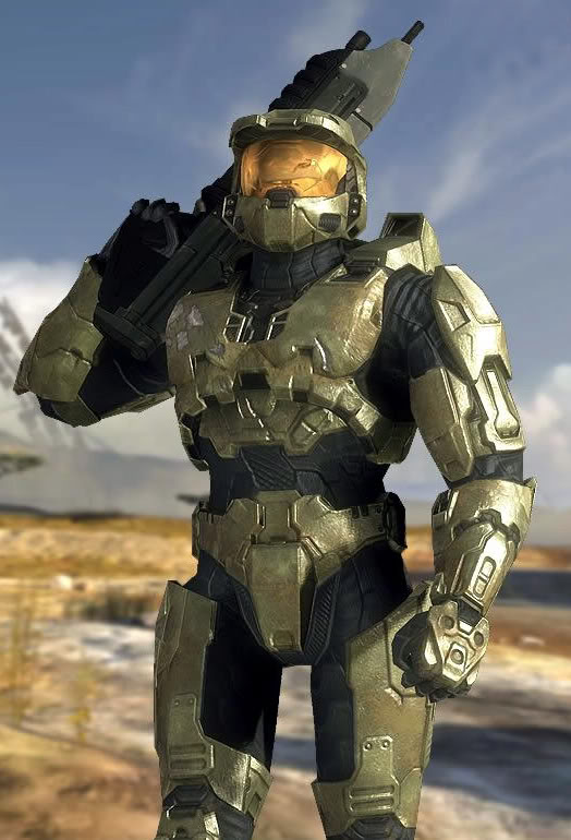

First you will need a few decent reference pictures. For demonstration purposes, I will be using an in-game screen-shot of the Master Chief in his legendary armour for the scaling of FlyingSquirls MK.VI Torso:

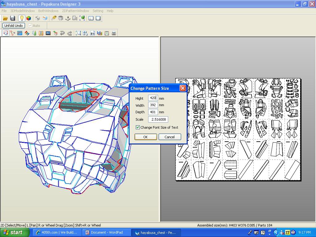

Well, there’s no better place to start then the First step- Measure up. For this grab your friend or second person, and hand them the measuring tape. Now, have them measure the height, width or depth of the area of your body that will have the armour piece you are scaling on. For example, I will be using Flyingsquirls MK.VI Torso. For this specific piece, have your partner measure from one of your arm-pits to your other arm-pit and add 2cm-5cm for padding, and fiberglass. For me, the width (Arm-pit to arm-pit) was 39.2cm. If you are making another piece, look at your reference picture(s) to find the basic where abouts of where the piece lies, and how bit it should be on the body.

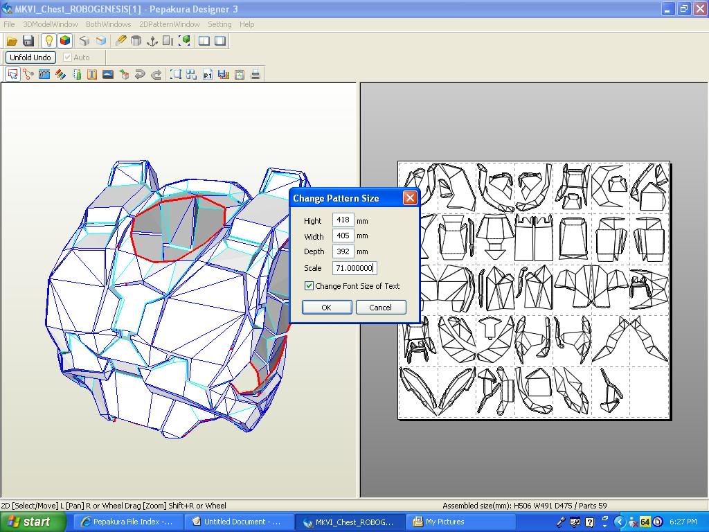

Now for the second step-Type in the numbers. For this step, take the number you just got (for me, 39.2cm or 392mm) and input it into the scaling table. Do this by opening your Pepakura Desinger of choice, clicking on "2D Pattern Window", then going down the list to "Change the Scale of Development". From there, click on "Specify Scale", and input the number. From there, all of the other numbers should snap into proportion:

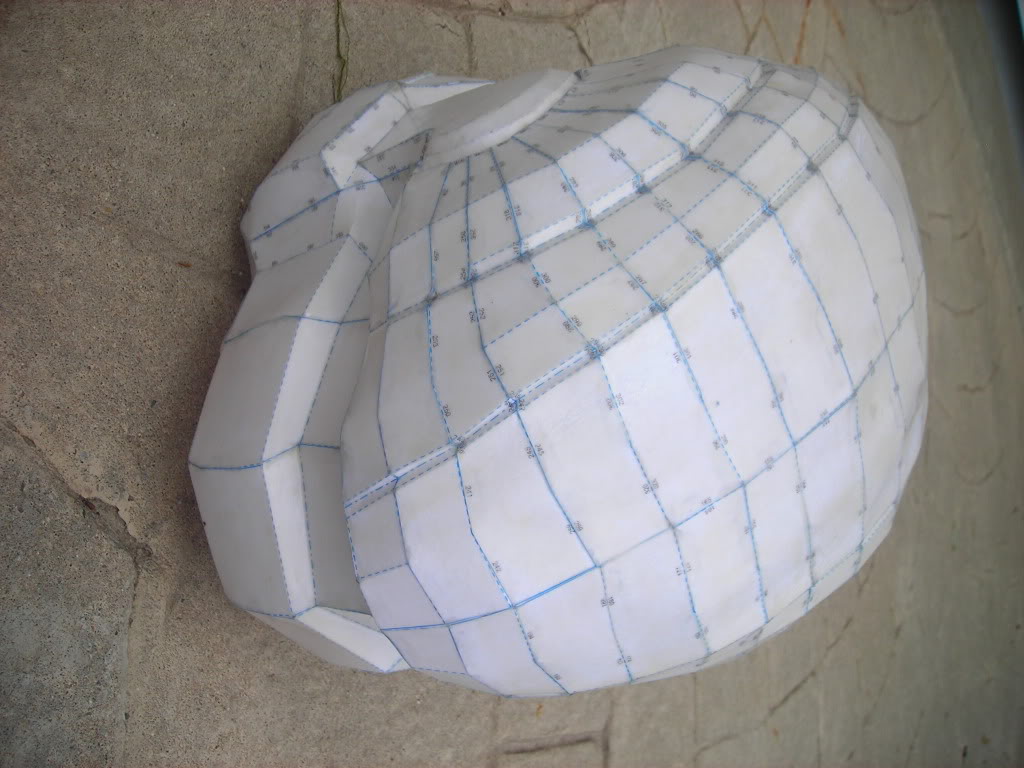

And finally, the Third step: Print, Pep, Smile. Simply make sure all of the pieces of the armour are within the dotted lines, and make sure everything is scaled to your calculations. Click "Print" and watch the Cardstock go into the printer blank, and come out with all of the solid lines, dotted lines, dots and numbers. From there pep the armour piece, and there you go. Ready for resin, Fiberglass/Slush Casting/Hot Glue:

For the Second step-Scale the file, get Robogenisis’ MK.VI pep files from the Costume Wiki. When you open them, they should look something like this:
Now, this is where you change the scale. Do this by clicking on “2D Pattern Window”. Now, go down to “Change the scale of development”. Then click on “Specify the scale”. Once you click on that, a small box should show up in the center of your page. The scaling number for all of Robogenisis’ files scale should read 86.000000. Now, take your height in inches (for example, I’m 71 inches tall) and replace the “86” with “your height”, Example “71.000000”
