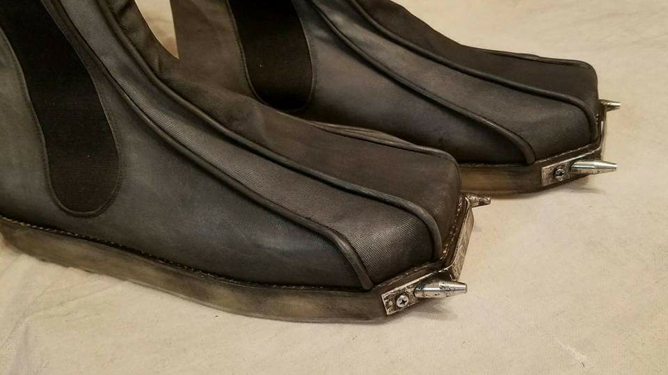

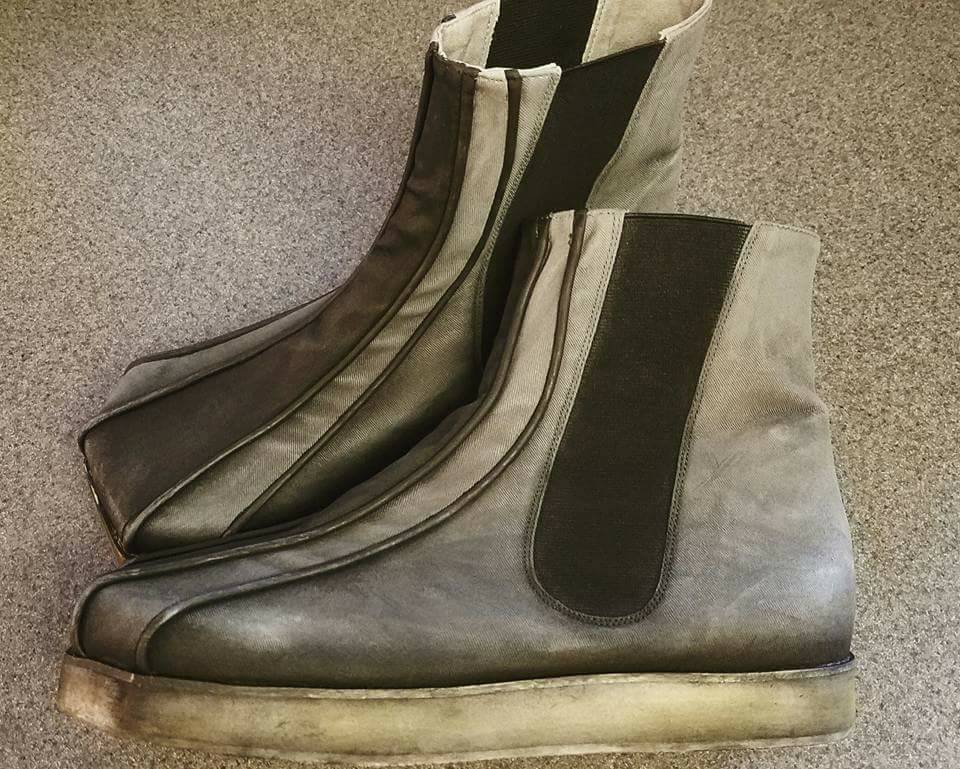

I got both the cape and boots from MoW, I masked off the soles, sprayed some water over the boots and built up layers with watered down black acrylic, getting in the cracks and working my way up. dry brushed in some brown and gray to blend. once dry, I hit the soles with a dry brush of a little yellow, then with rubbing alcohol rubbed it in to look worn. dry brushed more black and brown. lightly building up all colors

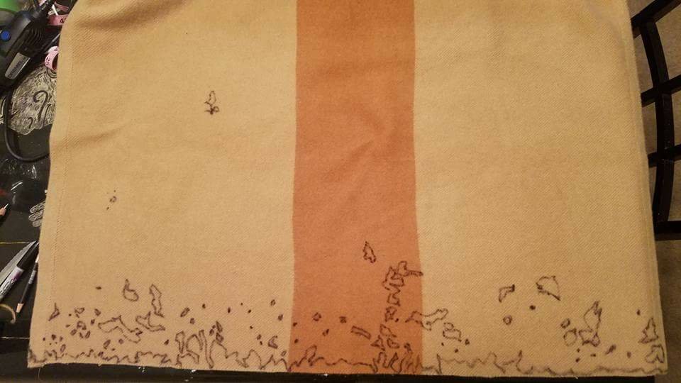

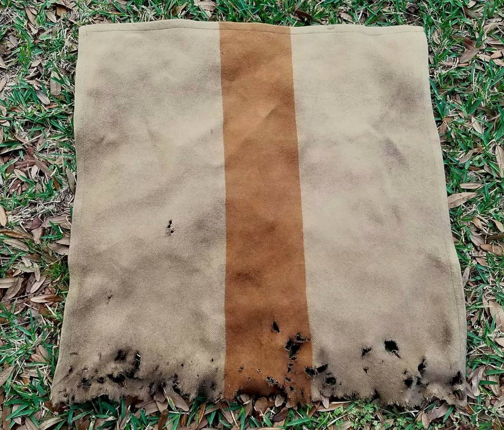

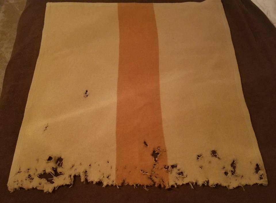

as for the cape, took a sharpie and traced out the pattern. cut out the big holes and edges with scissors, then a steak knife and started fraying the edges and the holes. lightly misted flat black spray paint over a few holes and on the bottom

thanks man! hit me up anytime. as for the toe spikes, I got metal ones from Evo Props. they supposedly fit the boots but mine didn't. I ran up to Lowe's and found a half inch aluminium strip and made my own, using the same spikes though
